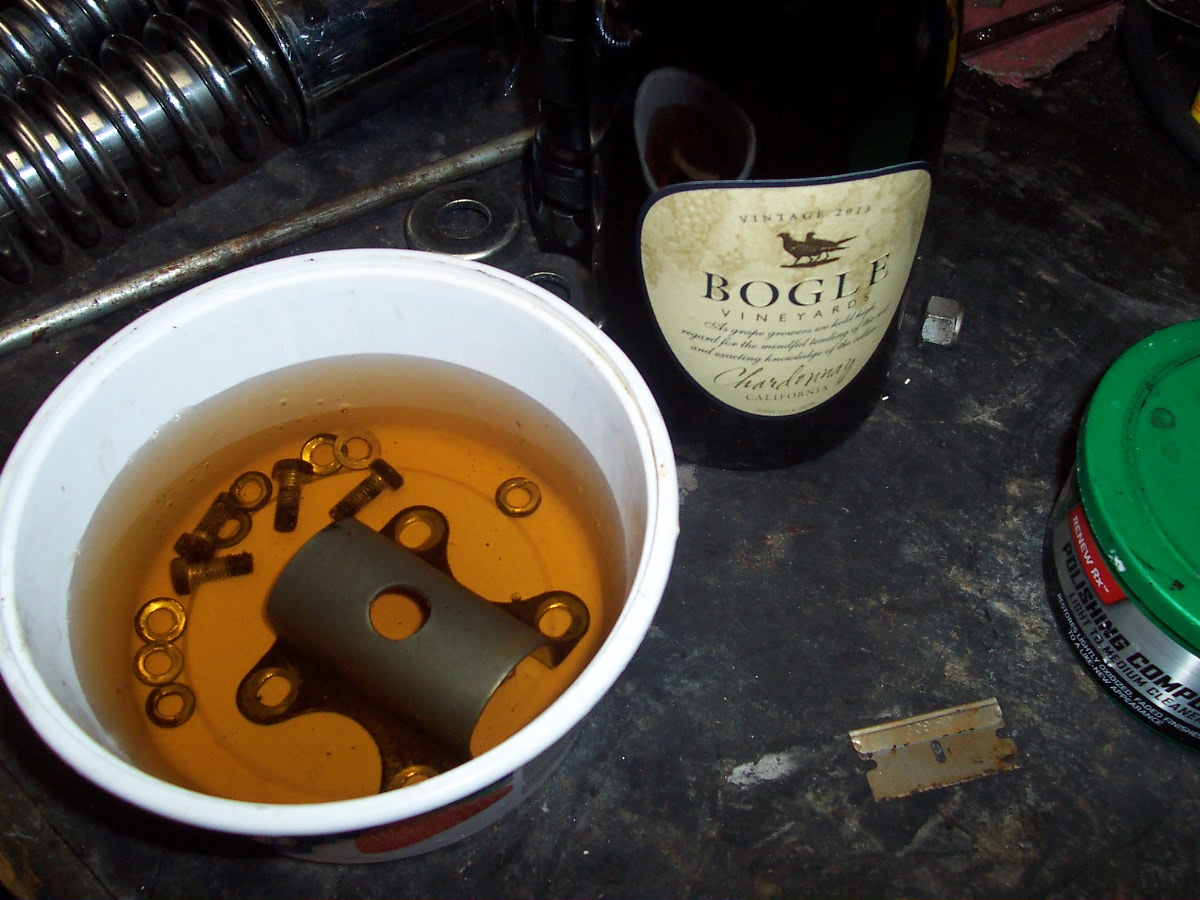

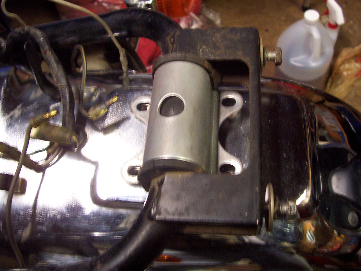

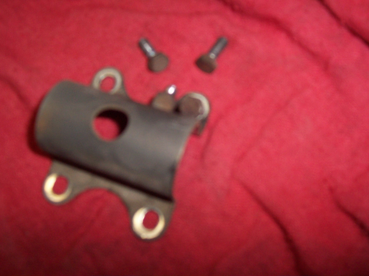

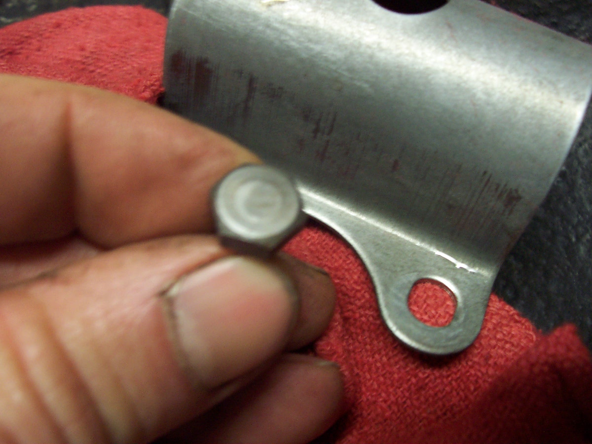

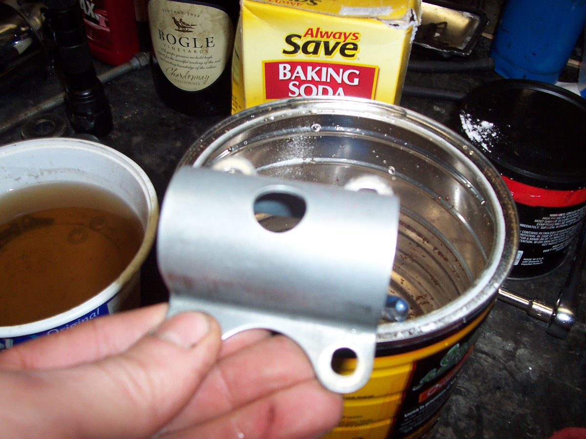

Thought I would share this. Old bikes have old crusty hardware. I took this ugly fender bracket off earlier tonight. I soaked it for a few hours in apple cider vinegar and give a scrub with an old tooth brush followed by a rinse in water mixed with baking soda.. rusty parts might have to sit over night. For chrome items I use regular vinegar
after a couple hours
