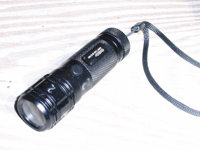

Motocomm Ridercam 480 is the camera I use. It is vga 30 frames/sec 640 x 480, but now there are HD versions available.
At 5ft., the screen field of view is 9 ft wide. So horizontal viewing angle is 84 degrees.
Front lens barrel O.D. is 28.8mm. I bought some bicycle quick-release seat-post clamps that were probably 28mm, then used a sanding barrel on a drill to open it up to the right size. Then I just had to use a longer bolt to fit the spacers and mounting perch.

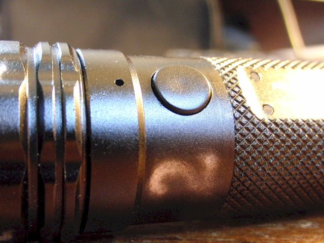

It's very simple to use.
One button.
Press it to turn it on.
Wait for both LEDs to come on.
Press it again to start recording.
The green LED flashes while recording.
Press it again to stop. (Green LED stops flashing.)
It shuts off after a few minutes of non-recording.
The battery lasts long, and I've made continuous recordings that lasted over an hour.
I would guess you can get about 2 hours recording time or more on a good charge.
I've charged it, and let it sit in a box for almost a year, then took it out and recorded for about hour.
The microphone is the pinhole near the button. I usually forget, but it's probably a good idea to stick a piece of tape over the hole to reduce some of the wind noise. I think I may have damaged the microphone on one of cameras. But if you want good sound, you'll want a separate recorder for sound.

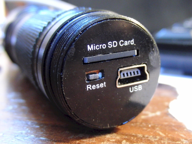

The backend unscrews with a watertight oring to access the sd card and the USB port. There is a reset button that kills power in case the camera gets locked up. I can't remember if I ever had to use it.

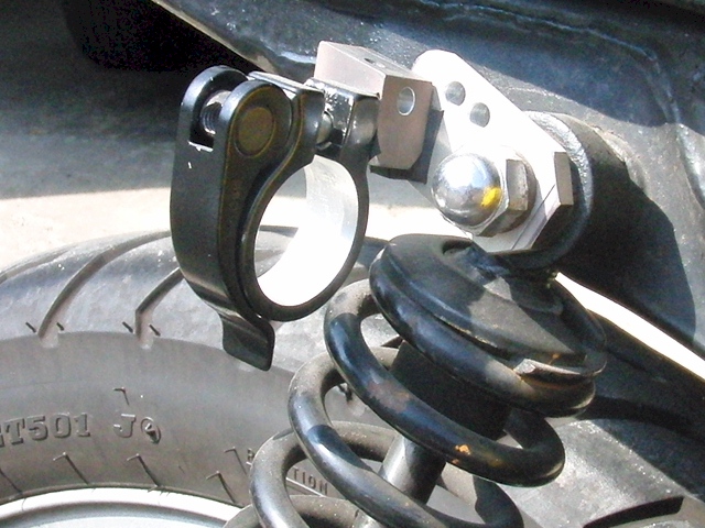

Here are the mounts up close. I just found some aluminum scrap at work to make the spacers and perches.
I needed a longer bolt to use for the fork pinch bolt.
The rear needed that extra spacer so the cam would clear the rear shock spring.
