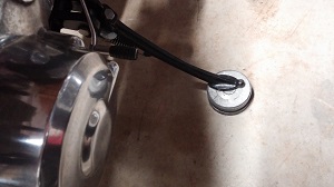

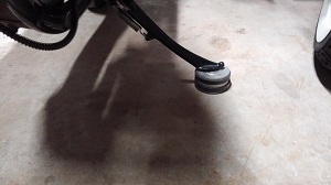

Just returning from being away from the Forum for a while. Funny, I was thinking of the forum the other day and was wondering if there was a place for tip-of-the-day!
Here is mine...I have found the need to slip a piece of 2X4 under the kickstand of my Copbike1000 a few times. As we ALL know, as you settle the kickstand onto the 2X4, it usually slides away and you have to balance the bike while you align the 2X4 block just right.
Well, I have had two fairly large, round speaker magnets that I have stacked onto one another. I then set the magnets close to the kickstand and when I am ready to set the kickstand onto the magnets, they are attracted to the base of the kickstand and you now have a secure base to set the bike on. No slippage. I think I took these magnets off of a set of old 6X9 car speakers.
