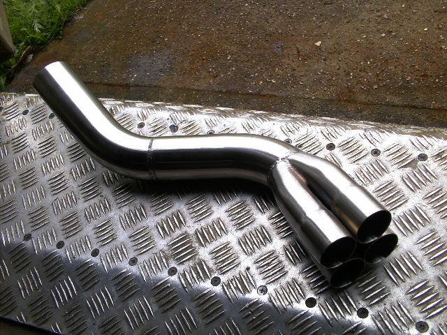

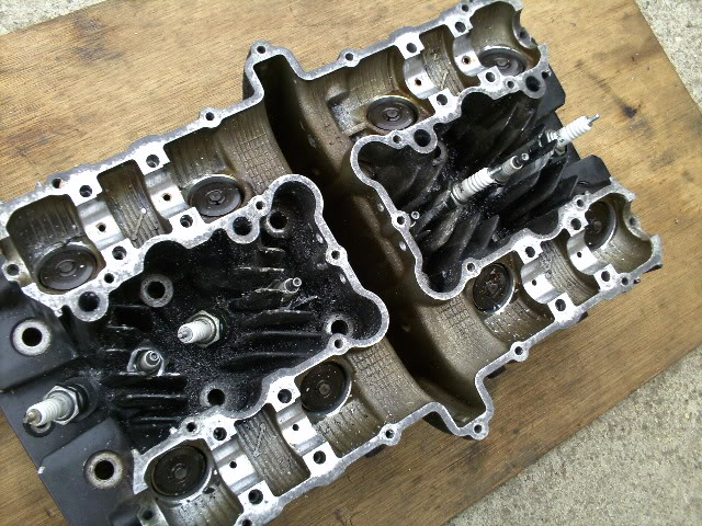

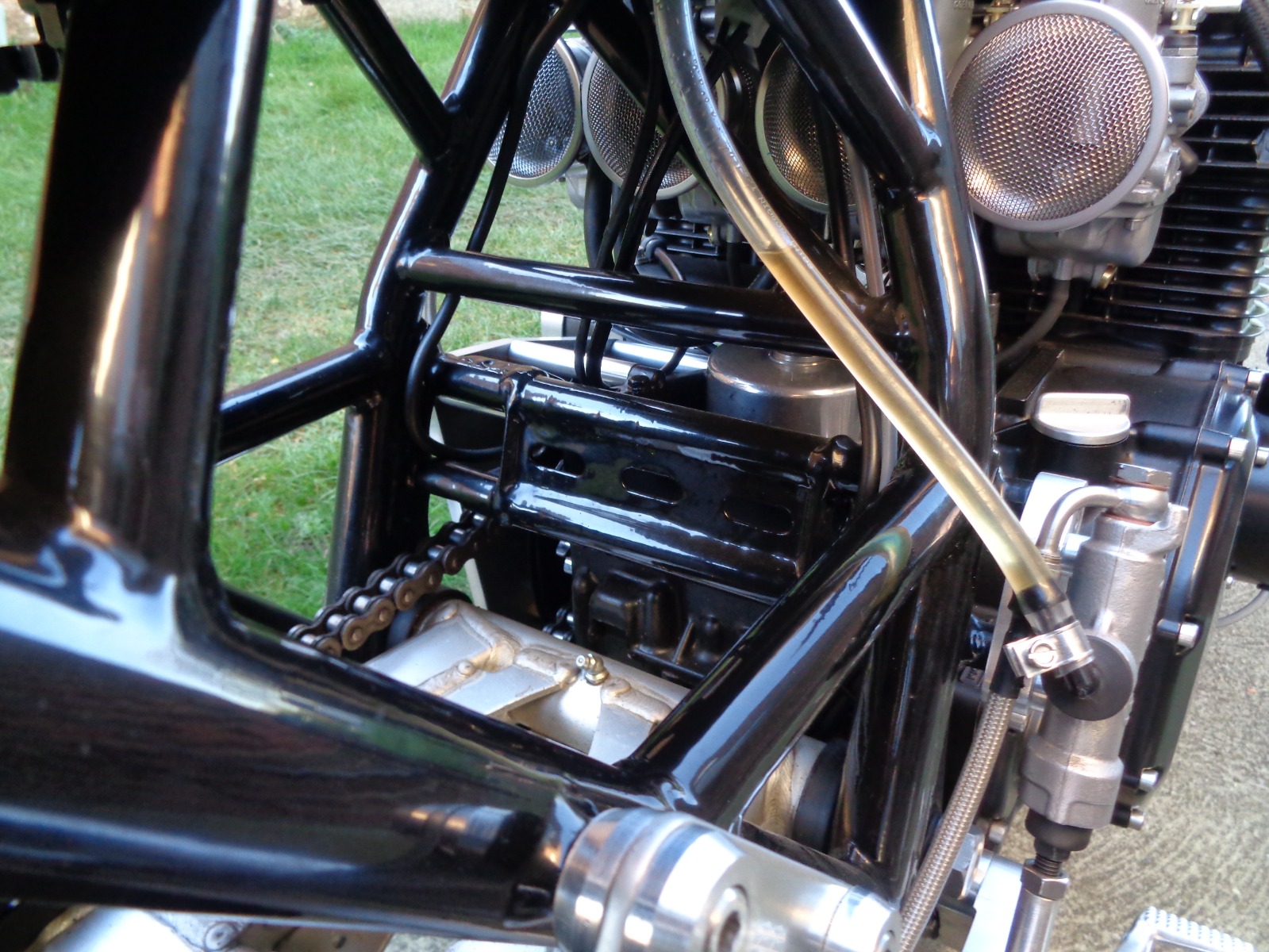

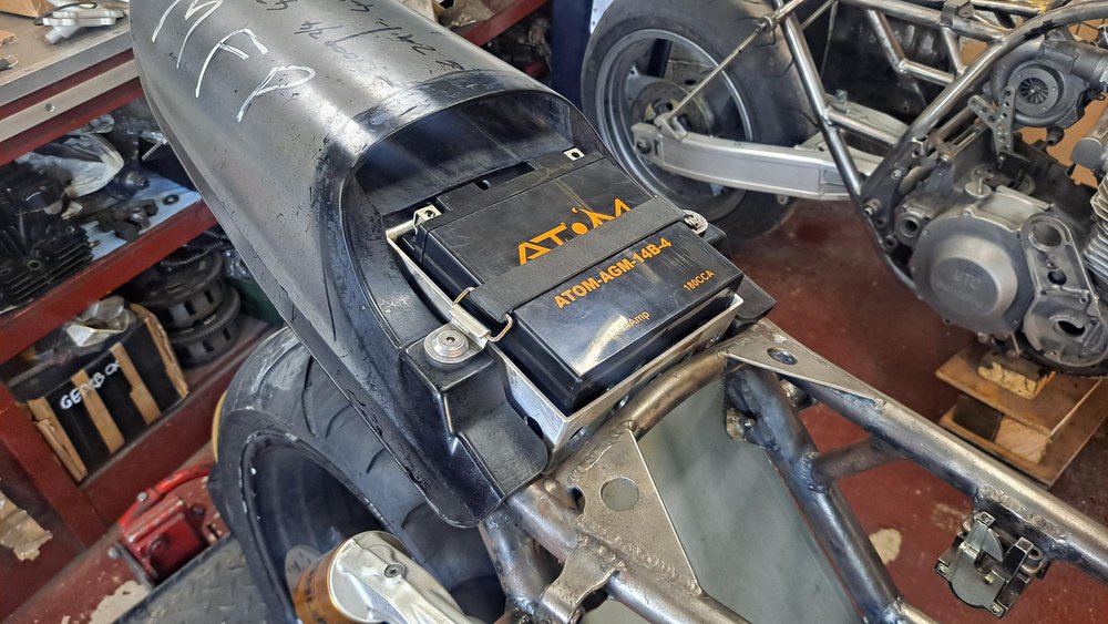

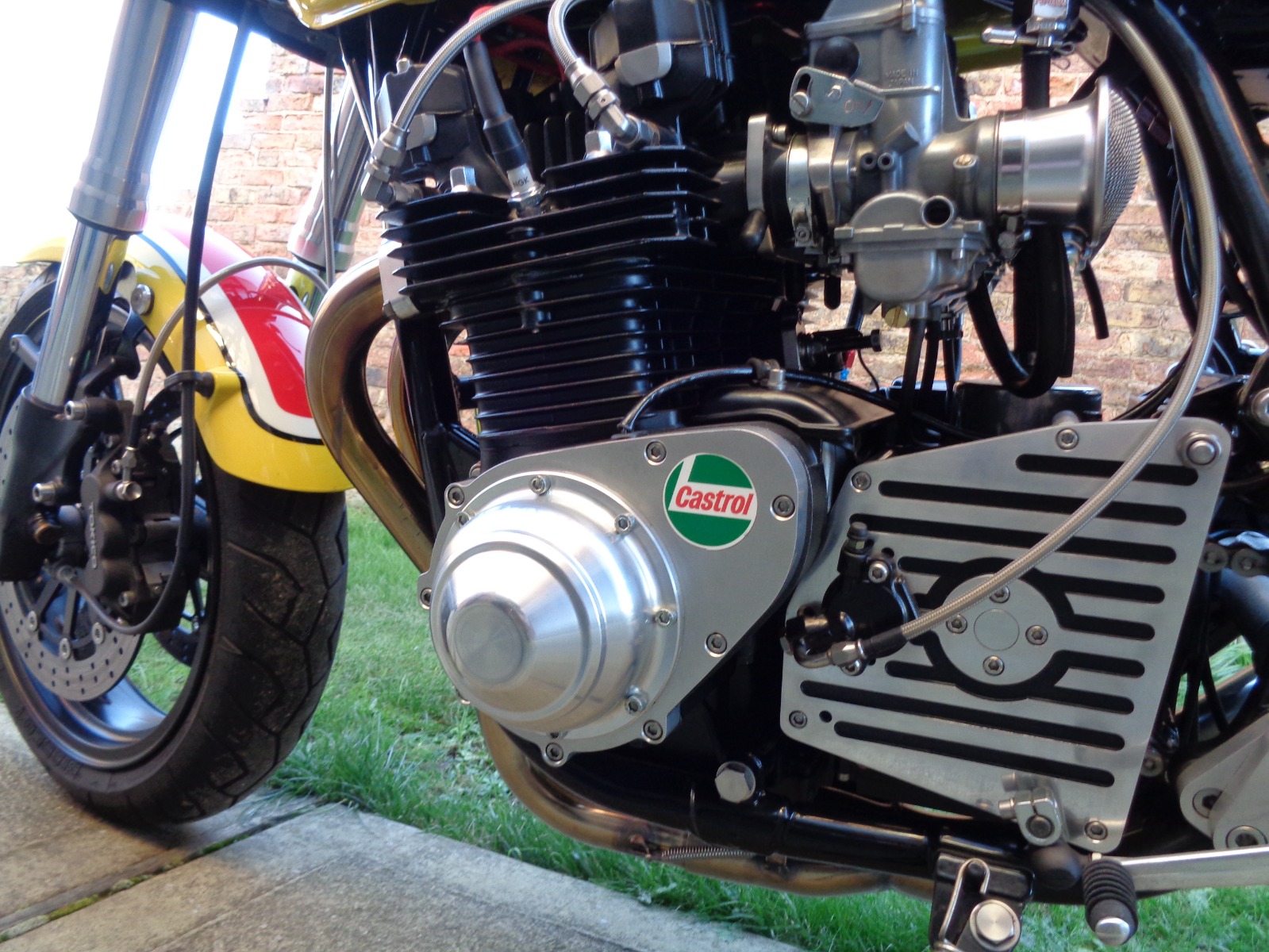

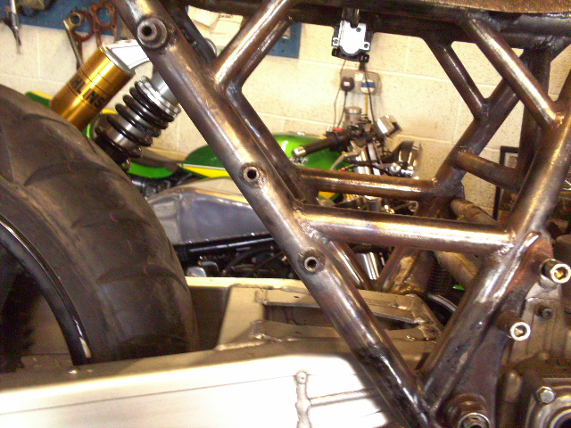

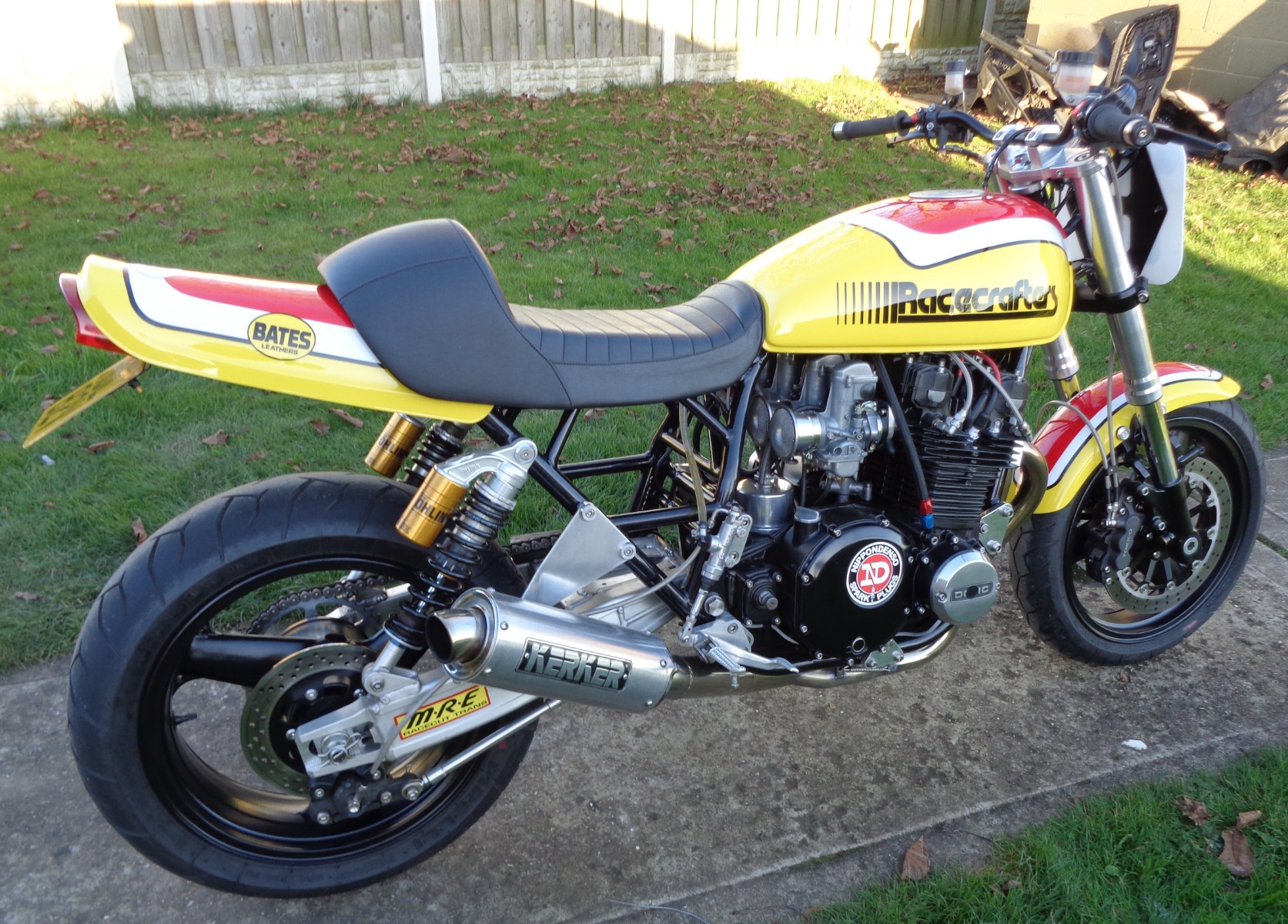

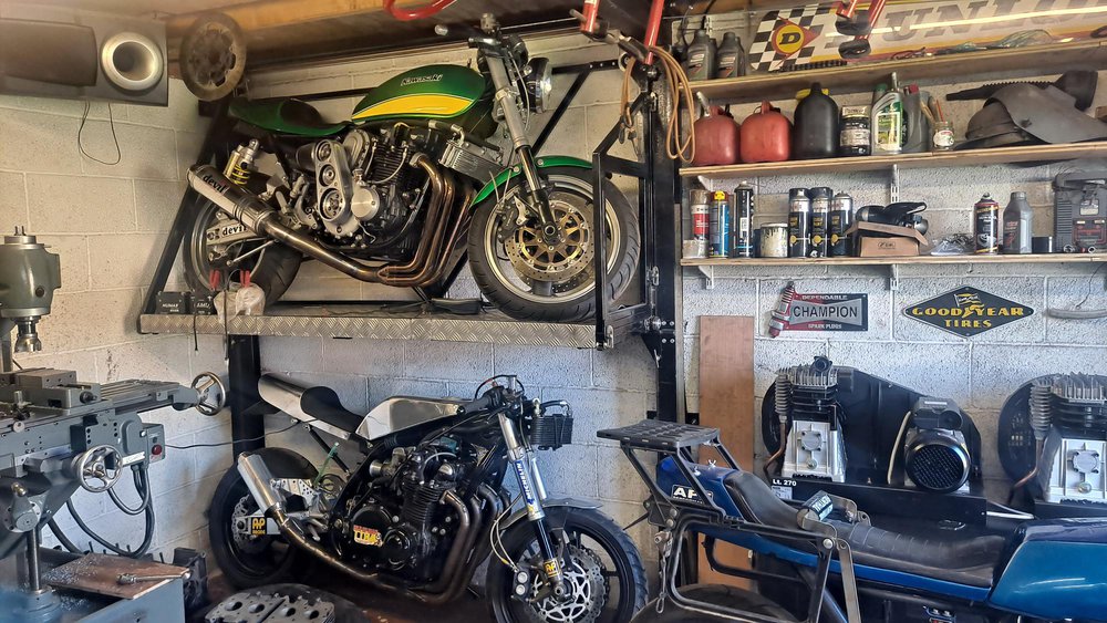

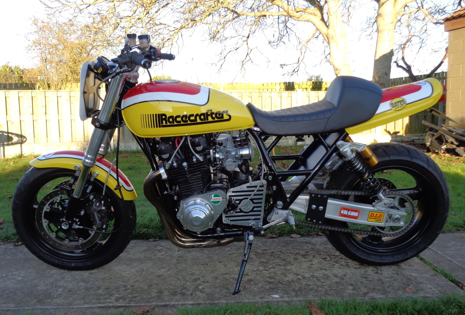

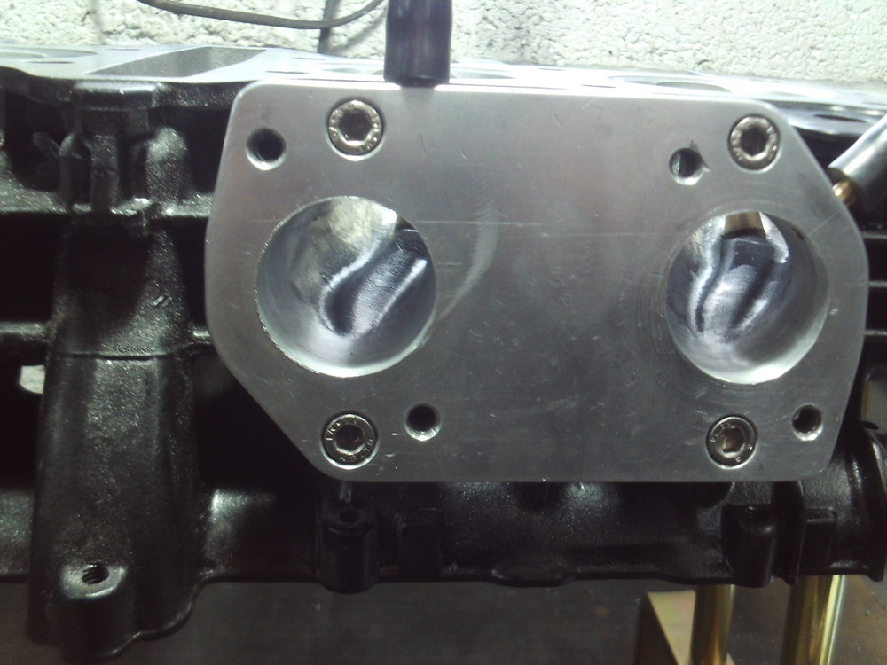

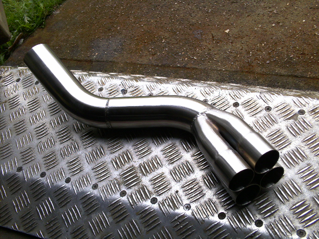

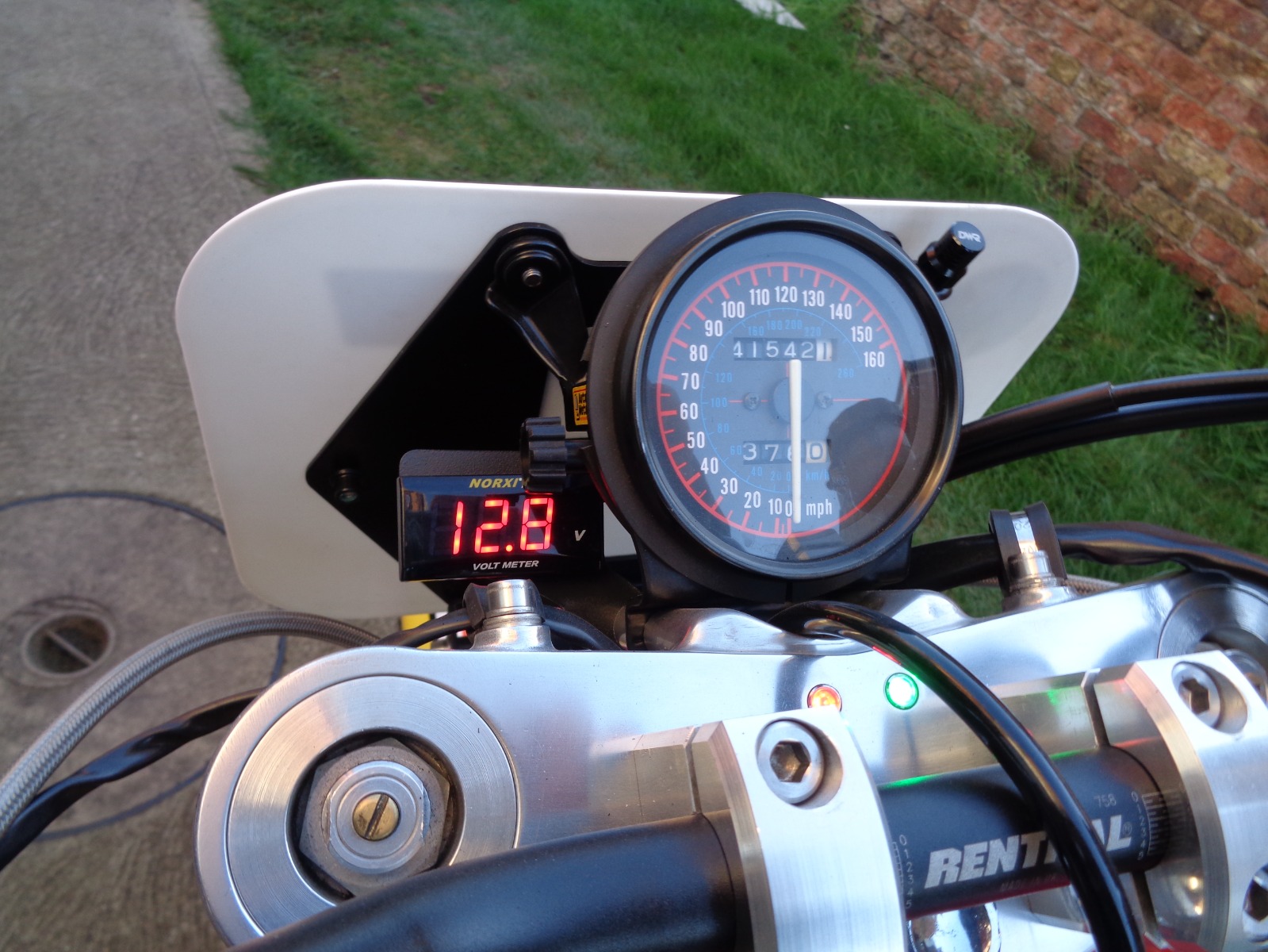

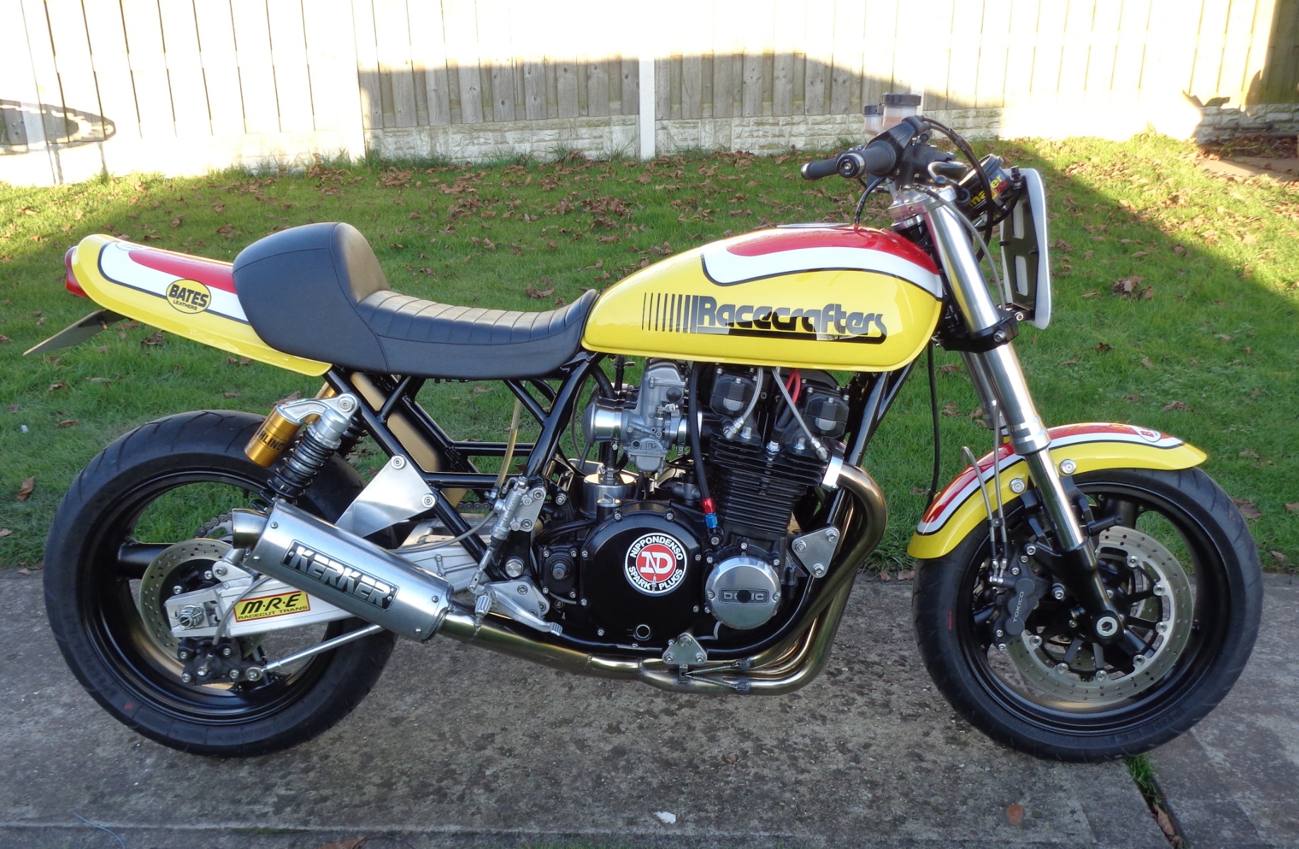

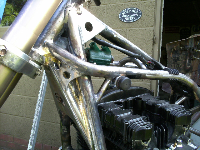

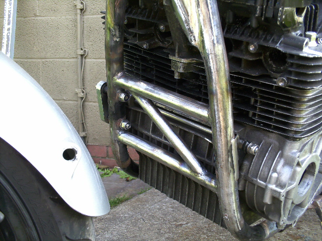

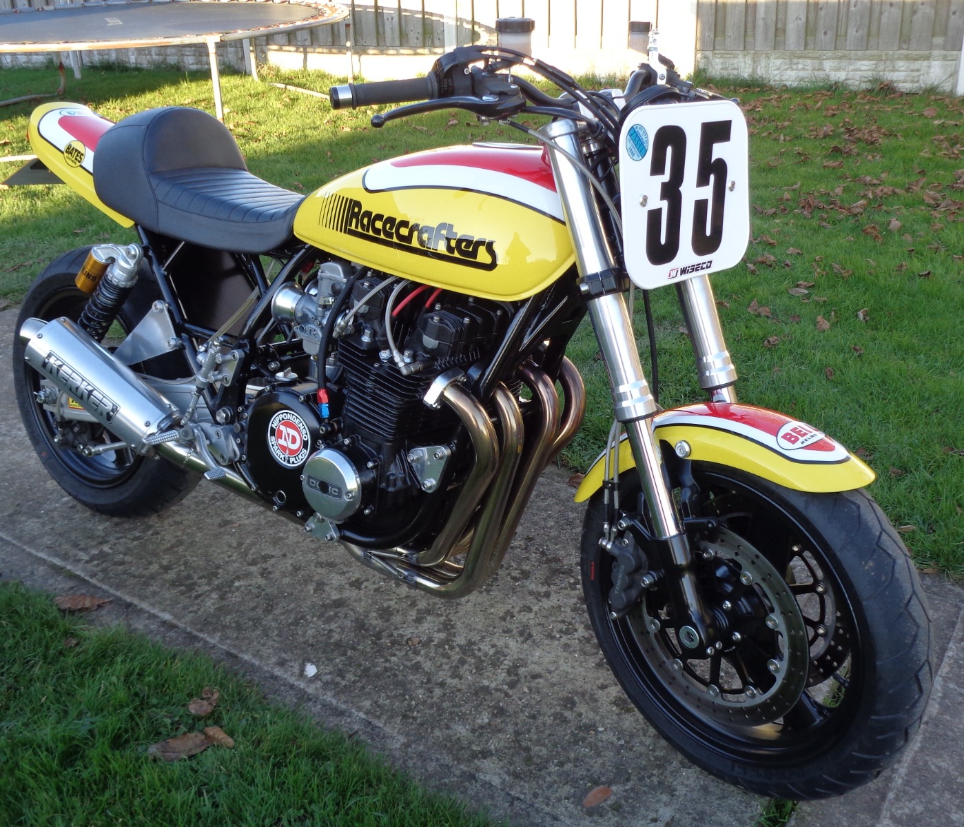

We are in the UK to start 2025 with another breathtaking build from Rob (Zed1015) approx 6 years in the making this “slow burn” project has run alongside other builds (watch out for the Moriwaki turbo in the future) I would strongly recommend checking out the build thread on the Z1OC site at the link below, the depth of engineering and ingenious problem solving is truly inspirational. I love the details like the “modified” lower tree being used as a “top” tree because the original wasn’t aesthetically pleasing to Rob and also the “no vinyl” paint job (those decals aren’t “decals”)Couldn’t resist including the pic of the storage solution when you “just have too many feature builds” for the available space !!!
Double the troubleZZ. AMA style Racecrafters Z1000 (completed) and Moriwaki Z1R Turbo. - Page 15 - Z1Owner sClub GB
Built around a collection of parts this Z1000A based AMA tribute is definitely “top drawer” when it comes to modified early Z’s 😊
· 1075 Wiseco pistons
· “J” head (converted to “eight plug”)
· Kent Cams
· Slotted sprockets
· Welded crank
· Titanium retainers and HD springs
· 32mm Katana carbs
· Dyna ignition

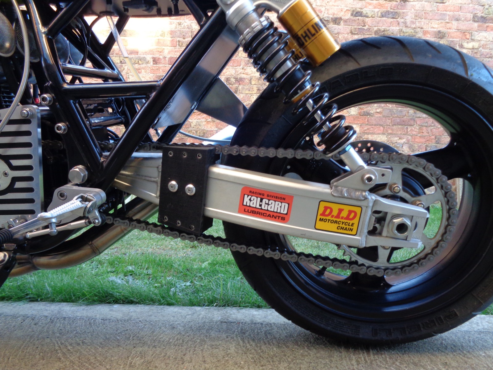

· XJR1300 swingarm with the frame line-bored at the pivot points
· Ohlins dampers
· ZX7R wheelsZX7R front end
· Heavily braced frame

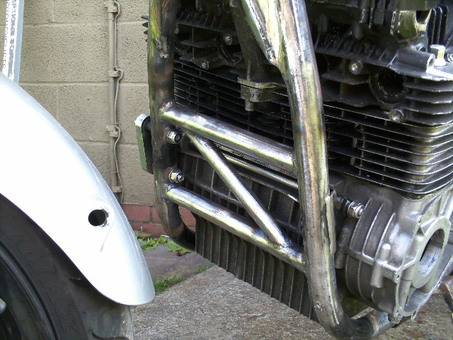

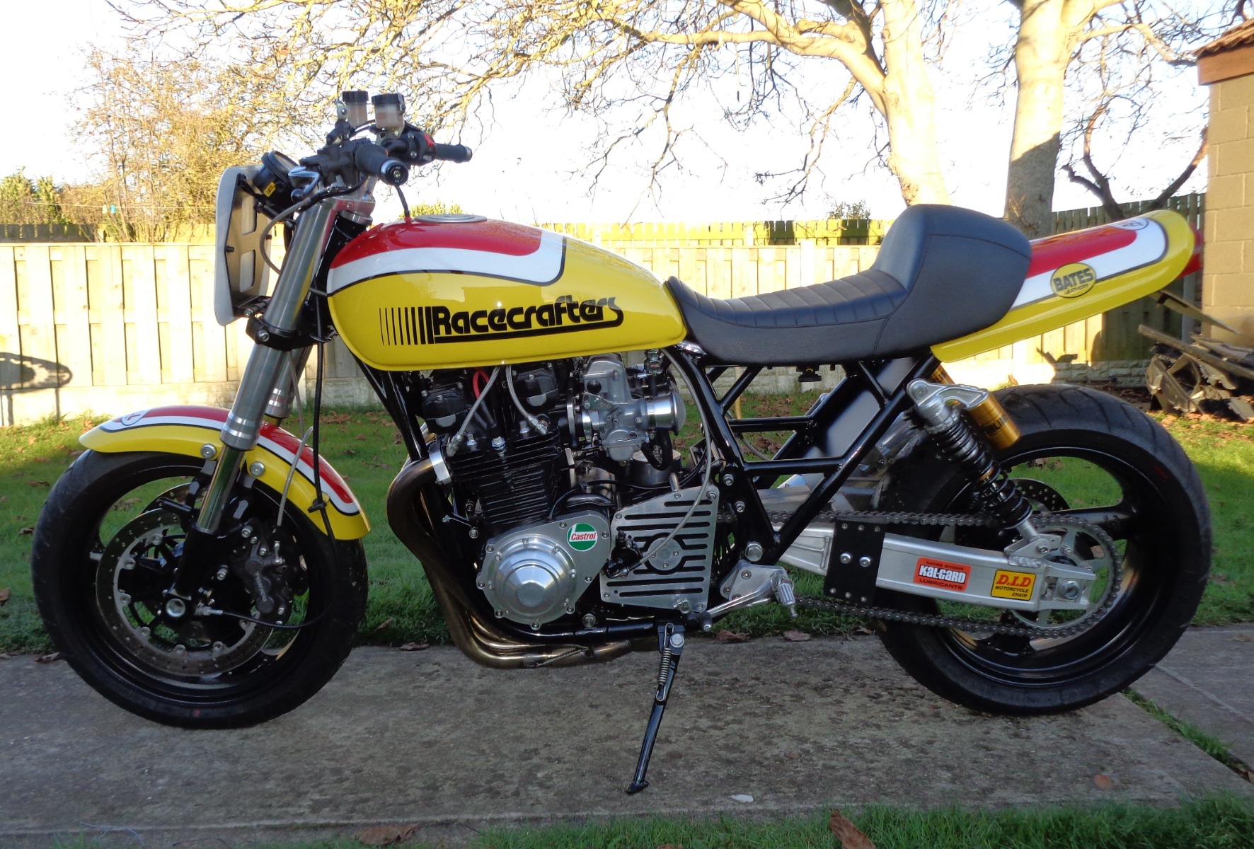

· Kent Cams
· Slotted sprockets
· Welded crank
· 32mm Katana carbs
· Dyna ignition
· Ohlins dampers

Absolute work of art. Serious fabrication I could only dream of!! Love it.

When Wookie posted zed's bike I clicked on the link to the z1ownersclub thread and got lost in the details. Completely forgot to come back and post here. Amazing work and some really nice fabrication. I tip my hat to you, sir.
Zed: if you read this, what was the reason for using the electrex rotor?

15 Jan 2025 08:24The reason is for the reduced centrifugal mass of the smaller rotor which gains a few HP and increases throttle response which is essentially the same effect as lightening the crank.Zed: if you read this, what was the reason for using the electrex rotor?
Other than that the smaller case allows more ground clearance and most importantly it looks trick ..

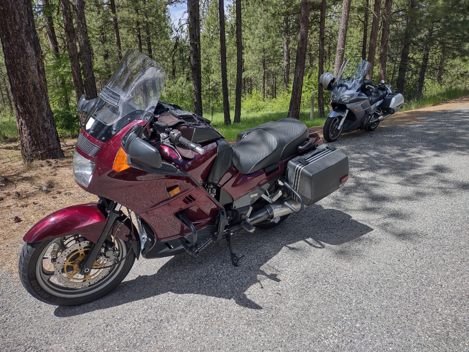

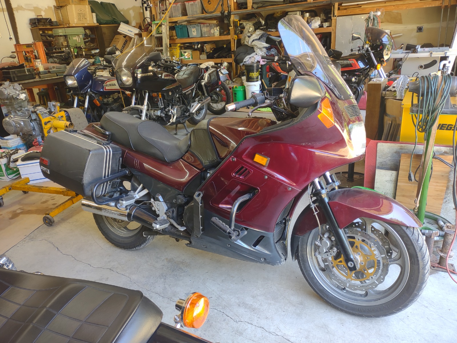

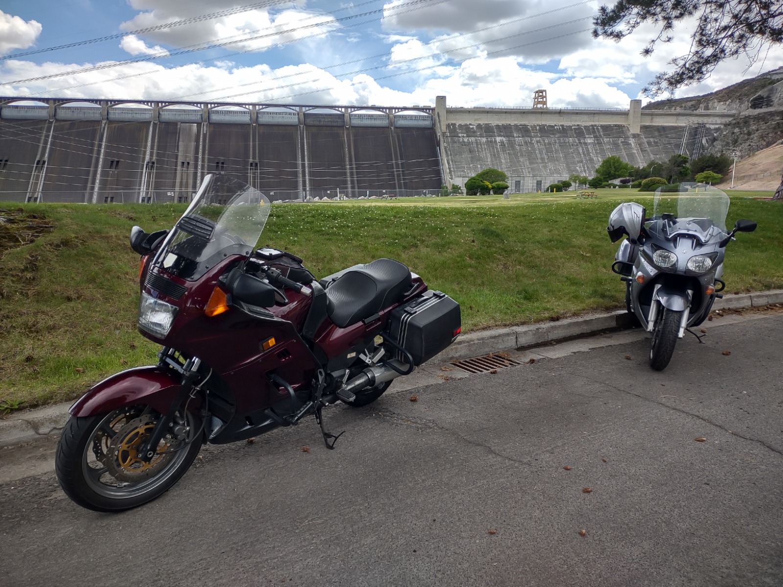

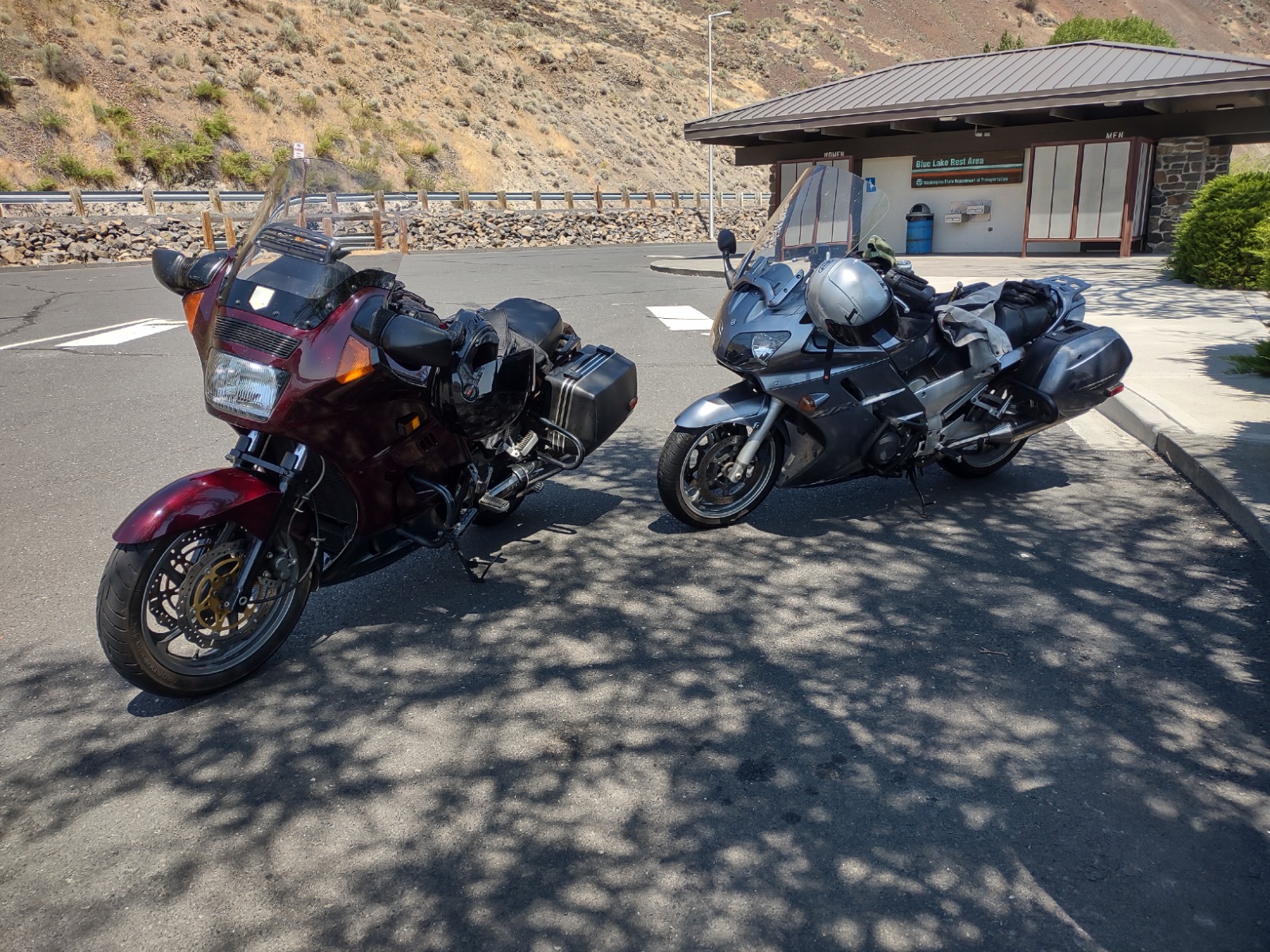

When I resurrected BOTM the criteria was simple. This was a feature about our members, their bikes and their stories. Not just for “trailer queens” and “high end” builds but also about the passion and the stories our members want to share. This month we have Kelly’s “concours” but more importantly a story of “one mans battle” his determination not to be beaten and how the passion we share has given him a “new lease of life”. Many would have been destroyed by such a diagnosis but instead Kelly has built an enviable stable of rides which he uses and enjoys.
Kelly’s story Back in 2015 I was diagnosed with stage 4 prostate cancer. Shortly after that my uncle called and said I could have his 84' Honda VF 700S Sabre and I joined v4musclebike.com for help resurrecting the bike after a 6 year sleep outside.
On that site I met some great people and one in particular. He was a federal agent and with the help of the site owner set up a fundraiser for me that everyone else on the planet could see but me.
In May of 17' we went on a 4 day website meeting in Eugene Oregon. At the big dinner they totally surprised me with a $2200 check for me to do something fun for myself.
I'd just helped my new buddy find a nice FJR before the trip. He asked me what I was going to do with the money. I told him that I was getting a long distance sport touring bike. We've been riding long distance every year since.I bought a 94' ZG 1000 GTR/Concours. It had a bad #4 exhaust lobe but I knew about “Shouldabeen” Eng torque cams for the bike.
I bought the last set he made and they transformed the bike. Peak power hits at 8k rpm. I shift at that point and my buddy's FJR can't catch me until 85mph to 90mph.
I also added a fork brace and Progressive springs. In the rear I swapped in a ZZR 1200 shock. Now I can just about drag the saddlebags in a good corner.I've ridden from Seattle area to Deadwood South Dakota in two days and rode for 9 more days straight. We covered 4k miles and I could have kept going.The first generation GTR/Concours can do everything a Goldwing can do but is way more fun. The last Goldwing that tried to keep up fell behind in a shower of sparks.

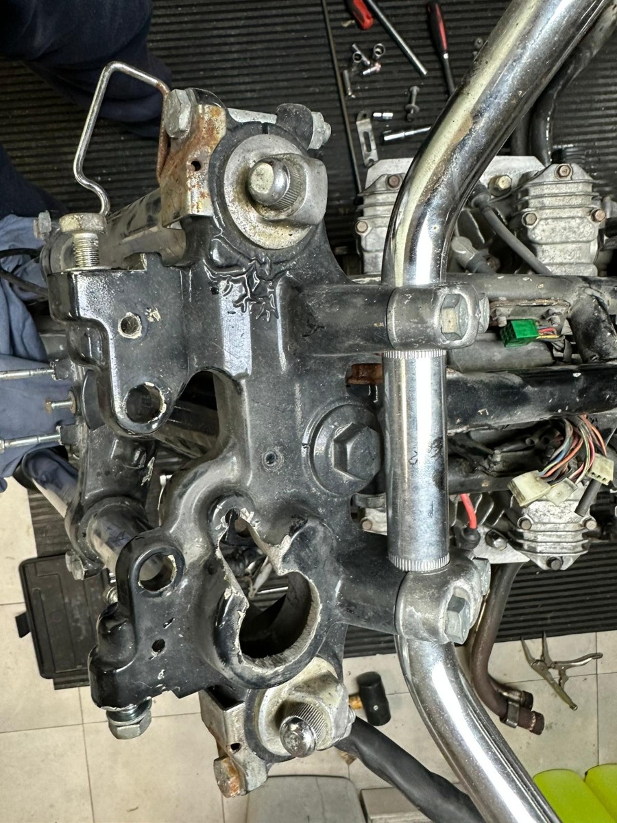

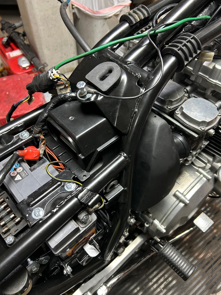

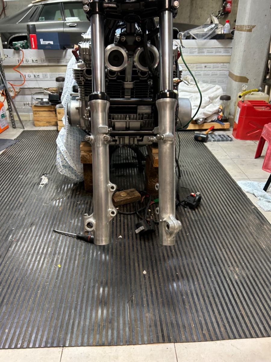

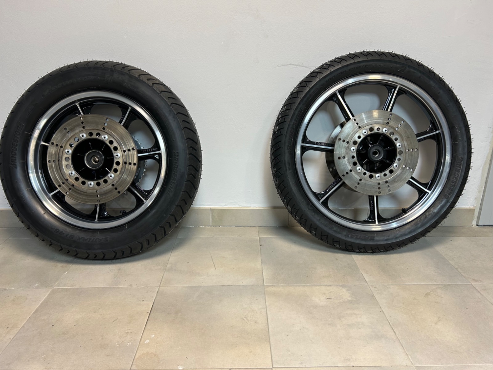

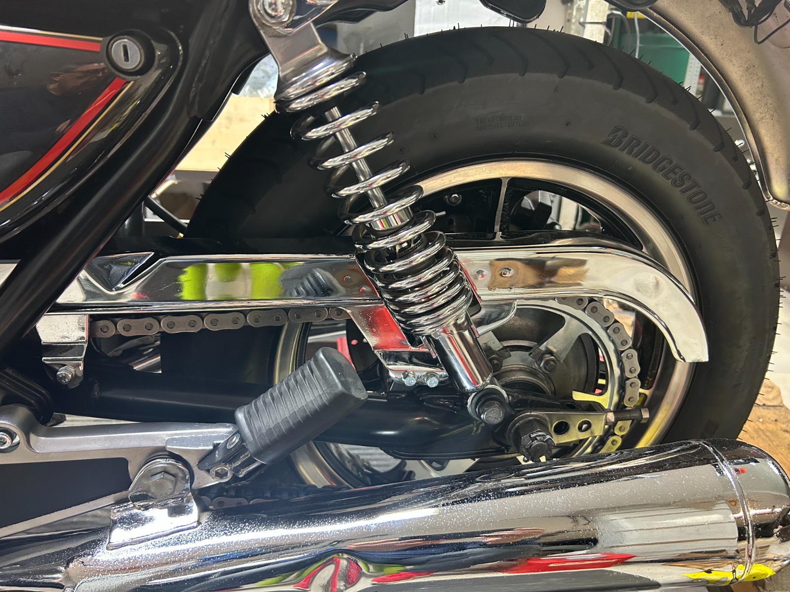

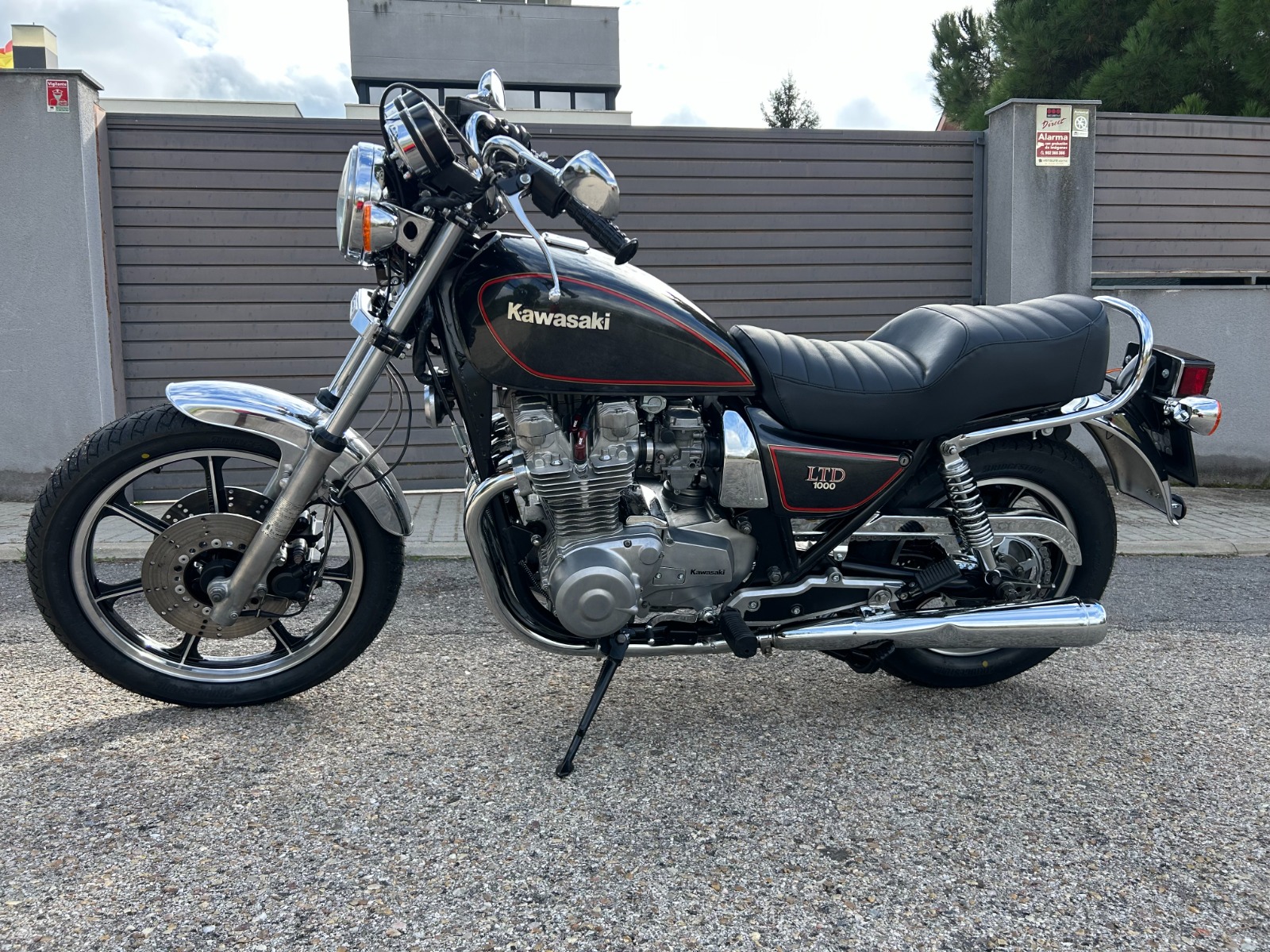

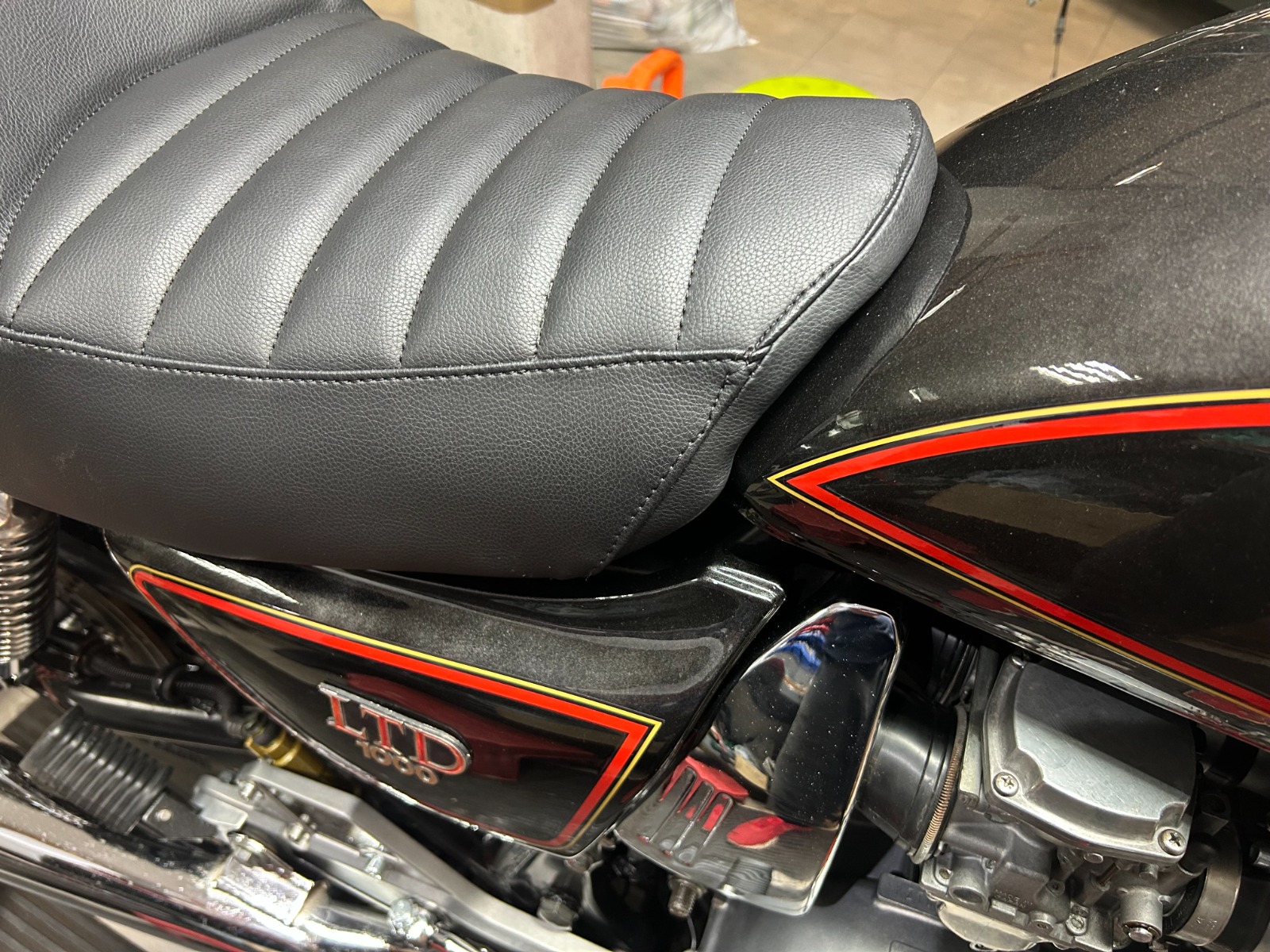

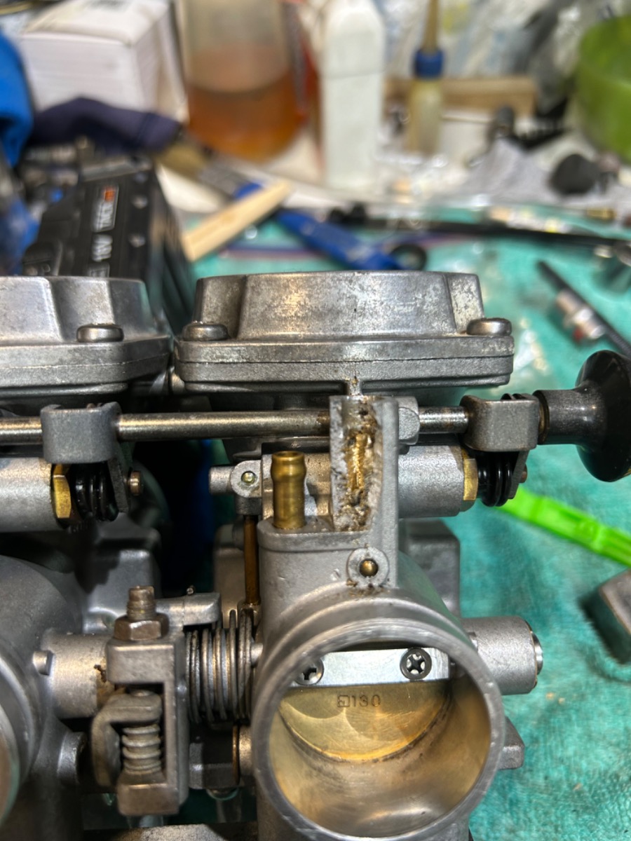

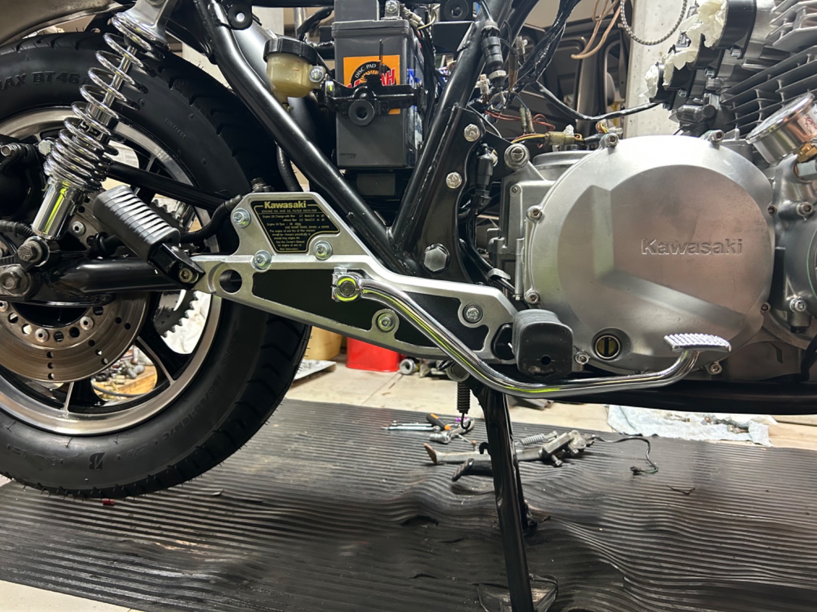

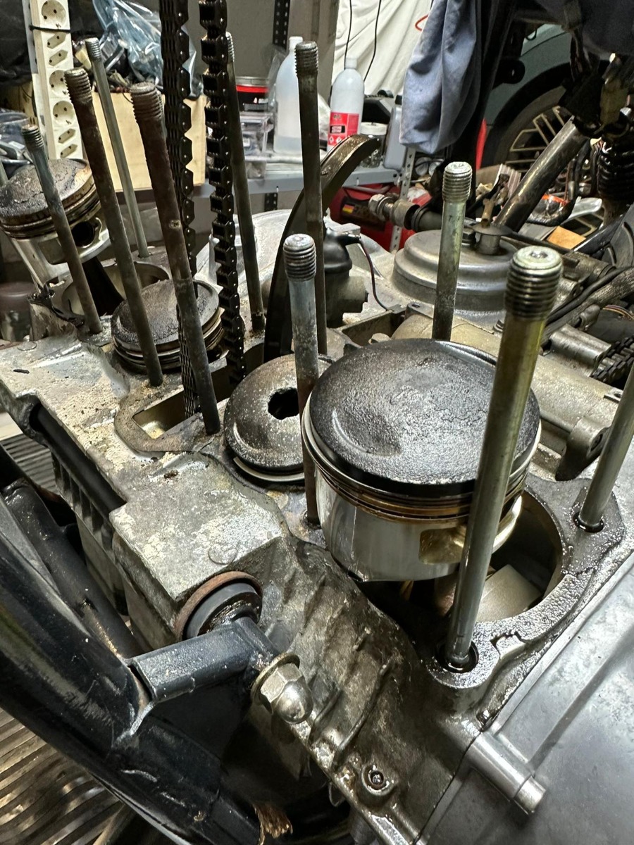

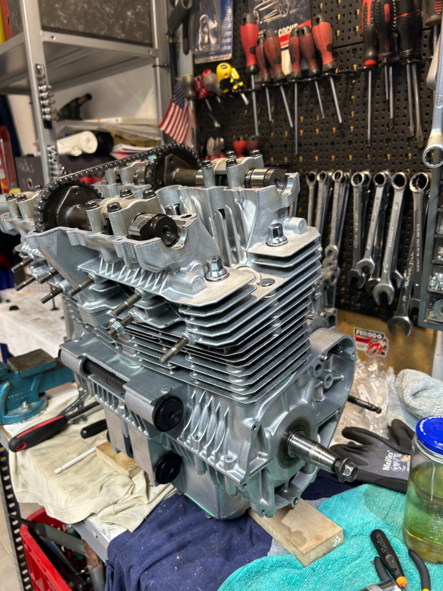

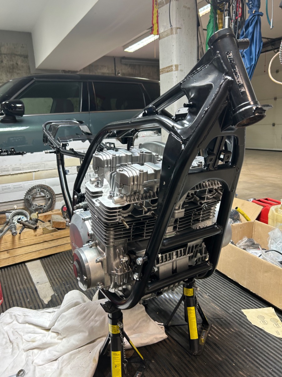

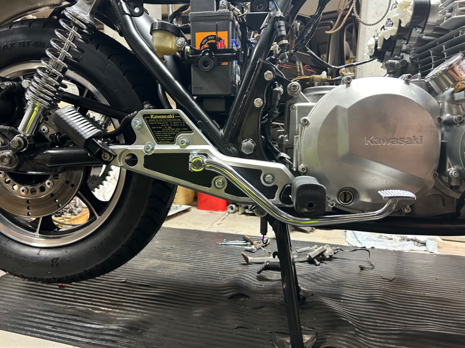

This month we are in Madrid Spain for Carlos’s 81 Ltd. I first became aware of this build in late 2022 (it didn’t start as a build, just ended up that way) I decided to follow the project as it’s the same model as my build and I’m always looking to learn.
Piston Hole Kz1000LTD 1982 - KZRider Forum - KZRider, KZ, Z1 & Z Motorcycle Enthusiast's Forum

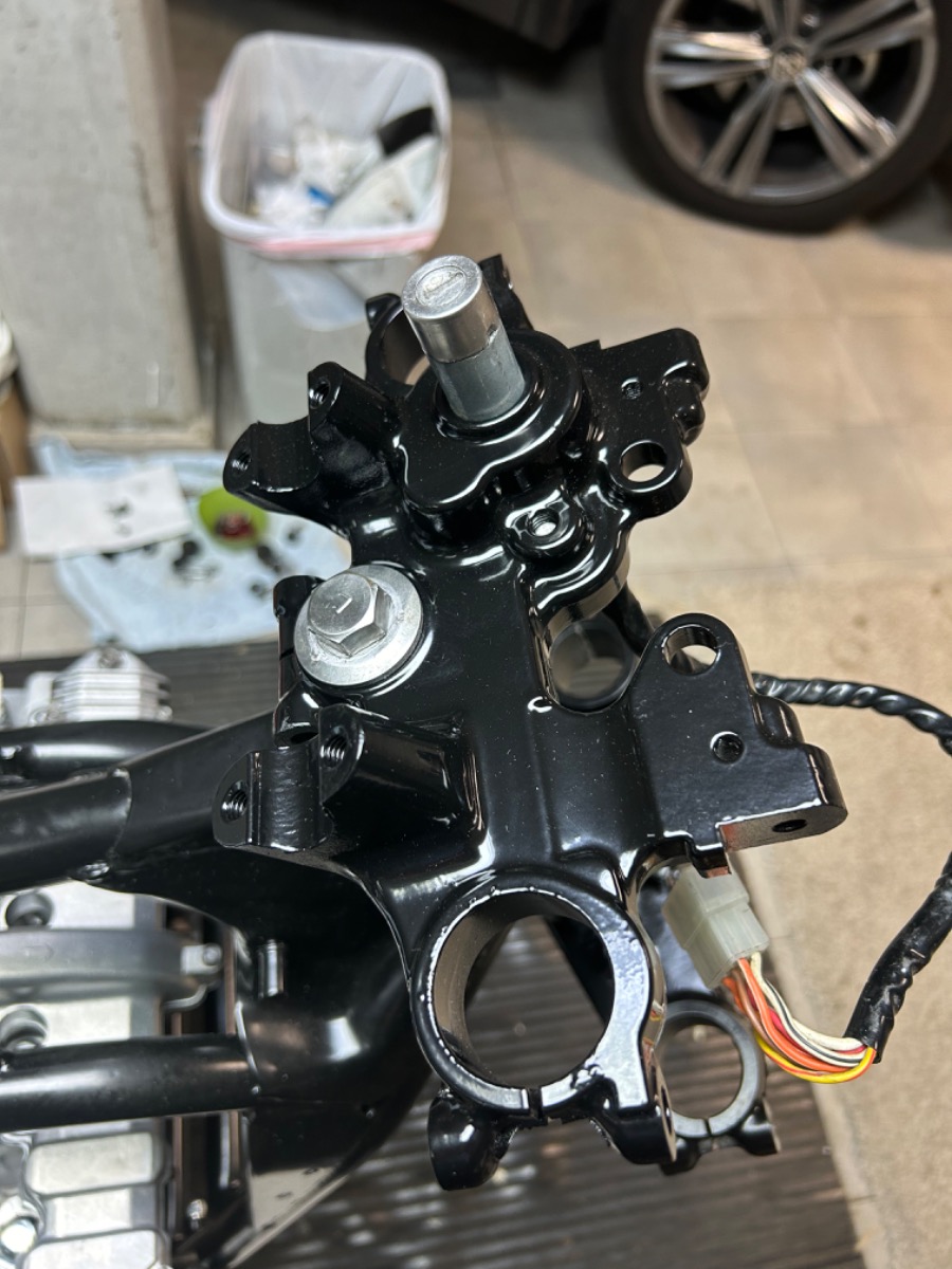

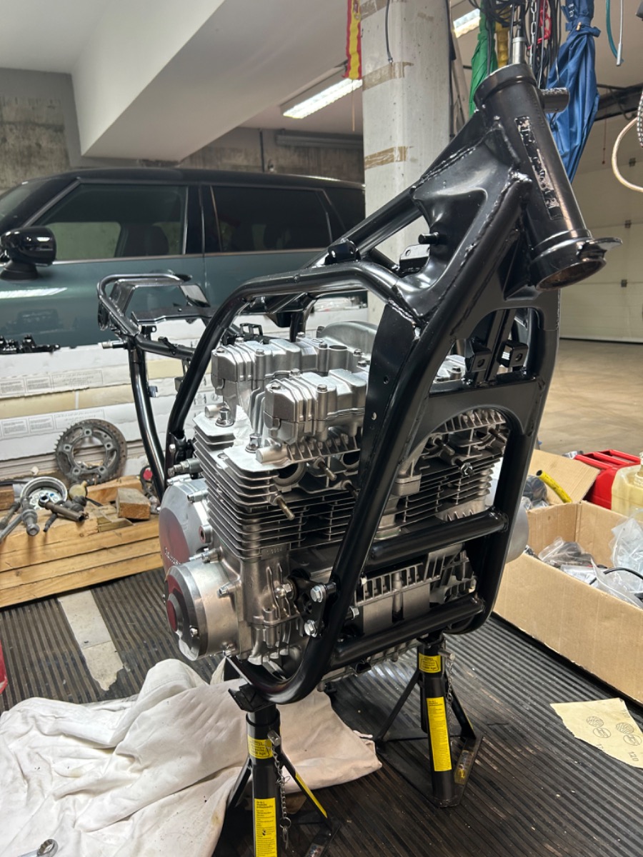

Initially the “ever optimistic” Carlos intended to give the bike a “good clean” some “routine maintenance” and head out into the glorious Spanish sunshine to enjoy his latest acquisition 😊Unfortunately it quickly became obvious that the PO had used, abused and butchered this poor bike until it just wouldn’t keep going any longer, and so started years of dedication in a frame up rebuild. Throughout this project the punches have just kept coming from butchered trees, to a holed piston and just as the “light at the end of tunnel” was shining bright a broken carb had Carlos scouring the globe for replacements (provided by another member here) So after much fiddling the carbs where on and finally the bike was a runner. But only briefly before the ignition system chose to be the next “fly in the ointment”It is testament to Carlos’s resolve that he has remained pragmatic throughout the build, taking the issues as they have arisen, rectified them as necc and moved on to the next step. Carlos I salute you in putting together a great bike that you can enjoy for years to come 😊

Butchered is an understatement, Wookie!
Excellent work, Carlos. It was a long road but now you can finally get out in that spanish sunshine and just ride.

Oh boy this bike was putting up some fight, but you won very nice bike ! Thanks for sharing the project !
