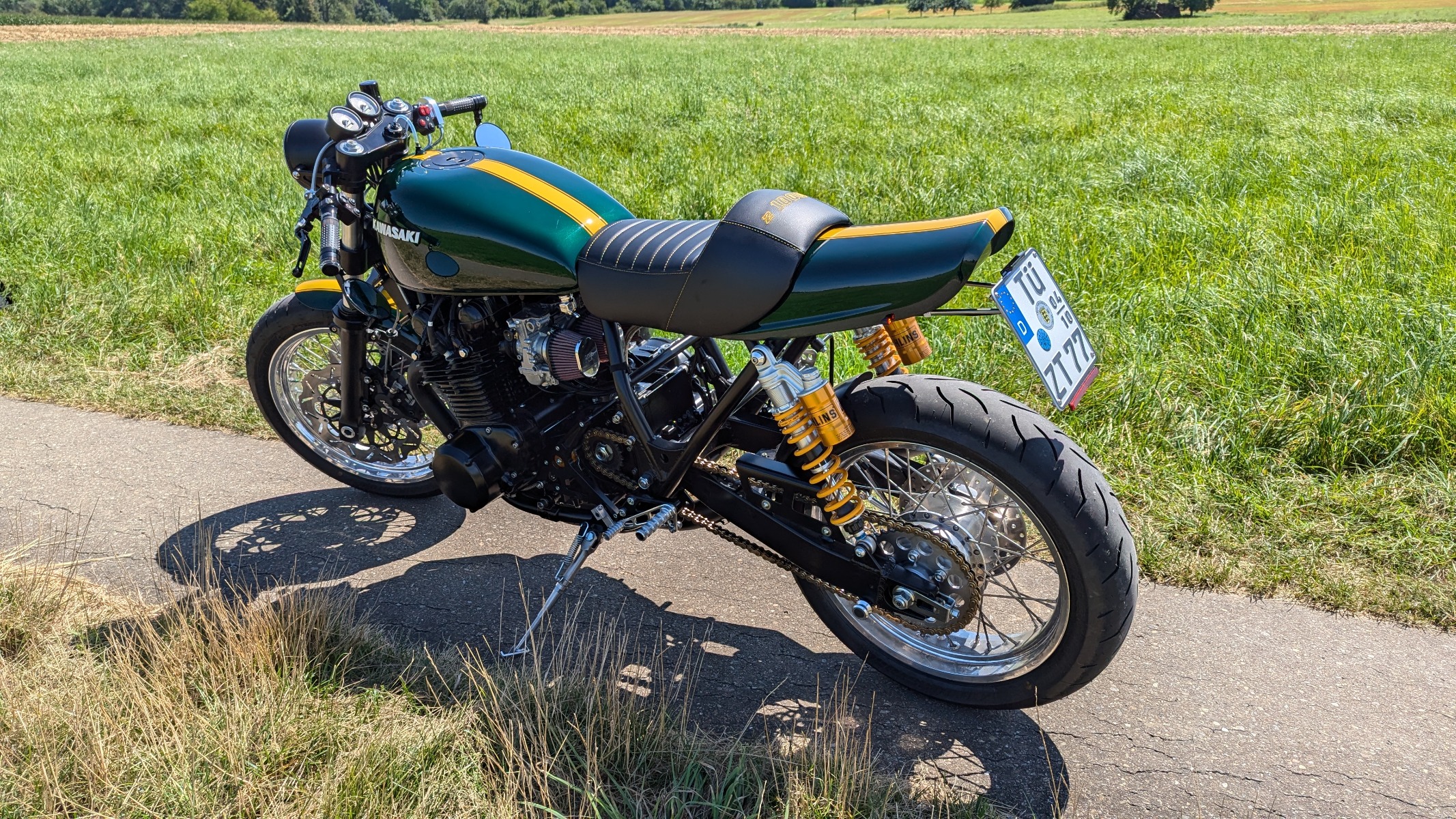

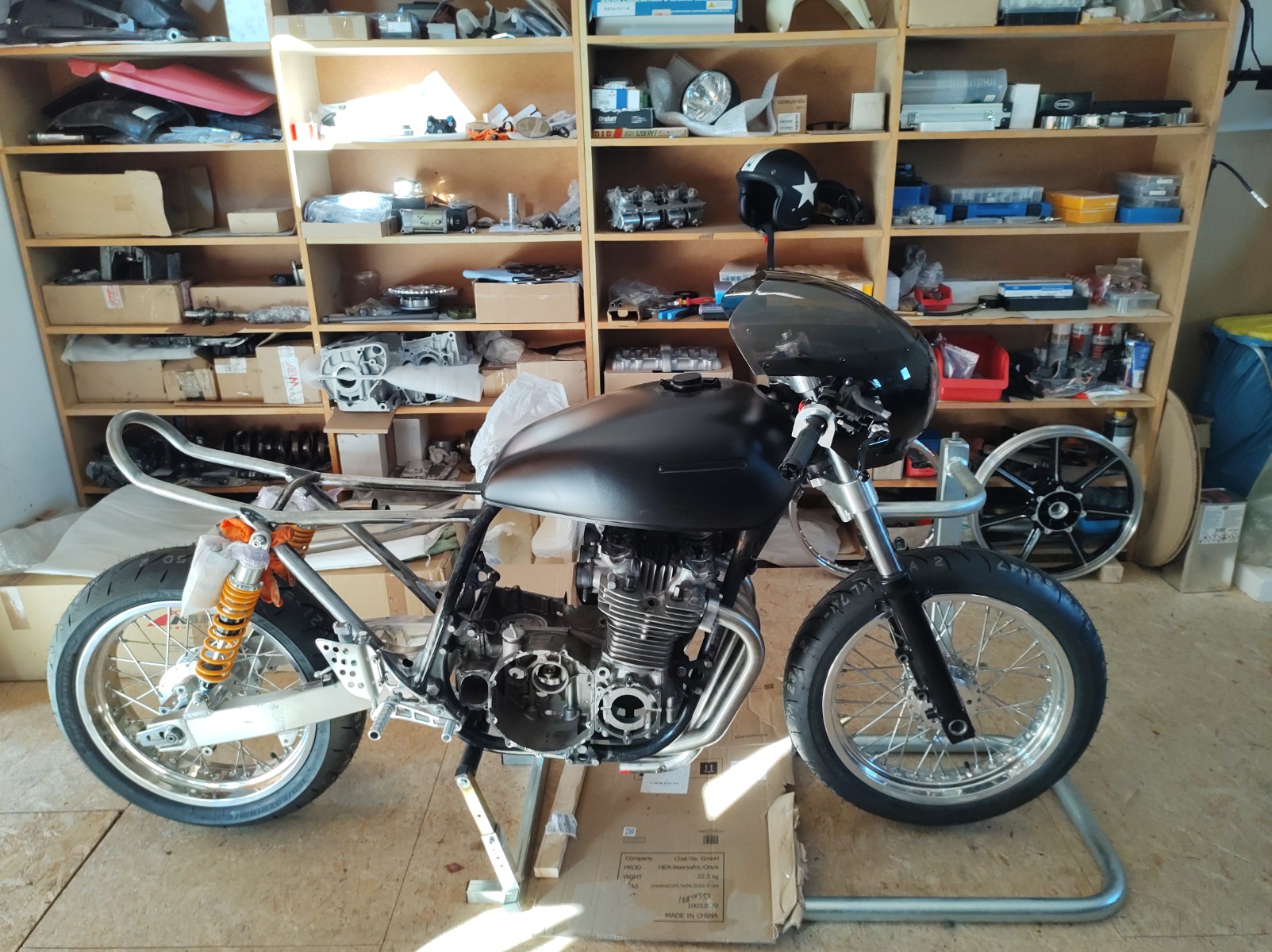

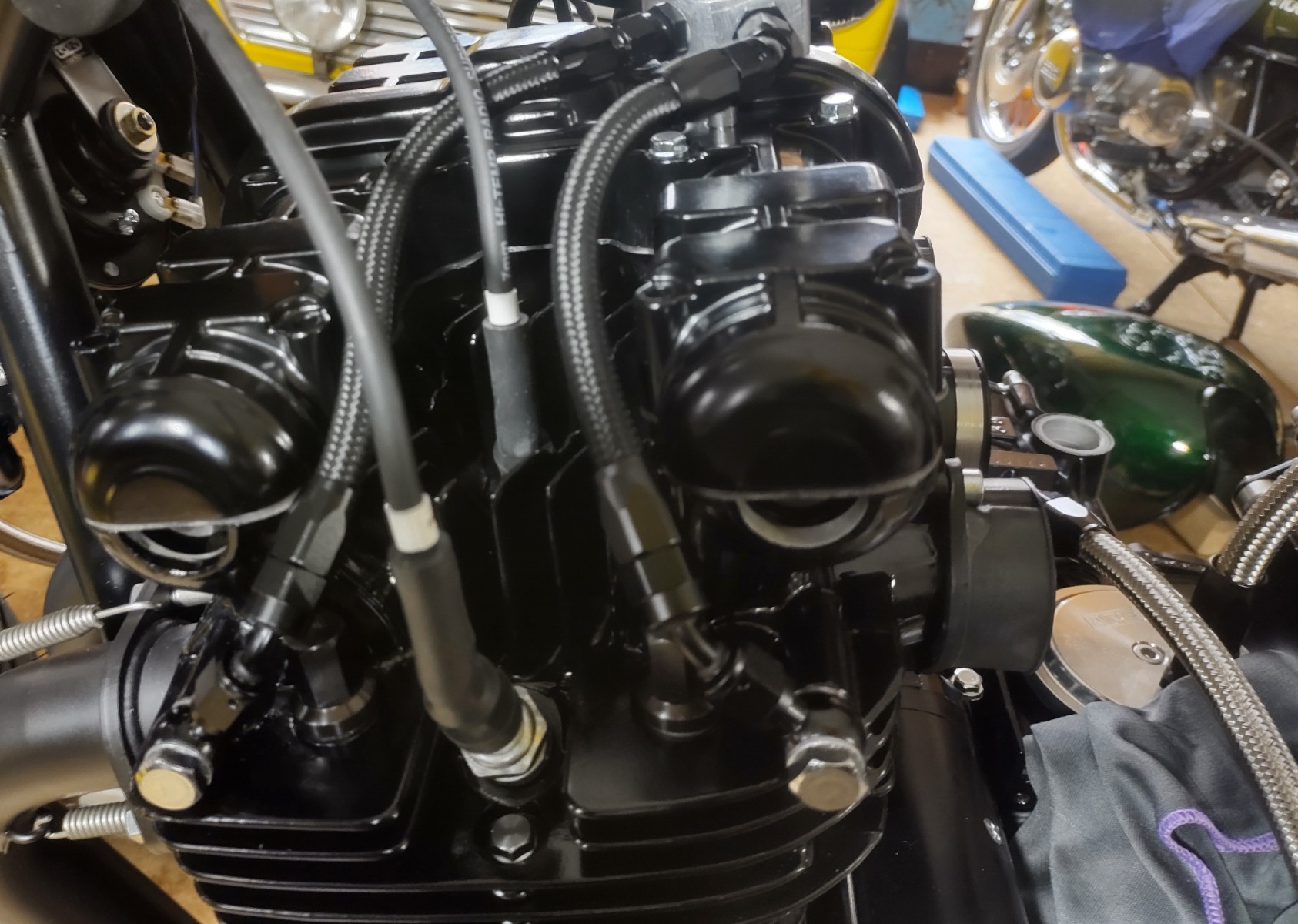

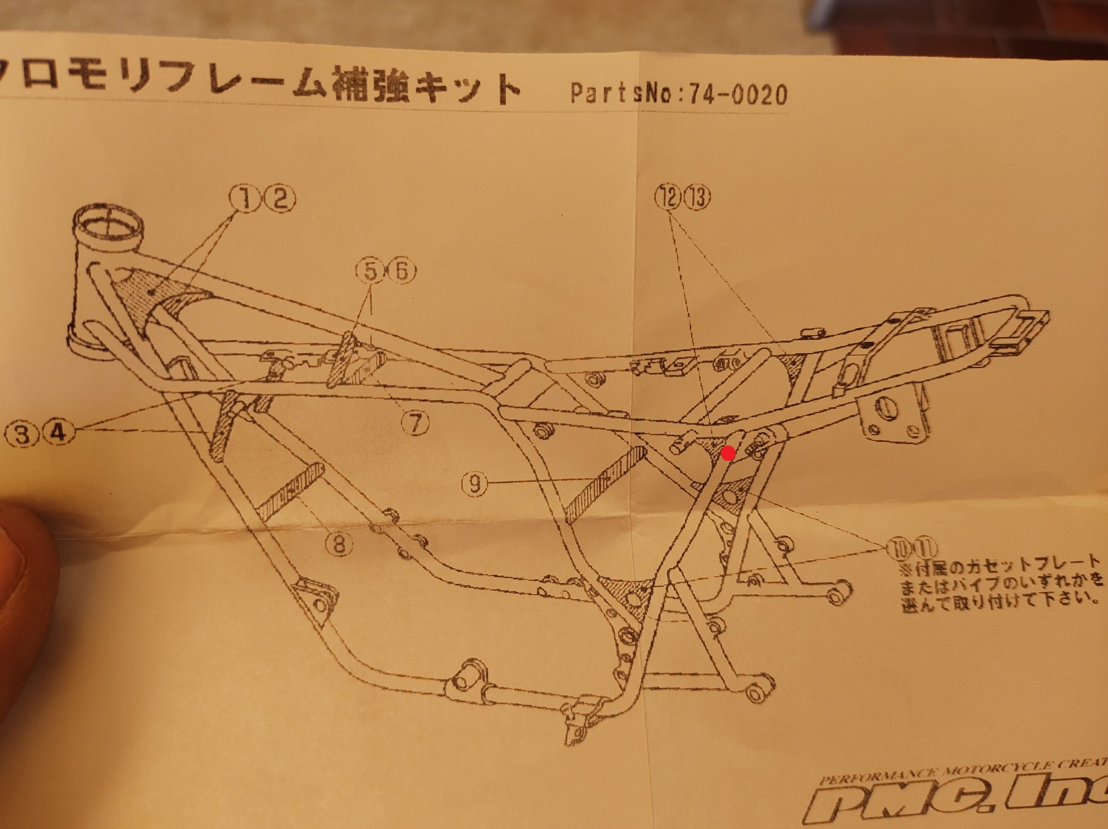

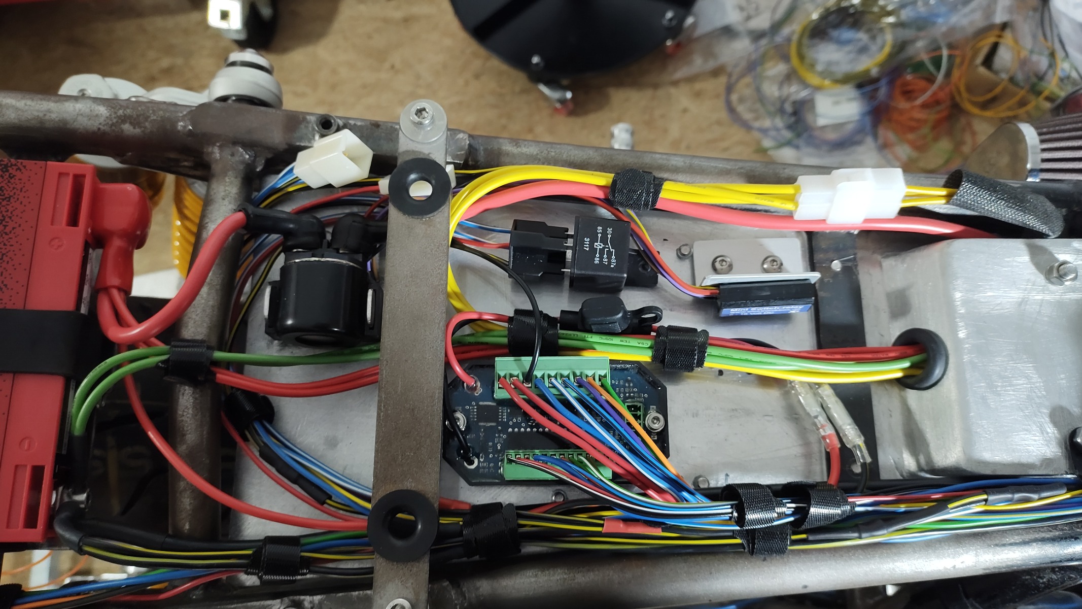

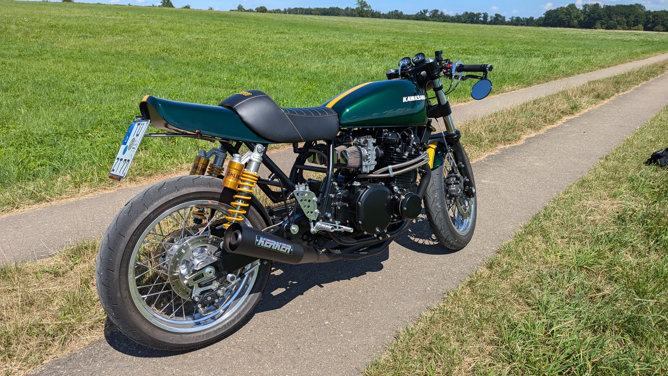

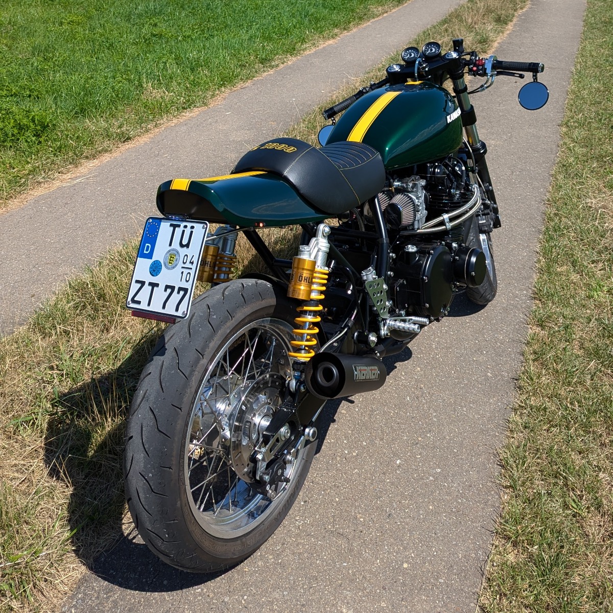

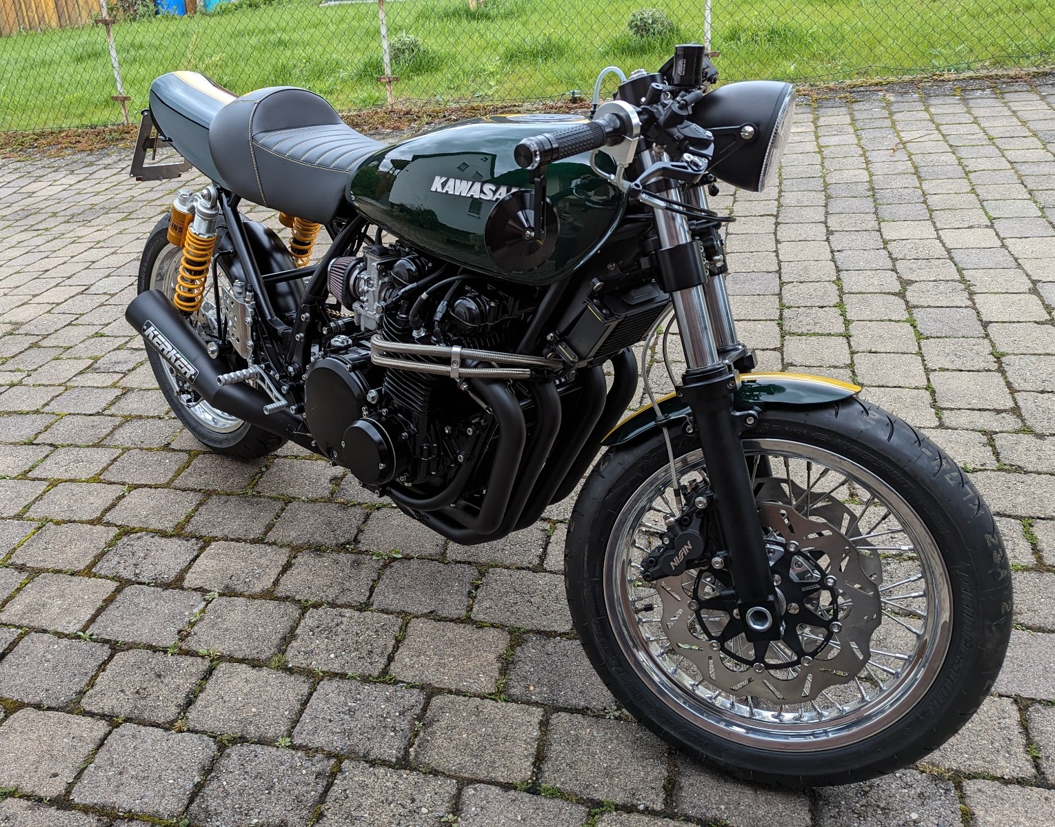

So for November we are back in Germany for another stunning piece of work from Calum (remember the 750 in June) there seems to be no "let up" in the quality of work Calum produces (I love this bike)
1977 KZ1000 Restomod - KZRider Forum - KZRider, KZ, Z1 & Z Motorcycle Enthusiast's Forum I started this project with the idea of doing a one-off, no compromises build. The idea was to build this bike exactly as I wanted, regardless of the cost of the parts. In the end this meant that the project lasted three and a half years, but it was definitely worth it. I started off with a KZ1000A1, a second frame and a Z1R motor. The second frame had already been chopped so I wasn't ruining a piece of history. Once I had all the parts I needed to decide what to do with the motor and the geometry. A huge thanks goes out to the members here for all their help with this and a special mention to zed1015 and kzstreetfighter71 for the some very good advice on the motor and geometry respectively. In the end I went with 18" wheels front and rear, a ZRX1100 front end and a 1991 GSX-R750 swingarm. The motor has a Wössner 1075 kit, Yoshimura stage 1 cams and Mikuni RS34's. That put out about 85hp at the rear wheel on a very easy-going dyno run with the initial setup on a freshly built motor (cams advanced about 1-2° and the carbs just chucked on the bike as they came). There is still a bit of tweeking to be done on the carbs and the suspension but thanks to kzrider I have ended up with a bike that is lots of fun to ride and looks alright as well.

Wow!! I'm a sucker for the kz1000s and this one is an absolute beauty!! Talk about detail. I love it

Not passed by; I've just been sitting in stunned silence all this time
It's a real emotional rollercoaster when you see somebody else execute the image you've had in your head better than you did yourself. This machine is just stunning. Well done.
BTW, how much fiddling was required to make that swing arm work?

Thanks guys, it was a lot of work over a long time (more than a couple of things were done more than once...) but I'm pretty happy with how it turned out.
@Buzz: The swingarm wasn't much work for me - there are some guys here that have adapted a load of gixxer 750 swingarms for the old Z's and they did the work for me
Basically the central shock mount needed to be milled off and the mounts for the stereo shocks welded on (I think they come ready made from PMC or Sanctuary). The front tube had to be milled down to fit in the frame and the bushings for the needle bearings and axle are slightly thicker (I think the swingarm axle on the gixxer was 20mm and the KZ's only 16mm?). Not really too much work if you have a decent mill and can weld aluminium - it's a no from me on both of those...
I also ended up getting another guy that lives close by and makes swingarms for old bikes (K & J) to weld on a couple of brackets for the chain guard.
The work that I put into it was just getting the wheel centered and the chain lined up. The swingarm is assymetrical so getting the wheel in the middle took a bit of messing around. The rear hub is custom made and the offset from the center to the sproket carrier was quite a bit off spec so that didn't make it much easier.
