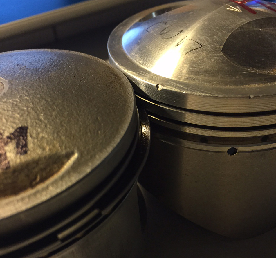

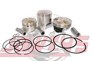

Below is a stock KL250 piston (with rings) and a Wiseco 1075cc 72mm piston. With a standard 17mm pin pushed through both pistons, you can see the Wiseco is about .025"-.035" taller then the KL250,
That means it will go into the combustion chamber further and it not be at flat deck height in a stock block.
Not sure what that means or how it connects with what your talking about ... but there you go...

My camera won't work without full batteries. I'll put up pics as soon as I cam. We're talking about 8mm here.

Yikes, that is 5/16".....

Now that's about as low in the cylinder the stock 1015 pistons are. Not 8mm.

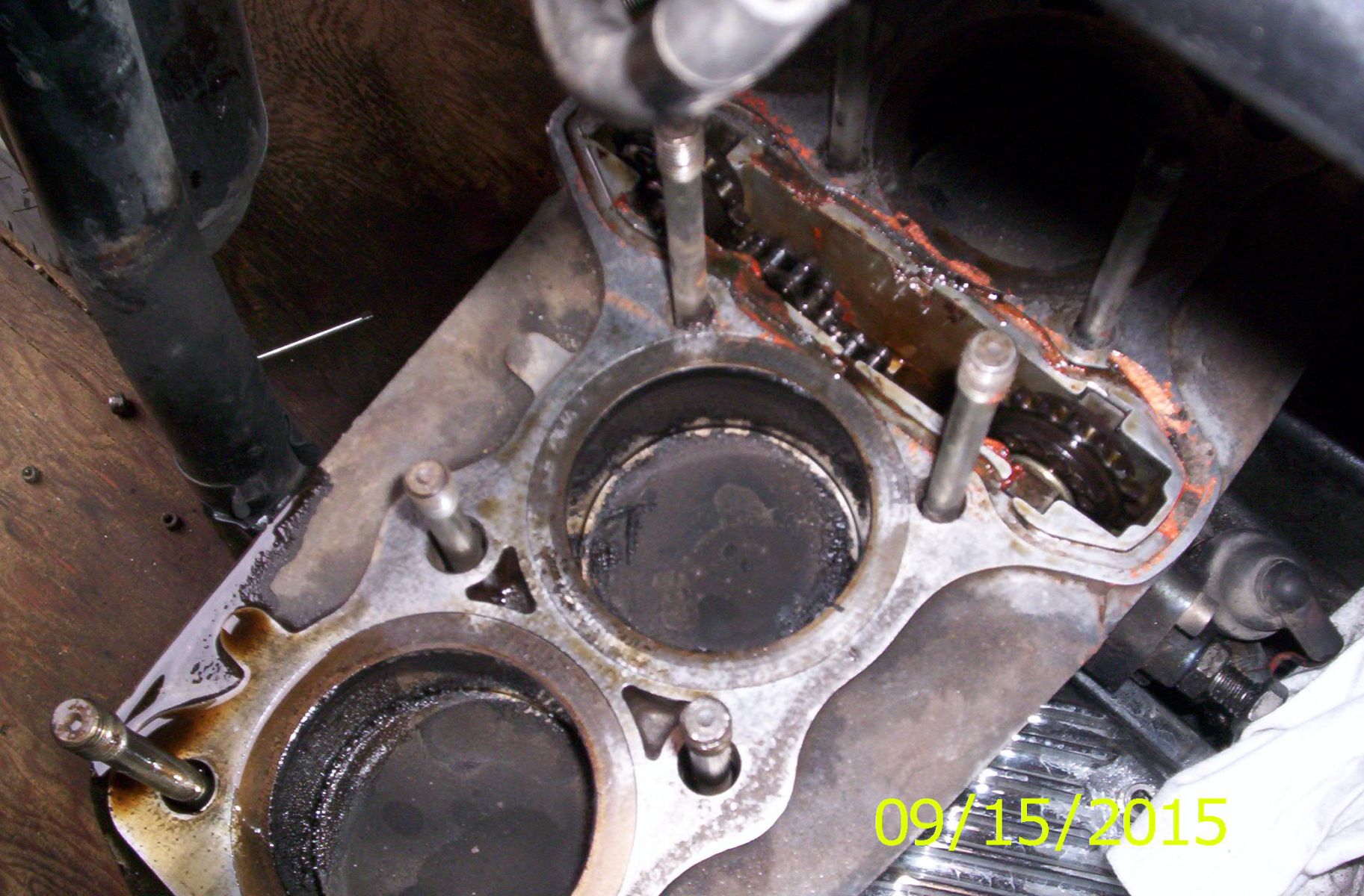

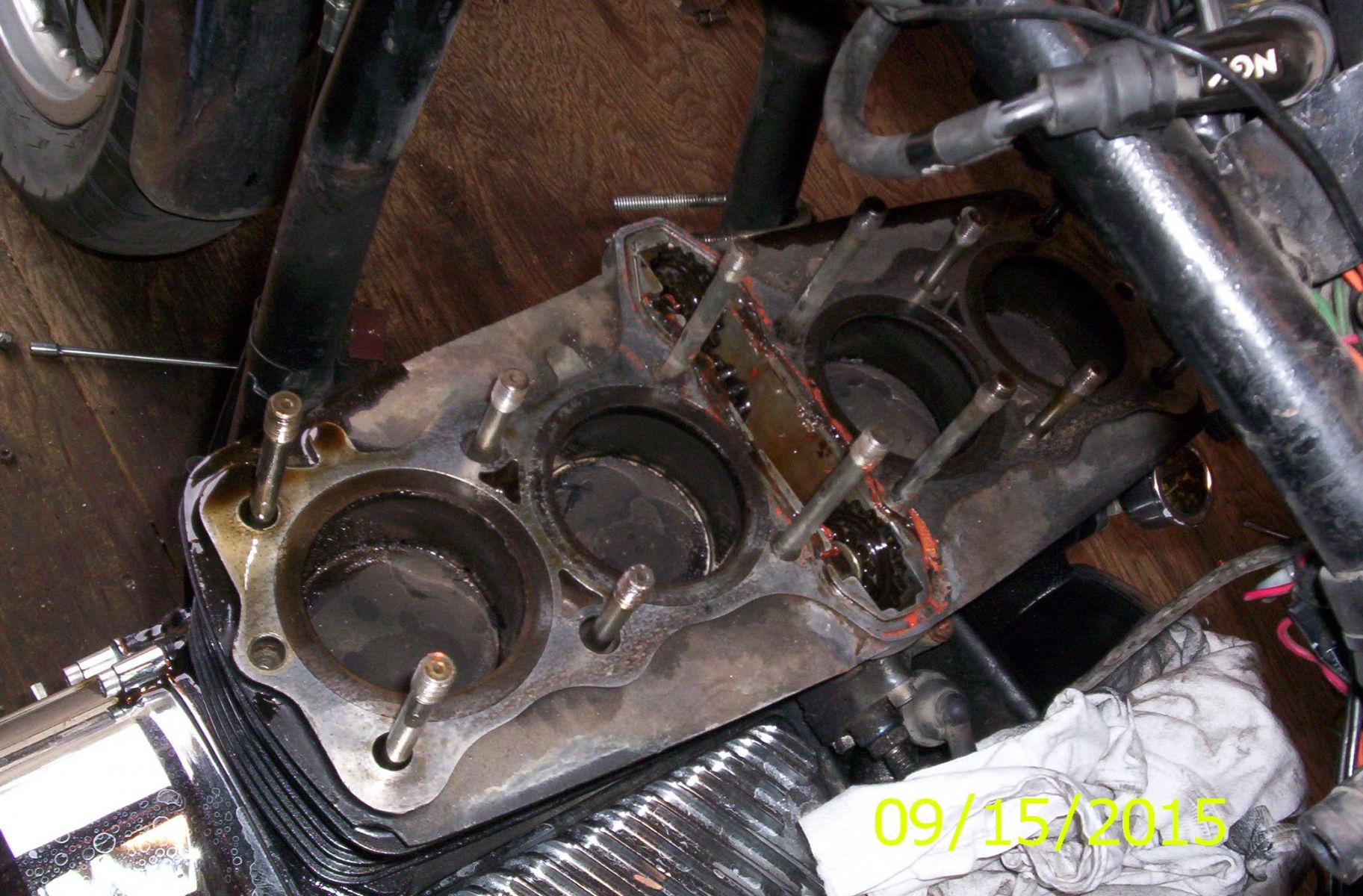

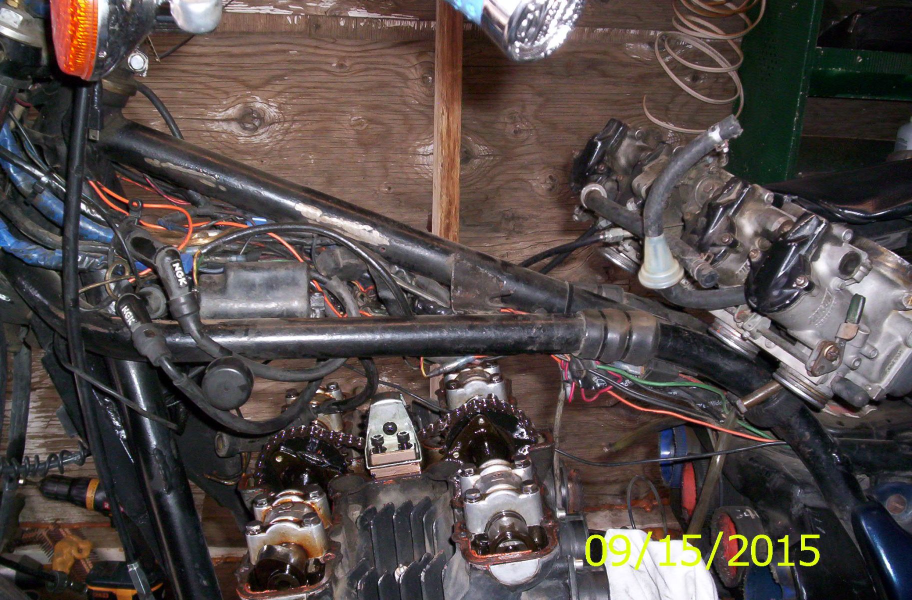

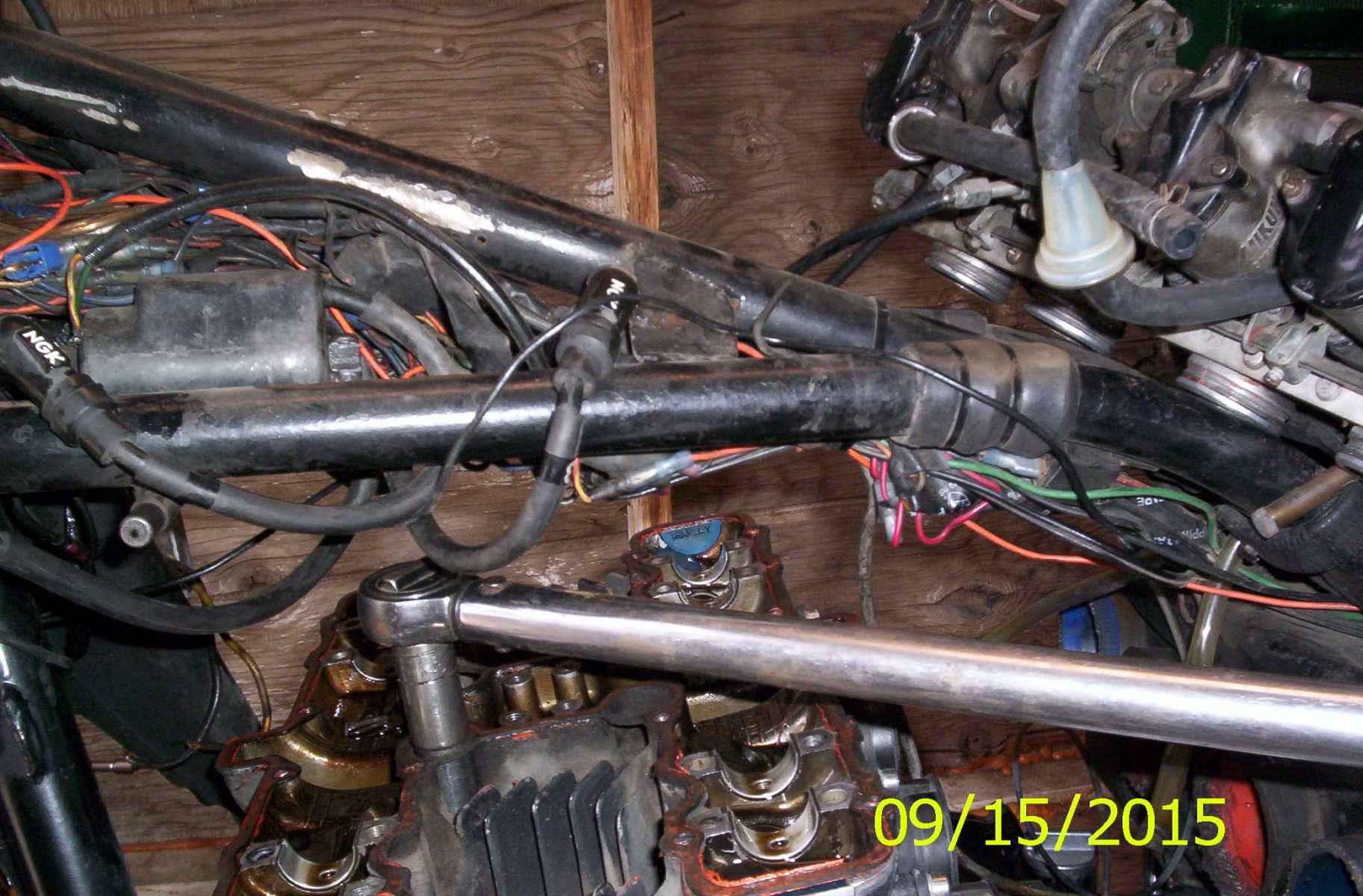

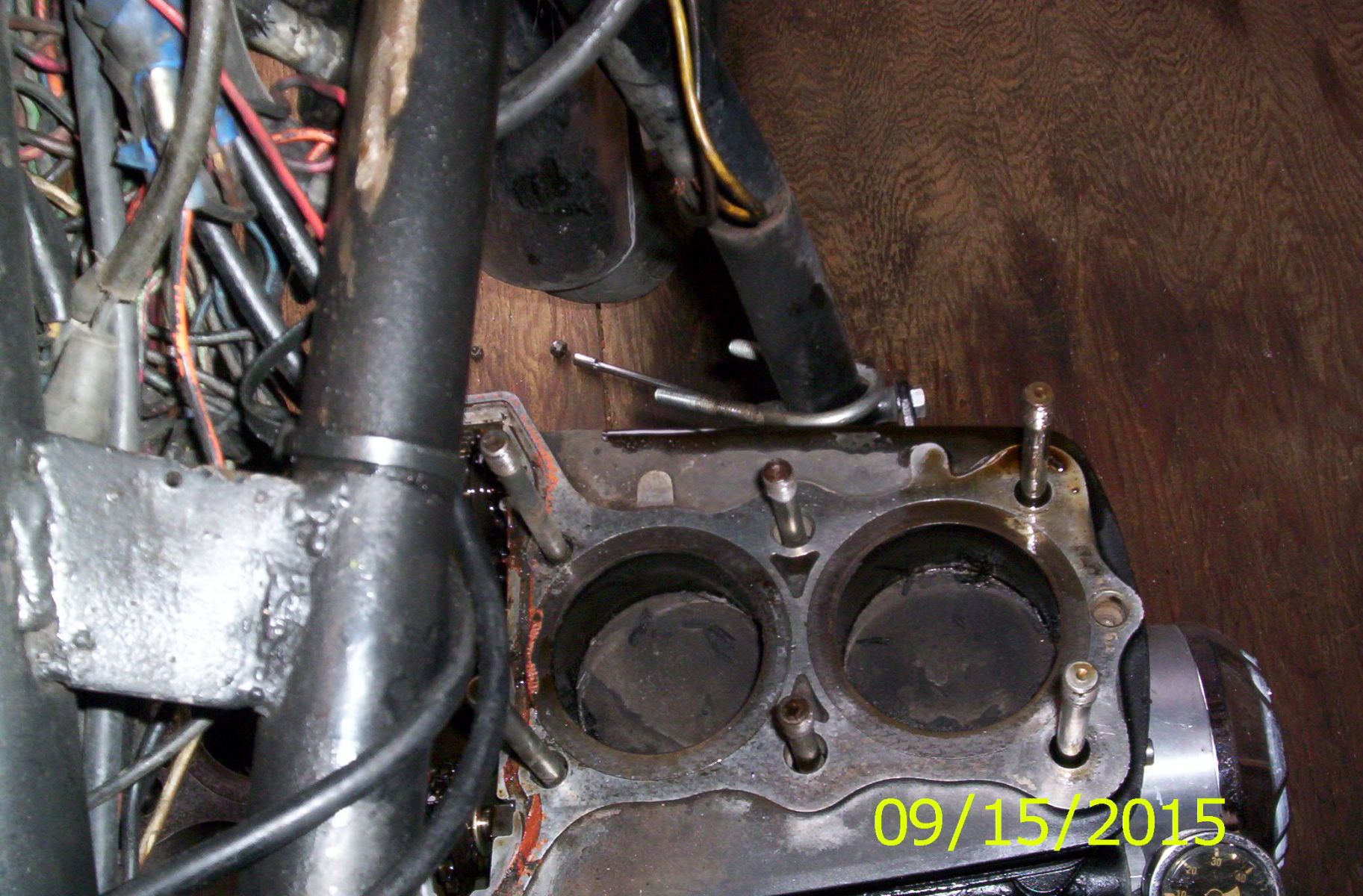

The weather will be cooler this week, I have what I need and time, I have no excuse not to do it. Everything looks good going in.
I knew reusing the rings would be iffey and it was burning a small amount of oil. Not bad after two years. The stock 1015-8.5/1 pistons are pretty clean comparitivly. #2 was burning the most oil as seen by the clean ring around the outside top of the piston. Time to stop, take a break, then go out and measure the deck height.
I know I was running low compression. Now we'll see why. Some light scuffing on the bores. Probably missed crap from when I did my valves.
I'm going to take pics of the caliper, then the crank rods and whatever marking on the crank throws.
