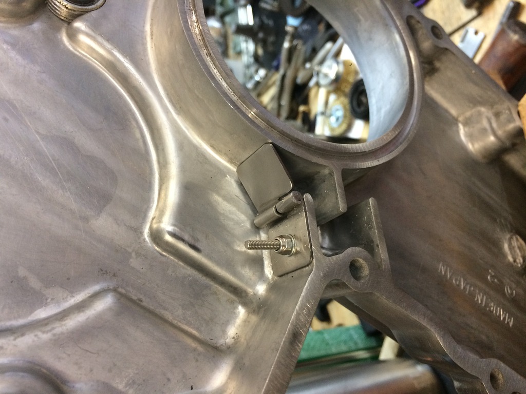

I changed the title. A better one anyway. I've learned a lot about these cranks the hard way. Seems like that's the only way I do sometimes.:blush: Anyway, it's been a fun ride even with low compression. Goes to show how durable and quick these machines can be.:woohoo:
While getting ready for the teardown I picked up some hinges for my oil pan gate. I like this idea the best.
I'm behind schedule a little but hope to start on it Monday or Tuesday. That is unless a paying job comes up. While the engine is out, I plan on putting in some gussets I couldn't get to with it in the frame.
We'll see how it goes.:whistle:

11 Mar 2017 17:45SWest wrote: I changed the title. A better one anyway. I've learned a lot about these cranks the hard way. Seems like that's the only way I do sometimes.:blush: Anyway, it's been a fun ride even with low compression. Goes to show how durable and quick these machines can be.:woohoo:
I have to wonder if the gate will open to far as is and not reliable close on hard acceleration :S

11 Mar 2017 18:13
Working on that. If the hinge is turned the other way, it can only open to a little over 90*. With that one a stop could be made to keep it from opening too much.
