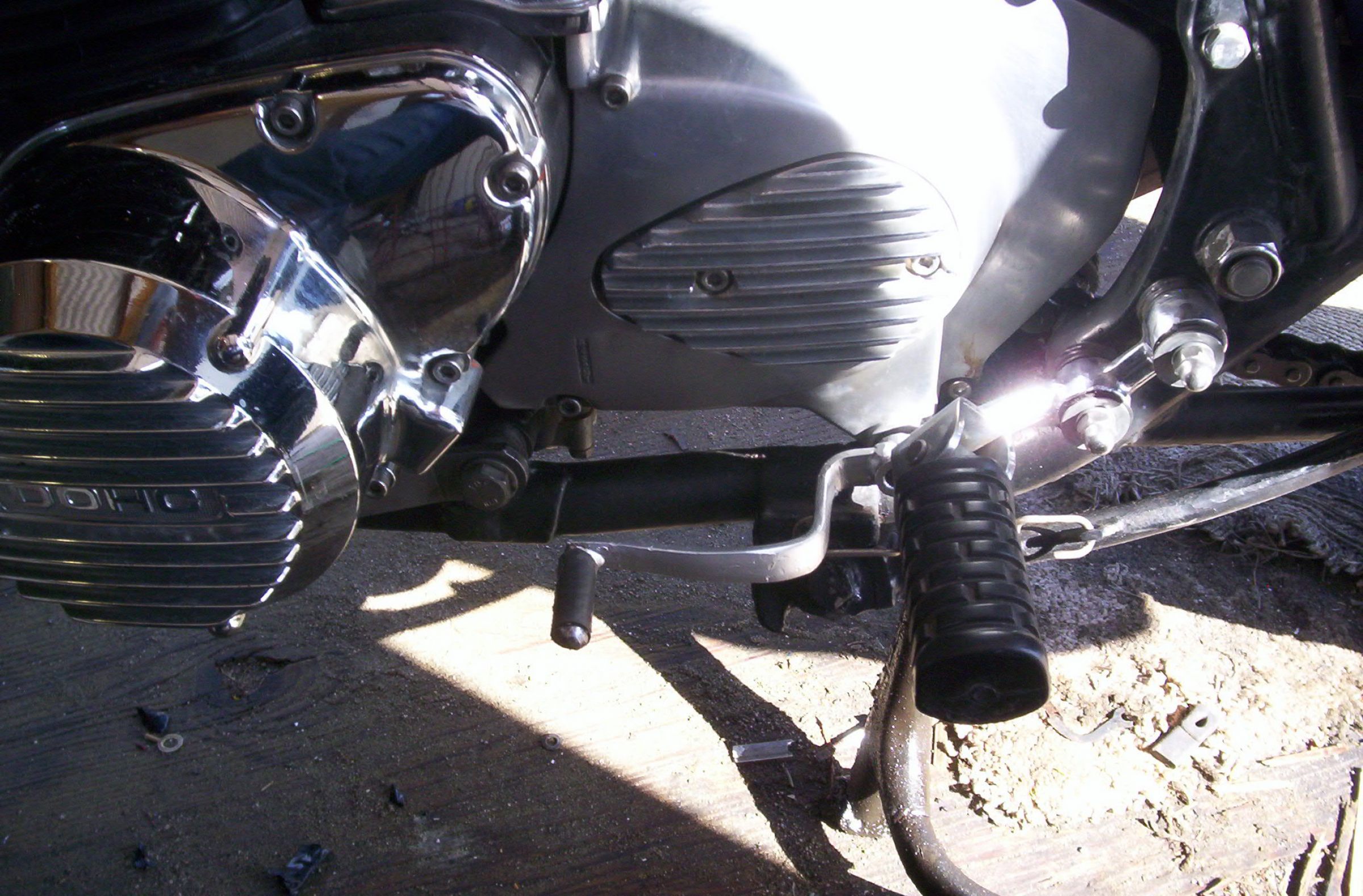

Got my mis shift problem solved. Had a 350 Honda shift lever laying around, looked like hell but I bent it a little more, now I don't heve to move my foot down for each shift. Squirted a little paint on it. I'll get a new rubber for it too.

Re: Z2 750 crank (Bossie the Kaw)
16 Mar 2016 19:44
Nice ....know what you are saying . I have to have my heal on the peg in order to get good leverage on the shifter.
