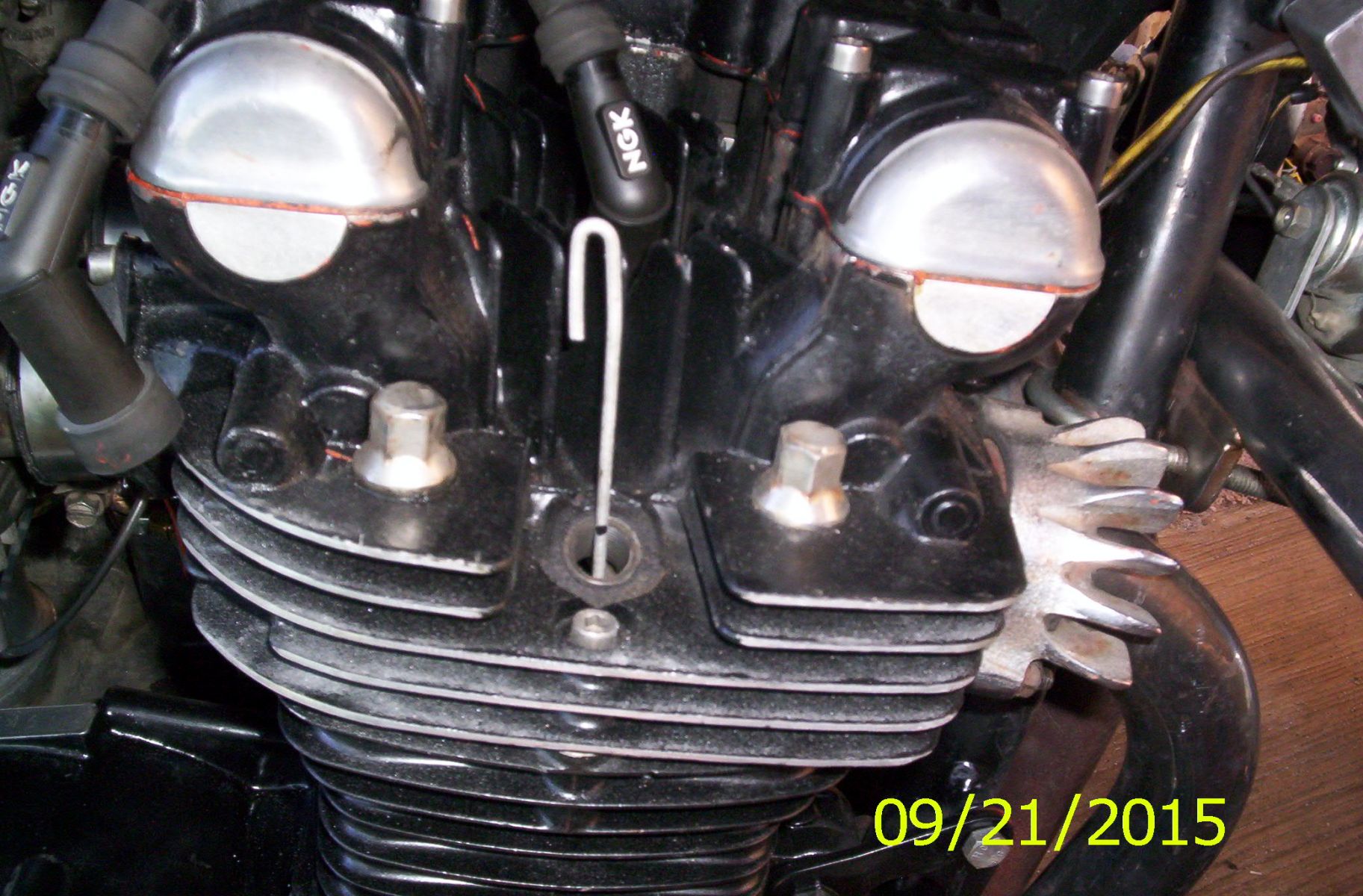

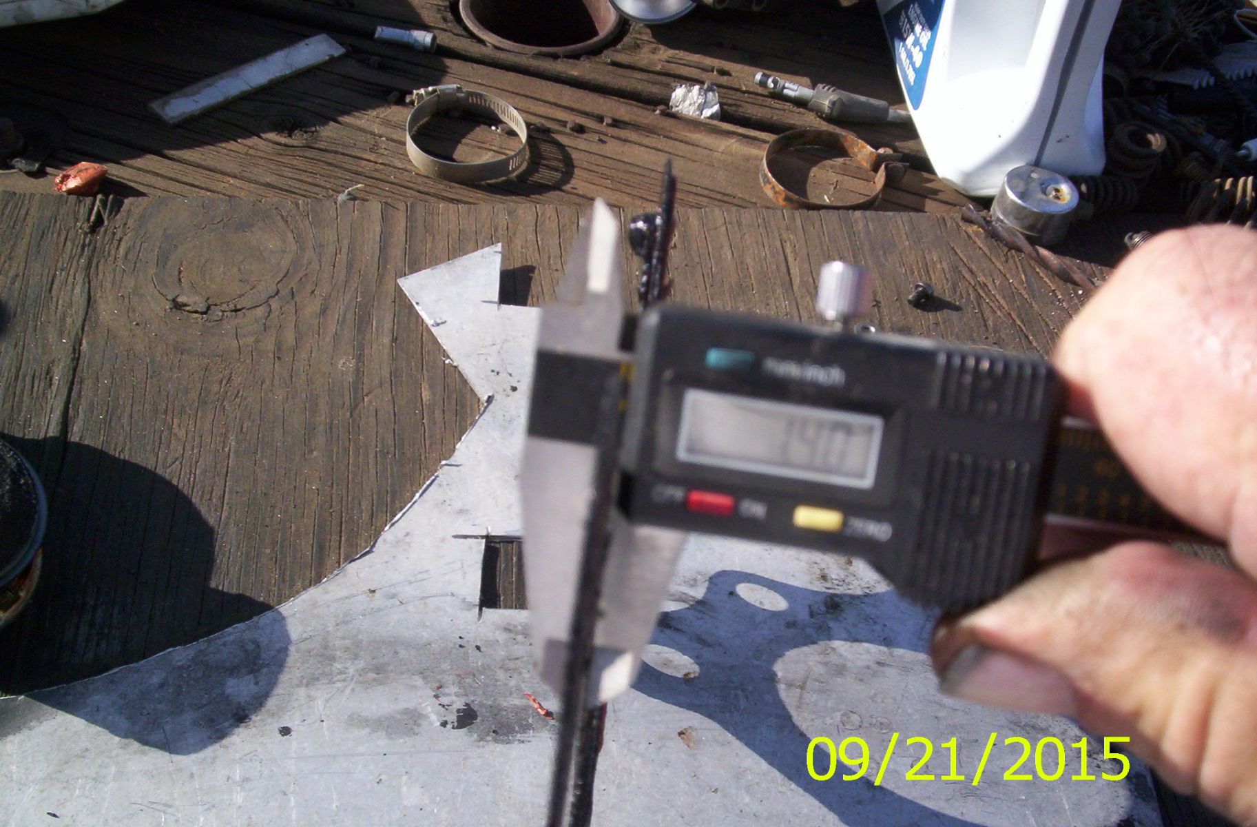

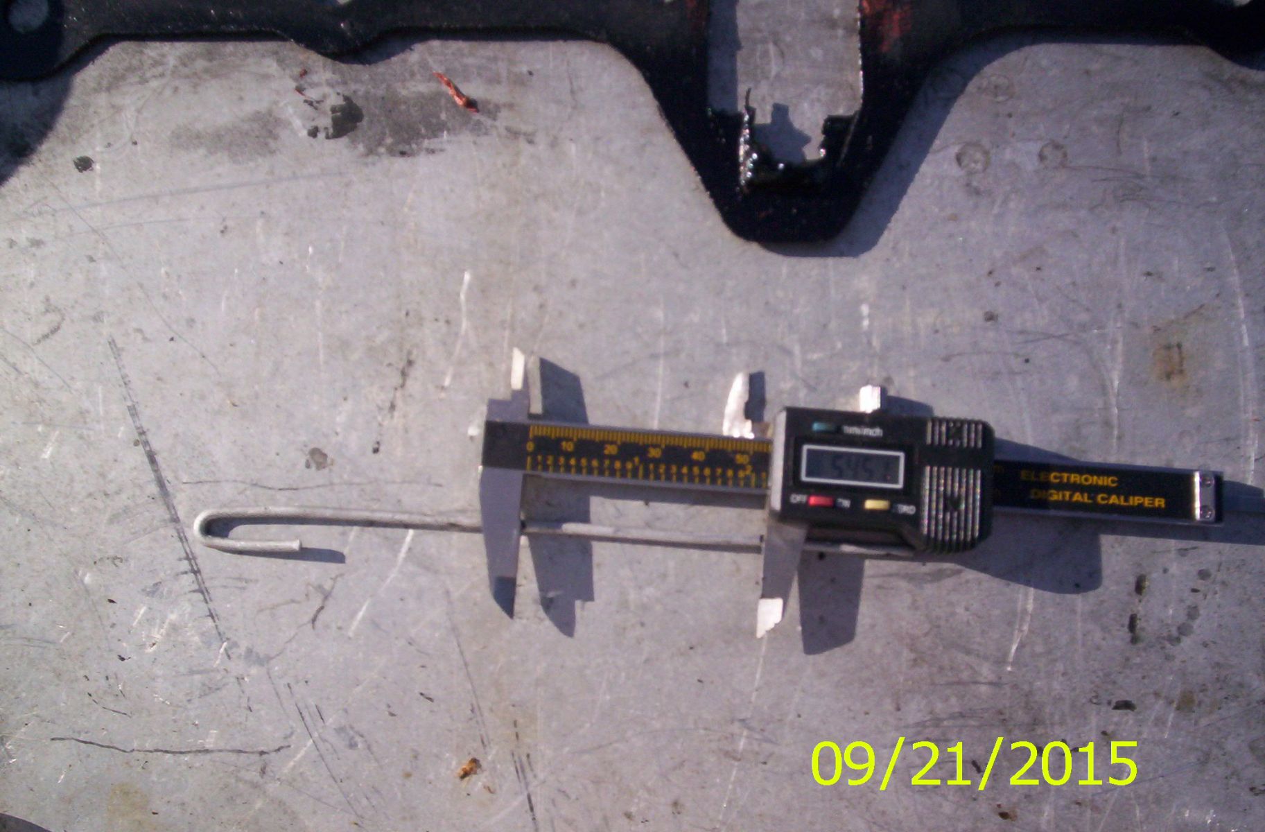

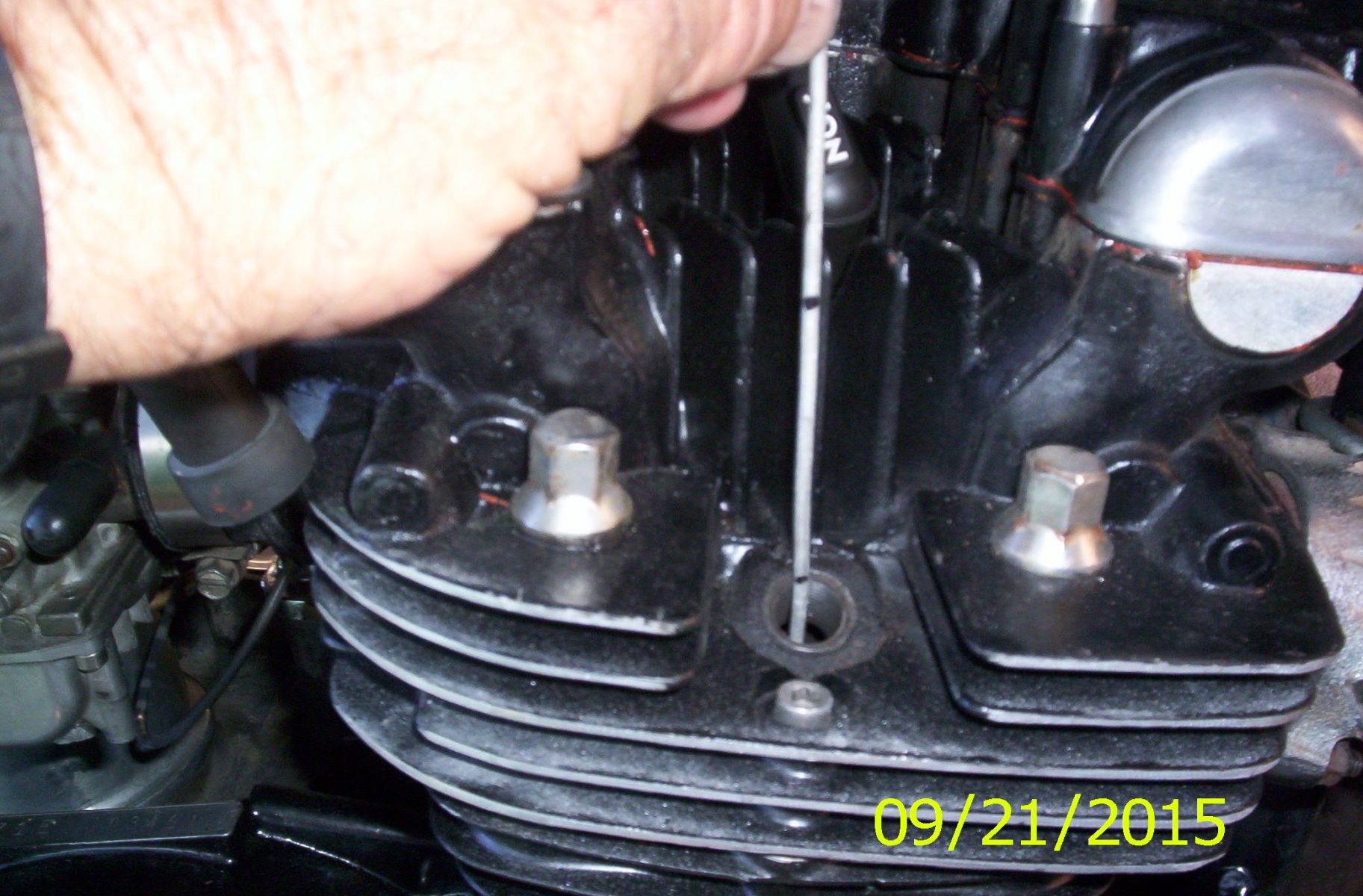

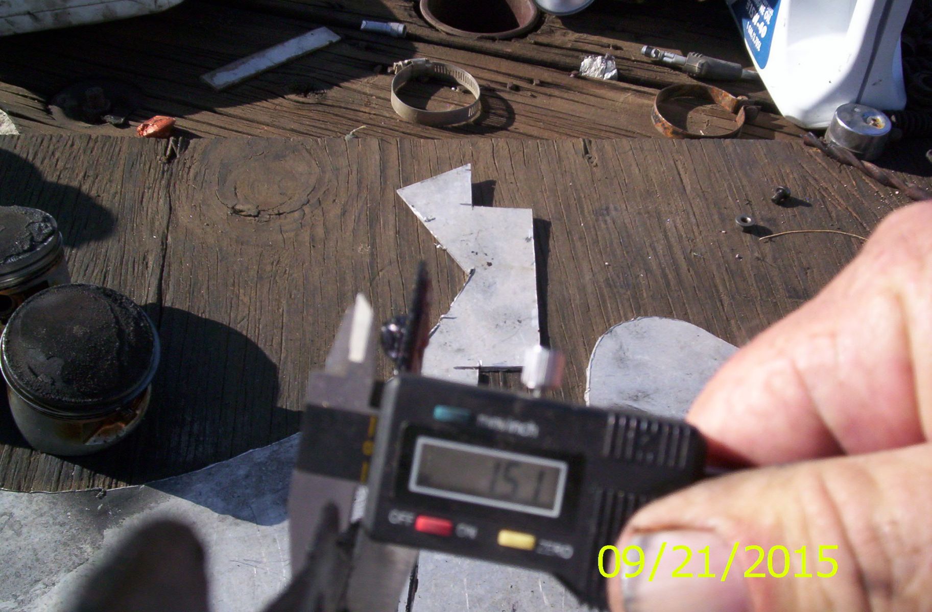

Ok, I'll do my valves this evening. Here it is. My last reading is 54.50. I took multiple pics because the measurements changed slightly.
TDC
BDC
54.51mm
Old gasket
Another pic of depth.
I'm now sure it IS a 750 crank. 54.51 - 1.40= 53.11.
