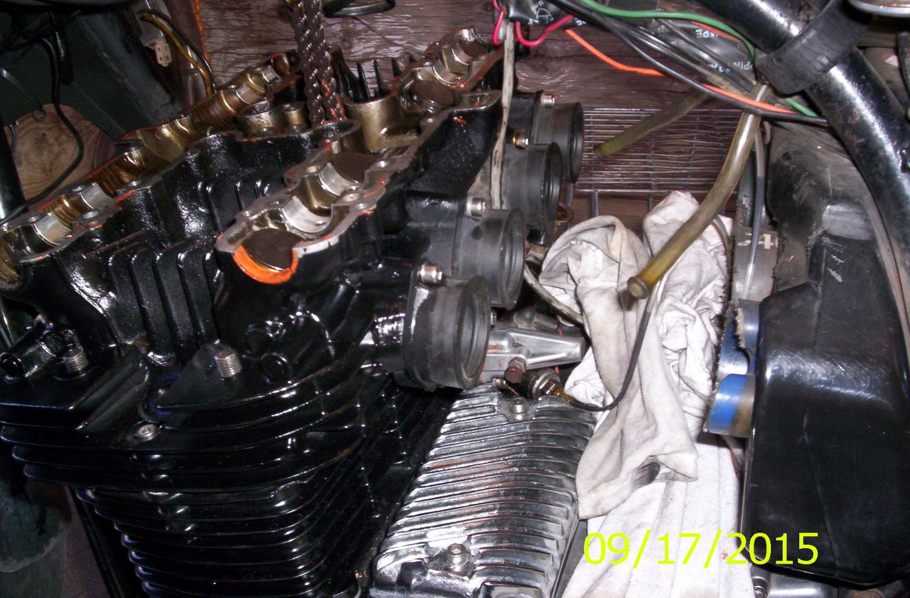

Buttoning her up.
Couple marks at the top I can't get out. I have no idea what caused them.
Bad idea. Got stuck in the bores. Had to get them out and use the clamps alone.
I was so pissed, I forgot to show the deck height. It was even.
Tired of the end caps leaking. Was going to turn them around so the blue would show but they were discolored over time in the head. Had Manly stamped on them. I don't like advertising for someone else I don't know.
Had two tight valves. Had to use the 205 shim but the 235 I had on the intake needed a 220 and I have .002 clearance. Time for more shims. You can see the bat wing sticking out.
Going back together.
I wanted to take more time on this but my truck wouldn't start. The battery took a dump. It always happens when the weather changes. I'll dial it in tomorrow.

No, they have a cap under the mains like the early Z1's. Easy to switch jets but no overflows. The ring compressors would've worked if I didn't have as much sticking over the top. Next time I won't. The 903 bored didn't have a taper on the bottom, so getting the rings in I had to use beer can metal to take up that 1mm space between the clamp screw area. With these stock 1015 bores it got caught in the taper.
