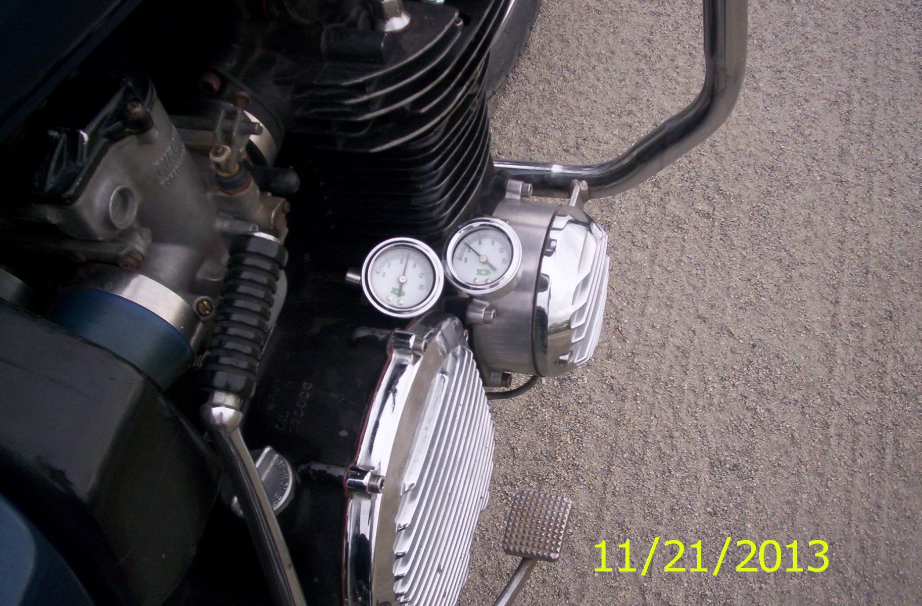

Getting past the heads is the problem. Your point is well taken. The bits should be ground to fit the screws snugly. I kept my old screws for 40 years until they looked so bad, something had to be done. Rather than buying new ones, I bought SS Allens. End of problem. No longer vintage and my bike isn't bone stock anyway. I like the fact one socket will work on all my fasteners in case of trouble. I carry a small tool box on my 40 year old machine.
The old screws looked horrible. The top pic shows the blown gauges but the Allens are visible. Better?

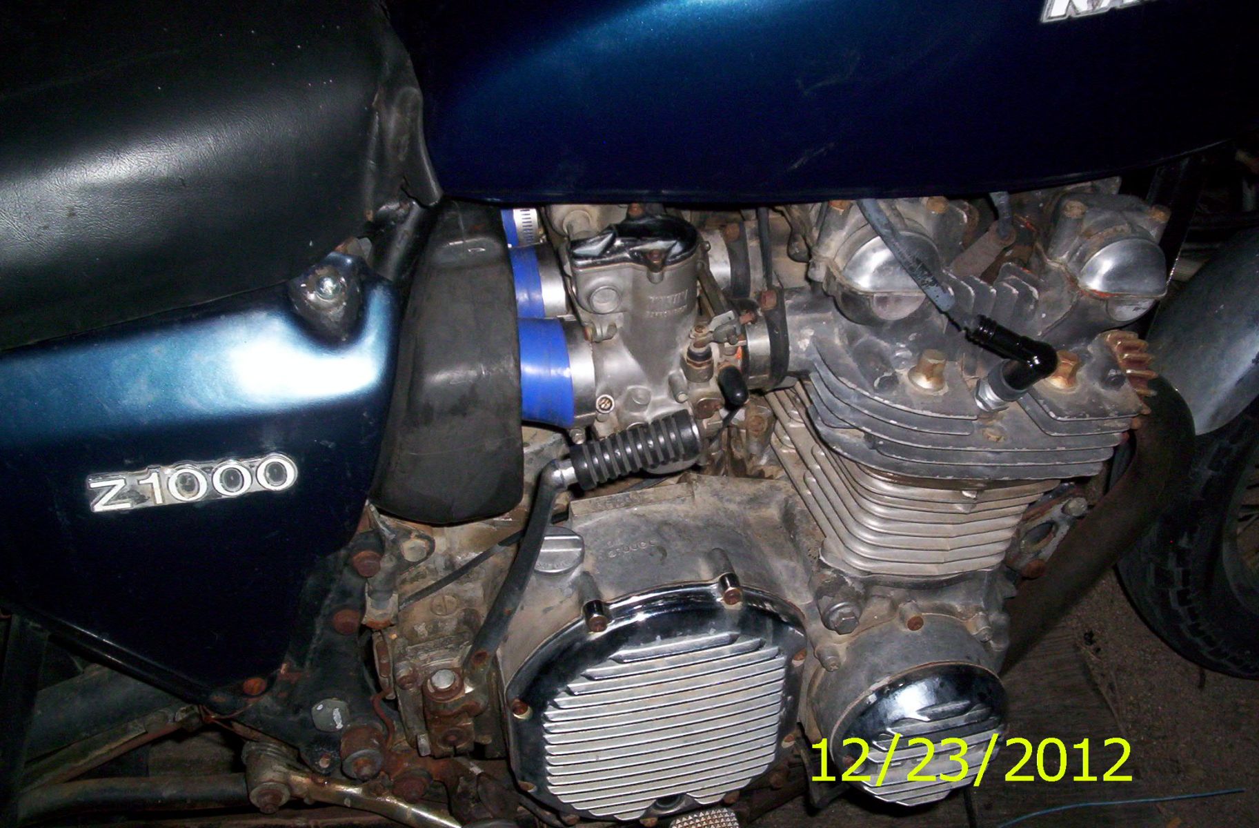

Back to the question; cost? More time than money. Polishing is a pain in the "arse" but worth it. Doesn't cost much of anything and when those deliveries come, it's like Christmas. I just wish I had thought to take a pic of Bossie sitting under the tree three years ago. My young neighbor didn't think she would ever run again. Should have seen their faces when I put in a new battery and did a burn out in front of his house. Looked like crap but she wanted to GO. That's when I decided to go through her from stem to stern, top to bottom.
