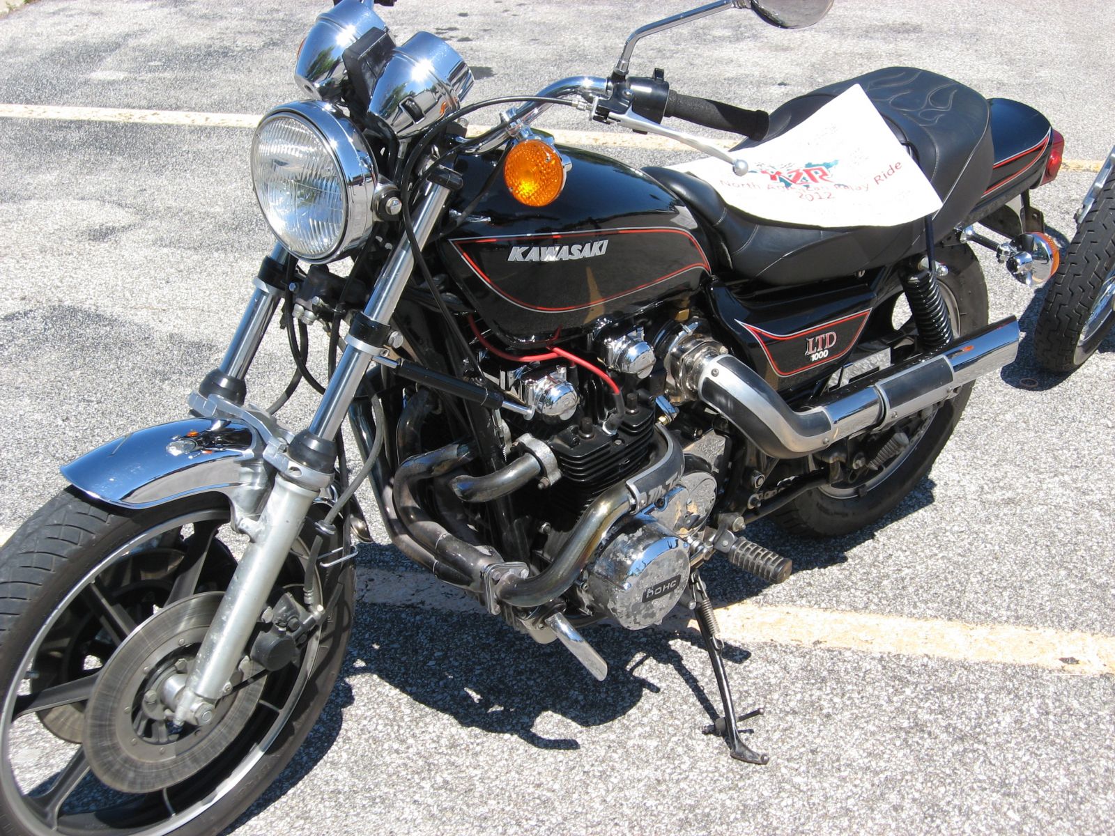

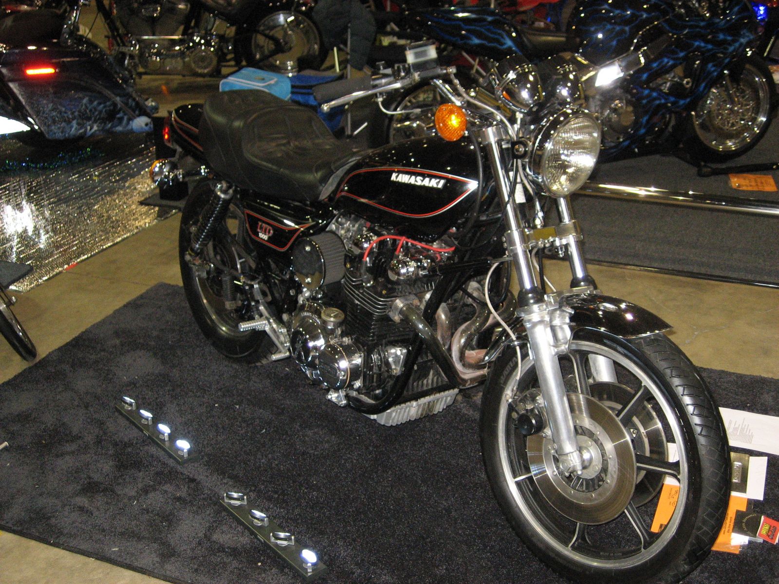

24 Mar 2014 23:18thanks for the flicks. Les had mentioned having the splitter in a triple tree on another forum. i was hoping yours might be such the case. very clean.

25 Mar 2014 06:10Thanks
Please forgive the water spots. It was snowing when we loaded up after the show

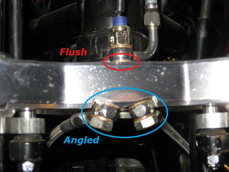

25 Mar 2014 07:37 - 25 Mar 2014 07:39Innovative -- sanitary -- handsome!
Am curious as to the reason(s) for attaching the lower banjo fittings at an angle instead of flush like the upper fitting.

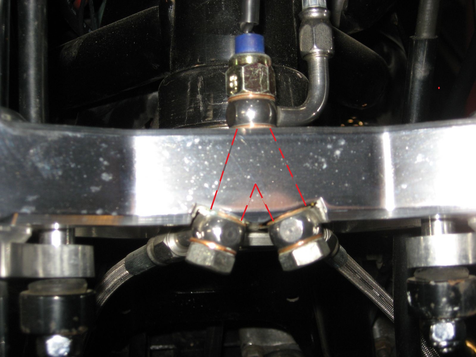

25 Mar 2014 08:14
Essentially a Y fitting, lower ones pointed at the upper so they intersect. I've used this for low offset trees and upside down conversions. Pretty slick really

Re: Turbo Rules the day, Thanks Les !!
25 Mar 2014 08:16 - 26 Mar 2014 05:59
didn't realize les had posted :whistle:.
pattons picture explains it well.
25 Mar 2014 08:45
see patton !
you savvy
26 Mar 2014 18:52
nice job on the trophies. I love the splitter for the brake lines. I see you are running Les' rear sets also nice touch!
I'm curious Les, why do the bottom banjos have to be angled? I understand the the "Y" concept but would it not function the same with the bores drilled at an angle and the banjos flush? Just curious.
