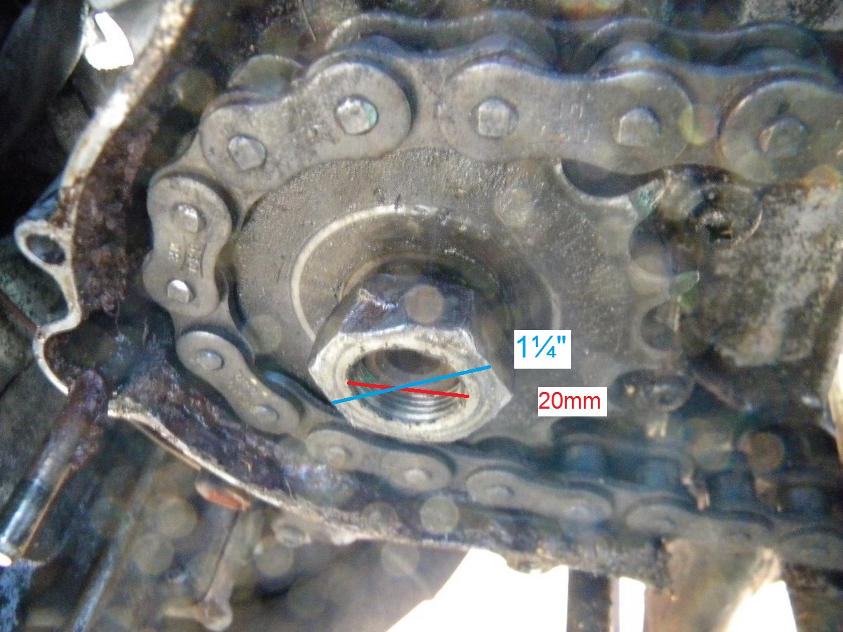

27 mm socket? kz900 front sprocket nut????

10 Jun 2013 20:40MFolks wrote: When you get ready to replace the engine sprocket, please remove the grunge from chain lube and who knows what in front of the sprocket. While you're in there, wipe down the clutch push rod with paint thinner. I hope the push rod seal is still good......
Glad you said that!!! Thats the first thing that came to mind when I saw the picture for the first time.
A pan with some Safety-Kleen solvent and a good brush would do wonders on cleaning up that mess!!!

No eBay APP ID and/or Cert ID defined in Kunena configurationGet this lug nut tool set and always have the right socket. I've had these for 10 or 15yrs and never found a large lugnut type nut this 9pc kit does not cover. I see not great reviews here and there, but I've used these a lot and been real happy with them.

10 Jun 2013 23:56trianglelaguna wrote: ...front sprocket nut...is 1 1/4" by7 my tape....

Per Kawasaki.com --
NUT, 20MM, Part No. 92016-043 "Cancelled"
Used on 15 Kawasaki models:

NUT 20MM, Part No. 92016-028 "Active"
Used on 135 Kawaski models:

your are kidding right...i will not wash the area off with gas and a putty knife and rags and brush all the knooks and cranny's with gas and a throw away brush and clean the push rod off and carefully install it...i will not....never crossed my mind to clean that half inch of gravel and chain lube out of there...should I???

yes indeed that helps..i'm on my way to get bend tab washer and nut in the morning....thanks that should help the 17 yr old at the counter find me a nut
Patton wrote: Per Kawasaki.com --

Don't see either part no listed at Z1E. :pinch:

the nut is what I said it is 1 1/4 ...where it came from? what bike he robbed it off???and when i get the time i'll post a pic of the f'ng thing with a tape/calipers on it to lift my tarnished name back up into the throne it belongs on around here.......oh and btw I can read a tape all by myseff
Patton wrote:trianglelaguna wrote: ...front sprocket nut...is 1 1/4" by7 my tape....Perhaps when measured between opposite points instead of measuring between opposite flats.

I will not clean that goo farm off there,that is my retirement grease...I am glad you guys are all perfect...and I will not shower...I will not clean the dog shit from the yard...I will not even flush...that goo and gravel must be there for a reason!!!
Dr. Gamma wrote:MFolks wrote: When you get ready to replace the engine sprocket, please remove the grunge from chain lube and who knows what in front of the sprocket. While you're in there, wipe down the clutch push rod with paint thinner. I hope the push rod seal is still good......

According to the seller's listing, this set includes: sae sizes 3/4" (light green), 13/16" (purple), 7/8" (green), 15/16" (brown), 1" (silver), 1-1/16" (black) and metric sizes 17mm (blue), 19mm (yellow) and 21mm (red).
From the set, 1 1/16" socket -- which equates to 1.0625" or 26.9875mm -- is fitting the stock 27mm nut .
Not in the set, a 1 3/16" socket -- which equates to 1.1875" or 30.1625mm -- may fit the stock 30mm nut.
RonKZ650 wrote: Get this lug nut tool set and always have the right socket. I've had these for 10 or 15yrs and never found a large lugnut type nut this 9pc kit does not cover. I see not great reviews here and there, but I've used these a lot and been real happy with them.

Whatever its original source, the apparently "over-size" 20mm (inside diameter) nut at hand appears deep enough to contain unused thread in this particular application.
Perhaps some automotive lug-nut?
