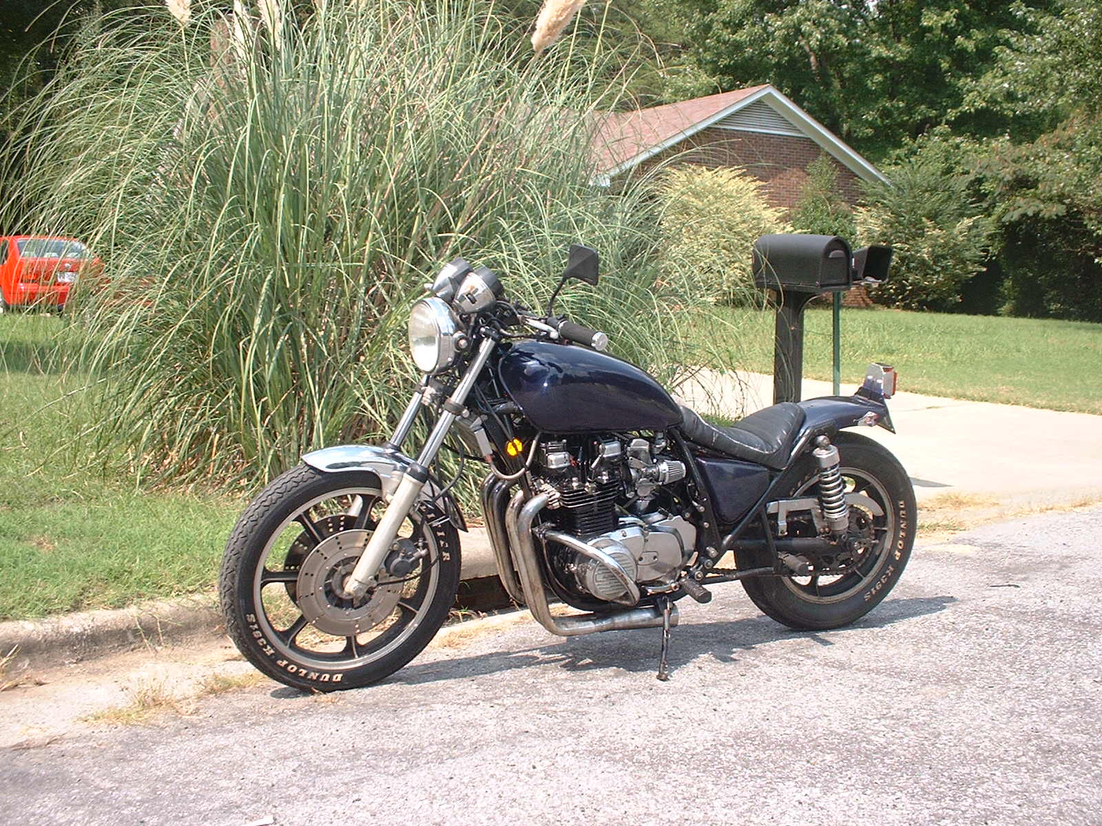

02 Jun 2013 22:46Attachments:

LTD had no relation to a MKII. The title may have had errors, but the bike in the picture there has a 1979 or later engine because of the emissions ports on top of the valve cover and may be a MKII engine in a 1978 LTD frame. Hard to say. 1977-1979 1000LTD used the older style KZ1000 engine. The MKII engine was used in the 79-80 KZ1000MKII, and the 79-80 shaft drive, but only in the 1980 LTD, as well as the 80 Z1R.
Don't mean to argue, but just the facts as they are. Normally titles have no mention of LTD, MKII or the like. They go by numbers. KZ1000B is LTD, KZ1000A is standard KZ1000, later turning to MKII, KZ1000E is the shaft drive, KZ1000D is Z1R.

Was a KZ1000B2 titled as a 78
. Thats the way I got it from PO .. Come to think of it ,it was titled by the engine number not frame and I remember when I replaced the head gasket and valve cover gasket I did have to get gaskets for a 79 engine. Maybe it was a late production model. NOW the big ??? Will the jugs and head from a 79 fit the cases of a 78 since the TITLE was on the case number.
This was not a stock engine, the first time I pulled the head I found COPPER gaskets with RC on them. I MIC.d the bore and it was 73mm=1075cc.
Just asking for more KZ knowledge!
HOGEATER(CHUCK)
