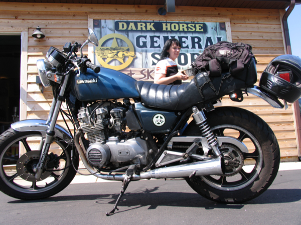

Heres my issue; I'm taking a long road trip on my (mostly) rebuilt kz550 ltd, 1982. I need to get some decently sized saddlebags, and the problem is that most of them I've found will flop into the rear wheel without some sort of saddlebag support, which I'm finding out is harder to come by than I thought for old KZ's..
SO, my question(s)..a. does anyone know where I can look to find such things?, and b. if I end up having to fabricate something, what should I be keeping in mind, in terms of where the brackets mount on the frame..any help, tips, leads, or advice would be great, and I'd also be willing to open up ye 'olde paypal for anyone thats got a set of em:)

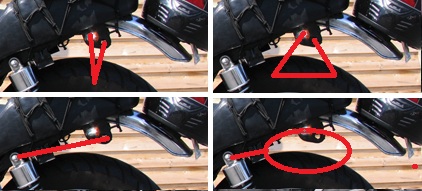

22 Jun 2012 16:34 - 22 Jun 2012 16:43nervousjay wrote: ...need to get some decently sized saddlebags, and the problem is that most of them I've found will flop into the rear wheel without some sort of saddlebag support...if I end up having to fabricate something, what should I be keeping in mind, in terms of where the brackets mount on the frame..

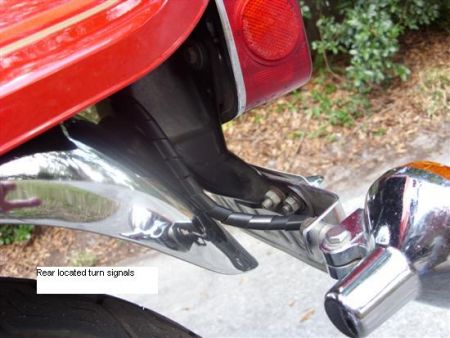

Am thinking the rear turn signals may interfere with fitment of soft saddlebags placed over the passenger seat.

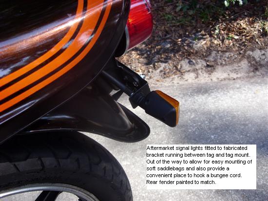

Could consider relocating the rear turn signals to a bracket fabbed to fit behind the license tag.
The added bracket provides handy additional locations for hooking bungee cords.

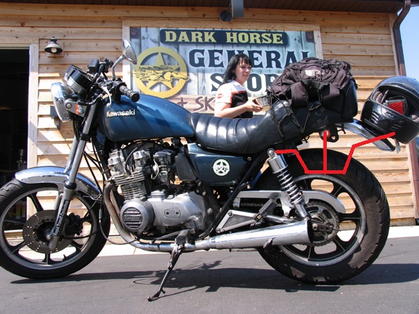

For the bike at hand, the added under-tag bracket might allow a bungee cord (or a more stable fixture) to run between it and the upper shock mount to serve as a stand-off. A metal stand-off could be designed and fabricated which might also incorporate attaching to the now unused holes where the turn signals mounted.
Just some possible ideas.
