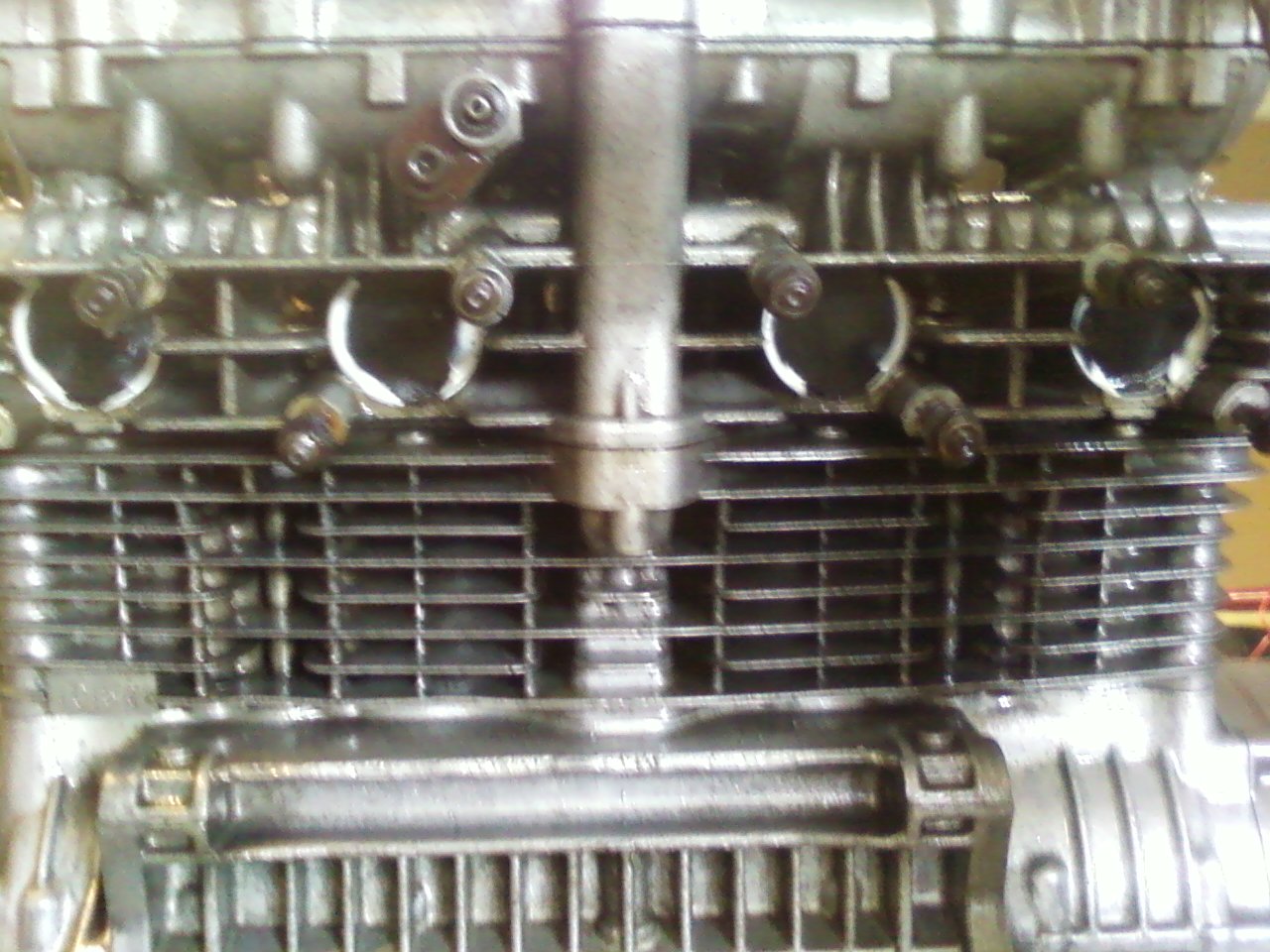

I was removing the valves from a head this morning and needed to remove the old cracked boots to get my tool in place. The boots had the original screws and you would know some of the phillips heads rounded out trying to remove them.
I took my cut off wheel and made a straight cut and got my impact out and gave them a good whack and moved on to the job at hand. I got new ends for my impact from Jeff @ Z1E.

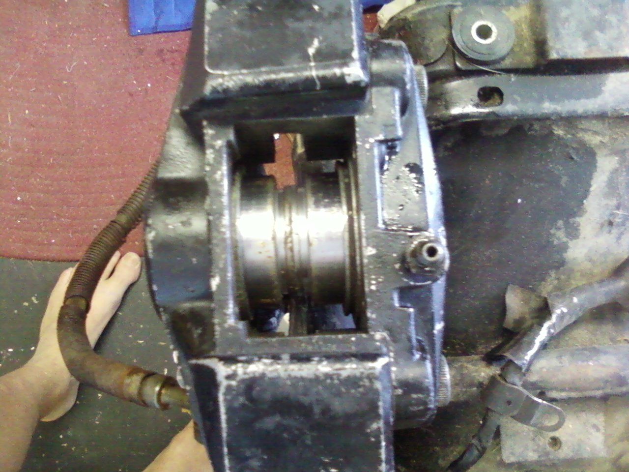

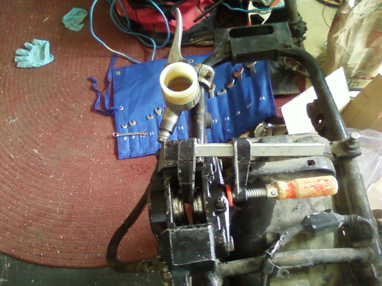

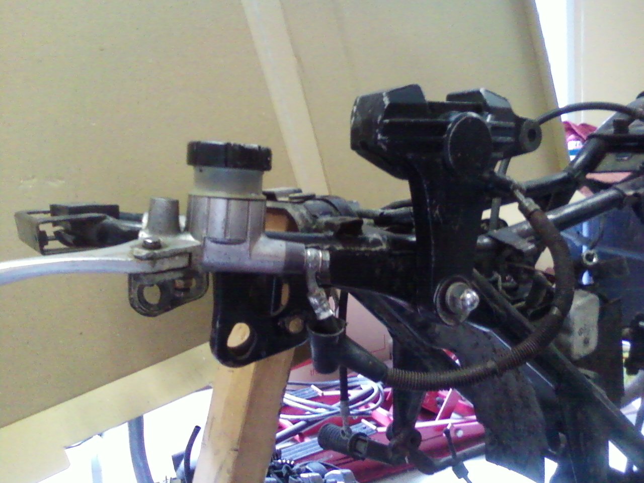

Here's a trick I used to free up some back brake pistons using the front brake lever.
bolted to my spare kz frame.
I pre soaked them in paint thinner for a couple days first
These pistons hadn't moved in 30 years.
