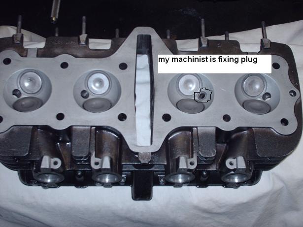

To Jeff, about the original head casting.
This is a must for a total restoration on the early production Z1
if the engine has been lost, redone, blown up etc.
someone building a hybrid 73 Z from scratch.
Can you place a value on one of these heads?
Marty in Buffalo
