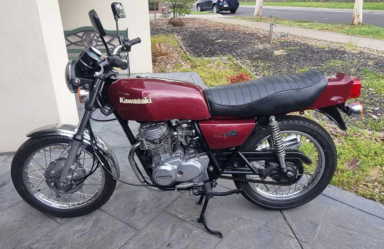

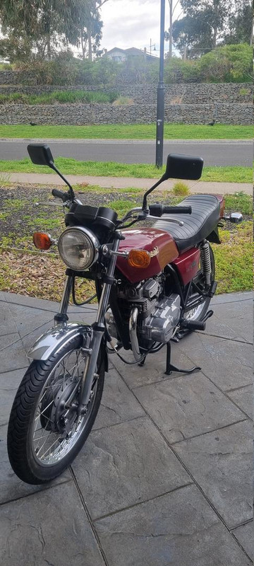

What are peoples opinion on mirrors? You guys prefer oem or visibility?
I've noticed my bike has rectangular mirrors. While they seem to be era correct, i think the oem ones are circular (black/chrome)?
being larger, the current ones are probably safer, in theory. But they certainly change the look of the bike.

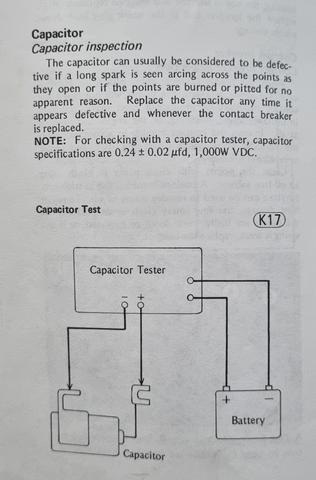

Can you believe this thing is still using its original condenser. There's oem and aftermarket options at a premium.
or this is an option. Will get one and fit it tomorrow.

Is the OEM condenser rated as 22 nF (nanofarad)? That seems out of range by an order of approximately 10. Every points condenser we've ever seen is in the range of 0.24 µF (microfarad).
An ignition condenser can be tested easily with a DMM that has a capacitance test setting.
Assuming the condenser & points are on the motor somewhere, is that capacitor rated for operating temps in the points housing?

Thanks for confirming the value. I wasn't sure if 22 was right.
220nf is same as .22uf
my original fears were true. Capacitance is ok, but 630v isnt enough. I imaging the oem caps are rated something crazy like 1000v+
Perhaps if I switched to electronic ignition 630v would be enough because no points?

630v ???? where ???? system voltage is 12v and HT output is approx 15kv

11 Sep 2026 03:06Yep, you're right. That trailing zero didn't register for some reason. 220nF is same as 0.22µF.Thanks for confirming the value. I wasn't sure if 22 was right.

Where indeed.
For what its worth it found this...
"...capacitor secs are 0.24 +- 0.02 ufd, 1,000W VDC.
So yeah. 630v was way out of the ballpark.
