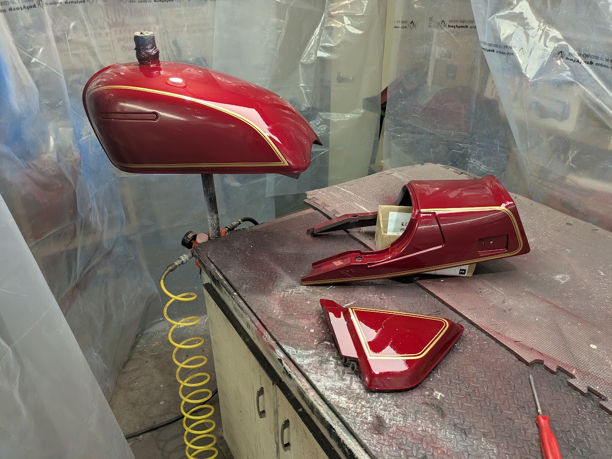

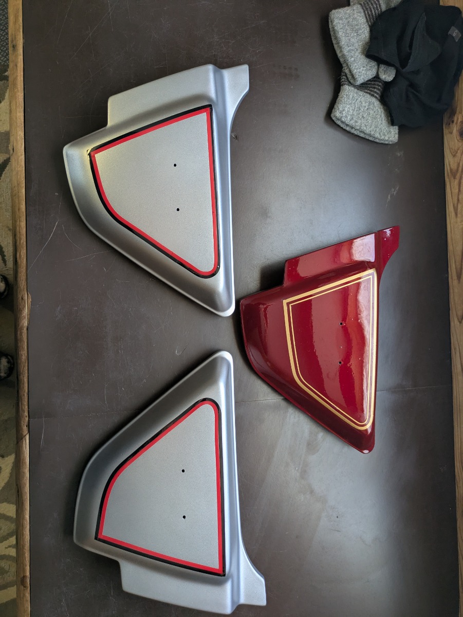

21 Jan 2026 12:54 - 21 Jan 2026 12:59I'm in the process of painting my bike parts. The red was easy. After removing the original emblems, I was able to match the colour underneath to another Kawasaki bike I painted 5 years ago. Toyota Ruby Flare. It's a very very close match and in the photo below you can't really tell which part is original colour and which 2 parts are repainted. The gold pin striping was easy enough (although not quite a perfect match size wise) It's 1 mm smaller gap between the stripes but....it will look great when it's all done. (That should give you a clue as to which part is original.

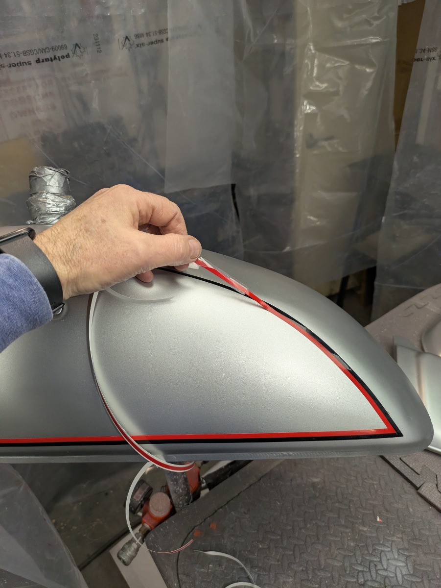

I received a second fuel tank and rear fender when I bought the bike. I've since purchased a set of side covers to go with them. I'm going to paint them silver so that I can possibly sell the bike with either colour the new owner wants or just sell the set the new owner doesn't want.
Here is my question, looking online I see different pinstripe colours for these Silver 750's. Different sales brochures and different countries might have had different options. Silver tank with red on blue, red on Black and dark blue on light blue. Since I live in Canada, what colour pinstripes were correct for a silver 1980 KZ750E?

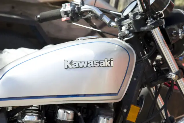

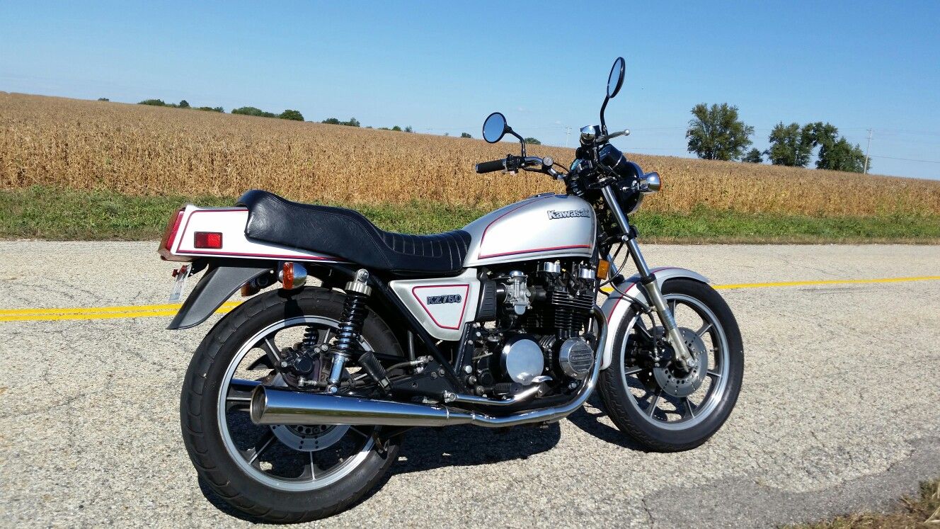

21 Jan 2026 14:06 - 21 Jan 2026 14:09
1978 KZ650B2 modified project
Last edit: 21 Jan 2026 14:09 by Injected. Reason: added pic

The first few postings in my build thread shows my (formerly) silver 1981 750E. The stripes are same as shown by Injected.

Wow, according to that 1980 only came in red.(With gold stripes)
I guess I'll paint the second set 1981 moondust silver with blue pinstripes.

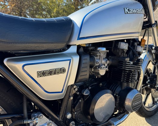

04 Feb 2026 08:40I have never owned one, those are stock pics grabbed from a Google search.The photos on the brochure show 2 dark blue stripes separated by a thin silver stripe.
The photos of your bike show a light blue stripe right next to a dark blue stripe.
Are yours original or was it a repaint?
