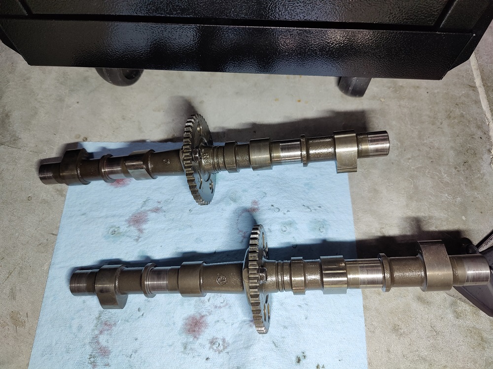

Yes, it was just the cap bolt that stripped out. Thanks for the information about the tensioner, I went ahead and ordered the updated/later part. I did a leak down test(glad I did), cylinder #3 exhaust valve is slightly bent. I pulled the head and have a new valve on order.
I've had a manual tensioner on a KLX250SF back in the day, it was more of an annoyance than anything. I like the set it and forget it of automatic tensioners.

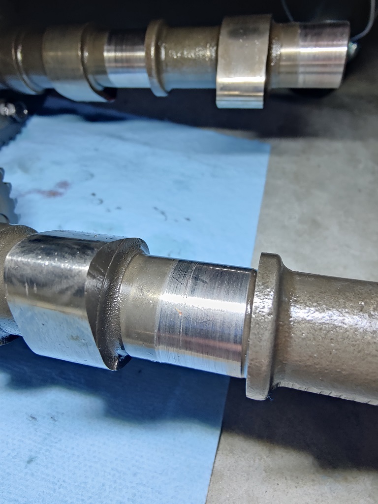

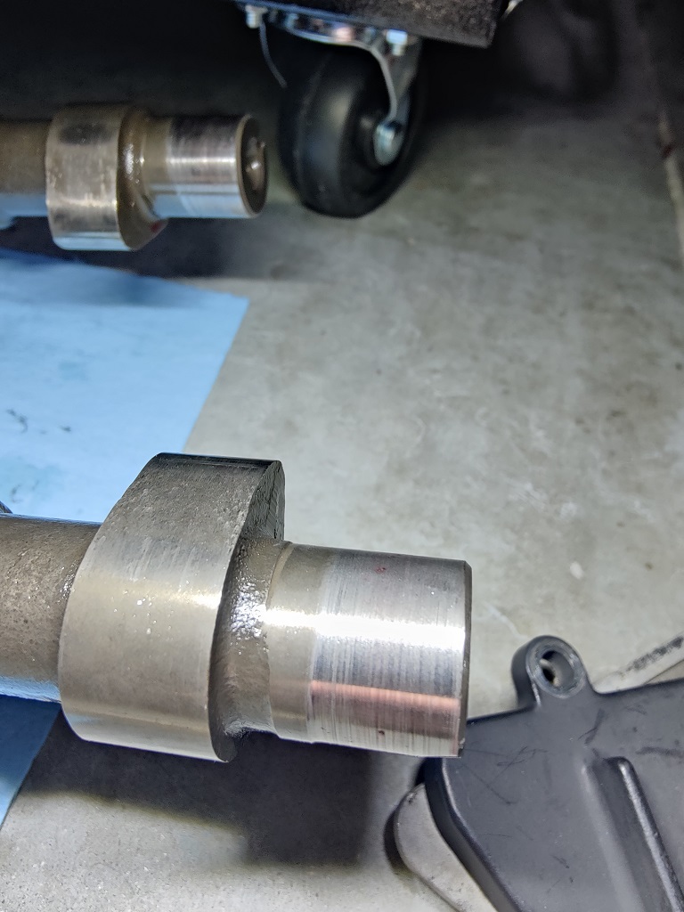

Here are pictures of the scoring on the camshafts.

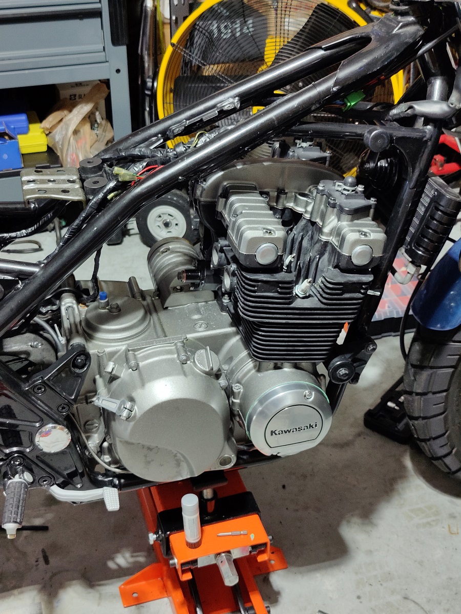

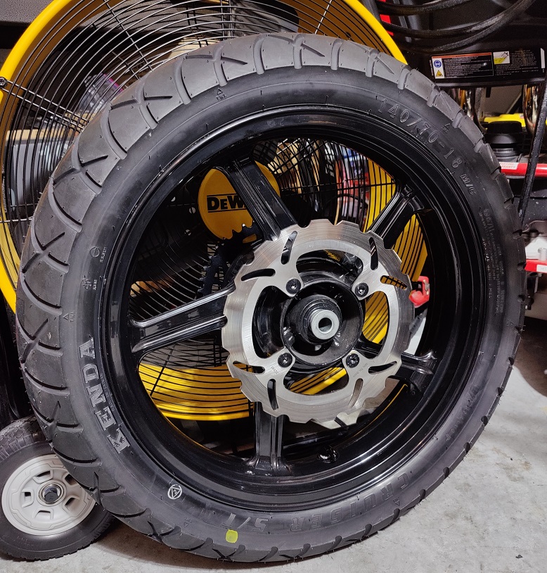

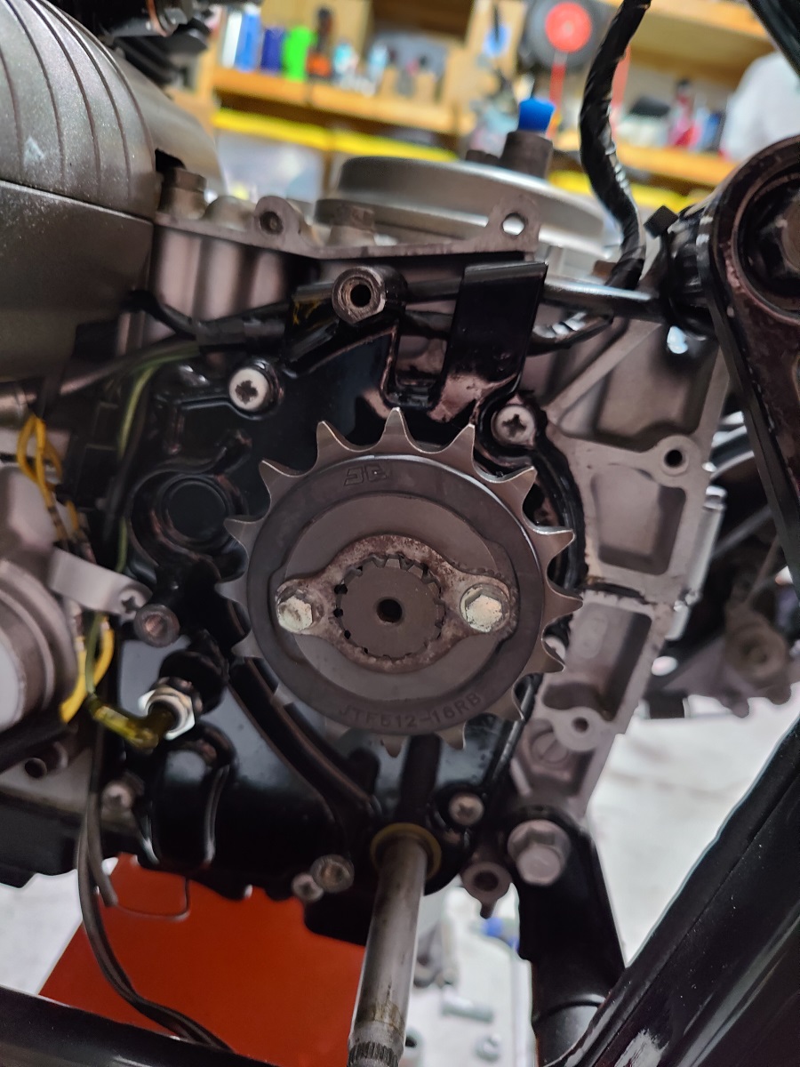

The used cylinder head I bought has several leaky valves, I set it off to the side. New exhaust valve installed into the old head, reassembled and put back on the bike. Valve clearance was loose, intakes all over 0.32mm and exhaust all at 0.50mm or more. The cam chain is at the edge of the service limit. New front(it had a 17t) and rear sprockets(39t was on it) installed, new rear tire to replace the oversized one on it. I removed the swingarm to check the bearings out, they're fine but there was very little grease and the seals are done. I am waiting on parts from Japan because surprise, you can't find them in the USA.

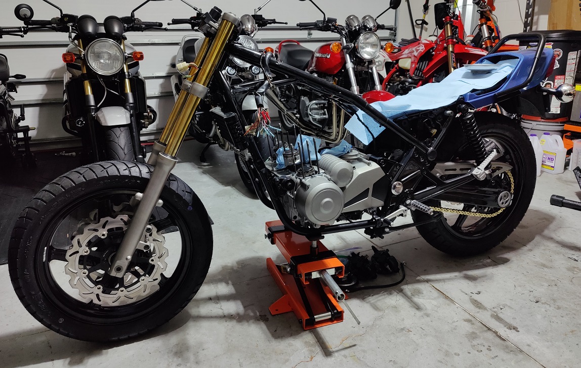

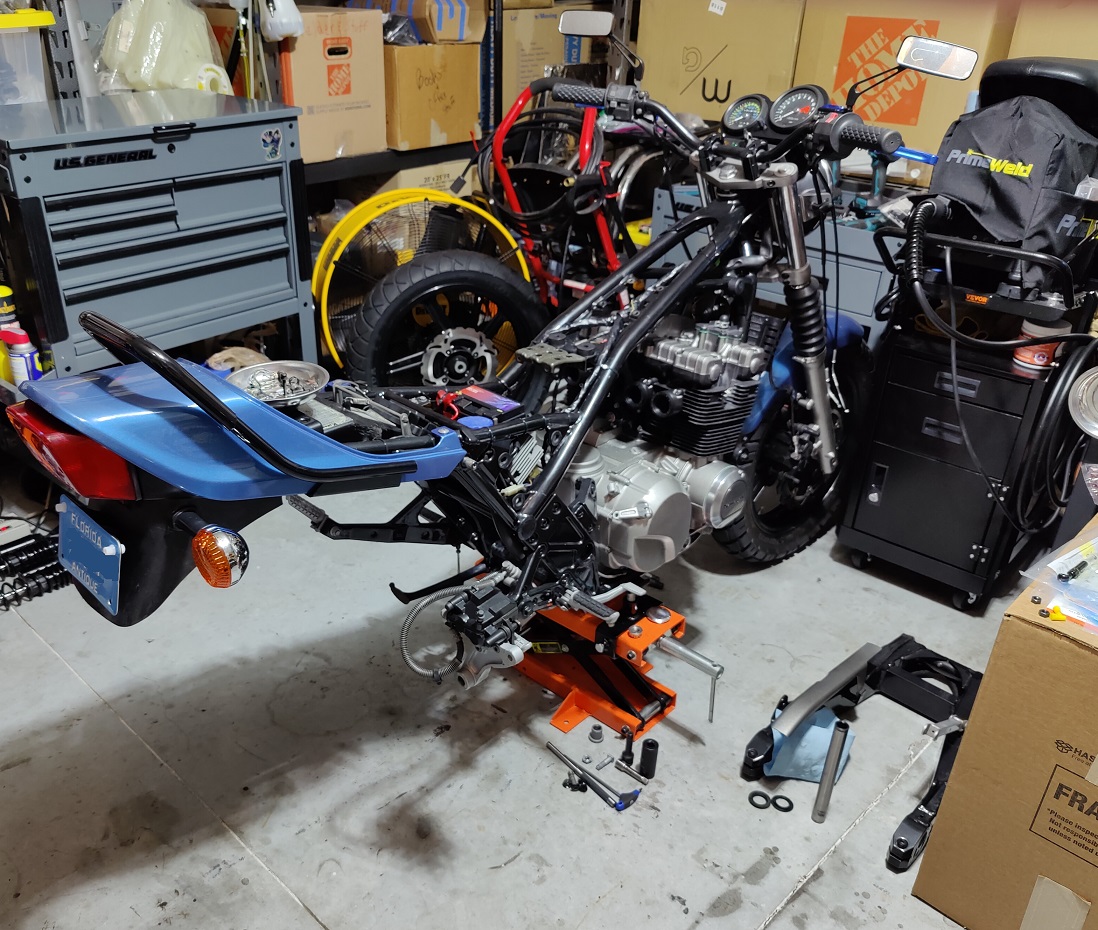

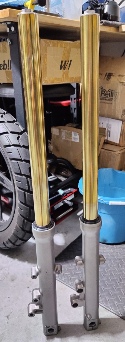

The project is still going but I may end up just getting rid of it as a roller once I get around to splitting the case. New fork tubes, previous owner crushed them in the clamps and the spring wouldn't move despite saying he rebuilt the forks(he just threw on new dust seals and they were out of oil). New OEM bushings and seals were also thrown on the forks. The lower steering bearing wasn't pressed on the stem completely, it's like he gave up trying to change it out after gouging the hell out of the steering stem trying to remove the race. I filed that down and got them changed out the correct way. Front tire(correct size) is new along with the wheel bearings. The only motorcycle I am buying after this would have to be a new one from a dealer, problem after problem just due to incompetence and being a lazy person on this bike.
