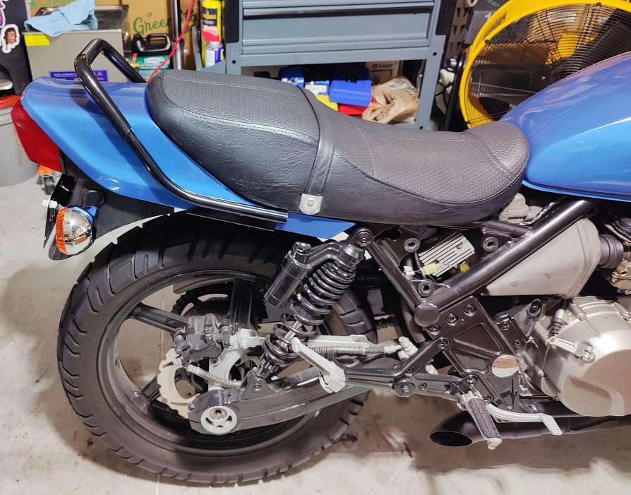

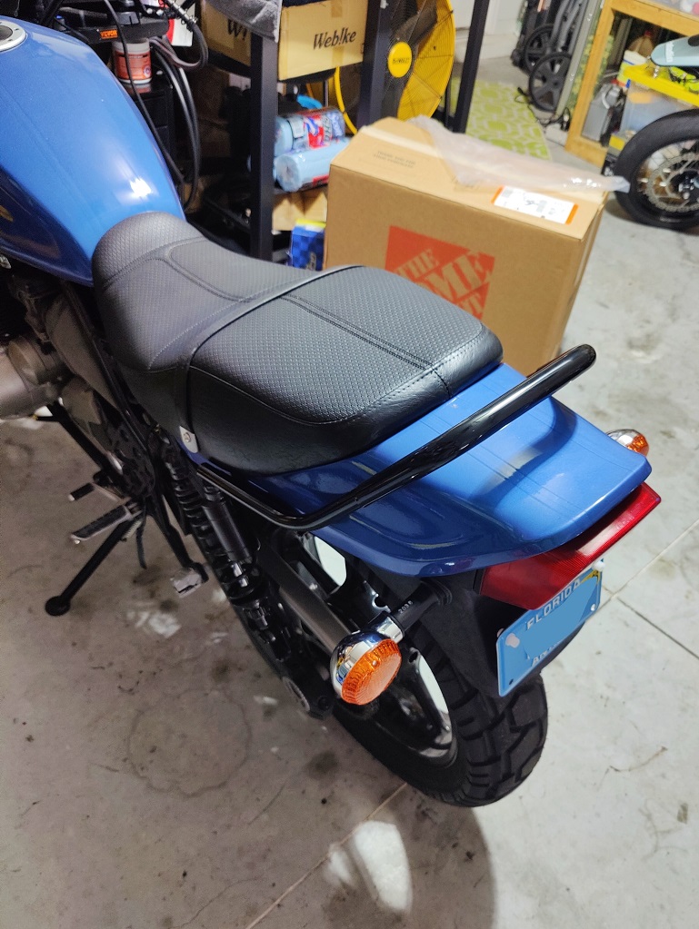

I've put on a stock rear fender, turn signals(K&S aftermarket) and removed the eBay parts(fender, rear light with integrated signals) that were on there. Going to get the signals wired up later today. I have a bunch of parts on order like OE sized tires, brake lines that are the correct length, Renthal bars, spark plugs. Some new intake boots from webike Japan are on their way, I have a nice grab handle for it and some air box covers that were already delivered.

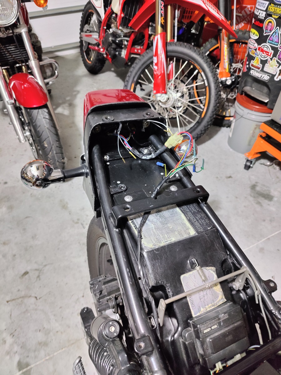

Not a lot of visible stuff done today, I removed the whole rear fender to look inside of the frame and I am glad that I did. There was a bunch of surface rust, hosed it down with various oils and cleaned them out. Turn signals wired in(Deutsch DT plugs are nice), grab handle mounted. I had to tap the mounting holes because when the frame was painted they didn't put a plug in.

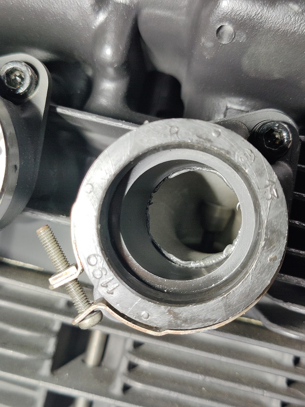

I pulled the carbs off, like the Zephyr 750 I have it was held together with multiple types of screws and homemade brackets. The float levels are completely off, tilting it slighting resulted in gasoline pouring out of the front. The worst thing? The previous owner pulled the engine apart to paint it, used WAY too much RTV to put it back together. Instead of buying a 60 cent o-ring for the carb boot, he just used too much RTV, stupid. Spent the time to pull the whole bike apart to paint it, spent time making homemade airbox brackets to hold it together, 3d printed adapter rings for the carb but draws the line at buying an o-ring.

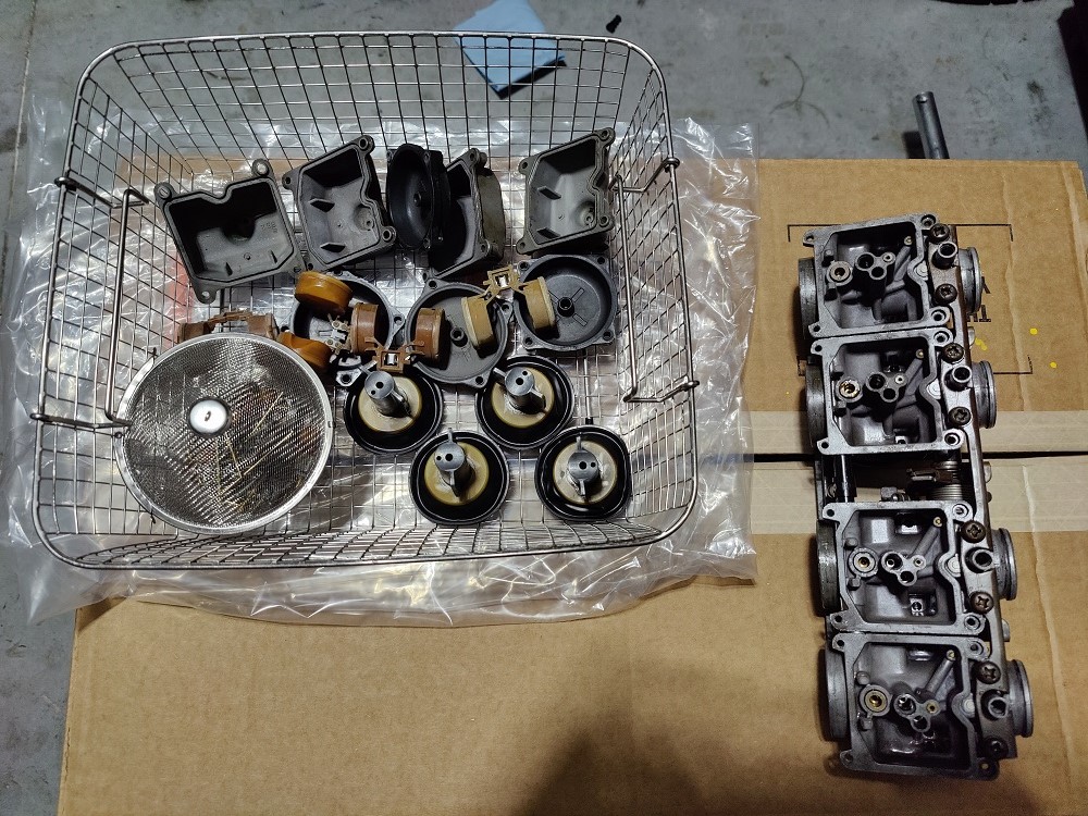

Carbs torn down to individual throttle bodies, cleaned and rebuilt. Fuel rail o-rings were nasty.
Picture is before ultrasonic cleaning and tearing them apart completely.
Does anyone know the factory setting of the pilot screw for a ZR550? The FSM and the Haynes manual both do not tell you. I have them set 2 turns out. I am going to be using the stock airbox and filter, jetting is OE. I do have a full Kerker exhaust for it, any jetting suggestions(sea level)?

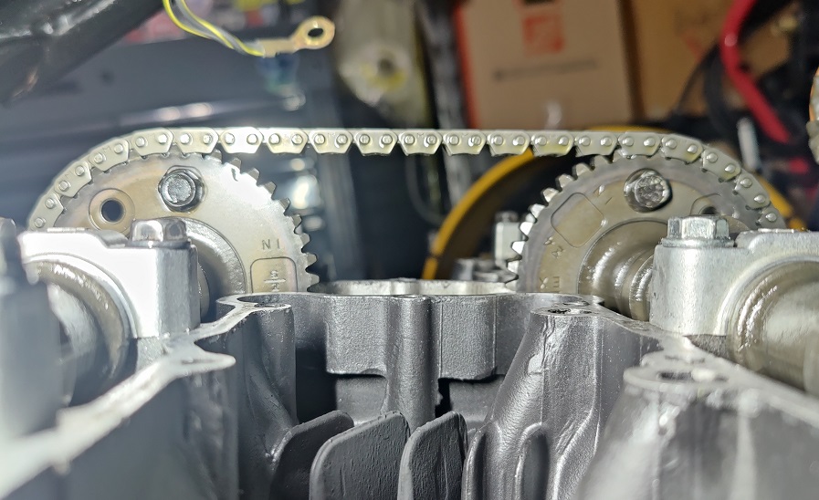

Engine timing is completely off.
Engine is set to TDC on #1 in the picture. How likely is it that a valve is bent? I am going to put the cams in the correct position and do valve clearances tomorrow.

I believe the default for the pilot screws is 2-1/2 out, but I’m just going off memory.
A Kerker exhaust, I’m assuming is more “open” so you might need to go with one to two up on your jets, as well as a high flow air filter, such as a K&N.

Is the pin count on the chain correct, don't forget when you fit the cam cover with the tensioner removed the inlet cam will rotate slightly "clockwise" as the guide pushes down on the chain between the cams
The following user(s) said Thank You: AOB85

06 Nov 2025 11:03Thanks, I will get mine set to 2 1/2 and up the main jet to #110/112.I believe the default for the pilot screws is 2-1/2 out, but I’m just going off memory.

06 Nov 2025 11:04The pin count is now correct, and I am glad you said something about the inlet cam because it is pointing slightly clockwise now. I am about to fit the cylinder head cover, followed by the tensioner then I will take the cover back off after rotating it several times and check the valve clearance.Is the pin count on the chain correct, don't forget when you fit the cam cover with the tensioner removed the inlet cam will rotate slightly "clockwise" as the guide pushes down on the chain between the cams
