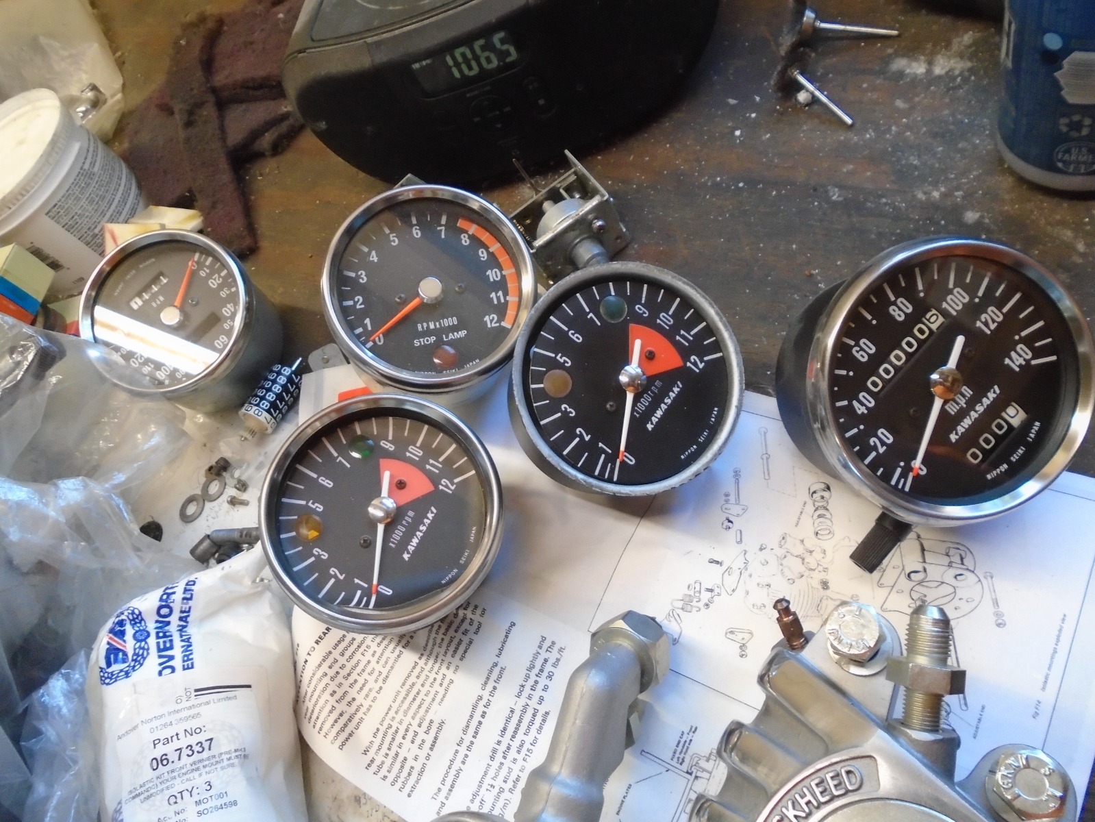

When the bushing for the spinning magnet starts to wear the instruments fluctuate up and down.
I made two new bushings to keep the magnet centered.

Nice job 73!! I've tried to duplicate that but i don't have a lathe and fortunate to already have an ample supply. End-play also is a critical component when performing work like that but you already knew that, ha. I have done a couple Yamaha RZ350 gauges, that don't have any bush at all, just shaft riding on the pot zinc! That's why they start to squeal subsequently destroying themselves. I install a grease zerk right above the cable threading on housing for Maintenace. Looks like you have the TWO style housings, early cast and later steel. Great job!!
Who made them?
Has anyone disassembled a reproduction speedo?
Do the parts interchange with Nippon Denso?

Yamaha favored the Nippon Seiki for the RZ and RD's. Like the early triple H series Kawasaki. The "Trip Register" is comprised of tiny little brass leaf springs. Not for the faint of heart i will say. That's why i got gifted with the task of doing these because you really need to pay attention what you're doing! The ND's used on all the Z's and KZ's are a cakewalk in comparison.
