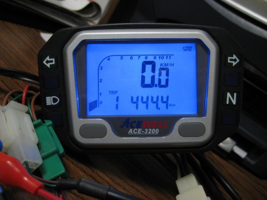

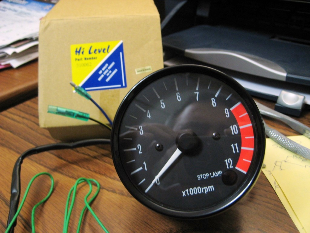

thanks.one other ting I need to do that I can think of is convert the tach to electronic. Theres not much good info google has found any ideas how to get it done?

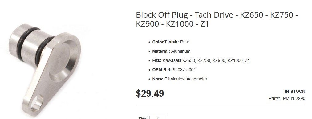

17 Aug 2025 06:03 - 17 Aug 2025 06:09You need to run one of these plugs after taking off the tach cable then the tach drive off the cylinder head.thanks.one other ting I need to do that I can think of is convert the tach to electronic. Theres not much good info google has found any ideas how to get it done?
Z1 ent lists them as fitting 1980 and up KZ550 engines.
When you hook up the electronic tach you attach the signal wire (usually green) to one coils negative terminal. If it just a single gauge then its dead easy, you can usually find switched power and ground in the headlight shell.

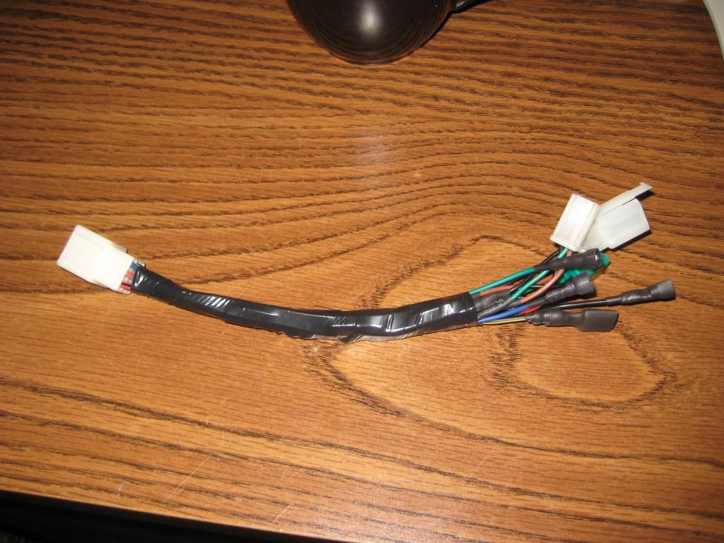

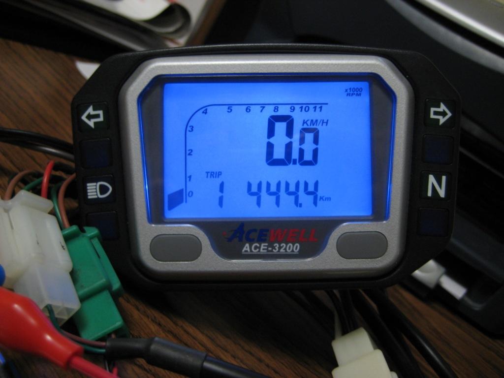

Most digital tachs come with instructions on how they wire up but I have found it is sometimes easier to make a short custom harness depending on if it is a complete digital dashboard (multi pin plug) to get them to plug into a stock KZ wire harness.
