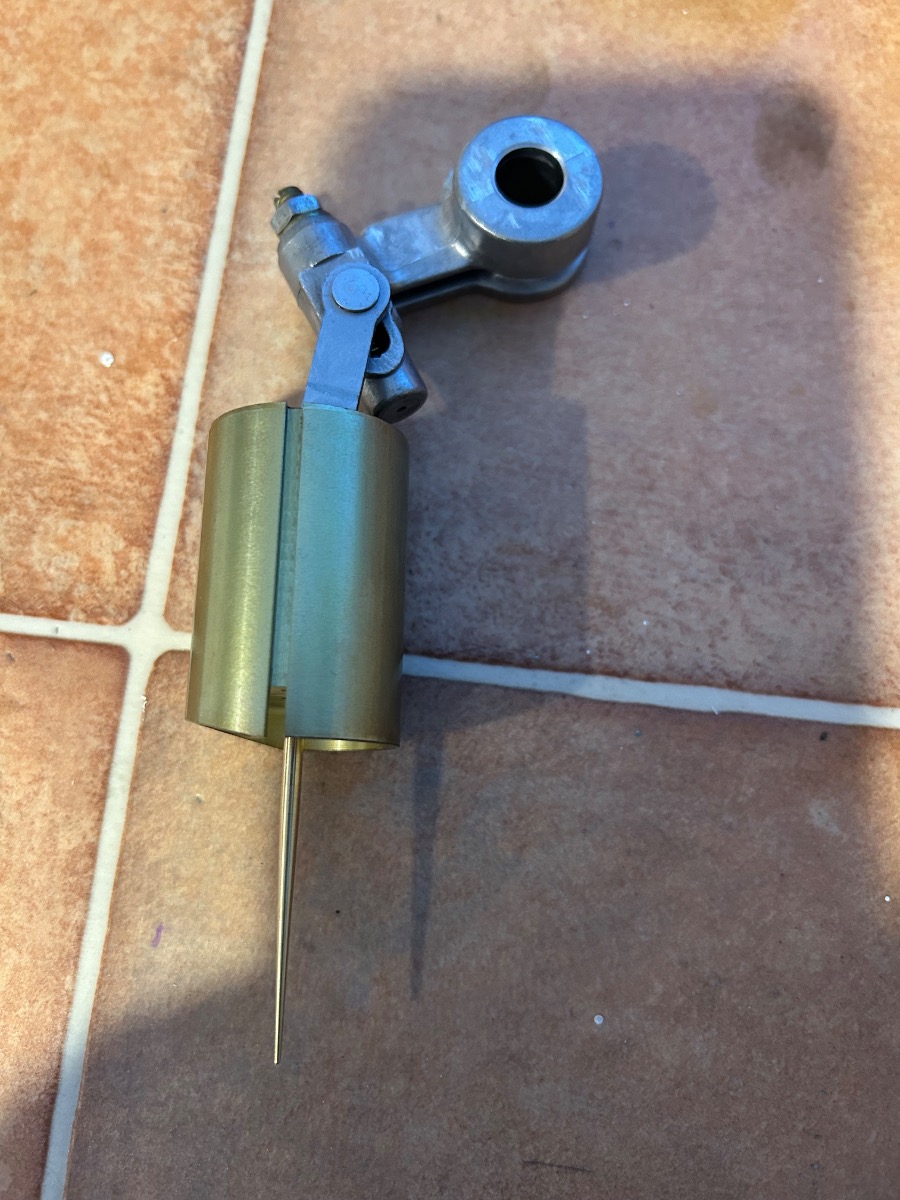

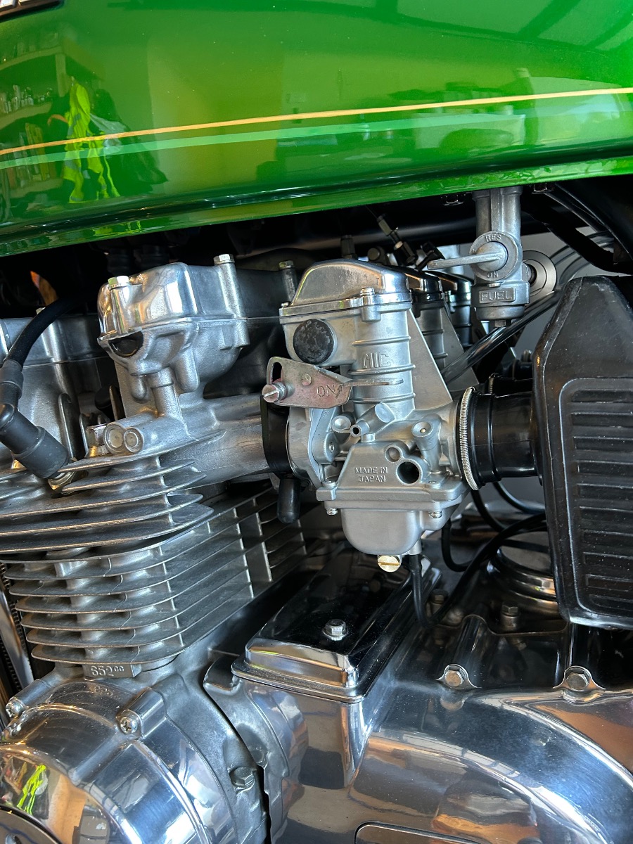

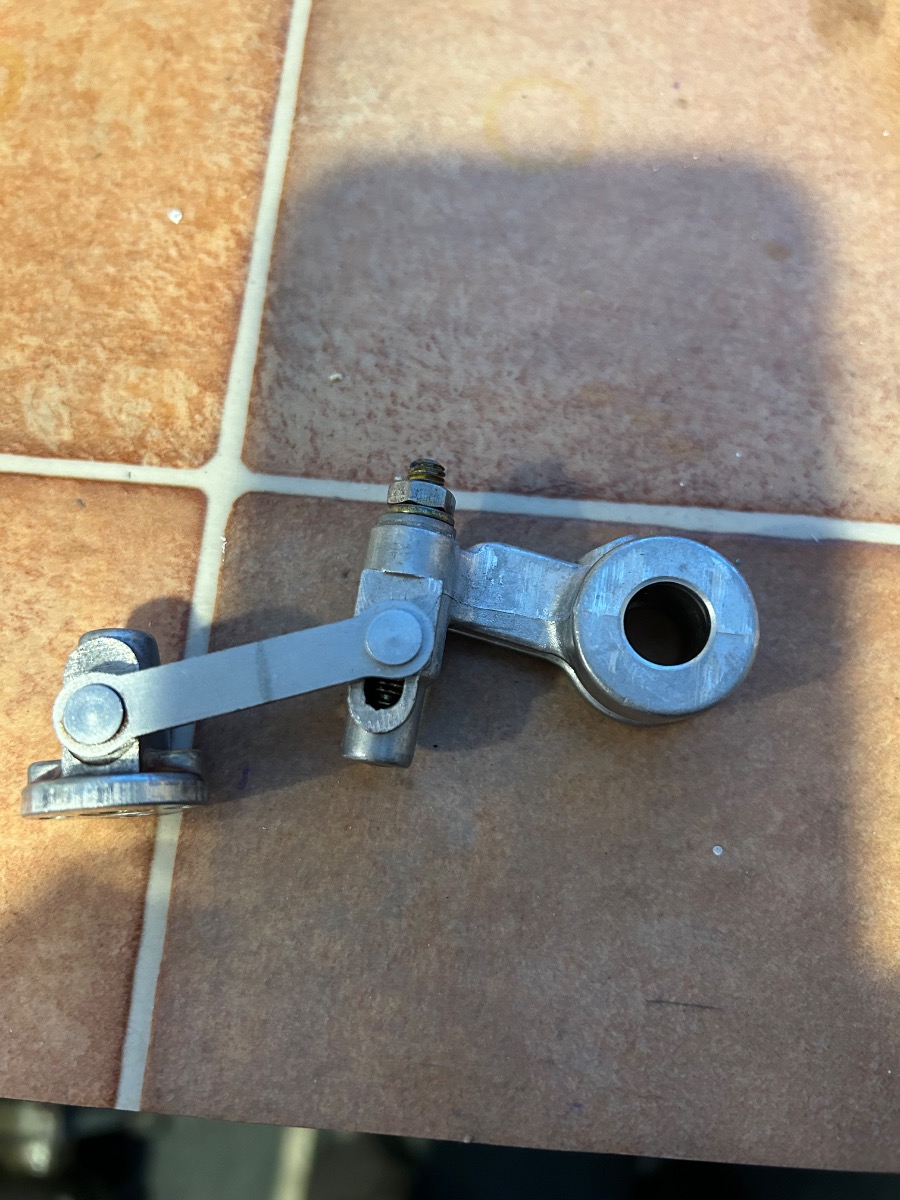

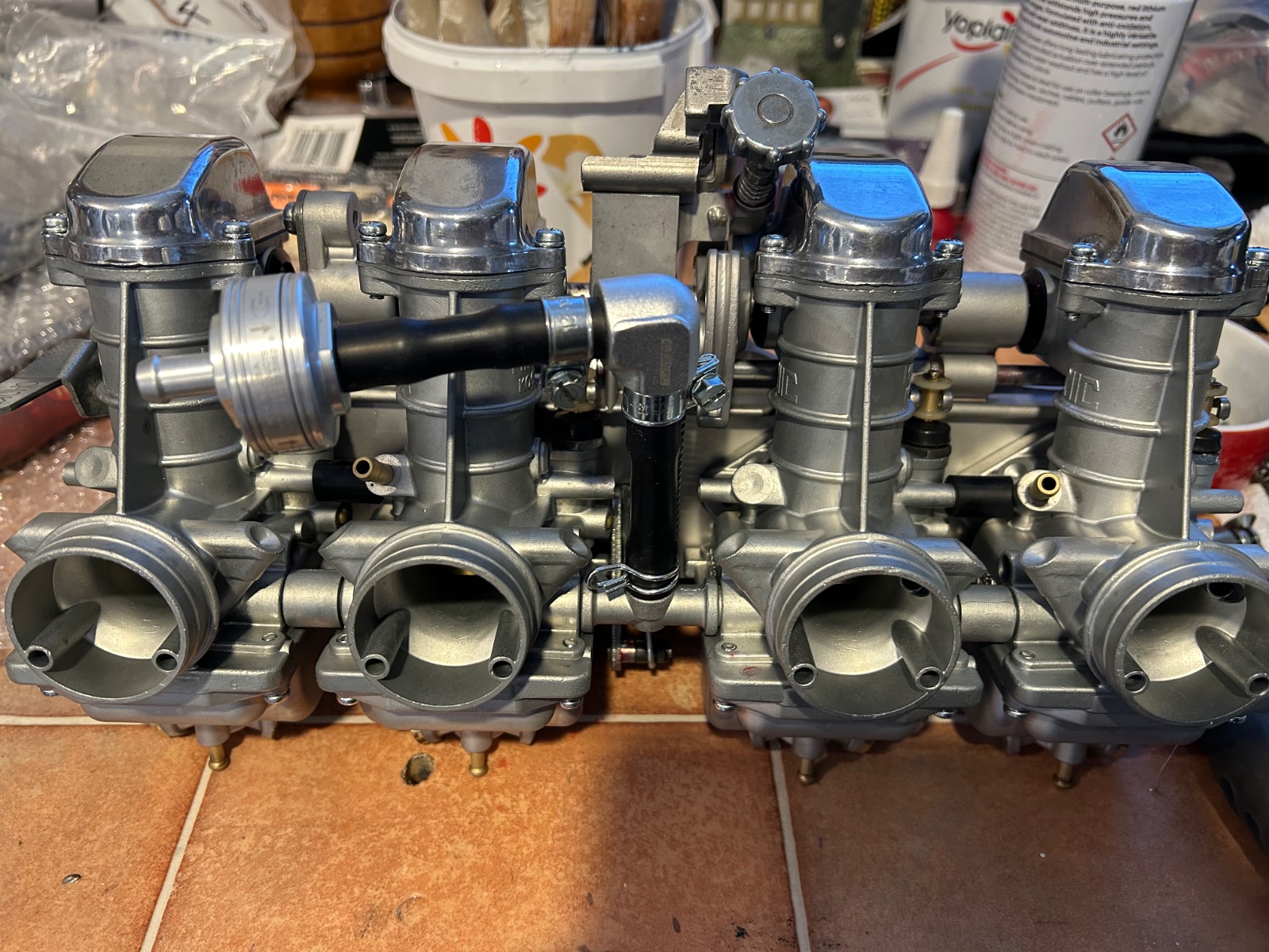

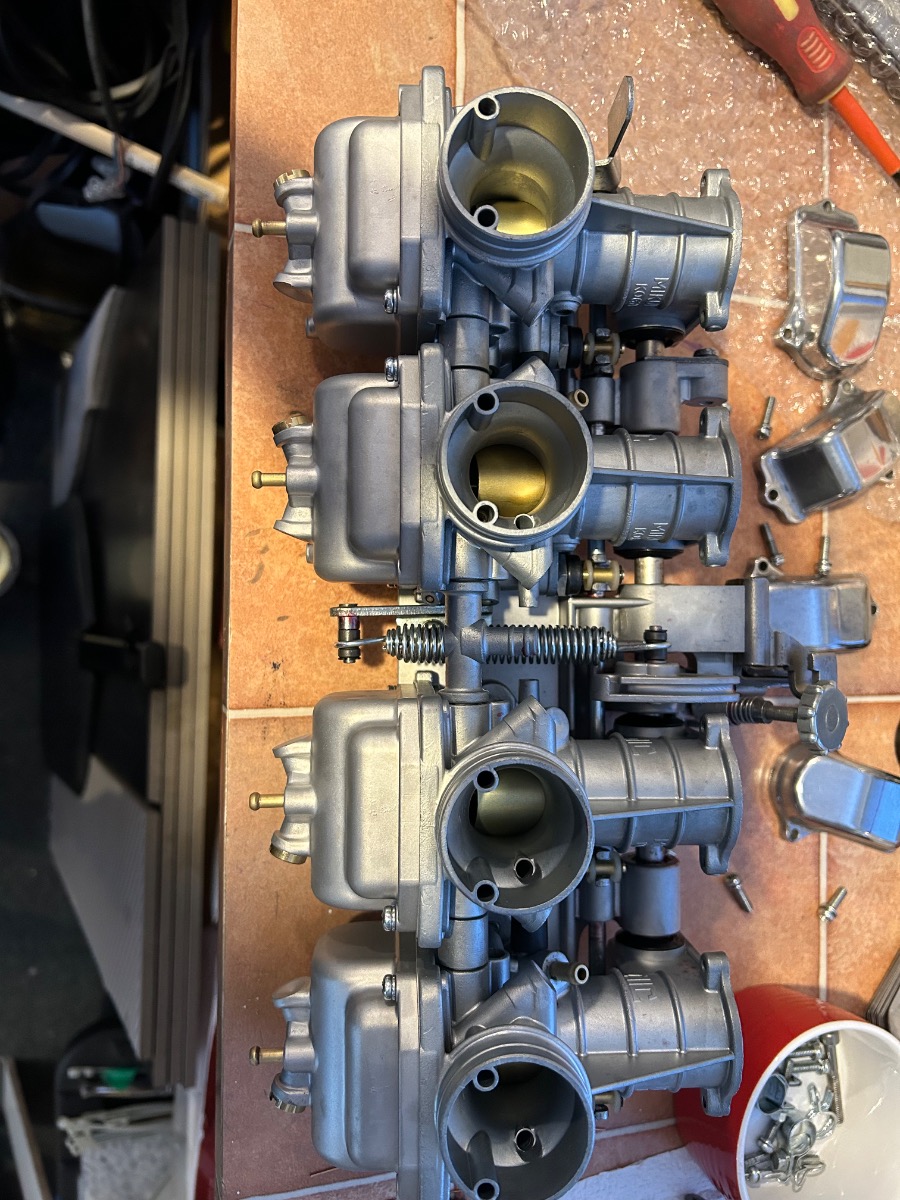

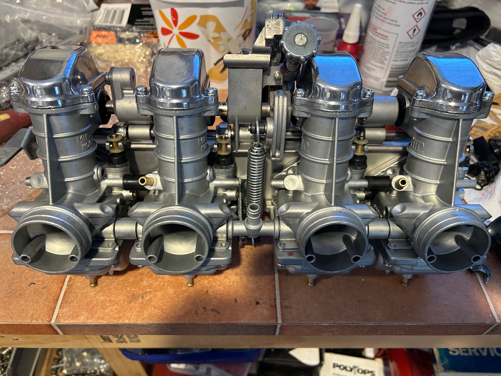

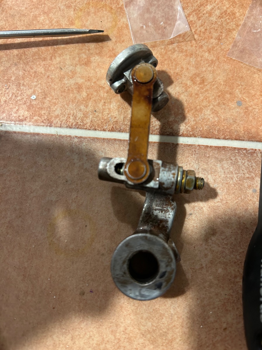

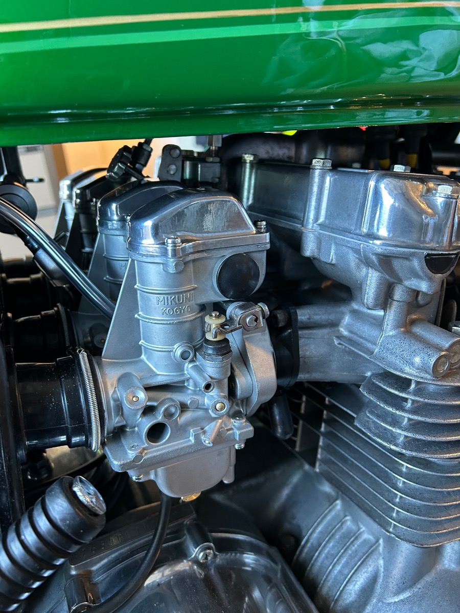

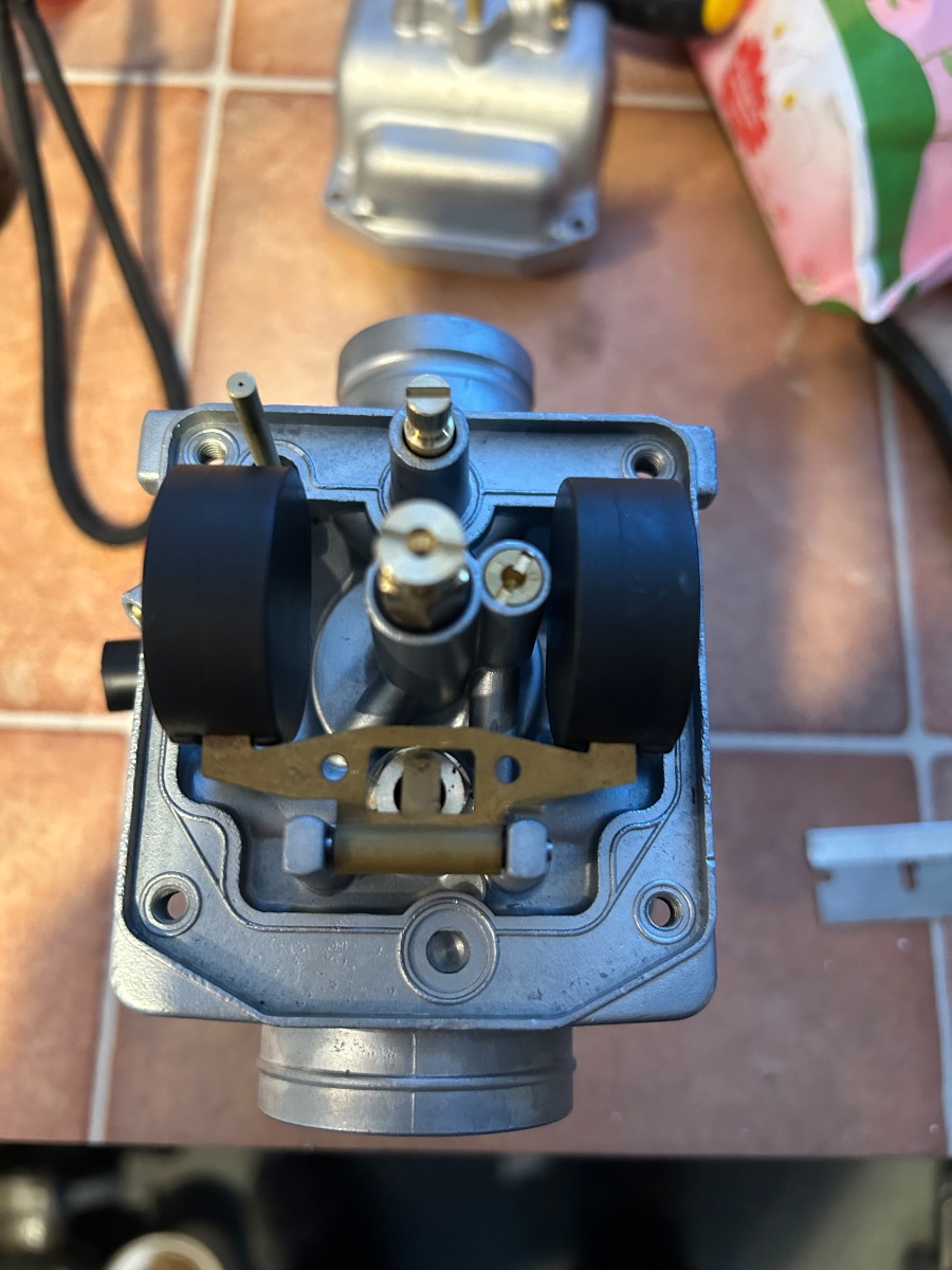

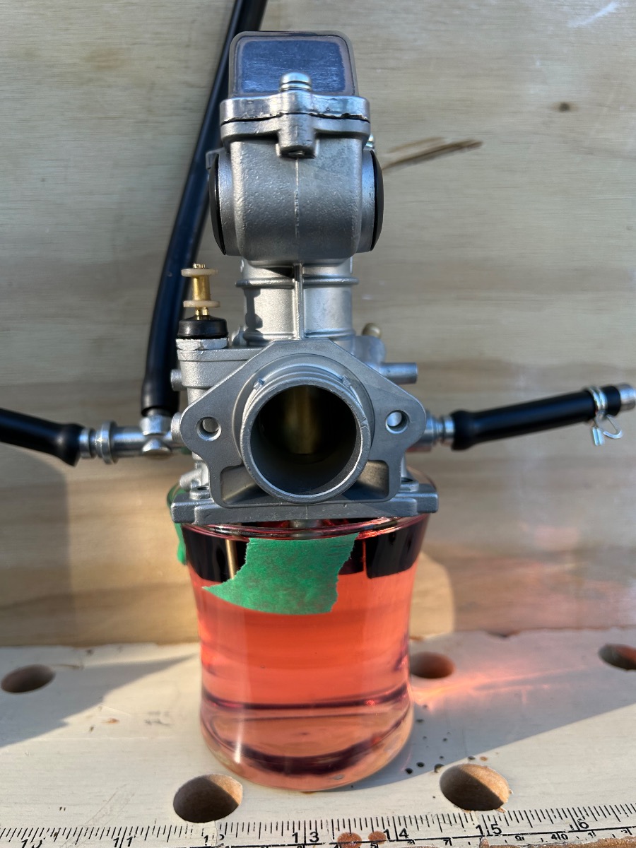

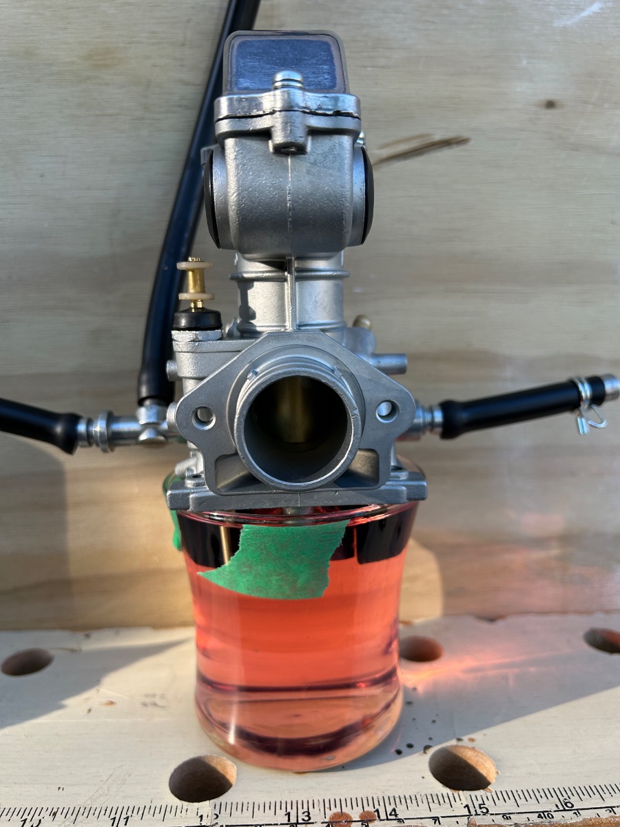

Decided to rebuild my carbs over the last week. They were generally pretty good, but not been rebuilt since new, still had original paint on screw heads. Pulled apart, vapour blasted and replaced jets, seals etc. set float heights using the wet method and jar on each carb, set the bench sync throat gaps to 0.7mm and refitted.
Allowed the fuel to prime and started straight away 😁, just have to set the throttle and full sync and should be ready to ride πŸ‘πŸ‘.
A few photos of the progress.

Looks Fantastic!! Fingers worn-out from all that sanding/polishing those tops, ha! Less wrenching, more riding now!!

Great job, Rich. ! Looks like new,... or better.... (..and that nice green colour with the handmade pinstripes on tank,..itΒ΄s a beauty!!!).....
