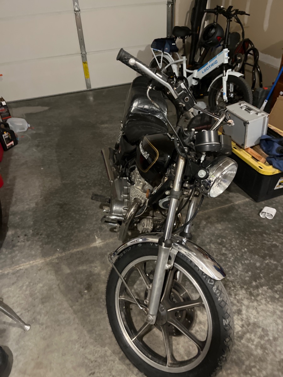

Hello all,
I got my KZ440 LTD back from my mechanic today and it’s running now without dumping gas everywhere (which is an improvement). I thought I’d start this thread to document my work on the bike as time go on. My goal is mostly to get the bike running well and meeting legal requirements so I can take my motorcycle endorsement skills test on it.
My first order of business is to fix the idle as it’s borderline unridable right now. I thought rebuilding the carbs would address this, but the bike appears to have a higher and higher idle as it heats up (to ~4000 rpm). Now, I’ve read some topics on this, so tomorrow I’ll pick up some carb cleaner to check for vacuum leaks and play with the throttle cable adjustment if that does nothing. I suppose checking the timing advance and valve clearance will come after that (although I need to do both of the latter even if I didn’t have this issue).
I’m operating under the assumption this is a vacuum leak as that would explain the rough cold starts as well (it sounds like one cylinder wants to die).
Despite this, I rode the bike around for an hour or so and had a blast. I definitely need to work on my overall stability riding, but this was my first time riding anywhere on public roads so I thought I didn’t do half bad. A friend said I looked like I was wobbling going straight on the road, and I definitely chose some questionable times to be doing things (like shifting in the middle of a turn or using a front brake to slow down when I realized I needed to sharpen up my course mid-turn). I’m sure this’ll come with time and getting more comfortable on a motorcycle.
As a second issue, I installed the horn today and it doesn’t work. I didn’t spend much time diagnosing it because I just wanted to ride around. I’m assuming the lack of a ground for the horn is the issue. I’ll order one and see if that fixes it.
Cheers.

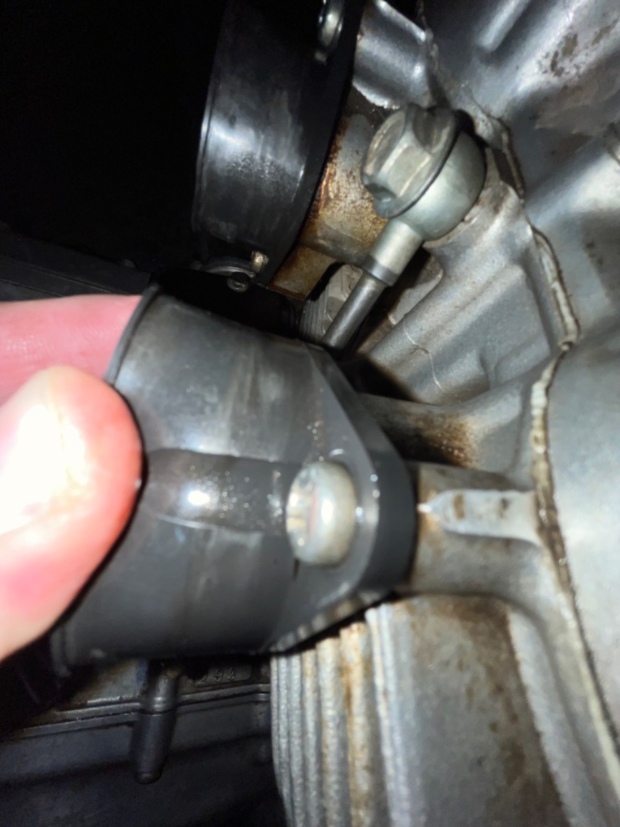

Using carb cleaner for diagnostics didn’t have a noticeable effect, so I pulled the carbs out last night and looked around.
(Edit: The crack is just behind the screw on the close carb holder. The far mating surface doesn’t look good either; does it?)
One of the carb boots has a tear in it. I’m not sure if the tear was caused by me removing the carbs, but either way I’m replacing both carb boots. I already put penetrating oil on the screws and am going to keep doing so for a couple days to get them out.
The second thing I noticed is that the petcock vacuum line was sealed with what appears to be a little clump of foil shoved into it. This bike has a Yamaha Raptor petcock clone on it already so I don’t need the line. I’ll order the matching plug (11012-1129 or 11065-0282) from the other carb and install that instead of the poorly plugged line.
As for reinstallation of the carbs, I’m probably going to pull the battery case from the bike to get a little more room to push the airbox away from the carbs and reinstall it that way with some engine oil on the carb boots. I’ll be keeping the same airbox boots, but only because the part is on backorder.
Thanks for the help all.

Looks like you are on the right track, the discolouration around the joint between the boots and head suggests leaking
