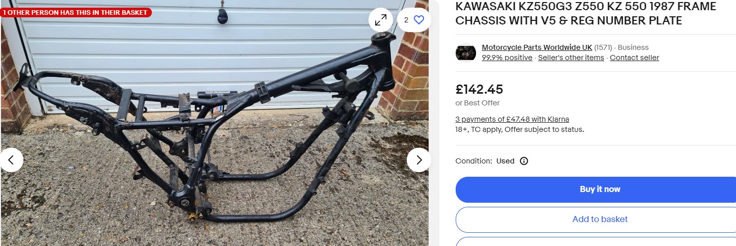

31 Oct 2024 07:59 - 31 Oct 2024 08:44Don't know for sure but I think that frame has been created in somebody's shed rather than by a recognised frame builder (looking at the head angle and single downtube it may have been adapted from a "chop" frame), it's got potential for a cool little bike thoughWhat's going on people of this forum. About a year ago i acquired a kz650 along with a custom frame that fits a kz550 motor. After sorting through several bins since both bikes were stripped down to the frame i was able to get the motor running in the custom frame and mostly assembled with the little information i had about it. Now i am kinda at a road block with it and would like to identify what company if any made the frame so i could finish this project. Or if anyone could point me in the right direction that would be much appreciated.
Edit: something else worth looking at is the position of the swingarm pivot (it looks high compared to the stock 550 frame below) which may mean the chain will be "eating" the swingarm !!!!
