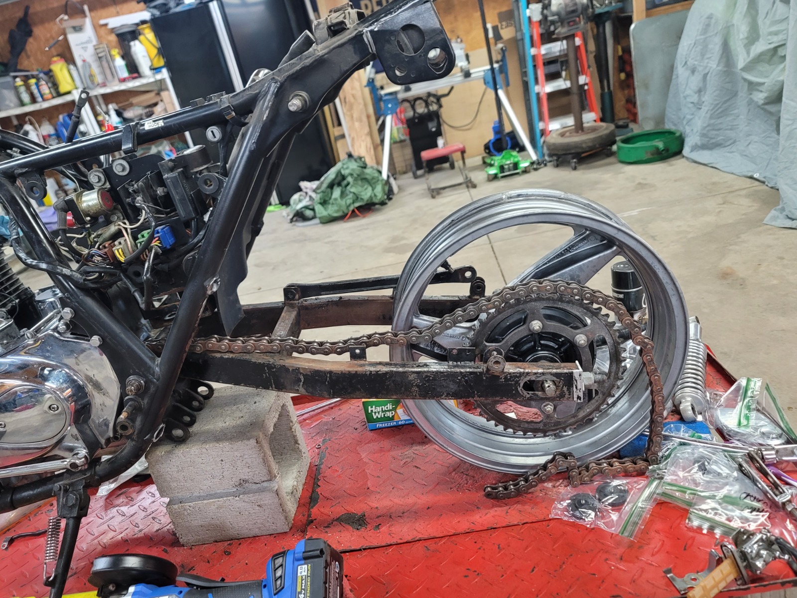

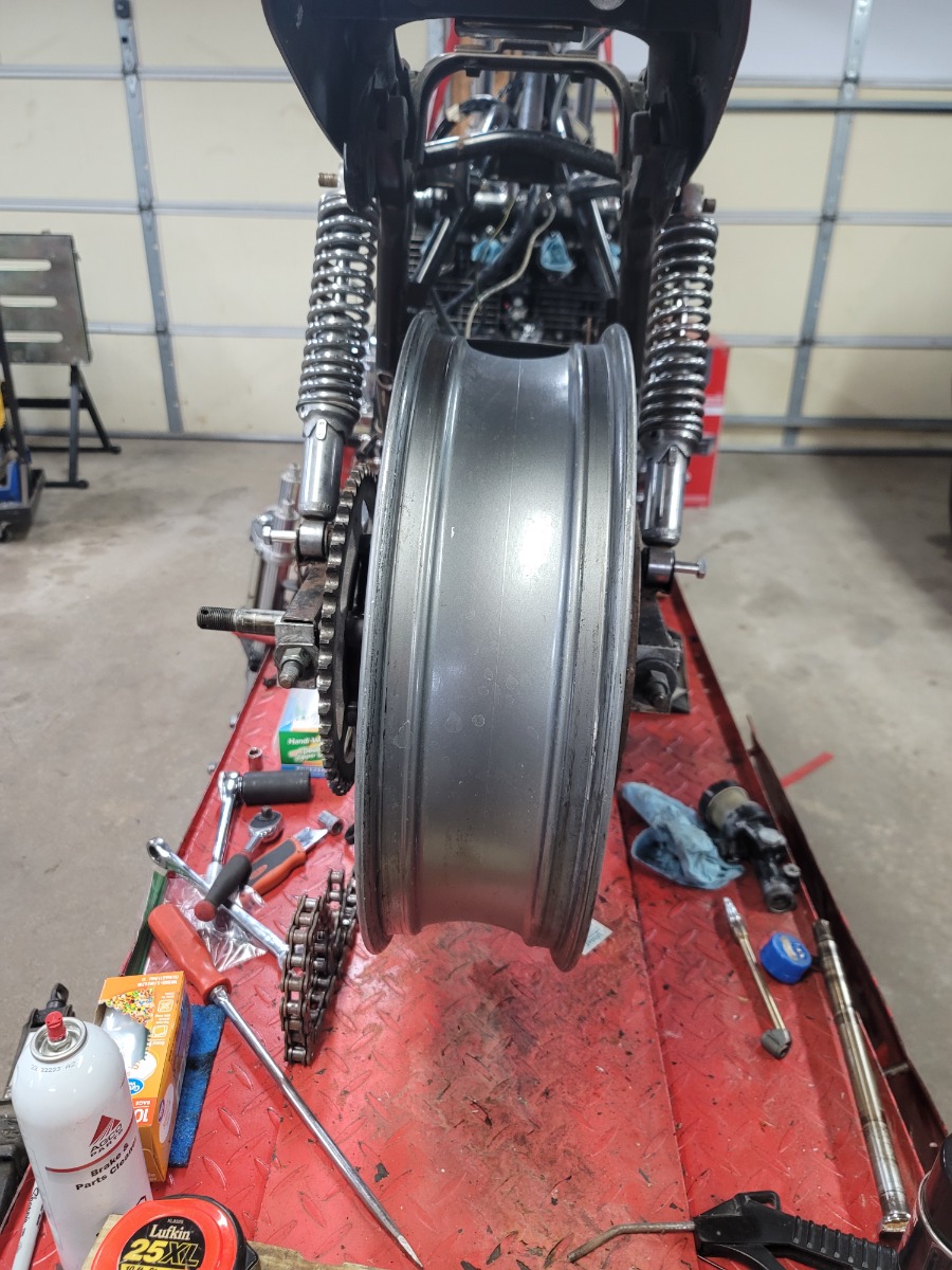

After buying this thing in February, she has sat... finally getting around to having the time to dig in. '98 ZX600E front and rear end going on. ISO RS34 carbs. Anyone, anyone?

Looks like it's going to be a tight fit with this swing arm. Thinking about going to a stock 2000 ZX6 swingarm instead.
