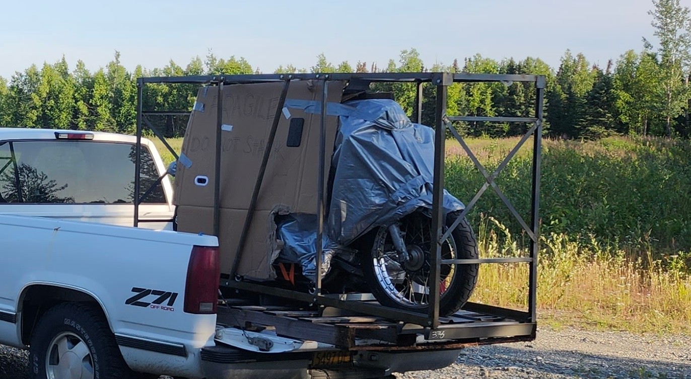

That last episode was maybe 4 years ago, and back then we were considering shipping it to my home in Southern Arizona, where all my tools and workshop is so I could get it going for him. I sourced a motorcycle specific shipping crate from a Kawasaki dealership in Eagle River, but the crate languished behind their garage for several years until now.

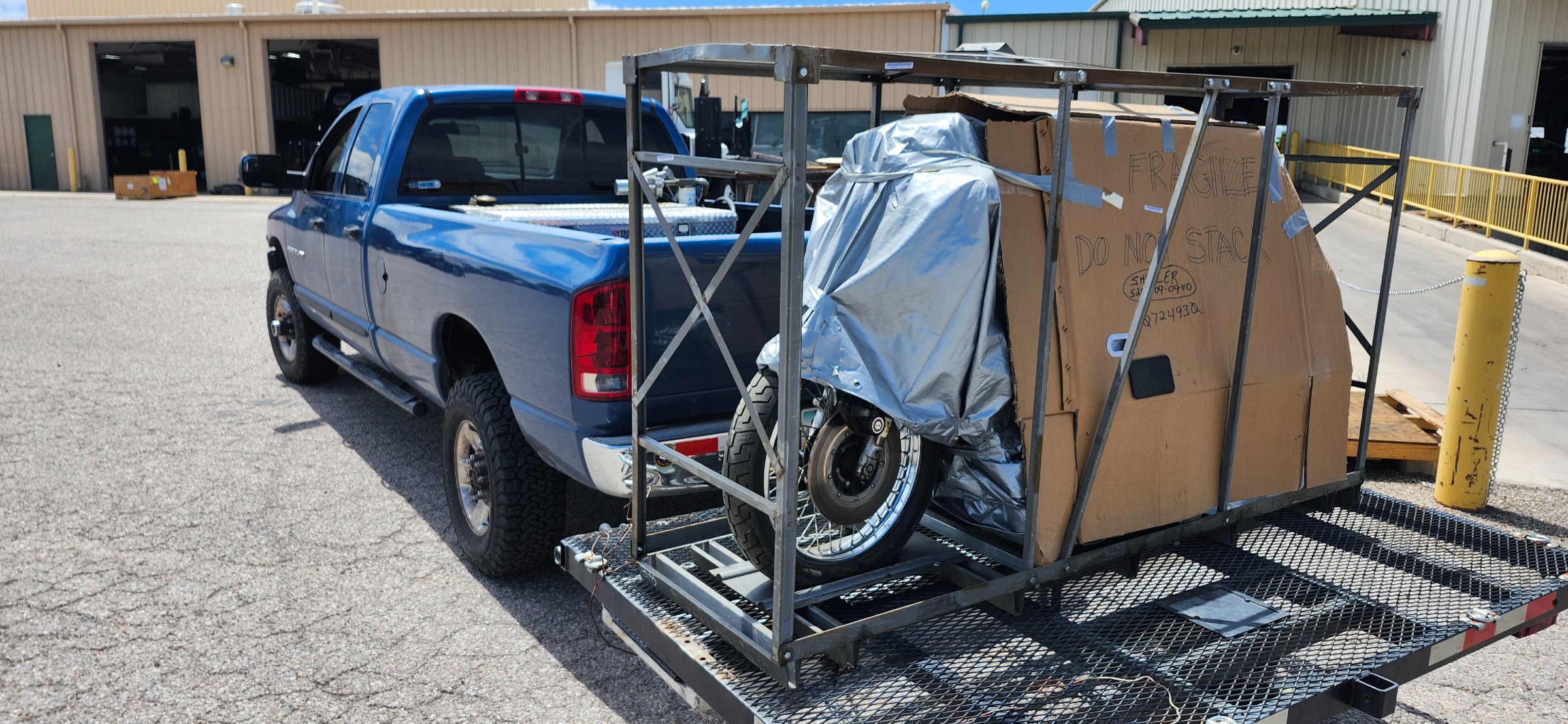

This last trip up there, My brother in law gave me the Z. We packed it up and drove it to a shipping terminal in Anchorage. About 2 weeks later it's sitting in my workshop in Tucson.
So now I can stand down from the transportation process and start trying to figure out what's going on with it.

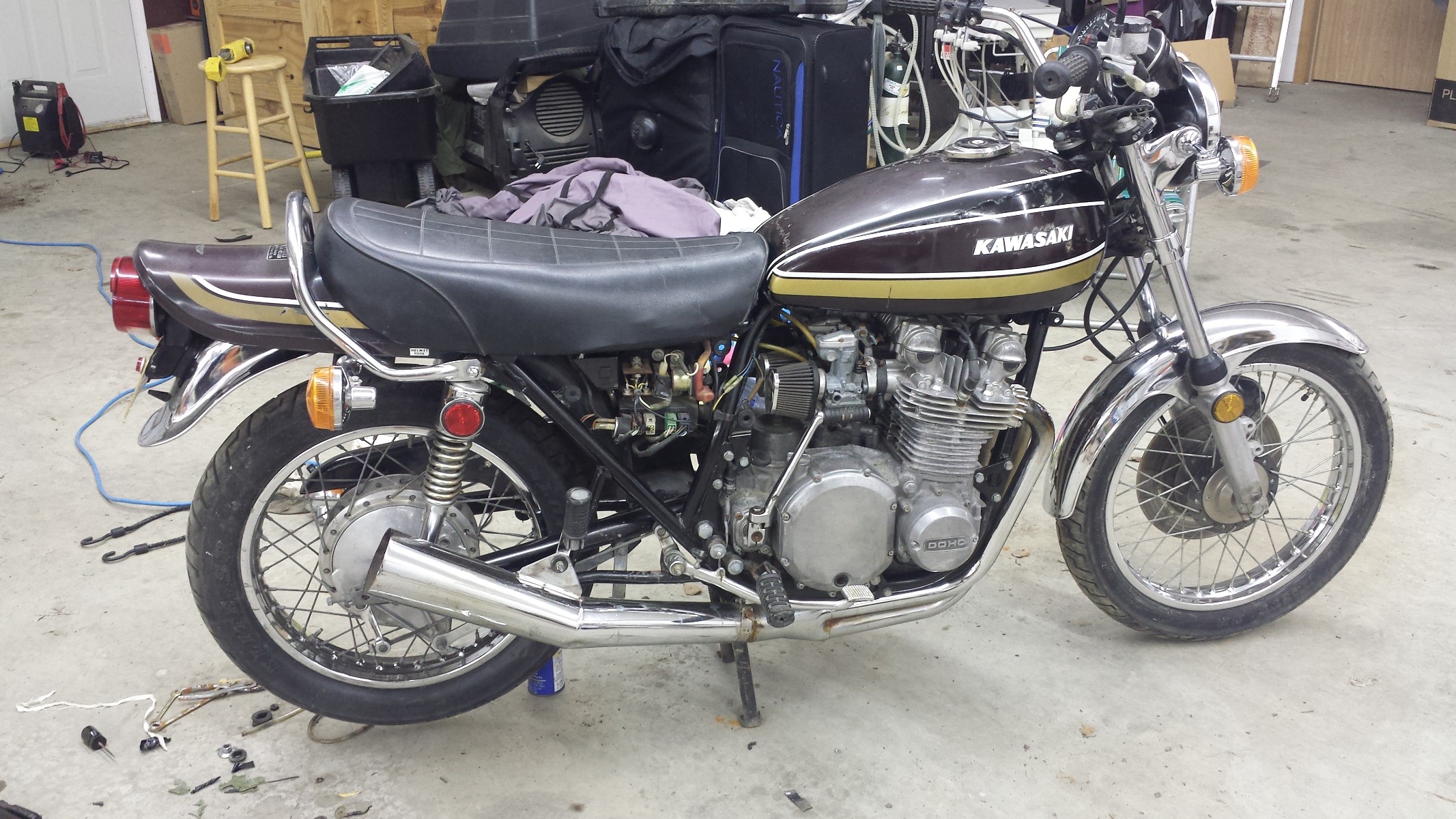

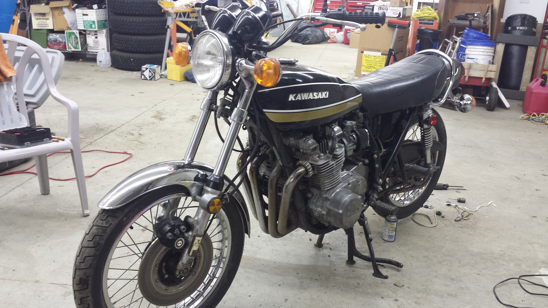

Nice find! A great platform for a 'survivor'-type refurb, especially if the sidecovers are still present. Following with interest!
Be gentle if attempting to turn the crank via the large nut at the timing advancer. The advancer is located by a small steel pin pressed into the end of the crank. It can be sheared off if too much force is applied to the large advancer nut. Ditto the timing advancer bolt; we've lost count over the years of the number of advancer bolts we've seen broken off deep in the end of the crank.
Don't do away that badge on the gas cap! That's a dealer-specific period piece not seen often these days. Ditto the 'K' badge on the caliper.
The adhesive label on the tailpiece is unfortunate. Short-sighted placement by the selling dealer. They can be removed with gentle heat from a hair dryer, a plastic razor blade and patience. Likely the label protected the underlying paint from fading.
EDIT: Forgot to mention the handgrips. They look to be OEM, which are difficult to find these days & much sought after by restorers.
