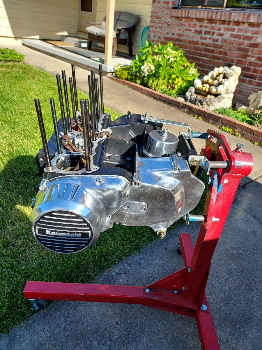

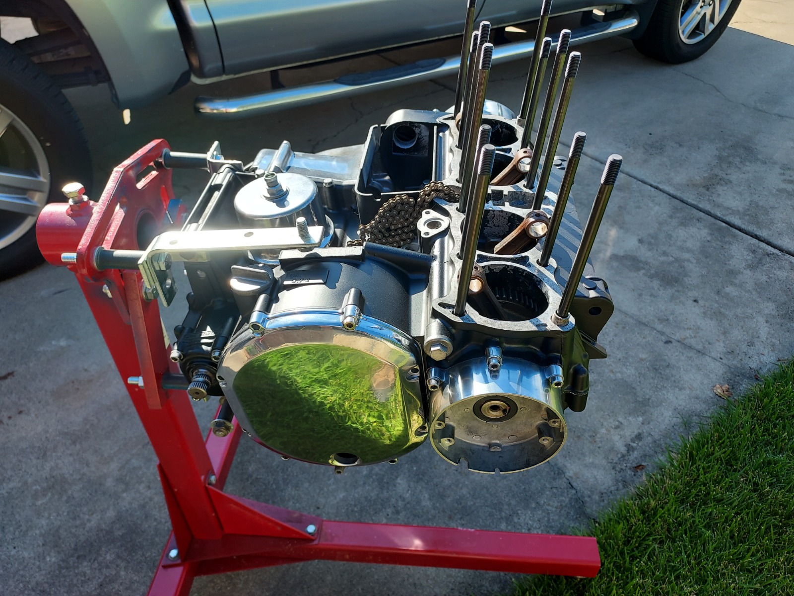

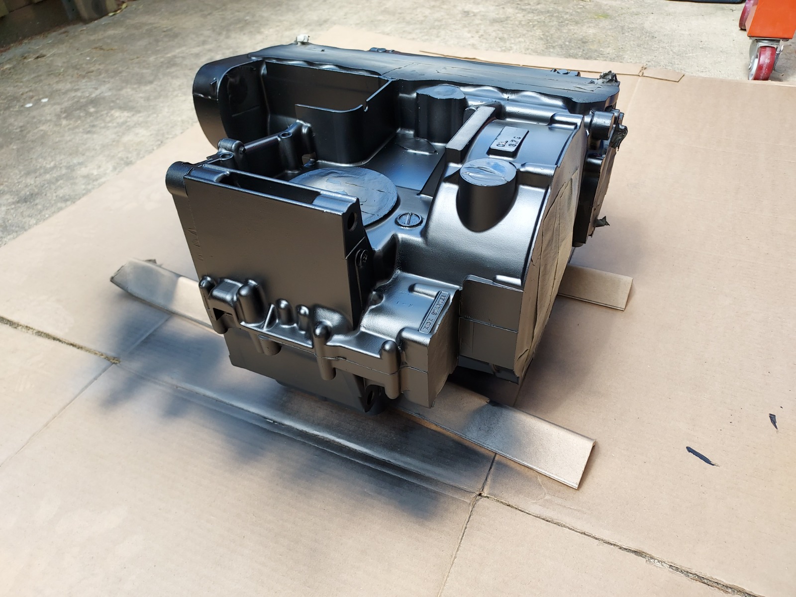

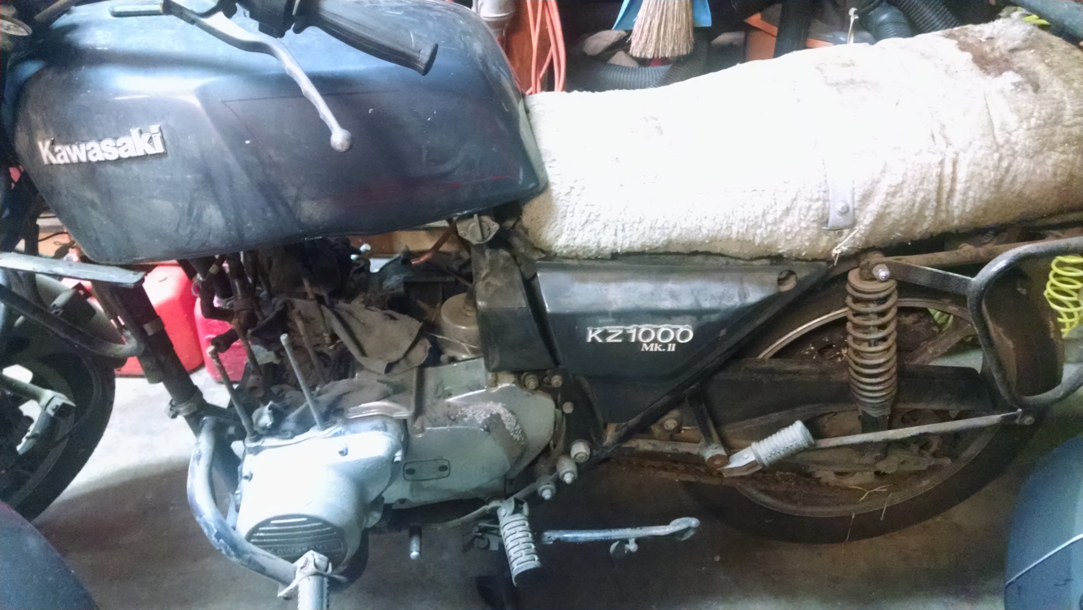

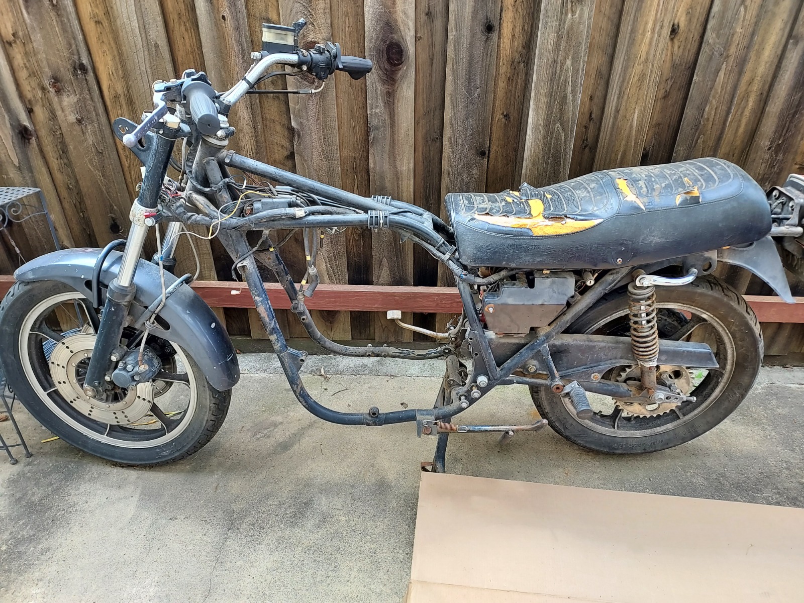

Originally posted comments regarding this project in my first "Howdy" thread. Here's a picture of the beginning.

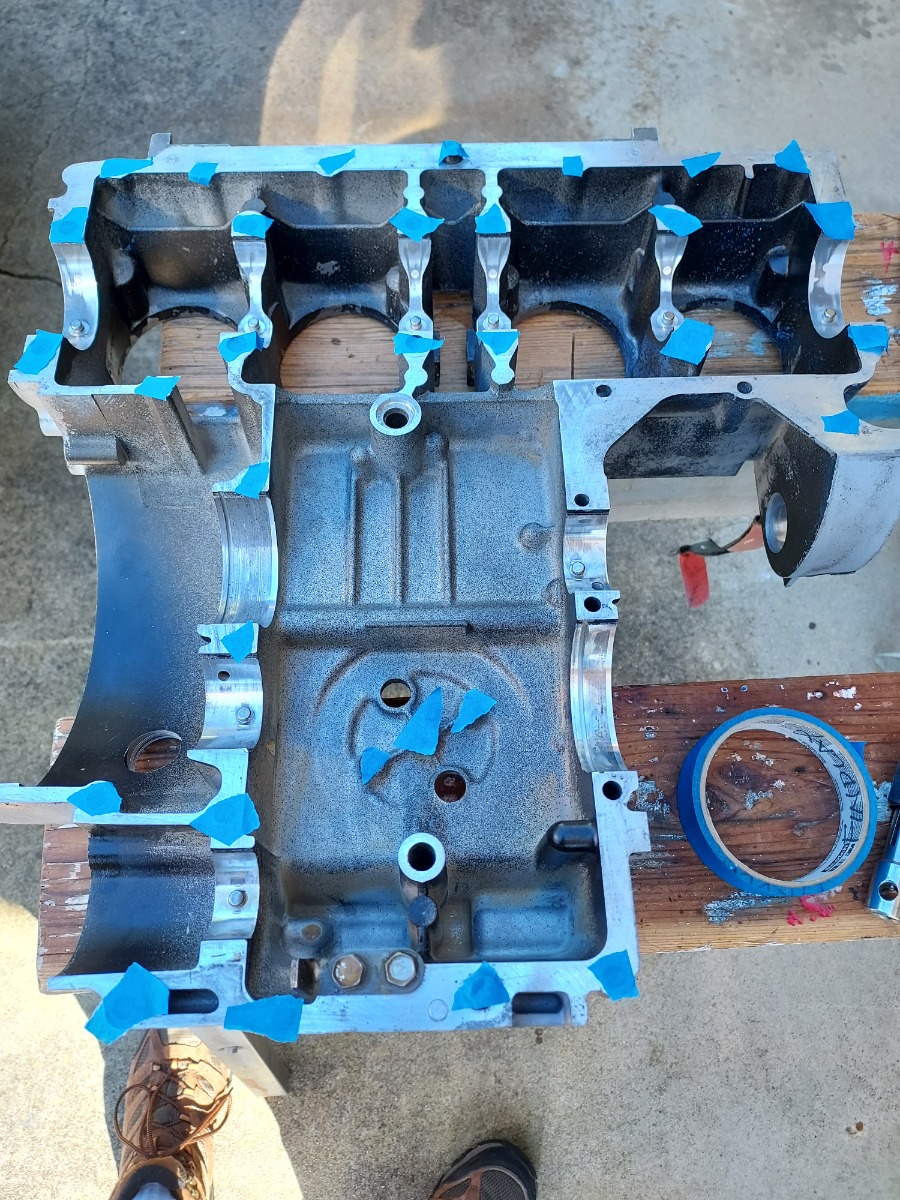

Just finished up painting the engine cases. Some pics..
After cleaning and clearing threaded holes.
Rest of frame awaiting attention....

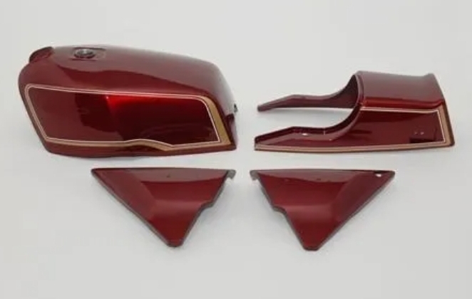

Found this set on Ebay for a very reasonable price!
Hope to be posting some progress as I trudge along.

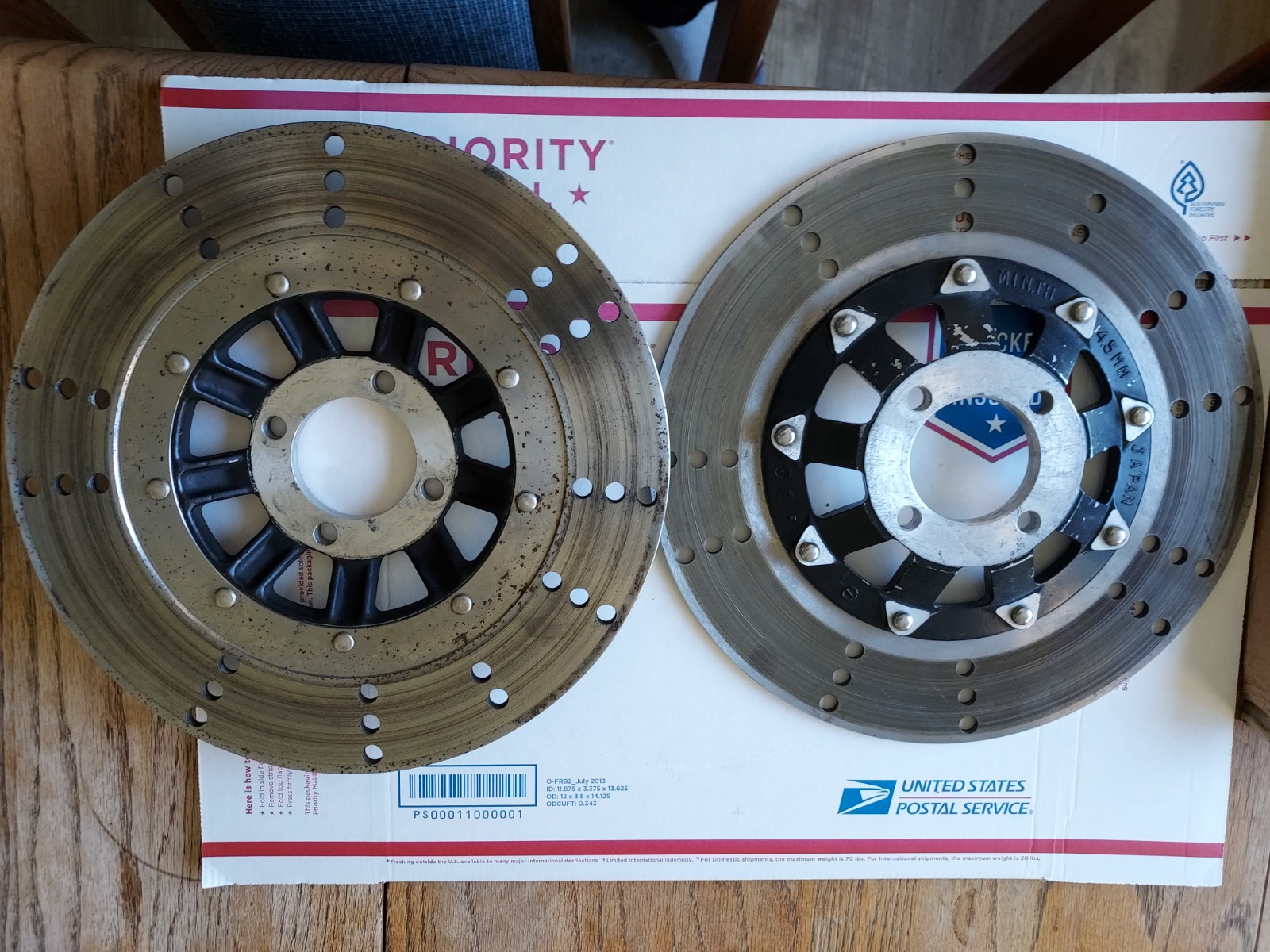

Got 2 front rotors off ebay. 4.97mm and 4.92mm left on them. Just shipped them to Tom at TrueDiskLLC I Michigan for refacing. Pretty sure I lucked out. Thanks to you all for the feedback and suggestions.

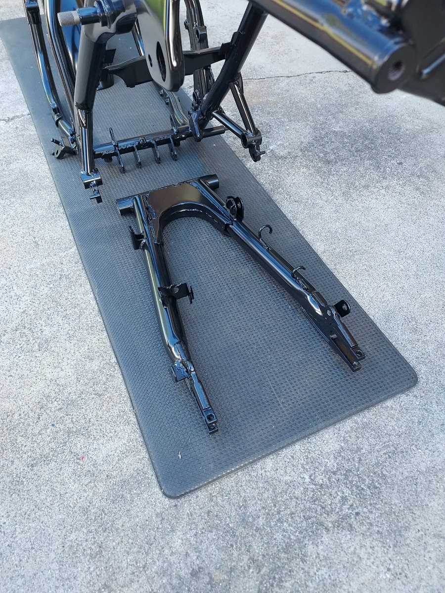

It certainly has been a while since I provided any updates. I will try to keep them in order of progress and give credit to all the folks who've helped out.

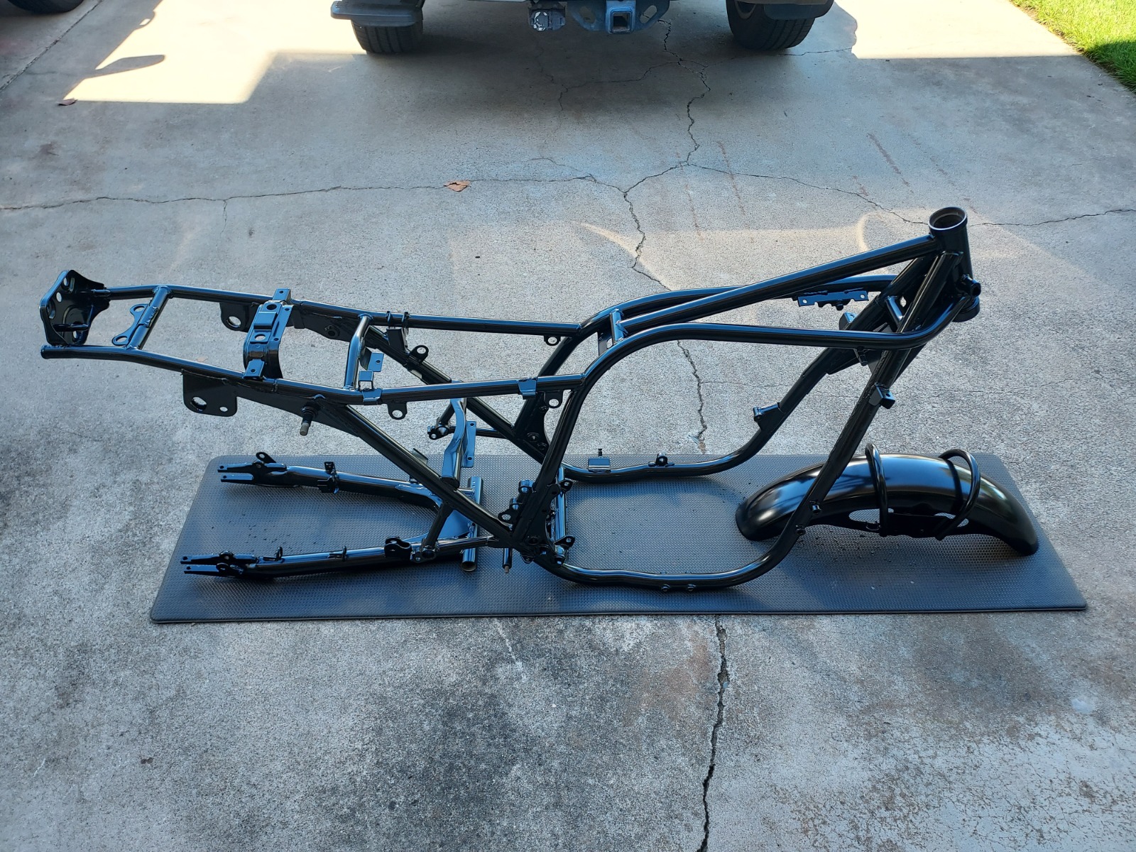

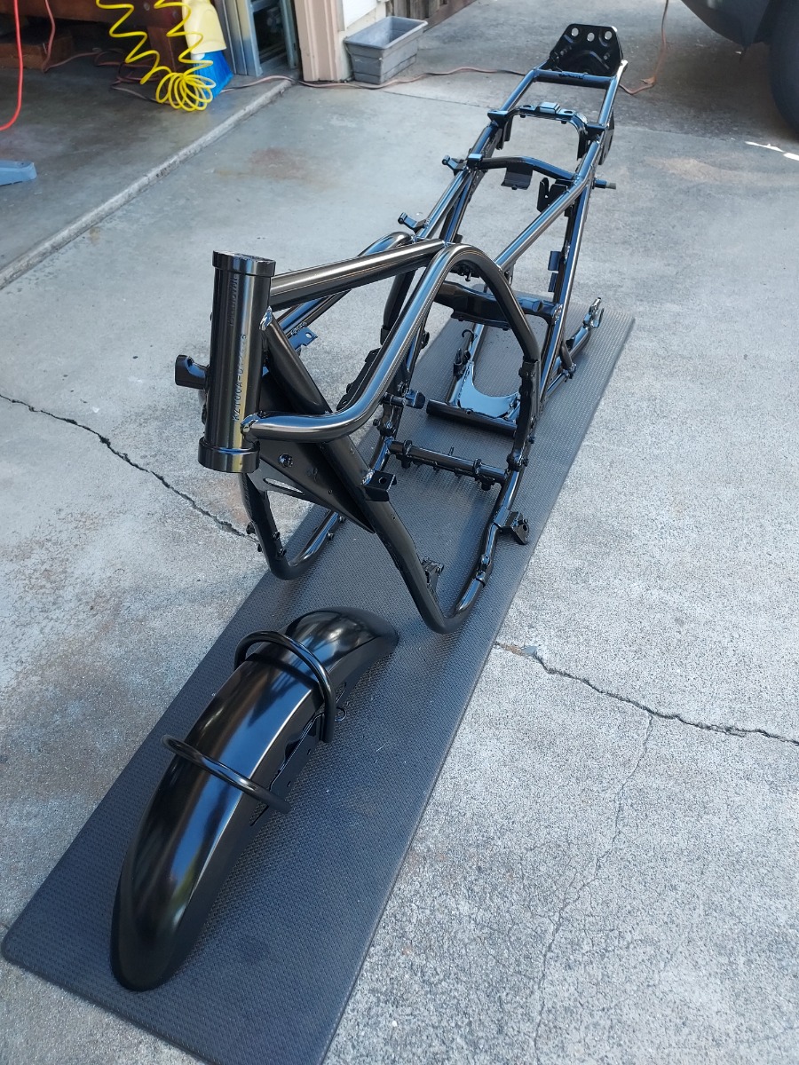

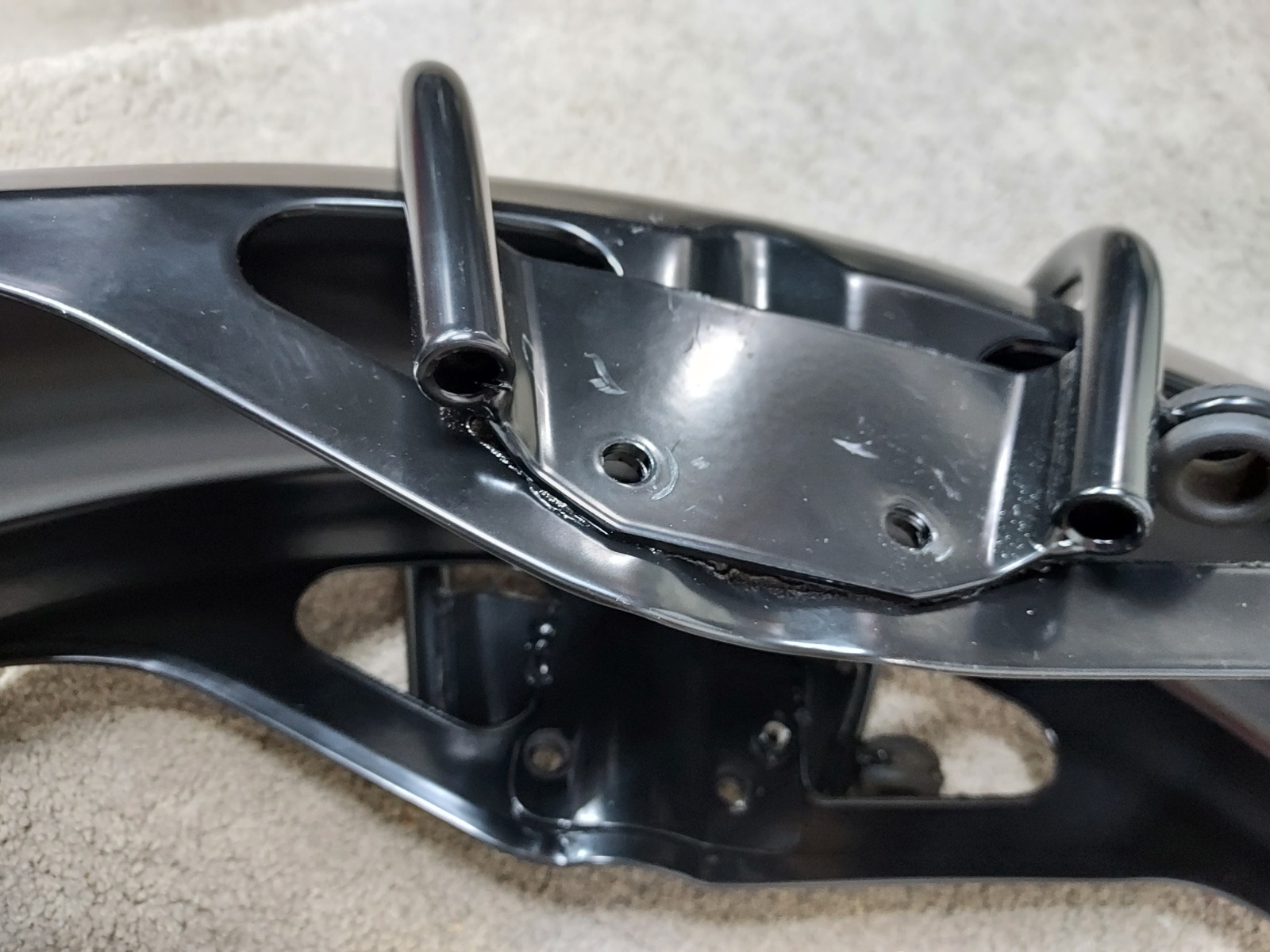

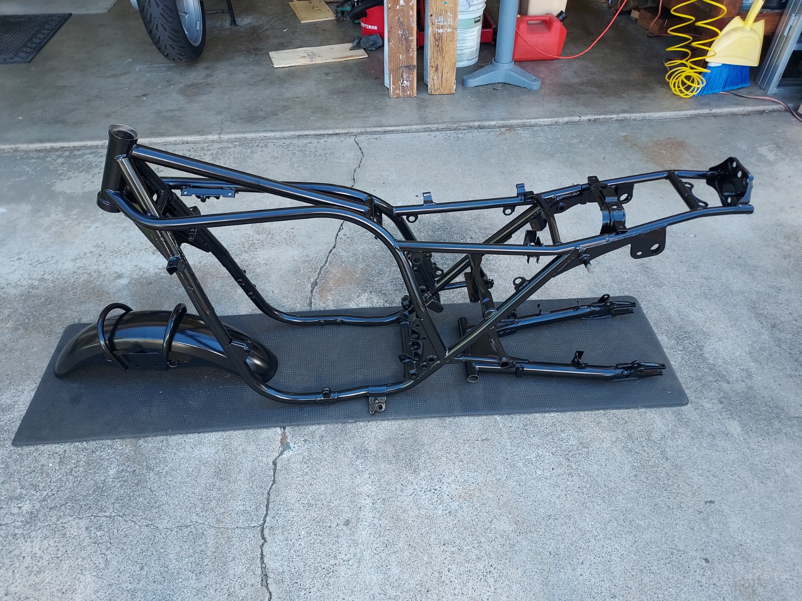

August and September 2024; had the frame and swingarm powder coated at Superior Powder Coating in North Sacramento, CA. Chris does an outstanding job and has helped me out on other projects (Norton, daughter's car luggage rack). Always straightforward with the estimates and reasonable, fast with the turn-around. Prior to handing off the frame, I was able to carefully remove the VIN label, which will be reaffixed once the frame is back in the garage. Unfortunately, the label has been misplaced at the moment.....
As you may notice, the PO chose to have the fork brace welded to the front fender and then repainted the whole thing. The paint was flaking off the chrome base so I decided to powder coat the entire assembly. More on that later.

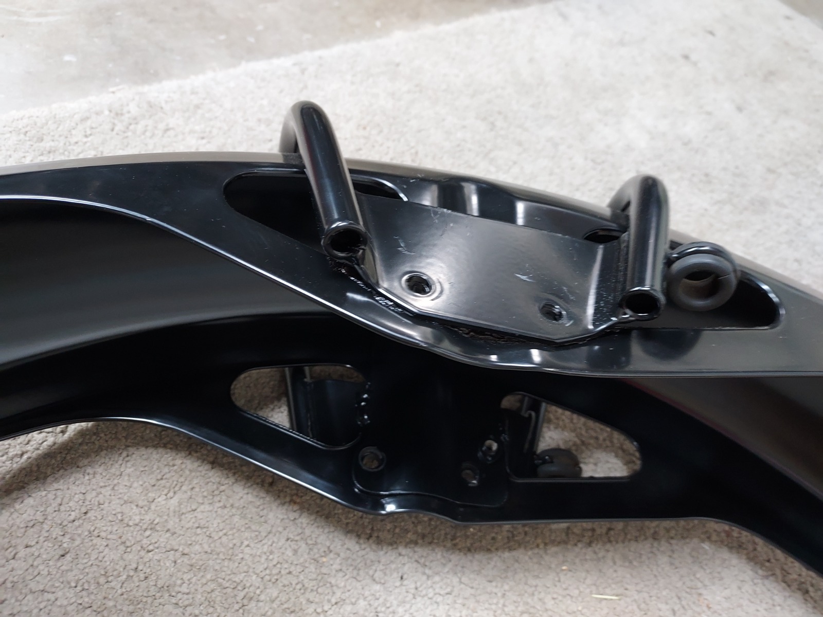

Swingarm turned out very nice!

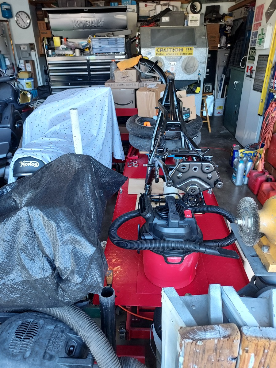

October 7, 2024 Finally managed to get the frame onto the work bench.
Please disregard the horrendous mess!!! I'm doing the best I can while attempting to handle all the other "Honey-do's"

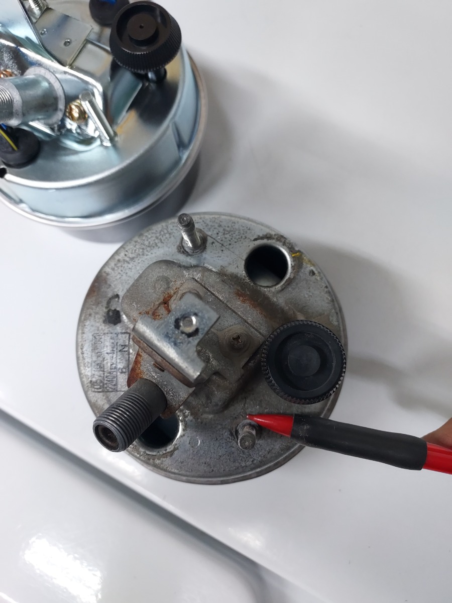

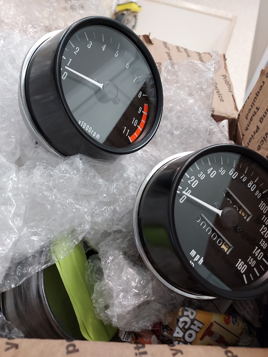

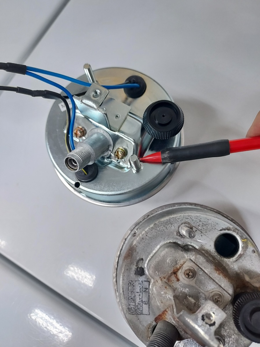

Instruments

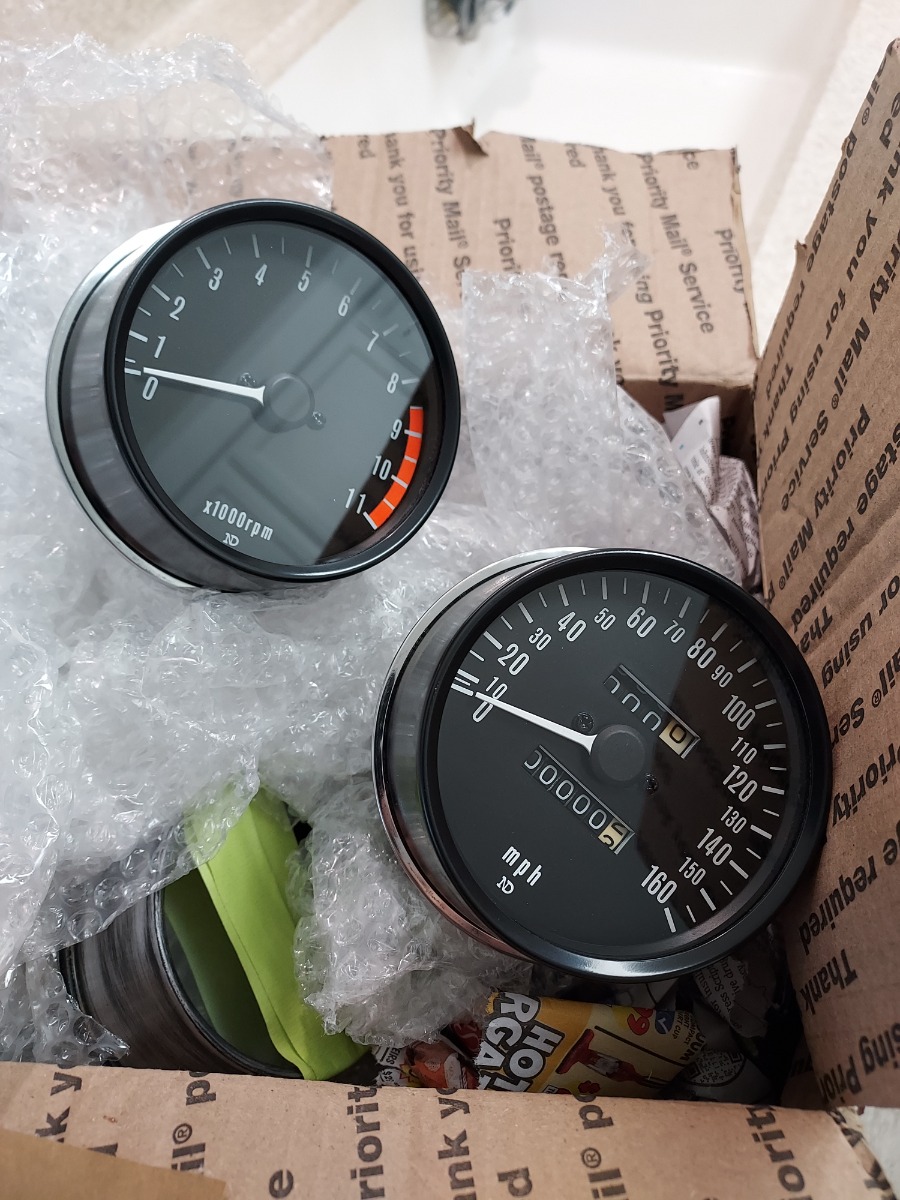

These pictures were taken on 10-8-2024. I originally ordered a set of aftermarket instruments (Taiwan repro) which appeared to be fine in the photos. Upon receiving them realized they would not mount to the oem bracket because the mounting posts were too close to the dimple in the back plate of the speedo. I ended up returning them and sending my originals to be refurbished. A bit more expensive but fantastic results!
Aftermarket vs stock
Originals after being reworked by Z-Resto Gauge Restoration. Great work!!!
Z-Resto
4522 Ryan Road
Conley, GA 30288
USA
zresto.com
email - 76kz900@bellsouth.net

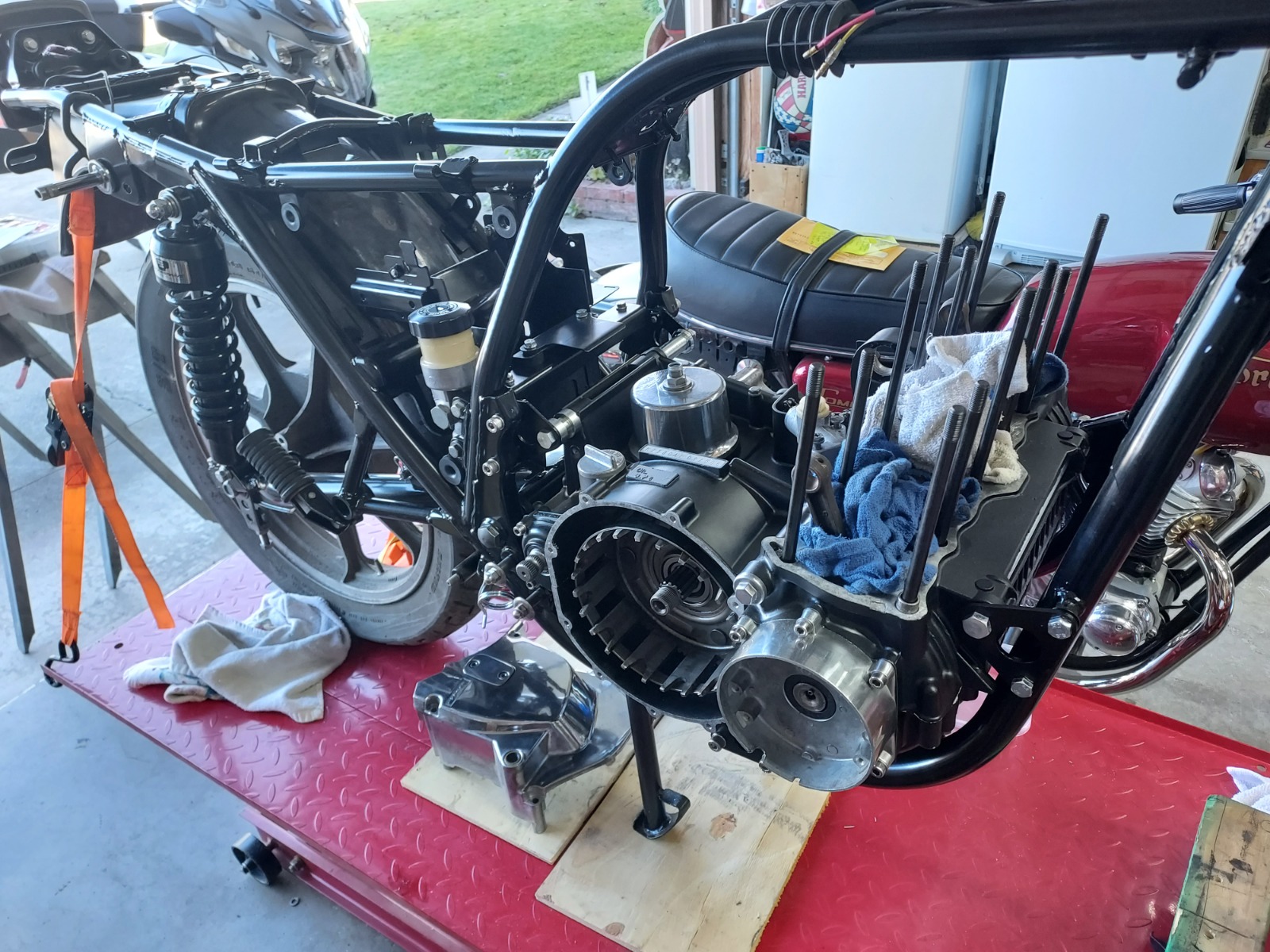

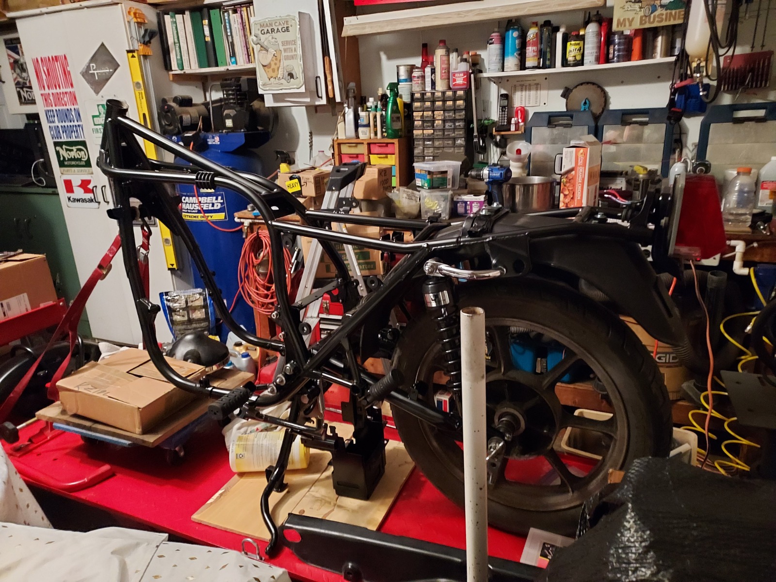

Time warp to late October 2024. Finished installing the center stand and swing arm with new Progressive shock absorbers. Put the old rear tire (still mounted onto the wheel) so I could have some weight n the rear and keep the front in the air while I assembled the forks.

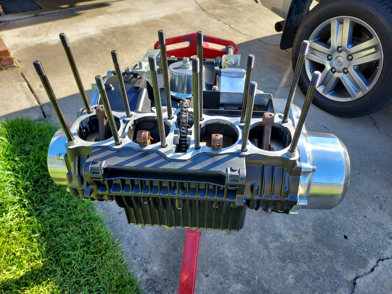

Got a bit stalled at this point as I decided to place the engine (lower assembly) in the frame before proceeding on the front end. Basically, took advantage of a friend's offer to help and installed in less than 30 minutes from the engine stand to the frame. NO dings on the powder!!

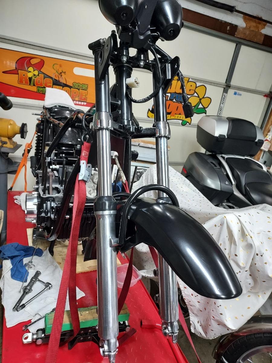

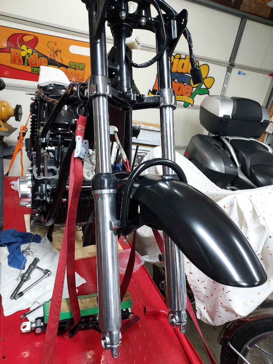

Front Forks.

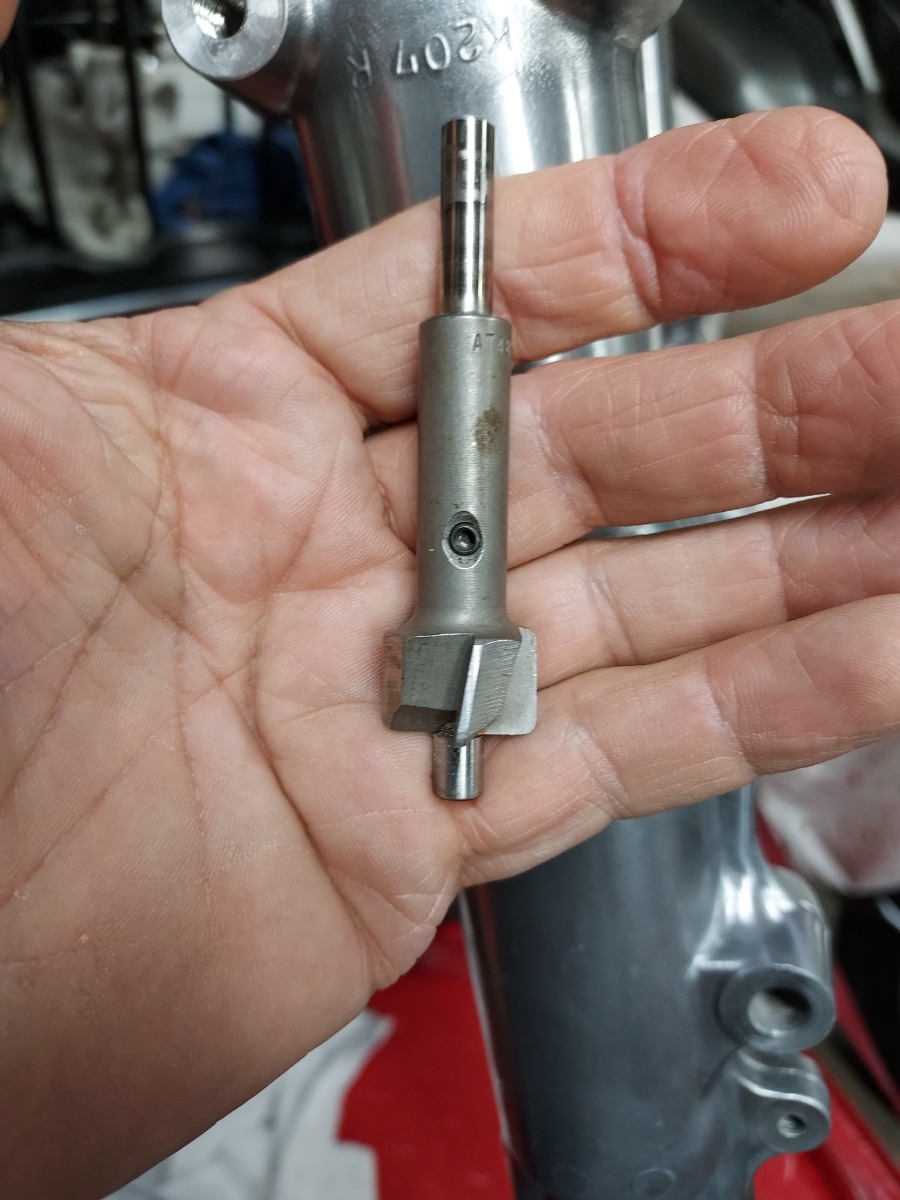

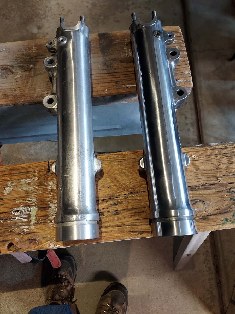

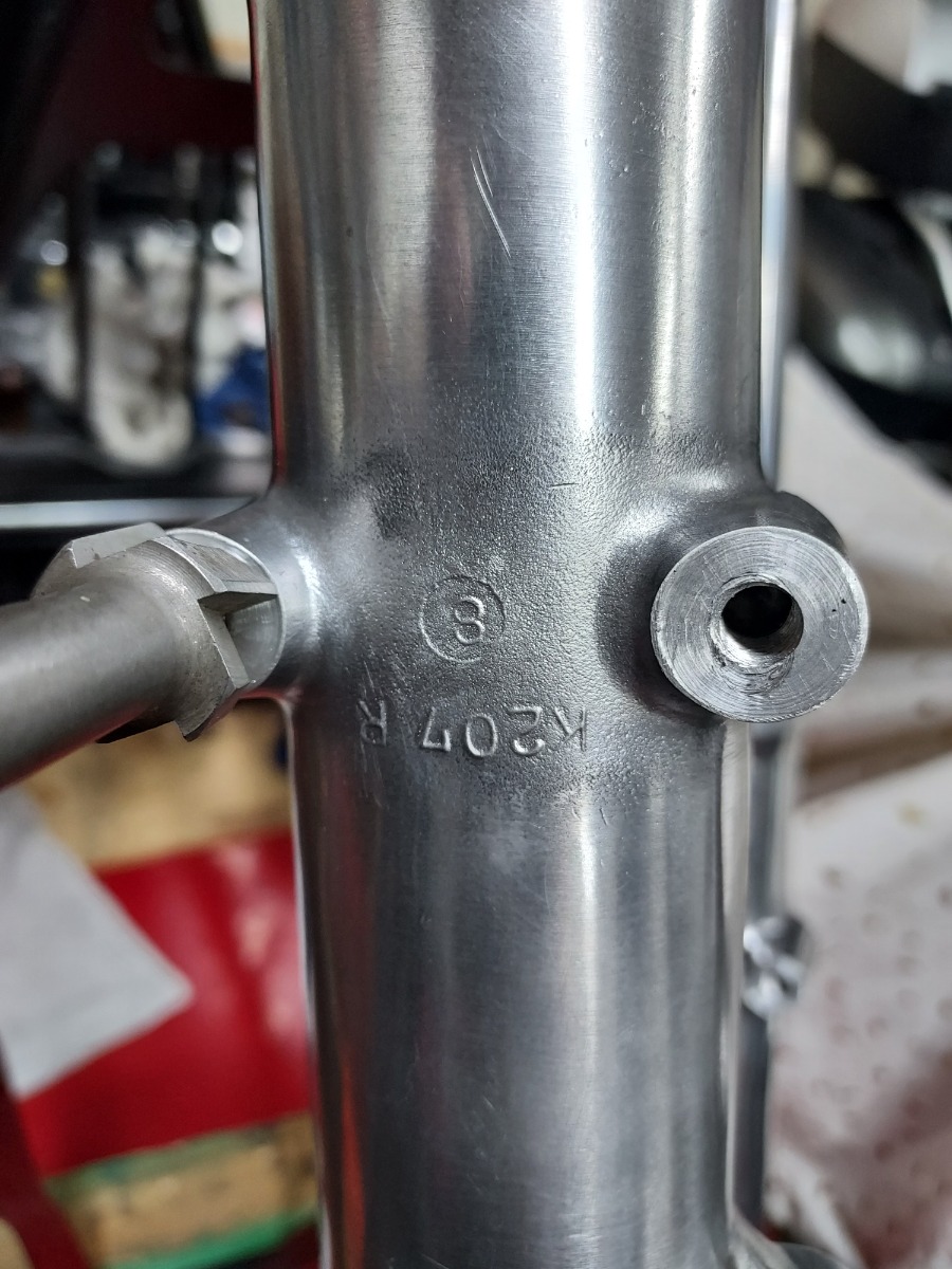

I'd planned to reuse/polish the original lower tubes. Upon disassembly, I discovered the fender bolt flanges on one were stripped out and on the other, the casting around the hole had cracked. Found two replacements on e-bay and polished them up. Assembled them with new upper fork tubes and race-tech cartridge emulators. Before / After polishing.
About that front fender assembly...... Taking another look at the brace welded to the fender, I realized the width of the assembly was about 4mm larger that stock - without a brace. I believe this was why the previous outer tubes were buggered. I obtained a piloted fly-cutter and managed to 'machine' off around each bolt hole on the new outer tubes. I did end up having to place a couple of shims to make everything proper but the fender/brace fit nicely!
