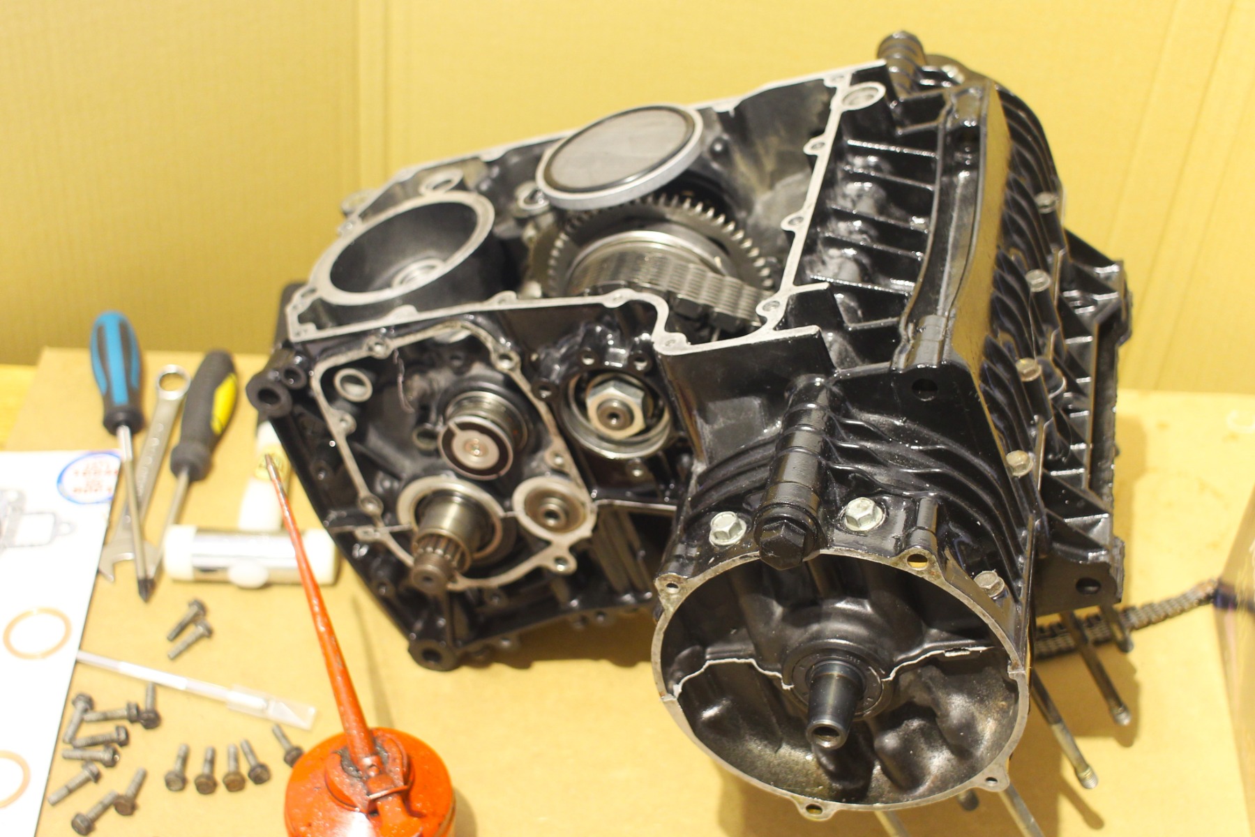

Anyway, I'm now able to work on the bike again, with the bottom end of the engine done. Just awaiting a few parts to fit the top end.

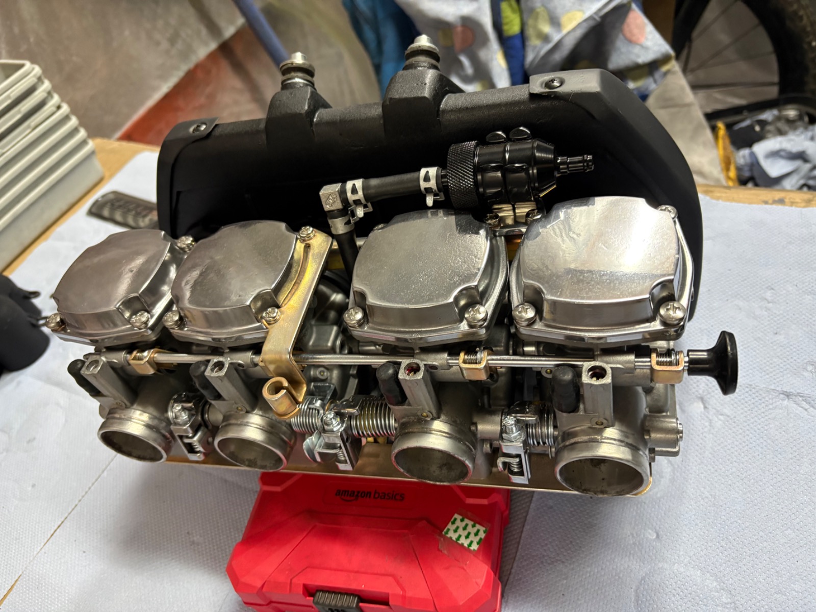

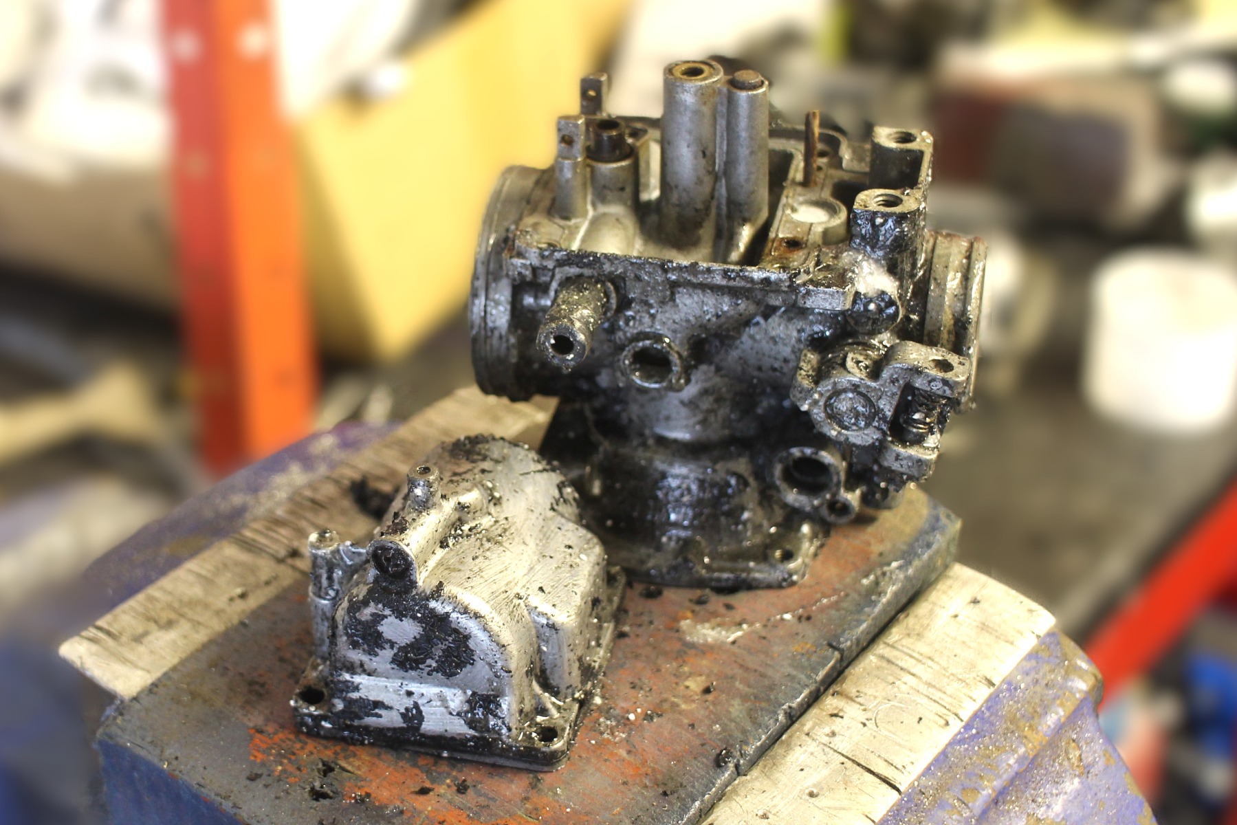

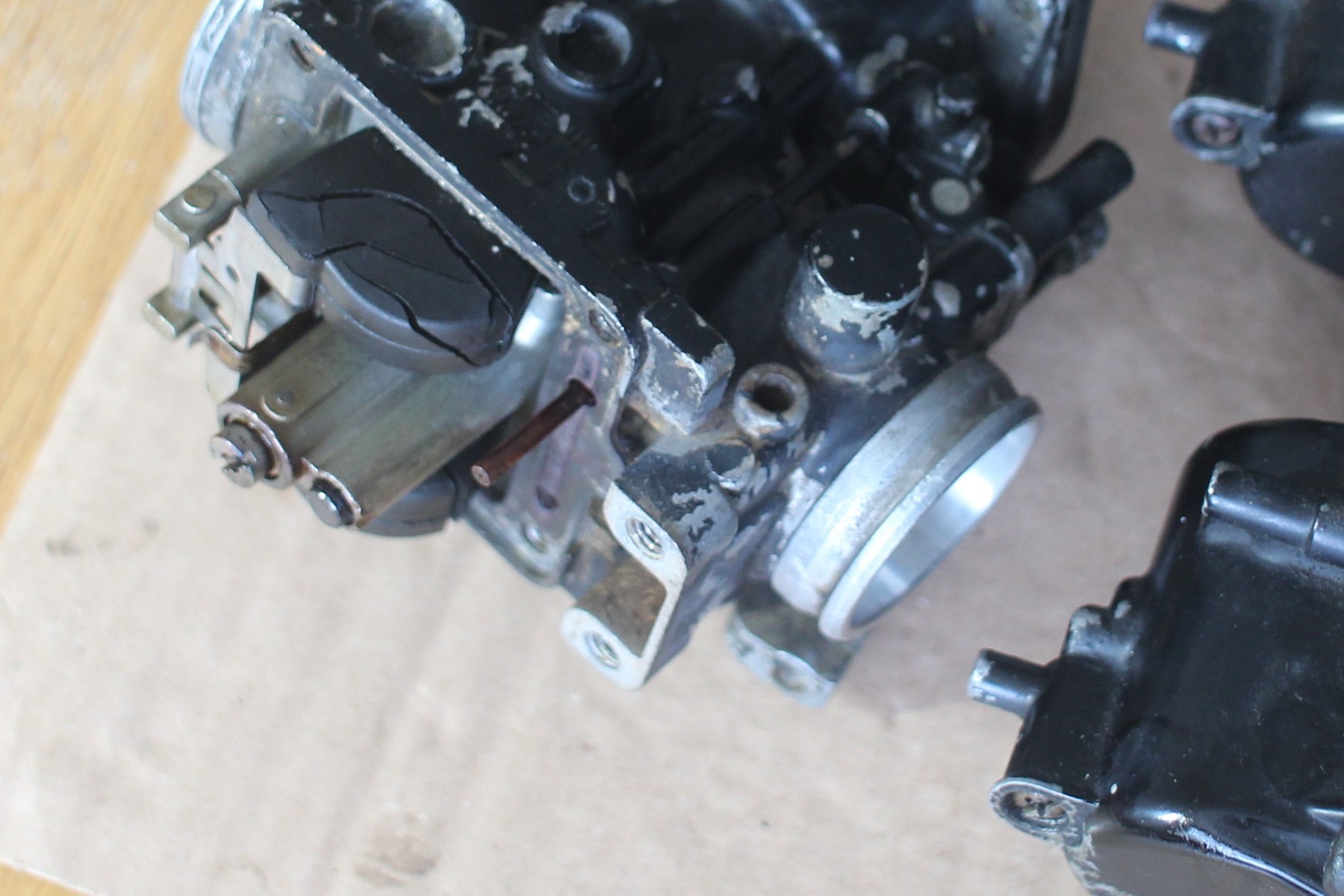

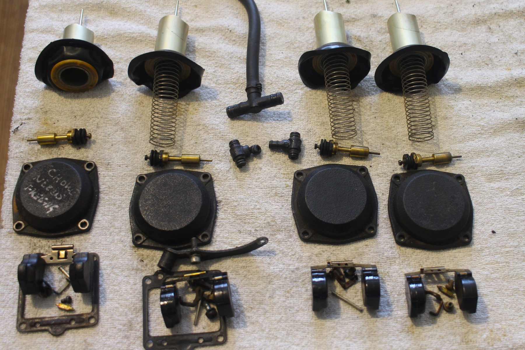

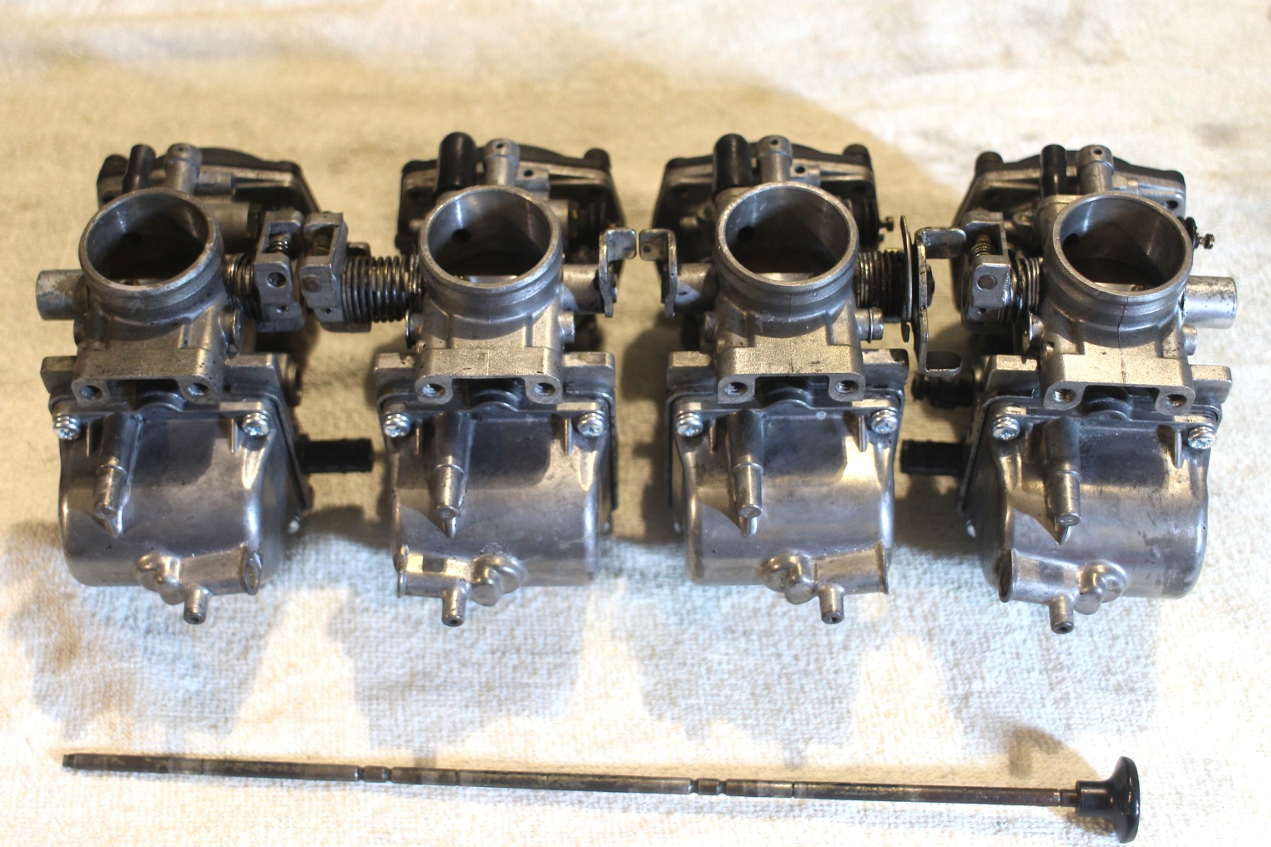

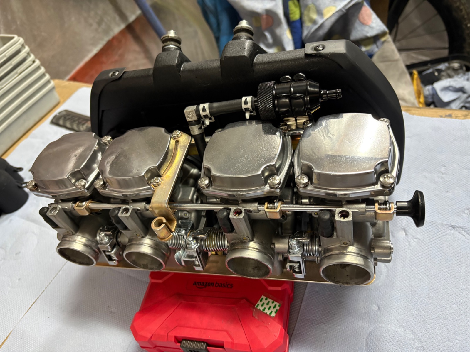

Moving on to the carbs, I did find one carb had a oddly damaged float, along with a missing spring and rubbish black paint.. took hours to remove it all and rebuild the carbs. The rusty choke rod is no longer available new, so going to try to make one in stainless.
What free site is everyone using instead for image hosting?
One of the boxes of engine parts that should be in my garage has vanished. Searched everywhere for it, but no luck. That box contained all the engine covers, camchain idler gears, blades etc. Have to find replacements on ebay/Z Power. Very annoying. No doubt in six months time, the missing box will turn up..

Replating would be ideal, I don't know any reliable plating companies near me. I may buy a DIY kit at some point and see how that goes.

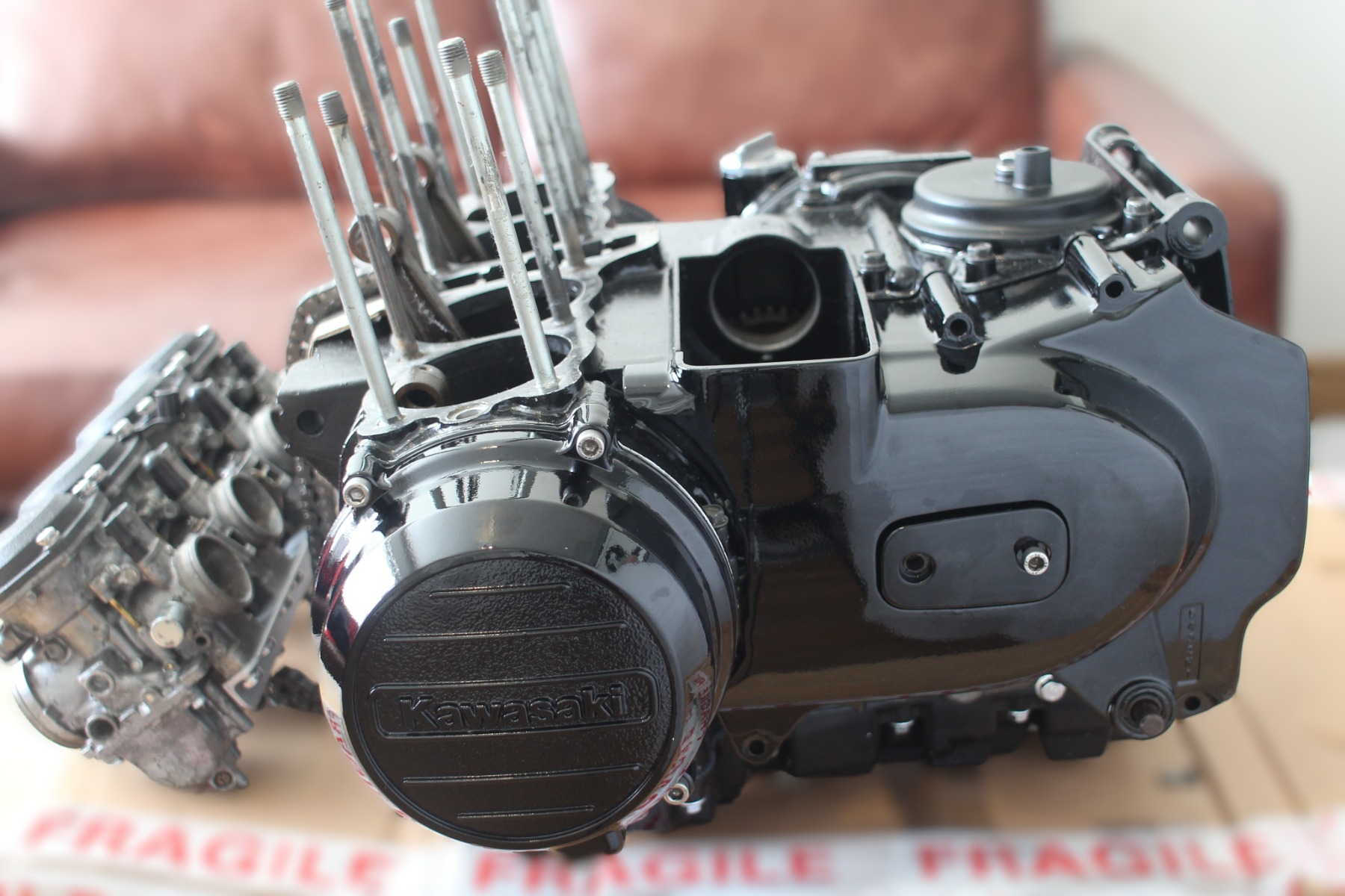

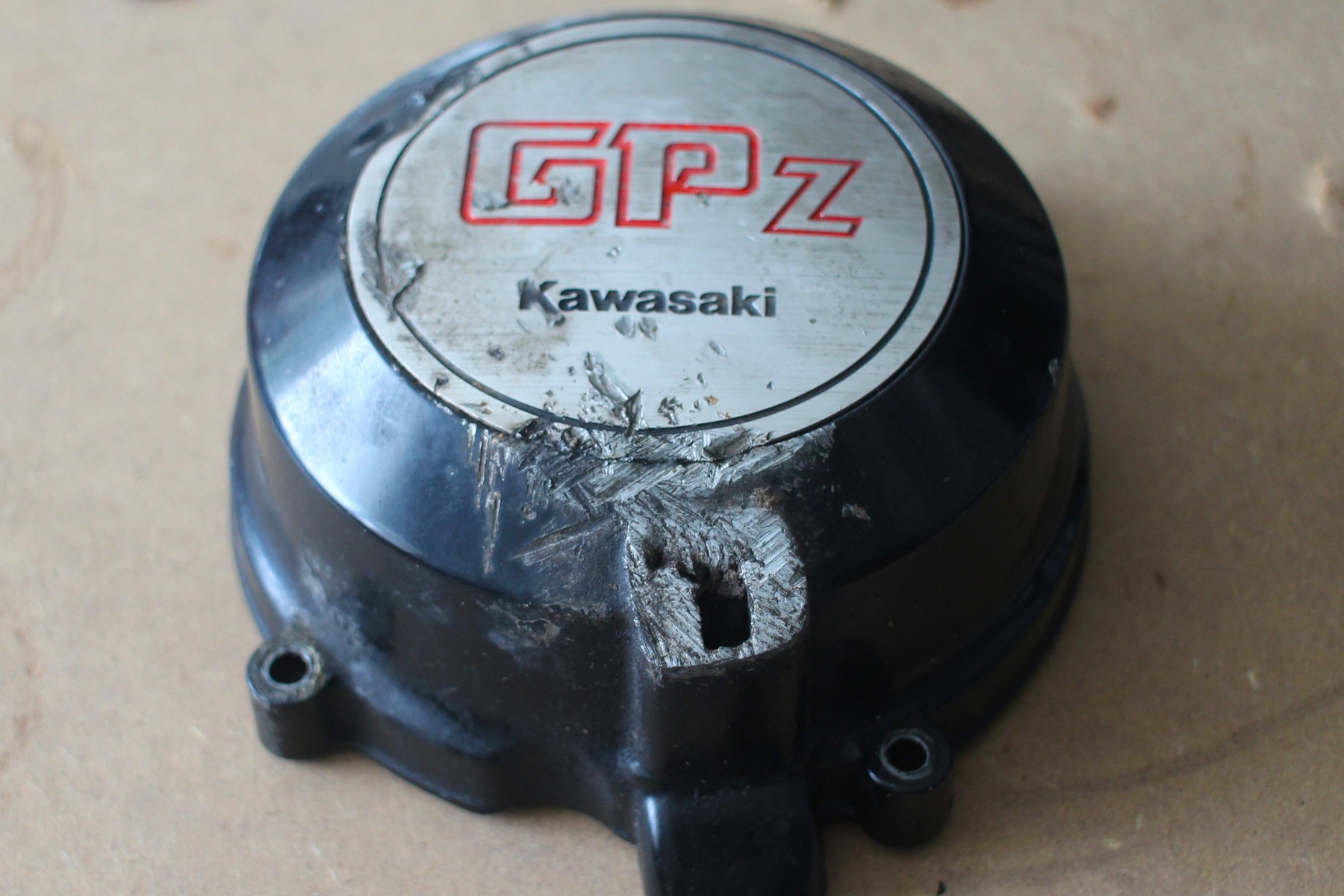

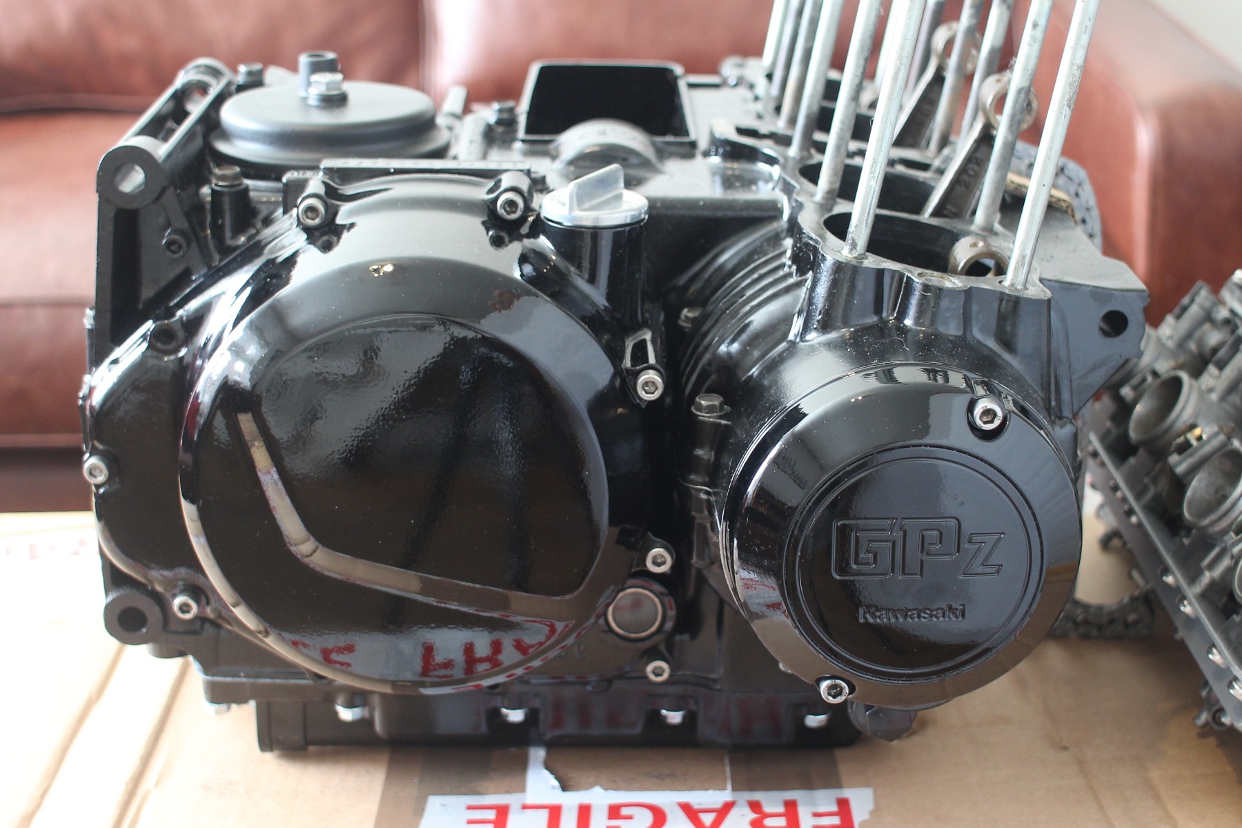

Got the engine covers back from being powder coated. The original alternator cover was damaged, so I bought an older style one instead. Loosely fitted them just to see how they looked on the engine..

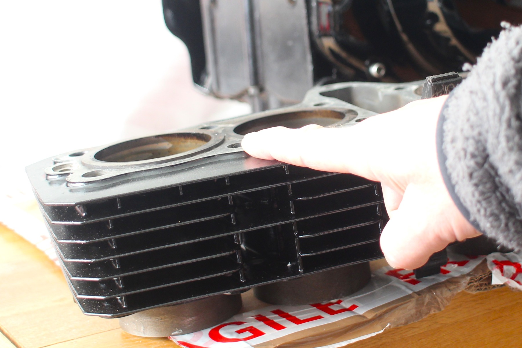

About to fit the block, when I noticed a problem, one of the liners had moved. Possibly with the heat used when the block was coated, or when a broken fin was repaired.
Took it to my mate and we used his hydraulic press to get it flush with the block deck again. Its now much better, but not perfect. There's a tiny raised area you can just feel with your finger tip. Not sure if its worth having the head ground, that could cause other issues.
Have to remind myself its almost 50 years old, so I'm going to try the' 'wet n dry on a plate of glass'' method to see if that improves things..

That's too much. Heat the block and use your press again. Wait until everything is cooled before releasing the pressure. Yes I know you have fresh powder coat, you'll have to be careful heating.

Lee have you powder coated the block ? I believe the powder melts at around 250 degrees so maybe an issue?
