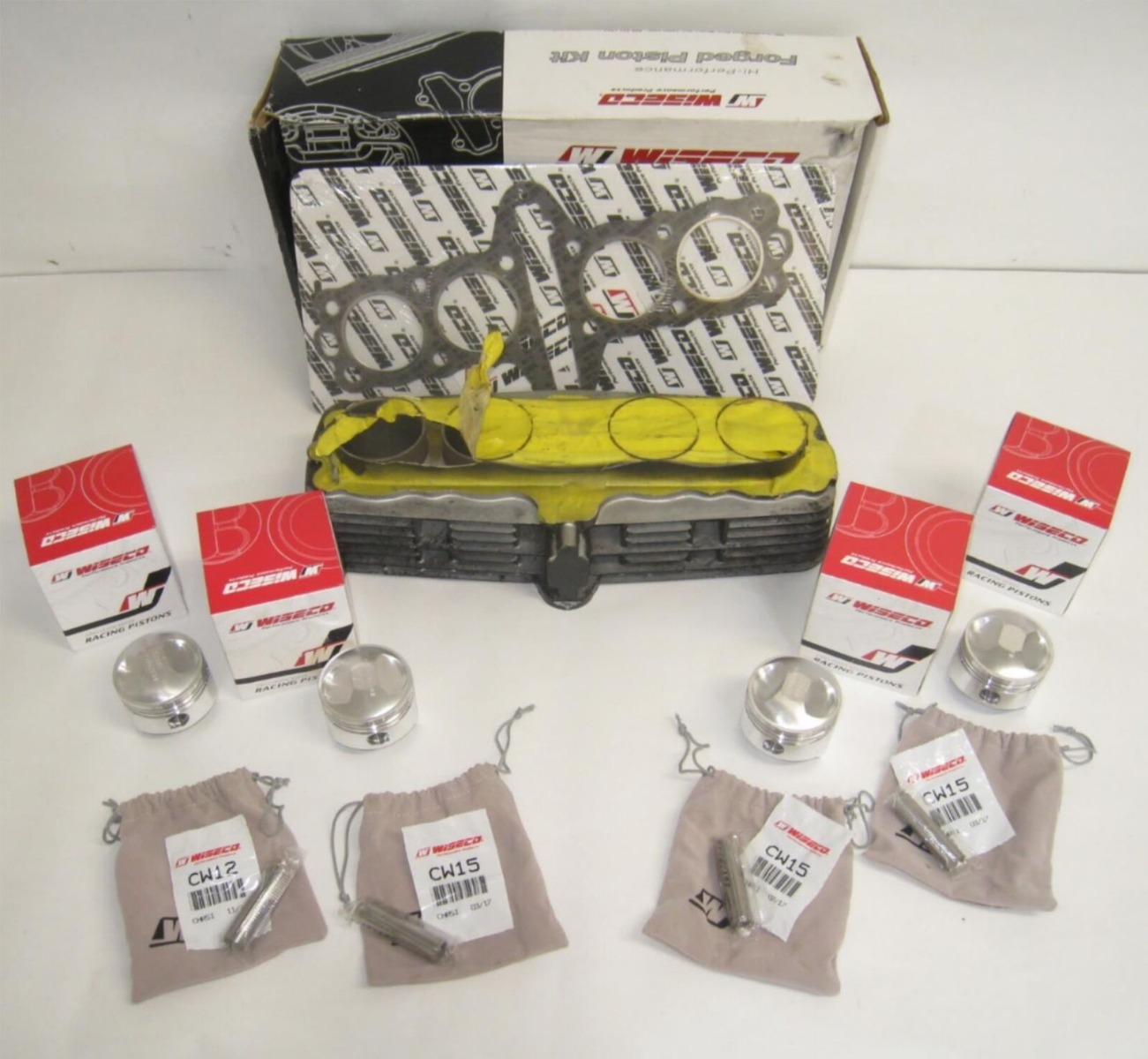

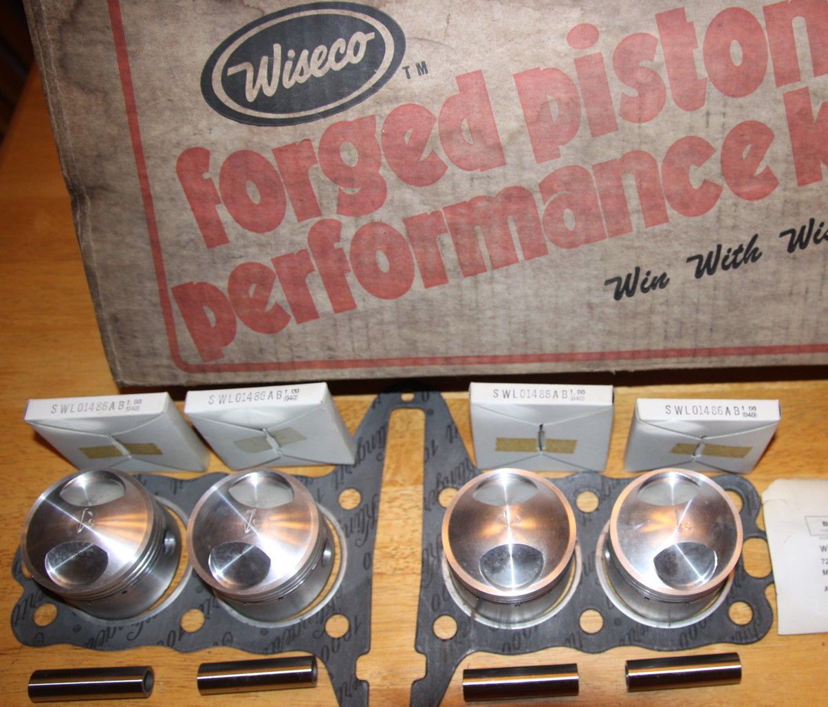

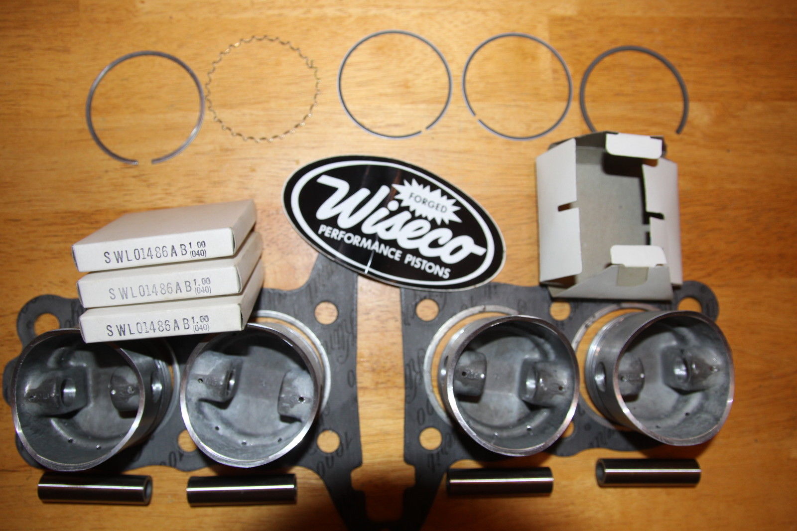

Well, the plot thickens...I have stripped the engine top end and covers, to remove the engine from the frame, and while examining the cylinder's found that somebody has already done a big bore conversion. However, its not the 700cc but a bigger one. The pistons measure 64.87mm, not 64 as on my 700cc kit. WTF Over? No brand name other than a "w" on the bottom. They also have a larger skirt. No sign of blow by either, looks like a 10.1 CR as well. The barrels are the 650 ones, so it's not a 750 set.

A 65 mm piston gives 720 cc, "W" is Wiseco, the liners will be on the thin side unless someone put sleeves in it (rare)

03 Dec 2023 13:18A 65 mm piston gives 720 cc, "W" is Wiseco, the liners will be on the thin side unless someone put sleeves in it (rare)
yeah they are pretty thin, definitely the original sleeves. They seem fine no galling or ringing. Didn’t know wiseco made a 720.

They discontinued the 720 kit over 20 years ago maybe more. You can still get rings for them but I don't think Wiseco sell the rings.
That kit bore has about the same liner thickness as boring a 750 to 810 cc.
I have a NOS 720 kit I bought a few years back, and have a barrel bored for it sitting on the shelf till I use it. I will be running a oil cooler on my engine as it will have a few other go fast goodies attached.
