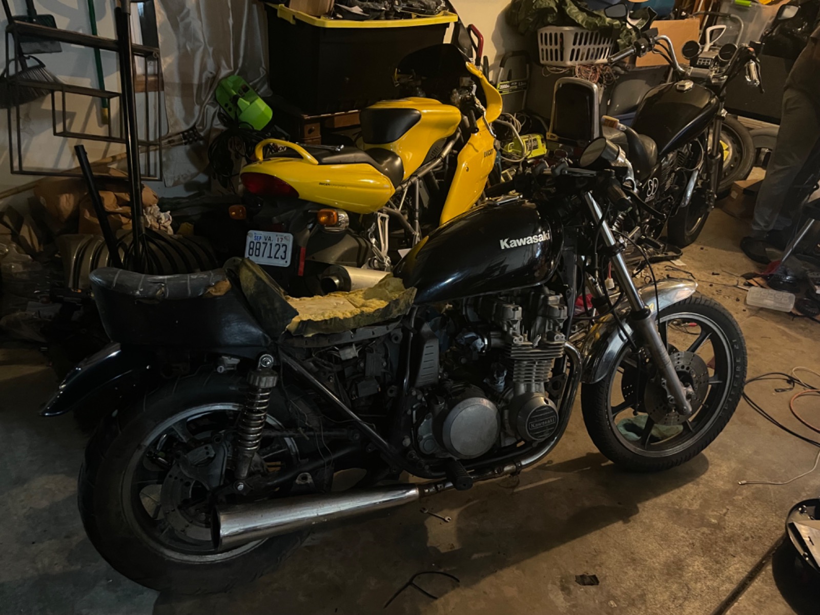

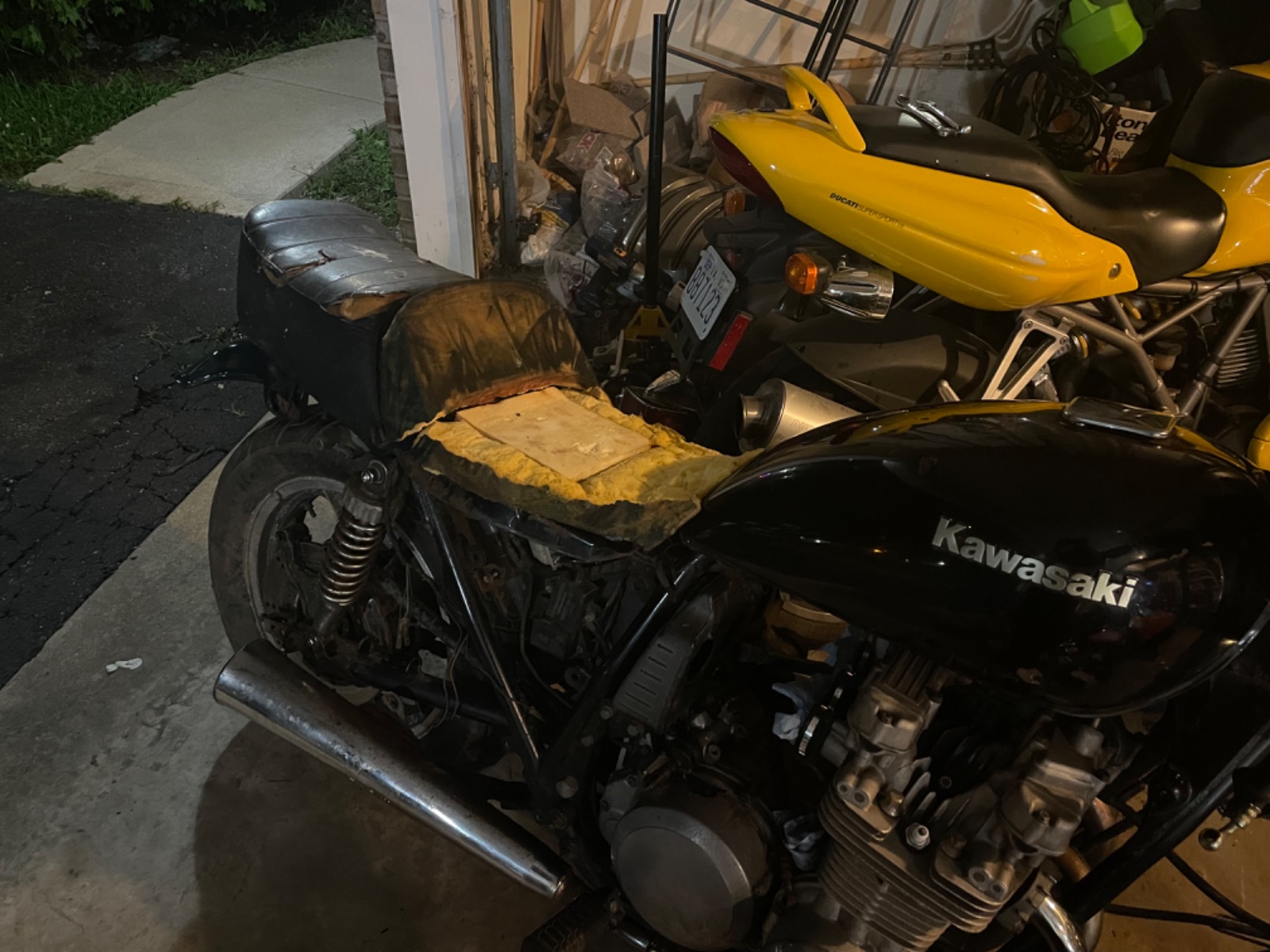

Just picked up this 81 750 ltd and she is beyond rough. It’s an electrical nightmare so I’m currently sorting all that out. Then I will be going through the brakes   Hopefully when I get it started the engine is solid and runs strong.

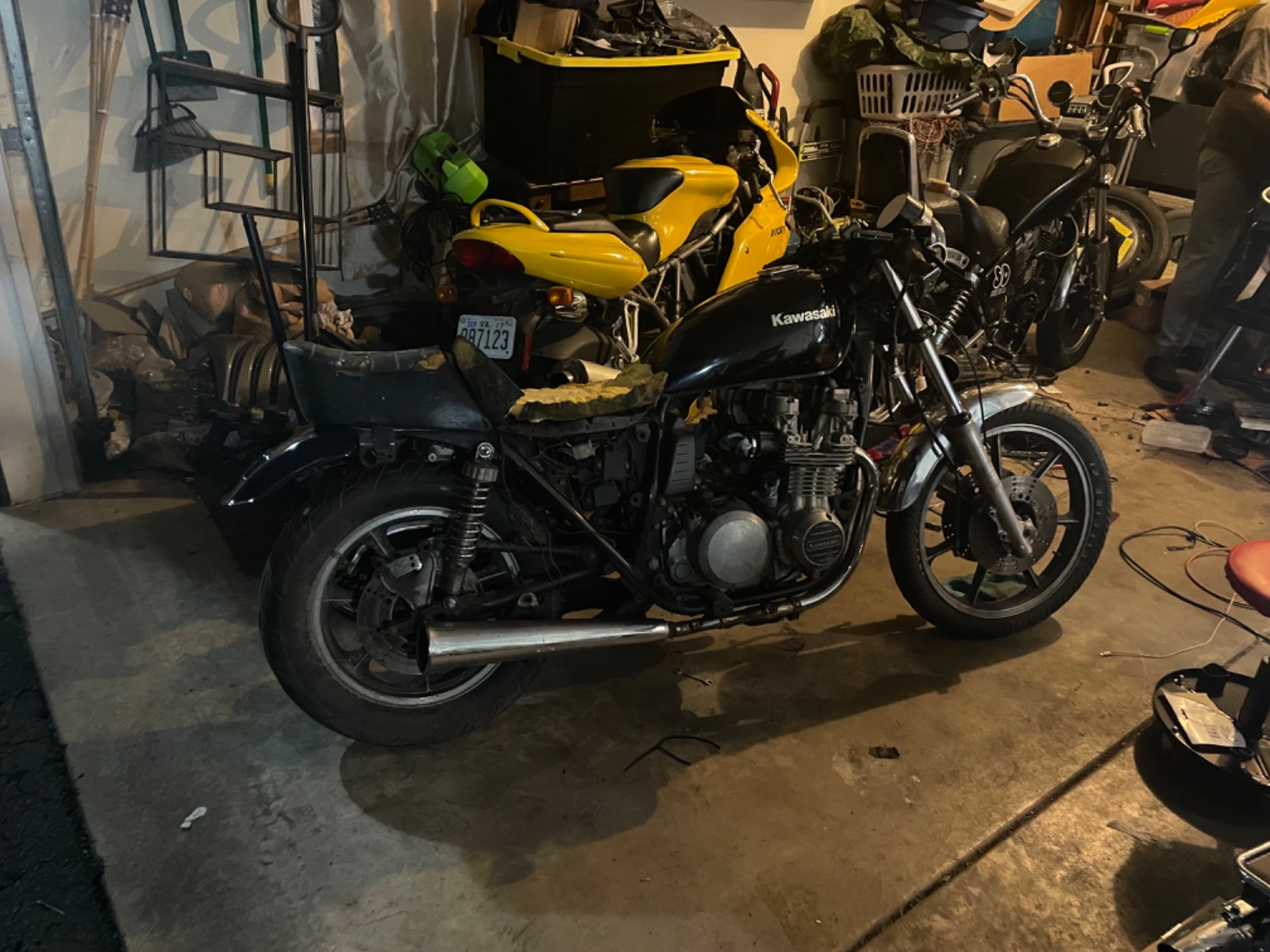

Was playing around with the bike a little bit today. Kinda liking this set up.

How much did you drop the front? You going with struts or short shocks in the rear and what is the seat from? It seems to fit fairly well.

I didn’t drop the front end any yet. Going with hard tail struts. And the seat is off of a 2013 Harley Electra glide. It does fit really well but it’s bulky.

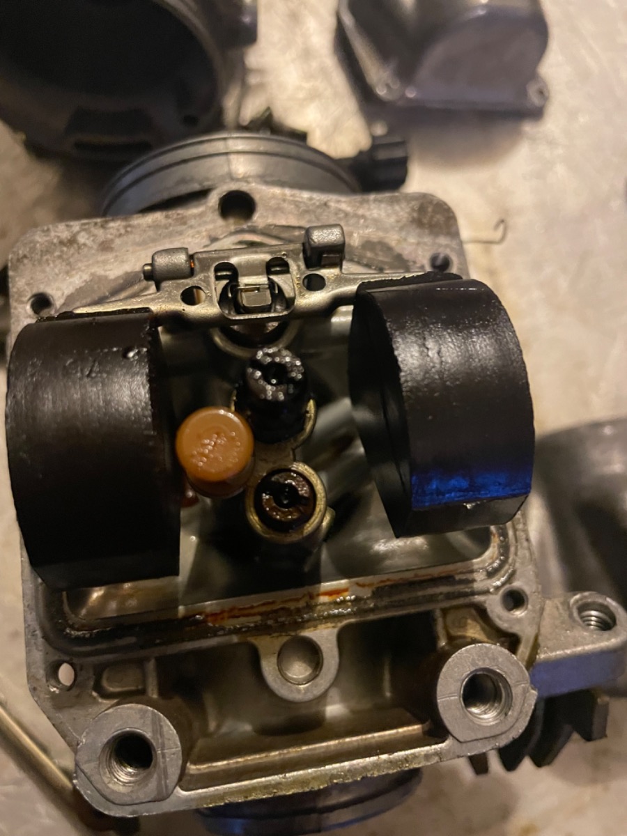

Re: 81 KZ 750 ltd.
04 Aug 2023 15:44
#887951

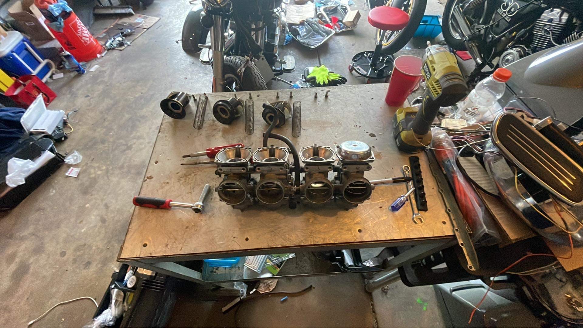

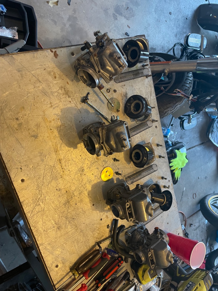

Well I pulled the carb’s apart and what a mess they are. Someone has definitely been in them before that didn’t know what they were doing. Have them soaking in some simple green and water they are cleaning up nicely. Good news the rubber diaphragms were In perfect condition.
74 Z1a 900 (Apart and making it better than ever)
77 Kz 650b (Threw a rod, going to sandwich in a 900 or 1000 motor)
76 Kz 400d
05 ninja zx-636
81 Kz 750 Ltd
Darien, Illinois
  • Nessism
  • Nessism's Avatar
  • Posts: 8057
  • Thanks: 3443
Re: 81 KZ 750 ltd.
05 Aug 2023 06:30
#887965
Nice to see someone doing a proper carb clean-up, with full breakdown.  I've got full O-ring kits for those carbs, in case you are in need.  If you want to source them yourself, these are the required sizes...
Pilot Screw: 1.2 x 2.0
Pilot Plug: 1.5 x 2.8 or 1.5 x 3.0
Fuel Tee, Transfer Tubes: 2.0 x 5.5
Drain Screws: 1.4 x 4.0 or 1.5 x 4.0
Float Bowl: 2.0 x 67
The following user(s) said Thank You: oldkaws4ever

Re: 81 KZ 750 ltd.
06 Aug 2023 12:31
#887999
A few tips I've learned (the hard way) regarding those carbs...
The primary main jets love to seize in the carb body.  Some heat may help, but often times, the slot gets buggered.  And I've had carbs where the threads pulled out of the carb body before.
The bleed pipe is below the primary main, and needs to come out for cleaning since the passage is super small.
The fuel Tee plastic part sometimes cracks.  Inspect carefully.
The pilot screw spring, O-ring and small steel washer often stay down into the carb passage when you pull out the screw.  A piece of stiff wire with a small J bent into the end will help get them out.
Using super glue in the float bowl groove helps hold the new O-ring in place.  Tape the O-ring down, until it dries, then install the bowl.
Keyster float needles are the best, other than OEM Keihin.
The choke plates are fiddly to get aligned properly.  I install them with loose screws on the butterflies, then snug down the screws after everything is closing smoothly.  And use Red loctite on the screws.

Re: 81 KZ 750 ltd.
07 Aug 2023 19:12
#888038
Do you have float bowl gaskets as well?
76 Kz 400d
05 ninja zx-636
81 Kz 750 Ltd
Darien, Illinois
  • Nessism
  • Nessism's Avatar
  • Posts: 8057
  • Thanks: 3443
Re: 81 KZ 750 ltd.
08 Aug 2023 07:24
#888044
Those carbs use an O-ring to seal the float bowl.  Not a gasket.  And yes, i have them.  They are round, and require superglue or some adhesive to hold them in the groove befor installing the bowl.
Contact me here if you want to discuss further...

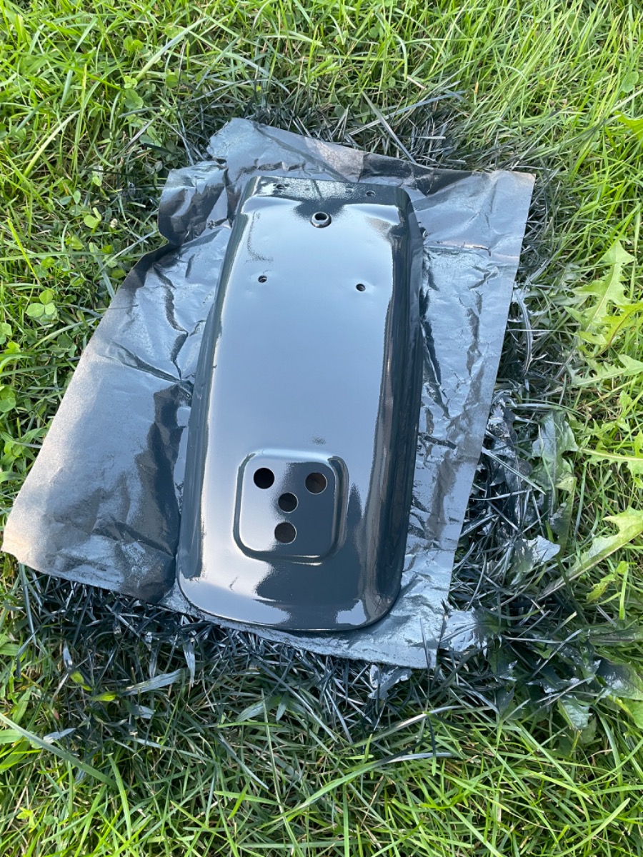

Re: 81 KZ 750 ltd.
15 Aug 2023 19:22
#888311

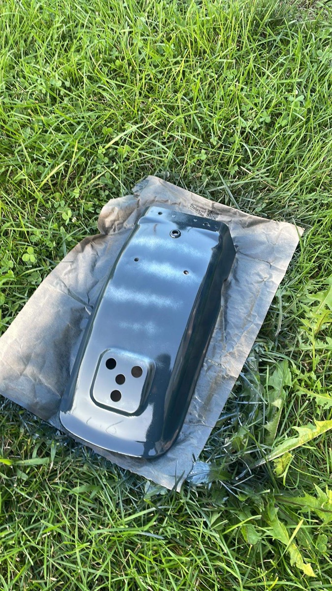

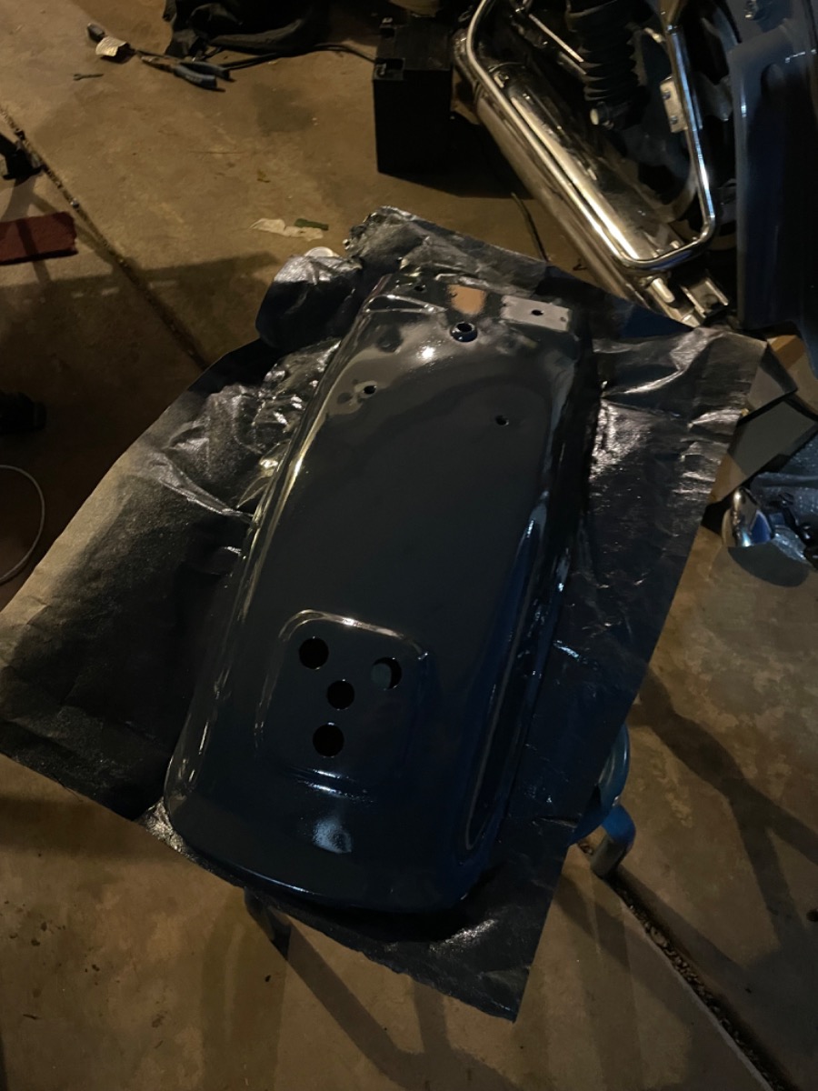

So I’ve gone a slightly different direction on this build. I’m going a cafe racer route with it. I ordered a set of clubman handlebars and bar end mirrors. Was starting to clean up the chrome and realized that it was pealing on the rear fender pretty bad. So I sandblasted it and painted it gloss black. Got to looking at my mufflers and they are literally rotted away on the inside. I might try to find a cheap 4 into 1 for it or figure something out for the mufflers. Was honestly thinking about cutting off the mufflers past the crossover tube and welding on some exhaust turndowns to give it that muscle car side pipe look. Maybe even fab up some baffles to slide in and out. Here is the rear fender.

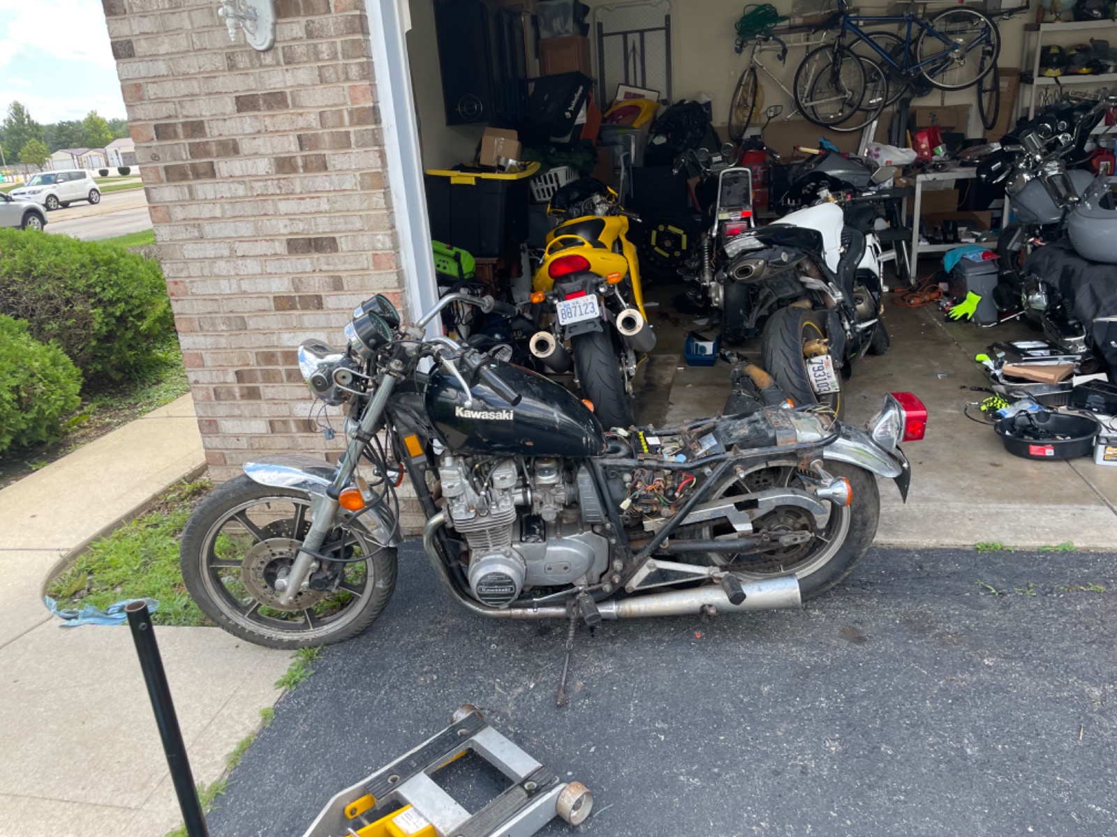

Re: 81 KZ 750 ltd.
16 Aug 2023 21:01
#888350

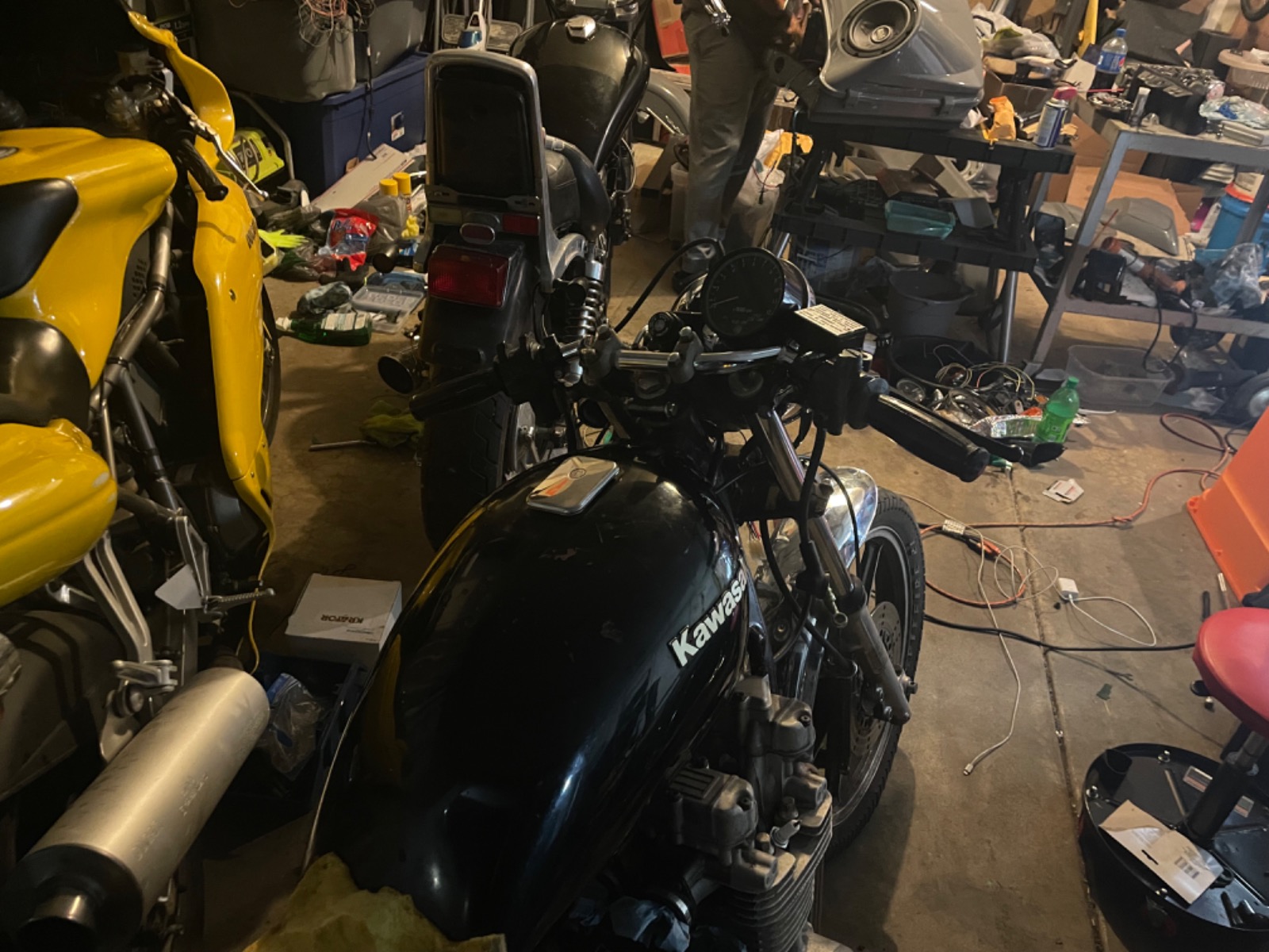

Got the clubman handlebars installed and a few other things. It’s starting to look like a bike again lol.
