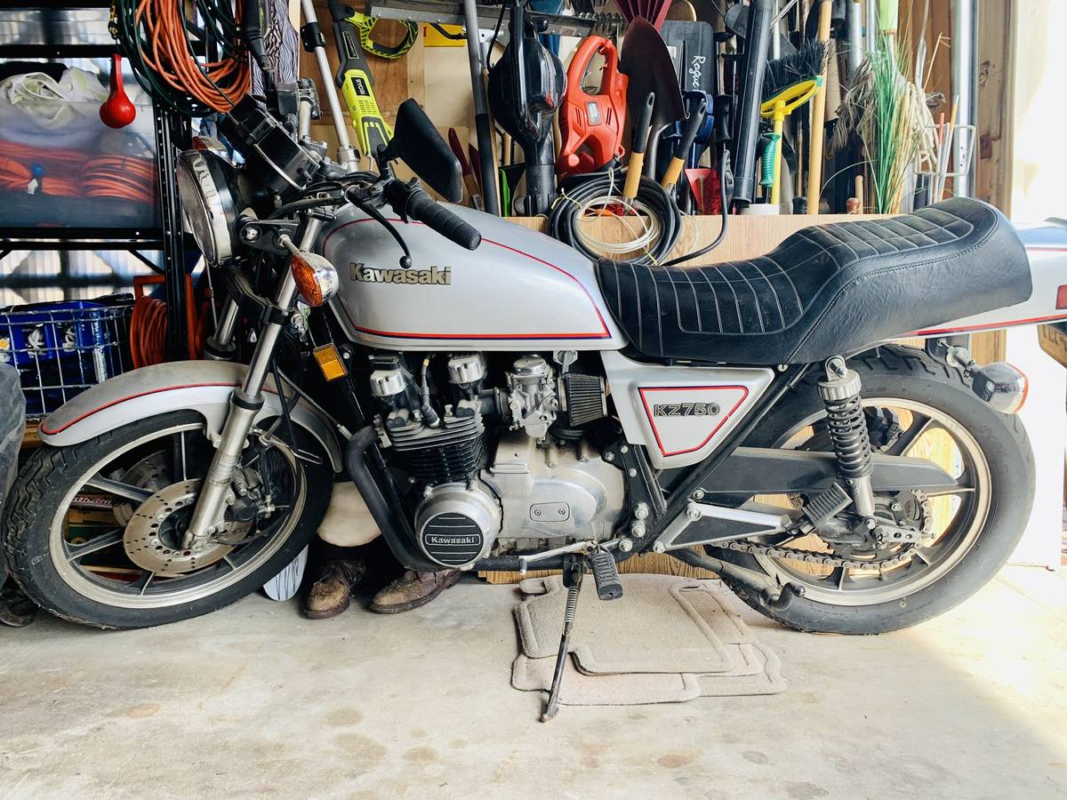

Found this silver one with 20K miles recently. Owner said it sat in garage for 11 years but ran well prior to being parked.
So far I've gotten a battery for it and pulled the carbs yesterday. They were pretty gummed up, visually not too bad but the slides were stuck. Had to push pretty hard to slide them out but got 'em.
Electrically all seems to work except turn signals come on but don't flash (hazards do flash). Common issue it seems. New flasher didn't help but I got the old style one. (Edit: Didn't realize there are two flashers. The turn signal flasher was bad so that's fixed.)
Pulled the plugs and sprayed fogging oil down cylinders. Oil looks clean through the window so going to try to spin the engine today but not start it yet.
I'll load up more pictures as I go along. This shot is in it's prior home:

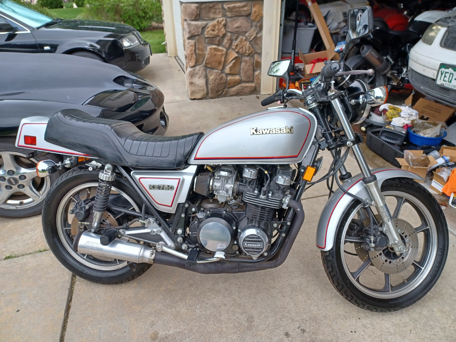

Looks like it's in pretty good shape! There are a few of us on here with this same year/model bike.

Very nice looking, considering 11 years in hibernation. You should be able to find most parts on Z1 Enterprises.

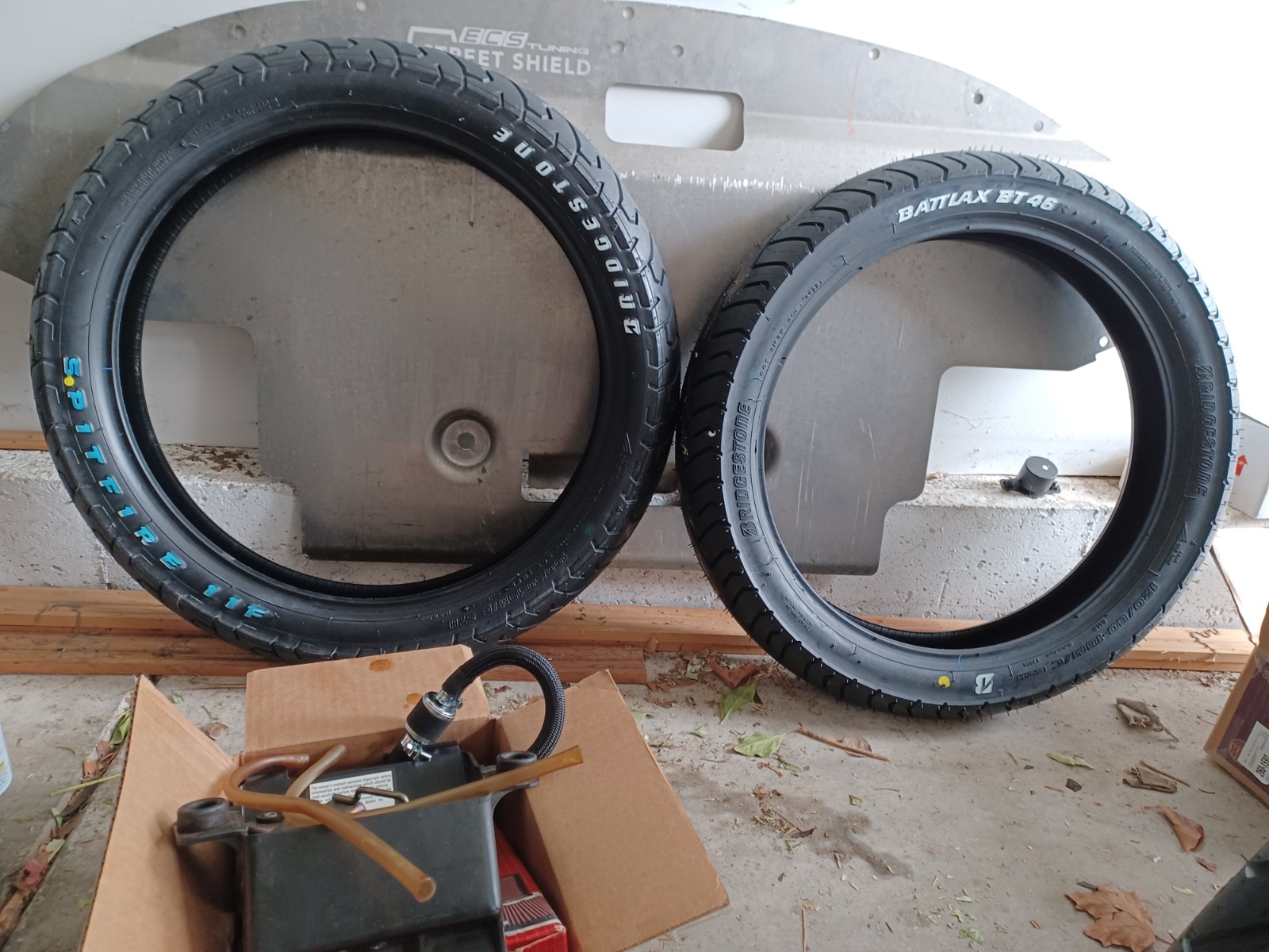

So I got new tires already. It has Dunlops on it that have tread but must be pretty old.
I found I could get Shinkos pretty cheap and Dunlops for a little more. Didn't really like the look of the tread pattern on either of them. I figure from my past experience on a KZ750 it doesn't need super sticky sportbike tires. The suspension isn't really up to it and the pegs will hit the ground before pushing a really good tire. So I paid attention more to the look of the tires.
Back in the '80s raised white letters were a thing for a while. I remember getting a white paint pen and coloring the letters on my FJ1100 long ago. So with that in mind I found a Bridgestone Spitfire front tire with the lettering. A little odd the letters face outward instead of inward but that's OK. It's basically a Harley front tire but advertised as good for sporty riding.
I couldn't find a matching Spitfire in the right size for the rear so settled for a different Bridgestone. Got a 120/80 Battlax. There was a 120/90 available but thought less sidewall would look better. I got a paint pen and colored in some of the lettering to match the front. (In the photo I wiped some of the protective blue stuff off the front tire to see how it looks.)

The next time you need tires, you might want to consider Avon. They make excellent tires in the appropriate sizes.

I like the Bridgestone Spitfires front and rear on my 750. The front one I bought last year had that raised white lettering. A black sharpie fixed that

I had considered the Avons but they were pretty pricey. So were Pirelli. Each of the Bridgestones I got were under $130, that was about my limit for tires.
