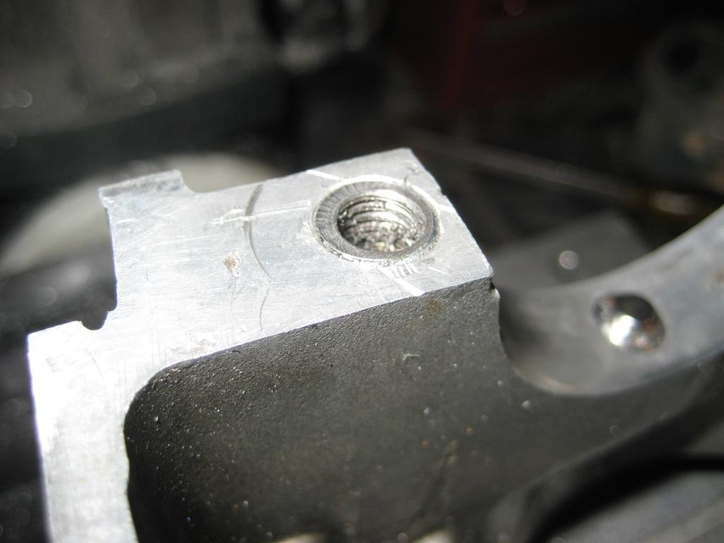

Just got back on this project the other day after spending a lot of time on another bike.
Getting back to fixing a F'd up crank bolt hole on the upper case.
Getting it clamped to my tiny milling machine was going to be some work.It was a couple of hours of trial and error until I used the uprights from my exhaust stud drilling fixture which have the same angle cut as the top surface of the upper case.
Quite a bit of a struggle but I knew it was not going to be easy.
Have it clamped securely and used a drill bit to position the 3/8 end mill where it needs to be to do the tap drill hole. Looks like it will clean up most of that angled crap in there now.
Here is the modified 7/16-14 X 1-1/4" bolt
Needed to use a end mill as the hole in there was oval. 3/8 is tap drill size for that thread (that is why I picked it) I just used the drill chuck as I had to swap out some tools on the same locked center.
Here is the modified bolt with a M8 blind thread in it sunk into the fixed threaded hole. Put some 3 Bond about 1" down and some red Loctite at the top.
Cut off the hex head with a angle grinder and thin cut off disk.
Finished insert spot faced with a 7/16" end mill to be flush with top of mating surface.
Now I have proper oil flow without leaks and a solid steel M8 thread for my crank bolt.

Nice work ! Using a hex cap screw for the insert so you could install it is a clever idea. My hat's off to you Injected !

This idea also works for fixing stripped M6 cam cap bolts in 650/900 cylinder heads (different bolt size required) and is about as cheap as you can find.

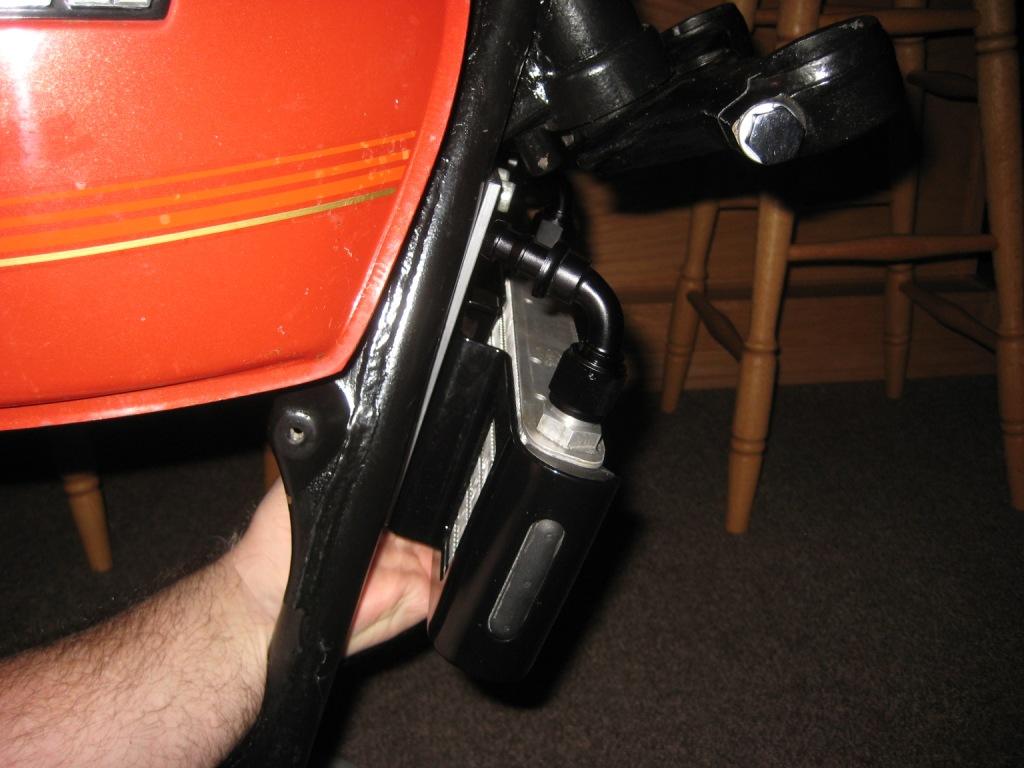

Mock up for the oil cooler bracket, bolted where the stock horn mounts.
Bracket is a stock Polaris part, -8AN cooler was built to fit in it with rubbers (also Polaris) on each end, friction fit.
Plate will also be bolted thru the Polaris bracket then attached to a rail behind the frame cross tube.
Need to make a triple clamp travel limit to attach to the welded peg.
Sits around the same height as other examples I have pictures of.
