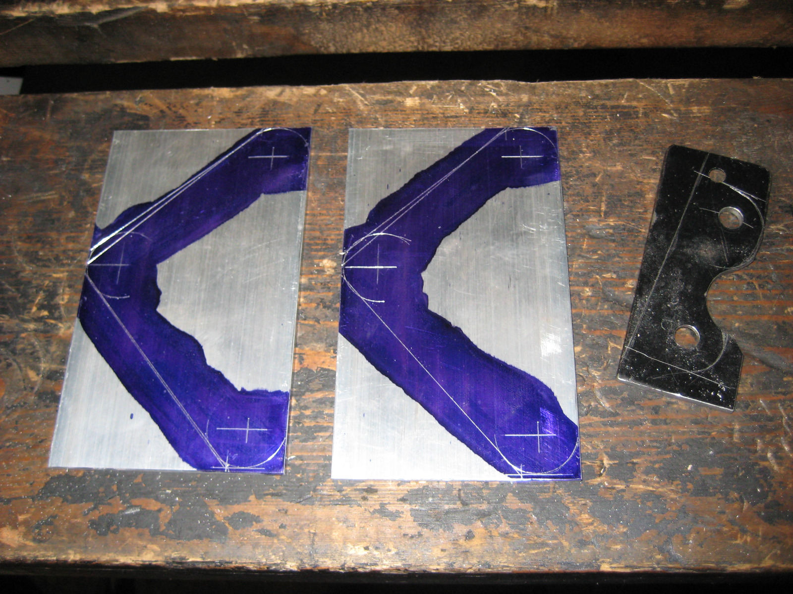

Got started on making the exhaust flanges today but did not get very far when I discovered I needed to buy the next bigger size of hole saw.
I have all the hole positions center drilled and the cut off angles marked so I can easily pick up on the machining when I get the right hole saw in my hands.
I also made up some limit buttons to be welded on the head pipes behind the flanges so they won't slip off and down when installing/removing. Will fill up the centers with weld.

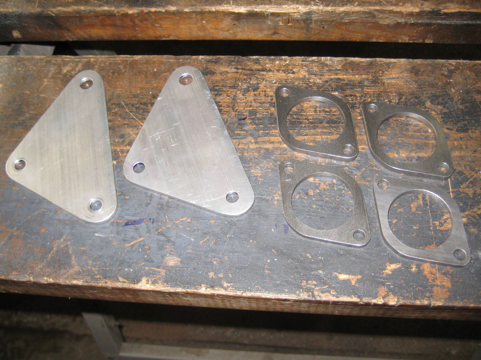

Finished drilling these flanges a little while ago.
Now just have to cut them to size, mill flat edges, then shape the radii on the belt sander.

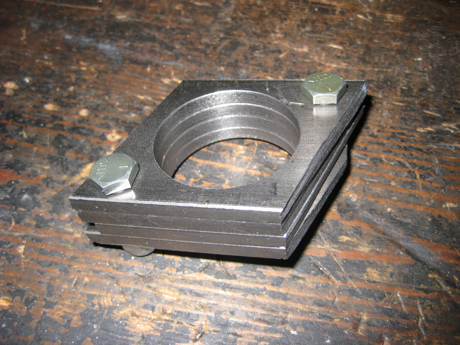

I got the flanges cut off by hand with a hack saw (Popeye arm) then I stacked them up so I can mill the cut edges flat.
Once the milling is done I will move on to grinding the radii.
I wrapped 1/4" bolts with copper shim stock to keep the ganged pieces from moving around.

Even though it was freezing in the garage today I was able to belt sand the radii on the exhaust flanges and muffler mount brackets.
Progress is slow because of the unheated shop circumstances.

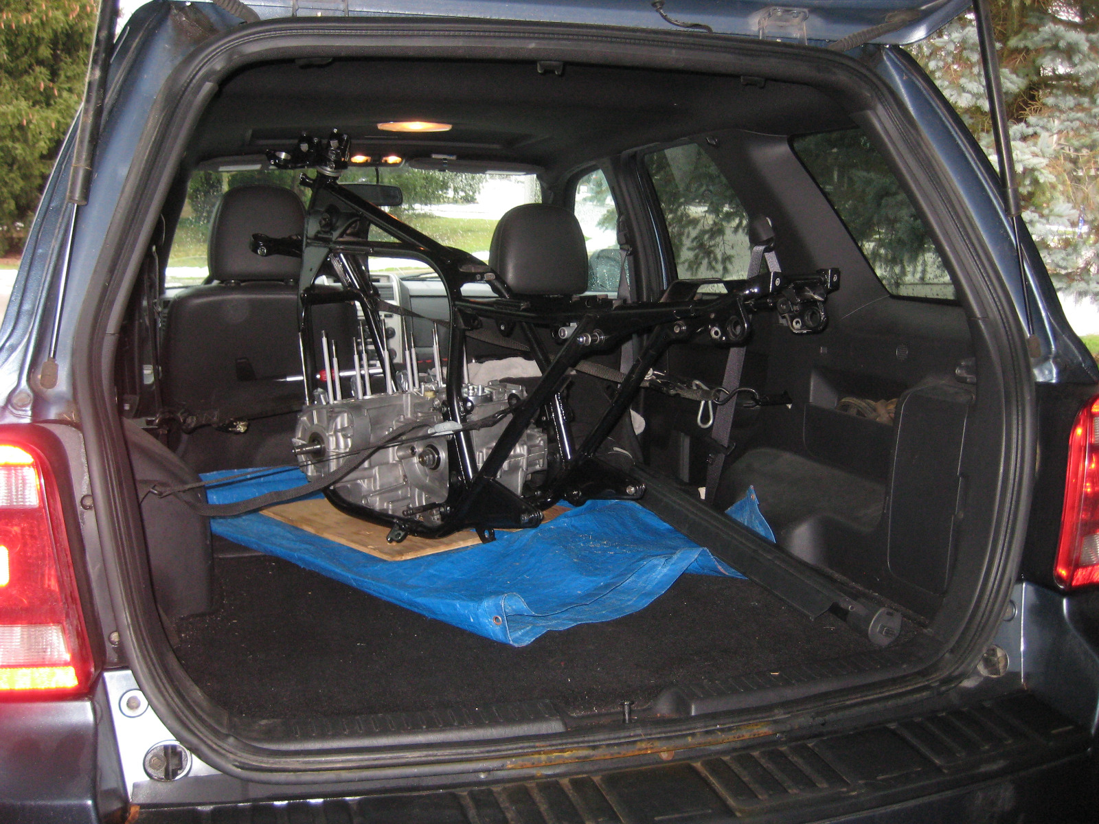

Did some assembly welding on the exhaust last night.
I don't have a welder so I took it to a friends house, he is out in the country and works mostly on ATV's so he does not own a hydraulic motorcycle lift.
At first we thought we could get it up on his welding table but that 8 foot table is attached to a wall workbench style so you can only access one side at a time. Decided doing it on the floor would be best as he has a heated cement floor. Once we blocked it up on the bottom it was discovered we could only work on one side at a time anyways.
The head pipes are cut off a 1000 header, so two pipes are short and two longer by about 1 inch. We quickly found out the pipes were hanging down about 1" too far on the shorter pipe and more on the longer pipe. We ended up sectioning the longer pipe and have it on the inside cylinder. We are going to pie cut the inside top of the outer pipe and pull the open end into the collector to correct the down angle (angle seen from the side)
That is as far as we got last night and I am returning tonight to hopefully finish it.
