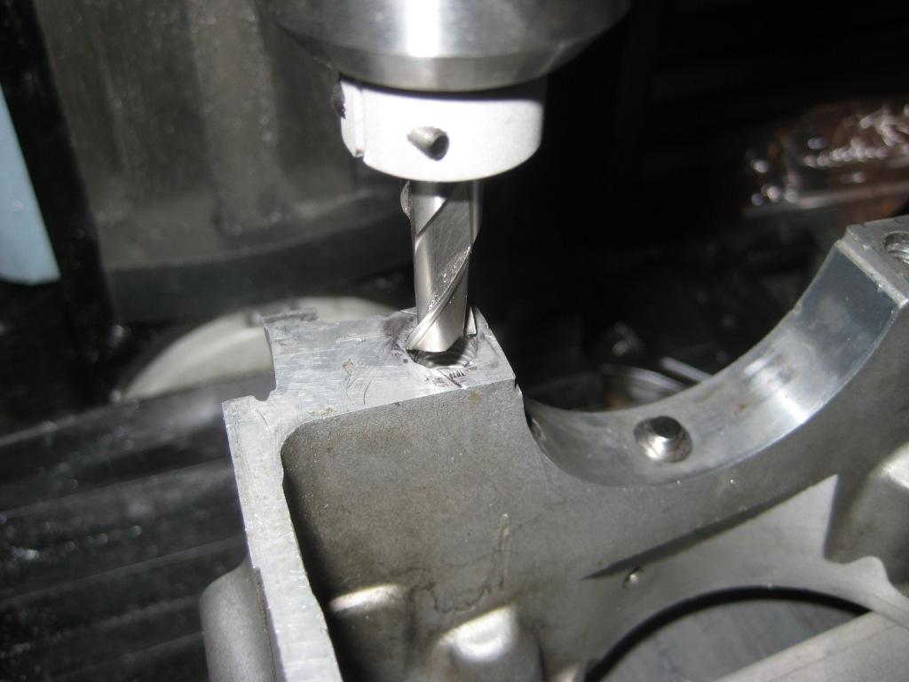

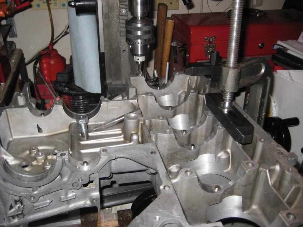

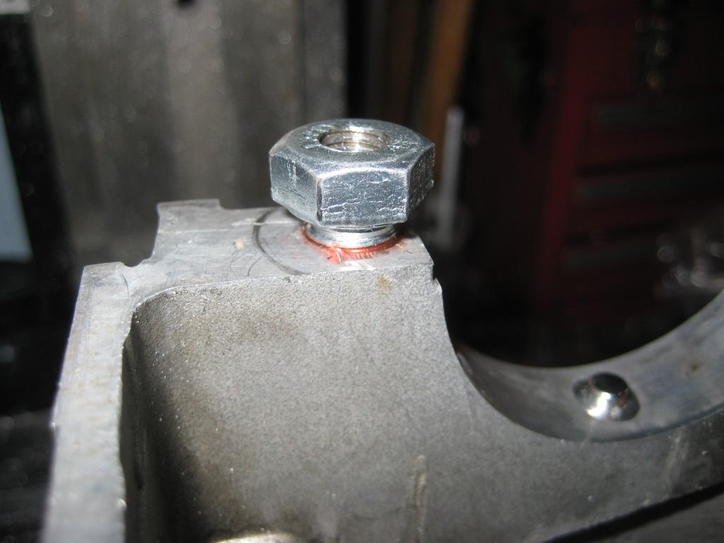

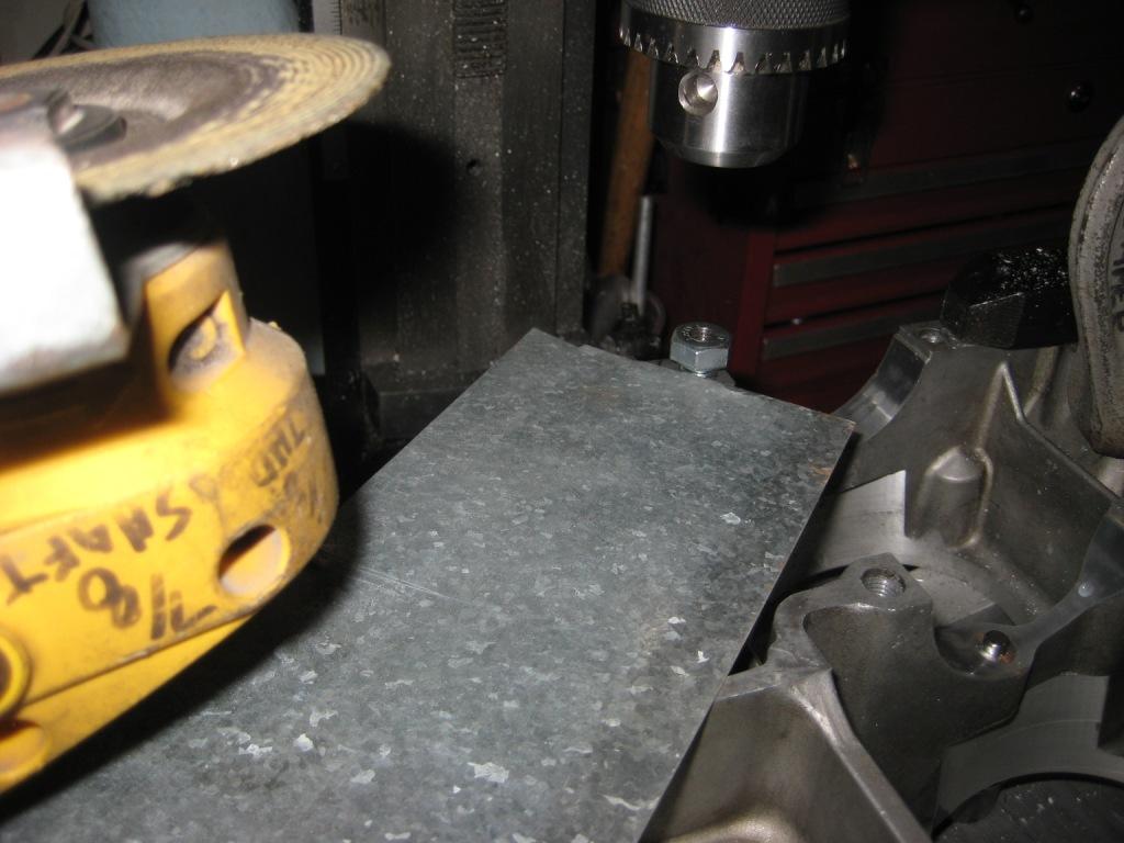

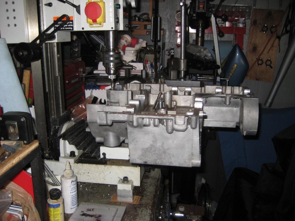

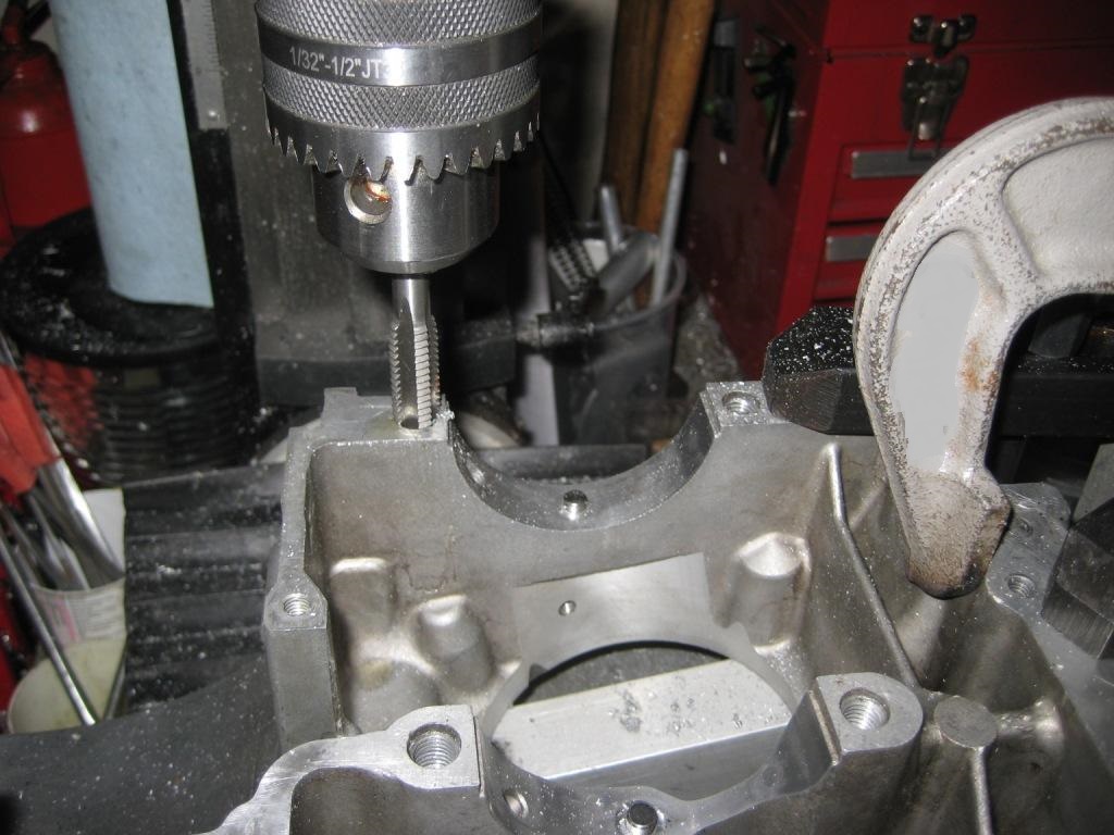

Just got back on this project the other day after spending a lot of time on another bike.
Getting back to fixing a F'd up crank bolt hole on the upper case.
Getting it clamped to my tiny milling machine was going to be some work.It was a couple of hours of trial and error until I used the uprights from my exhaust stud drilling fixture which have the same angle cut as the top surface of the upper case.
Quite a bit of a struggle but I knew it was not going to be easy.
Have it clamped securely and used a drill bit to position the 3/8 end mill where it needs to be to do the tap drill hole. Looks like it will clean up most of that angled crap in there now.

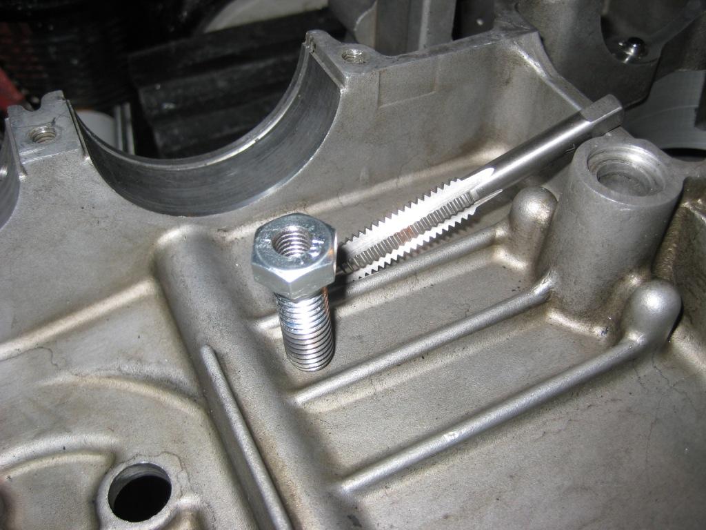

Here is the modified 7/16-14 X 1-1/4" bolt
Needed to use a end mill as the hole in there was oval. 3/8 is tap drill size for that thread (that is why I picked it) I just used the drill chuck as I had to swap out some tools on the same locked center.
Here is the modified bolt with a M8 blind thread in it sunk into the fixed threaded hole. Put some 3 Bond about 1" down and some red Loctite at the top.
Cut off the hex head with a angle grinder and thin cut off disk.
Finished insert spot faced with a 7/16" end mill to be flush with top of mating surface.
Now I have proper oil flow without leaks and a solid steel M8 thread for my crank bolt.

Nice work ! Using a hex cap screw for the insert so you could install it is a clever idea. My hat's off to you Injected !

Thanks for the support.
This idea also works for fixing stripped M6 cam cap bolts in 650/900 cylinder heads (different bolt size required) and is about as cheap as you can find.

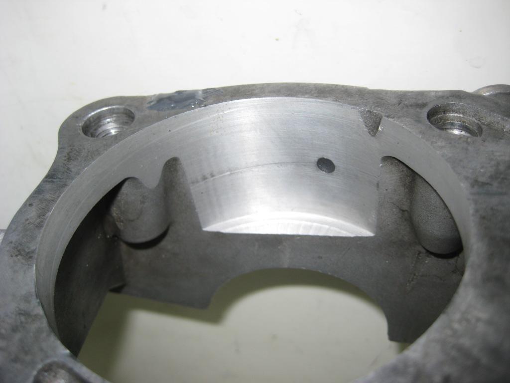

Filled both pry slots on upper case with JB Weld, will file flat once hard. This needs to be done as its very thin in the area around those to properly seal the base gasket.
The top bolt hole that attaches the points housing got filled the other day, a short bolt goes in that one, this keeps oil from seeping out.
These steps are not necessary if you stay below 1135cc. It gets worse at 1327cc, a window opens up on the generator side.

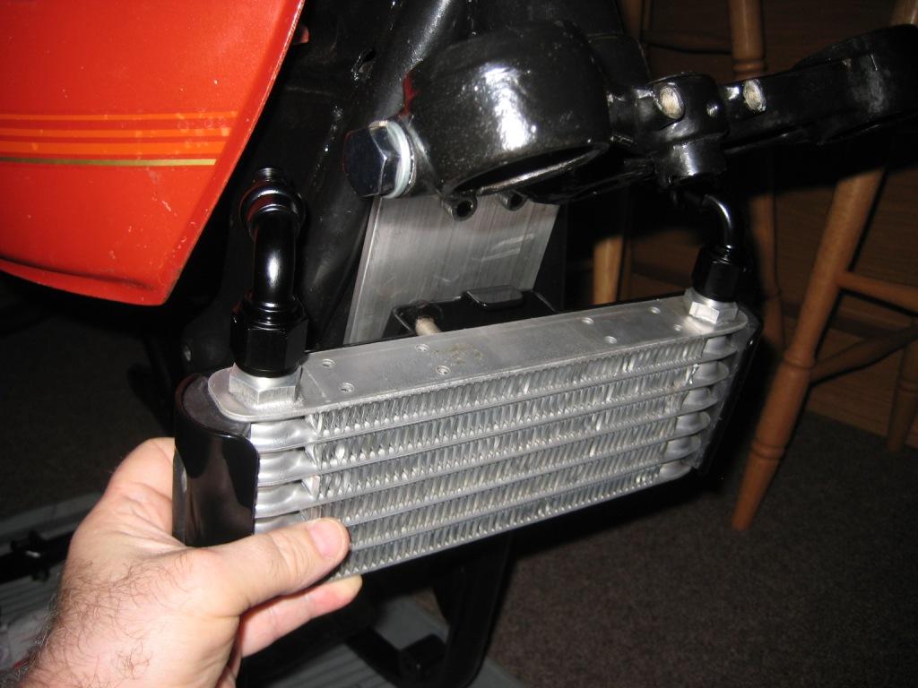

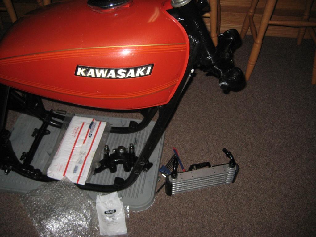

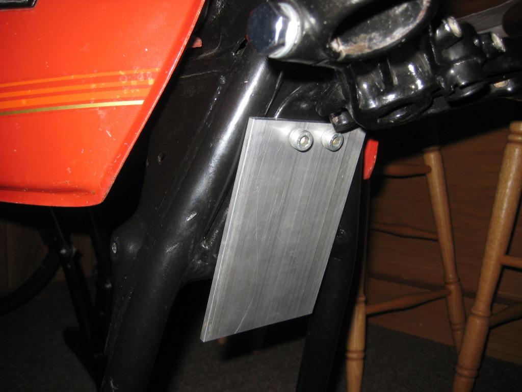

Mock up for the oil cooler bracket, bolted where the stock horn mounts.
Bracket is a stock Polaris part, -8AN cooler was built to fit in it with rubbers (also Polaris) on each end, friction fit.
Plate will also be bolted thru the Polaris bracket then attached to a rail behind the frame cross tube.
Need to make a triple clamp travel limit to attach to the welded peg.
Sits around the same height as other examples I have pictures of.

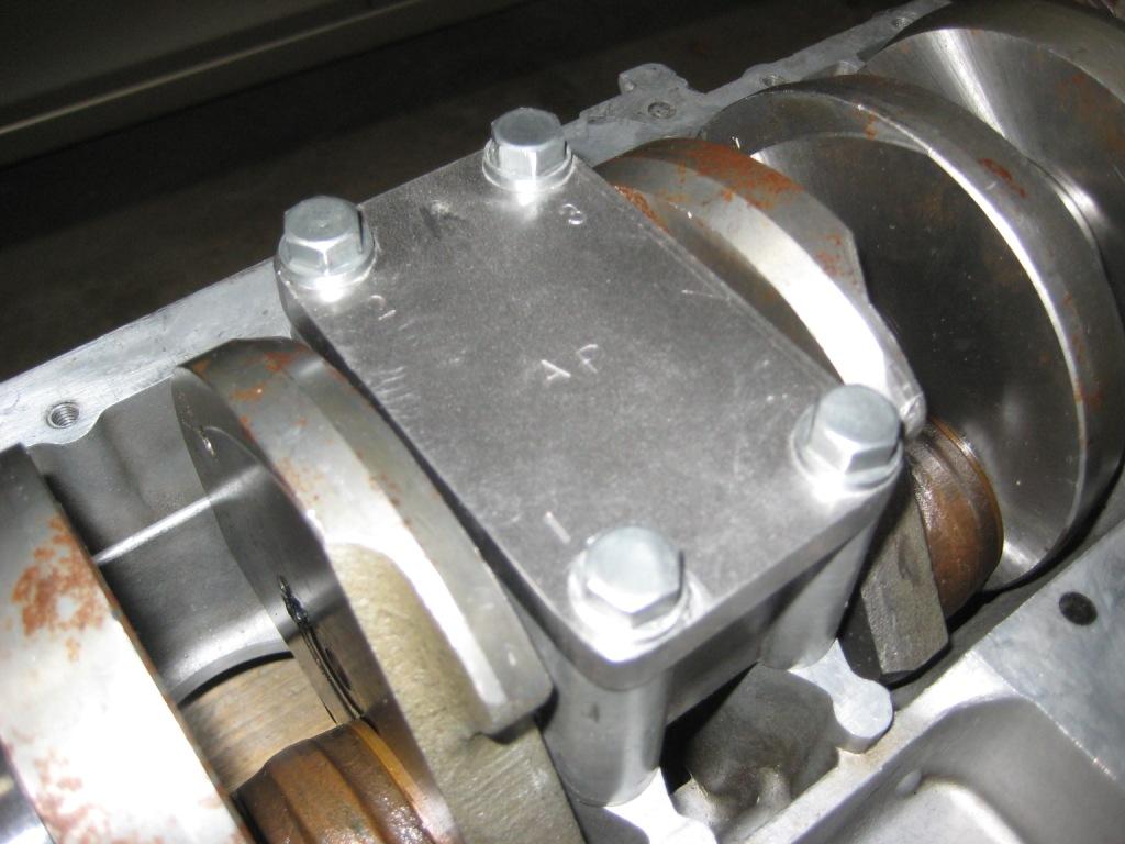

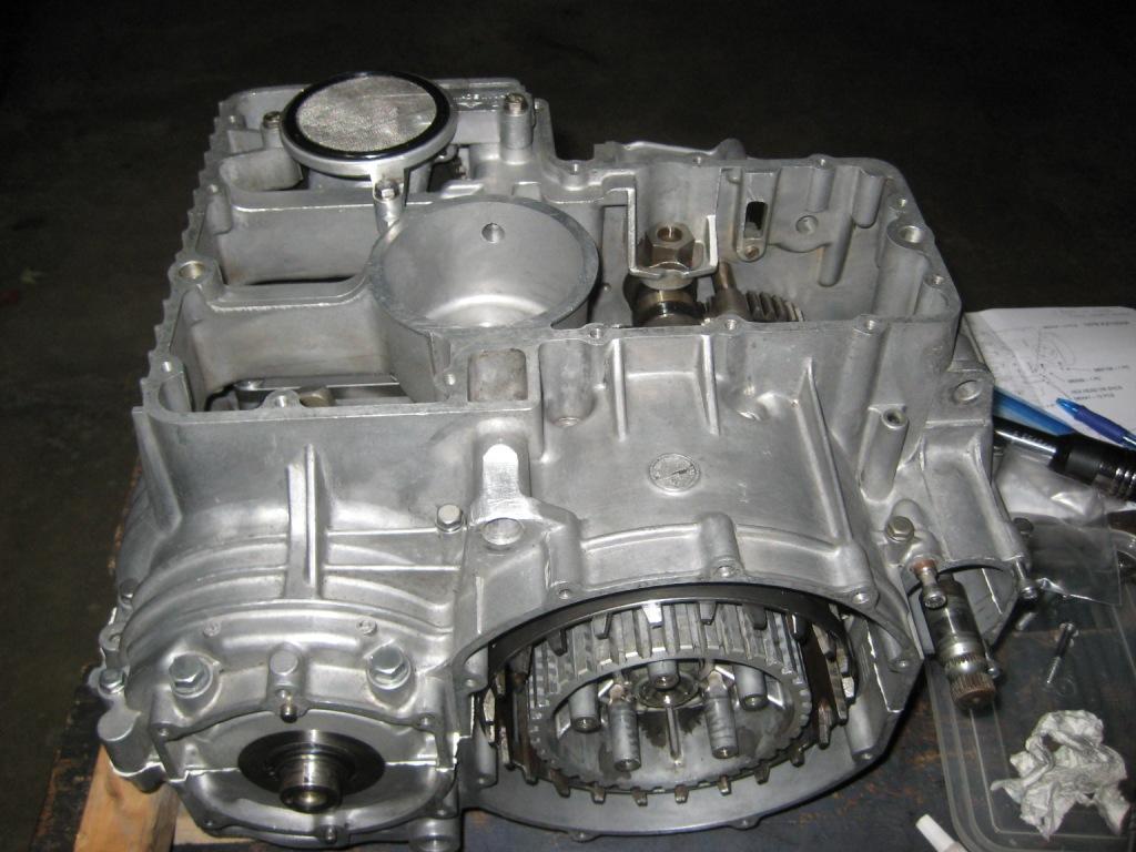

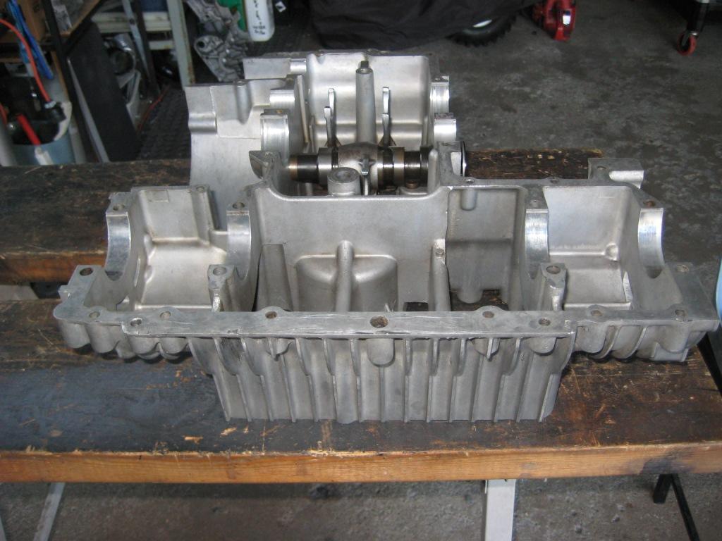

Got all the engine bolts de-greased and found a bunch of non stock bolts in the mix.
Went thru my Kawasaki bolt spares and found some suitable pieces but some will need to be shortened and the threads chased longer. It amounts to four M6 oil pan bolts and five M6 lower case bolts that need modified. If I had to replace these with new OEM bolts its North of $50. Spent a little time with a die and a hack saw sorting them out and saving some cash.
Also found that once de-greased the cylinder nuts were rusty, about 4 pieces out of 12 I would use. Luckily I have a complete used good set I bought off Ebay for cheap a few years ago Just need to buff them out with some chrome polish.
For all the engine covers I have purchased Allen head SS replacements as they are much easier to work with than the JIS pan head bolts.
Going thru and checking parts for the bottom end rebuild these cases must have been split before, one of the trans bearing position half rings has been replaced by two cut piston rings - a sign that they lost the original part.
The pieces I found were not cut correctly and are not the correct OD. I found a old 650 piston ring will fit perfect as a replacement, I have lots of old rings in my spares just have to dig some out!
Checked the oil pump clearance, surprised to find it nice and tight at .0015", kind of weird considering the mods this engine had.
Got the lower case completed ready for assembly. Had to clean it then reassemble the shift drum and shifter forks.
The black paint that was on there was already weakened by the paint remover so a little scrubbing with #1 steel wool got it off, tight spots I had to use tiny cut pieces held with forceps.
Tomorrow I will tackle the upper case, it has some corrosion and more paint left over than the lower case had so its going to be a bit more work to get clean.

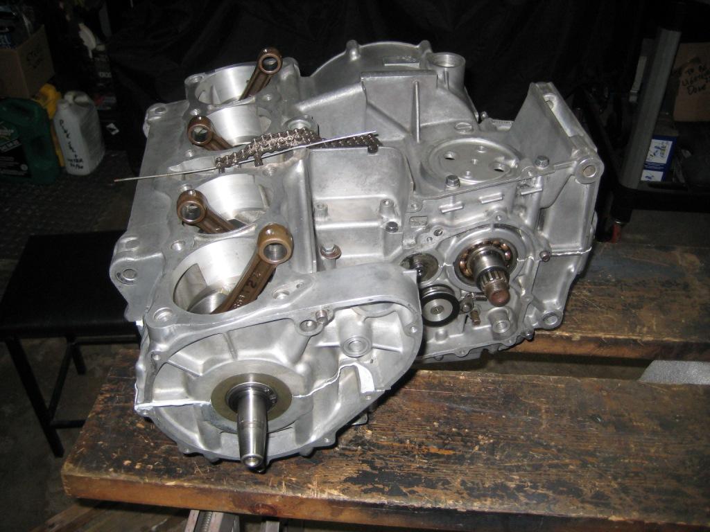

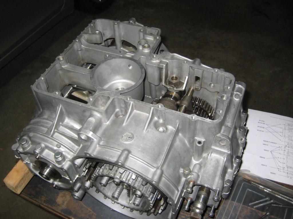

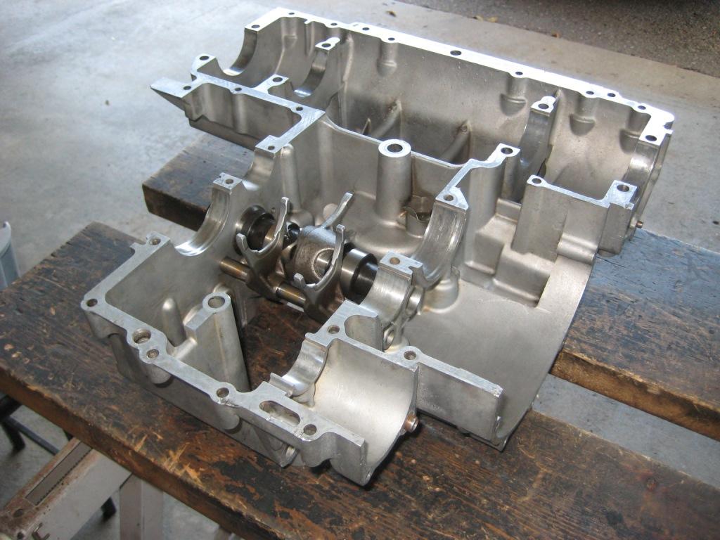

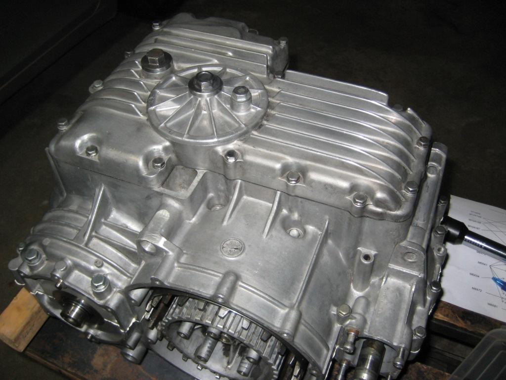

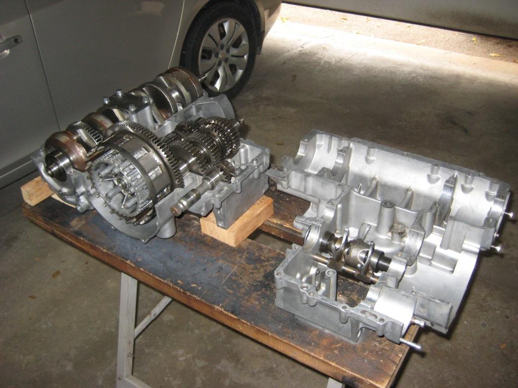

Got the upper case cleaned up then gathered all the parts for the assembly. Used a lot of elbow grease and steel wool to clean the cases as they were a mess to start off.
Just had enough 1194 to glue the cases together, need to order another tube
Missing a couple of 95mm bolts on the lower case, its been a while since I put a 1000 together so read the bolt chart wrong. Will try to find them in the next few days otherwise its together and torqued down to spec.
This is done enough for me to get it bolted into the frame, just need to drill and tap a hole for a steering stop then I should be OK to bolt it together.

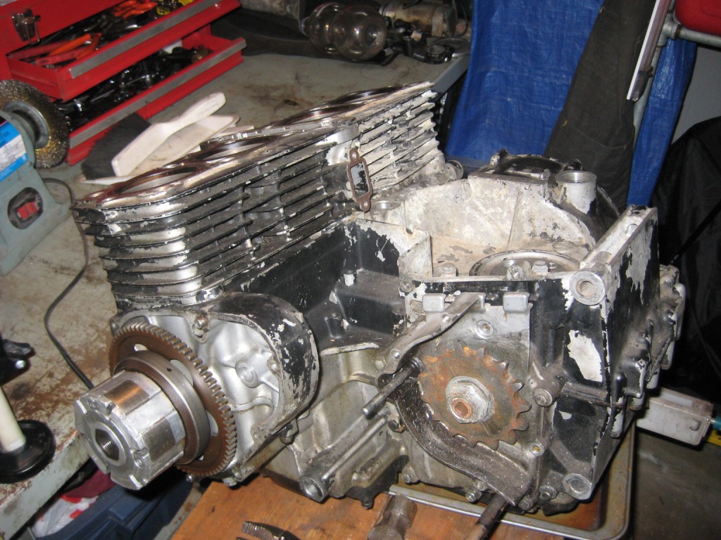

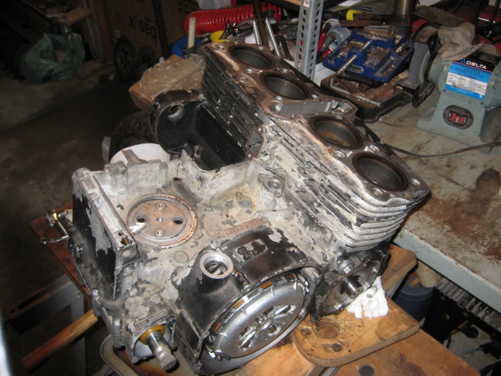

This is what it looked like when I first stripped it down :
