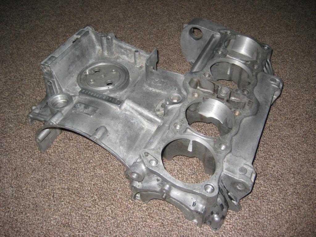

Got most of the paint removed from the upper case.
Still needs a going over to remove whats left and hit the corrosion with some lube using fine steel wool.

Got most of the paint removed from the lower case.
Still needs a going over to remove whats left, and not as much corrosion on this compared to the upper so it will need less work.
Will go over both of them with M6/M8 taps to clean out all the threads.

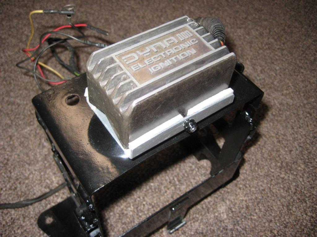

I did sand some engine covers the other night and made up this aluminum tray to hang the Dyna3 off the bottom of the battery box.
I enlarged the Dyna box holes to take a M4 sized rod, ran a die over both ends for some nylock nuts.
Its mounted off the battery tray from existing holes one thru that drain well, I made a standoff to support it flat. Its isolated with rubber foam and after this picture I put some heat shrink on the wires instead of that electrical tape.

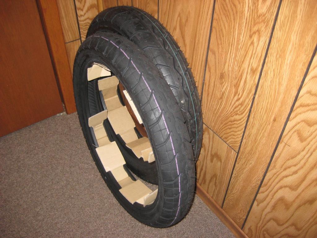

Bought some replacement tires, Shinko 230's front and rear. Price was right and they seem better than what I have on the rims currently.
Old tires are 12 year old Kenda Challengers, only issue was wet performance. Needed to change them even thought they do not have a lot of miles on them, they don't inspire any confidence.

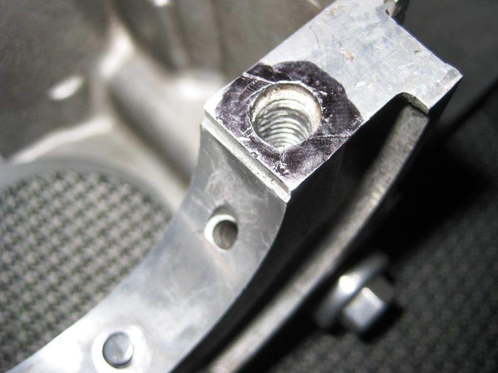

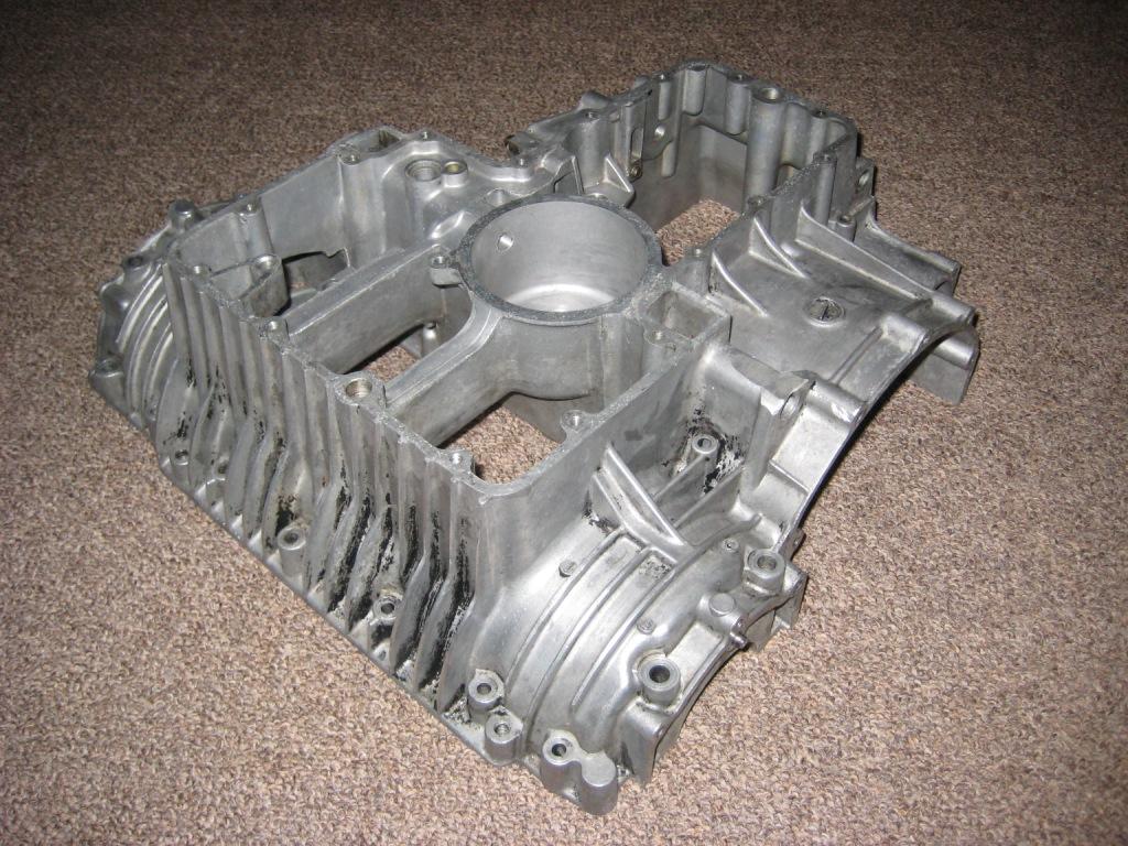

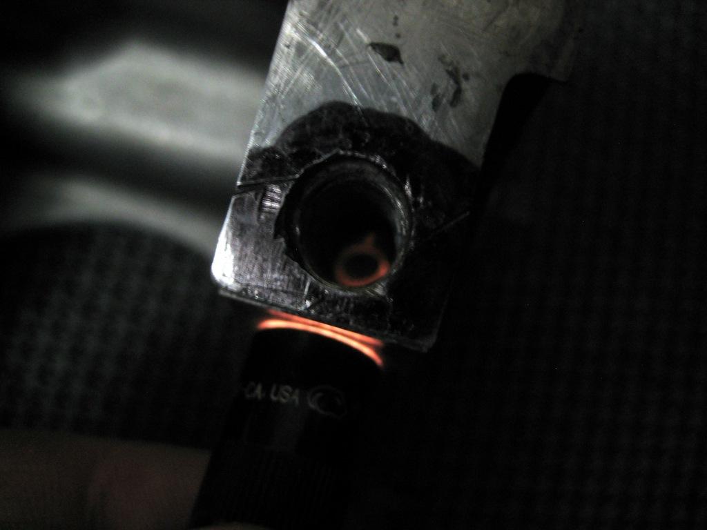

Got back to working on this project today. Started by chasing the threads on the upper case half casting.
When I was disassembling this engine I noted one of the outer crank case bolts on the points side was stripped.
Today when I was chasing the threads I realized just how bad the PO had tried to fix that buggered thread.
I don't know how this could have happened but that hole has been put oval by drilling on a angle then tapping with a M8? What I see here is baffling!! Whoever did this drilled too deep and ran into the oil galley line that feeds the crank/top end. The drill was angled towards the crank center line. This is not a regular thread repair, probably looking at making a blind threaded insert to seal that oil feed and put that hole back to a straight M8.
Problem hole location
Light shining thru where it should not go (must have been pissing oil badly)
Was sizing it up and I believe a 7/16-14 bolt should be able to help me fix this.
Fixture this flat on the mill and use a 3/8" end mill to do the tap drill hole for the bolt. Blind tap the bolt M8 then insert the bolt using some sealing compound, then cut the bolt off flush with the top of the gasket surface.
Some people should not be allowed to hold tools! Brutal...
