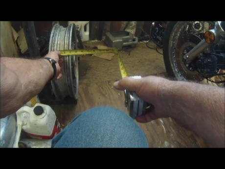

The bead breaker worked fine, got the old rear tire removed but it was on there pretty good. I needed to use dish soap solution and a combination of the breaker bar and tire spoons. I have not put the new tire on yet.
The rims/wheels on the project are 81 GPZ550 (forks,swing arm,rims,brakes) I believe the PO had it set up for road racing because most of the bolt heads were drilled for safety wire.
The 550/650 rims are smooth on the inside.
Are you referring to those rubber tube locks on the rear tire? Both have them but I don't run them, I closed up the rim holes with plastic plugs.

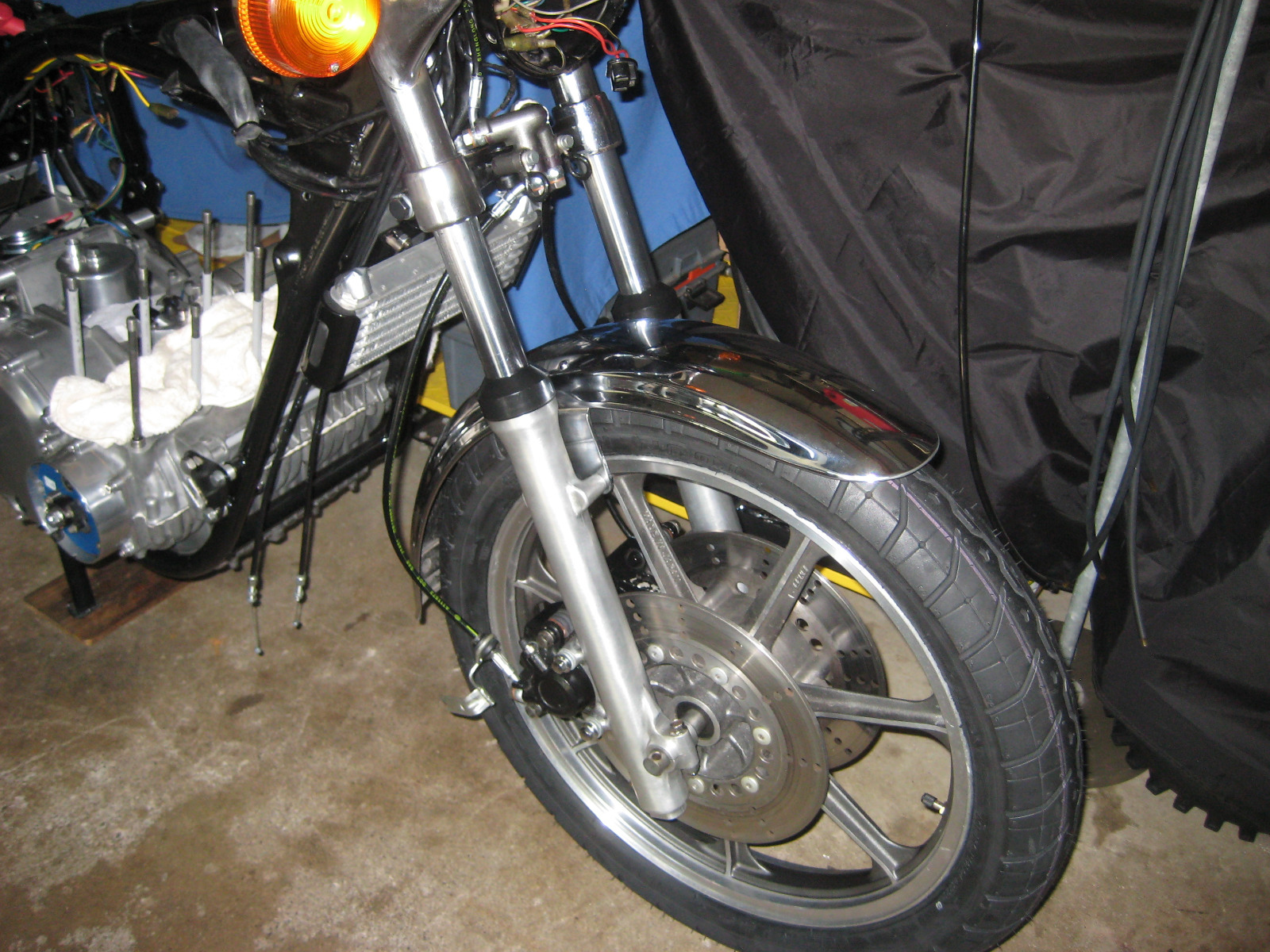

Shitty rainy day here so I decided to get some stuff done. Mounted the front wheel, a bit higher that I thought so blocked it up.
Also mounted the headlamp after hooking up a battery and seeing that everything was plugged in correctly (using Z1 indicators) Wiring does not match 650 harness in there.
Hella H4 Euro style lamp.
Checked the horn and the relay just clicks, wired something in the wrong direction I think. I will have to get it sorted out.
I decided to put a screw adjuster on the brake pedal stop, did not make any sense not having one.
Need to fix that horn before I move on to anything else.

It ended up I had the horn wired thru the relay wrong, was using switched power and engine ground instead of directly off the battery terminals. I only had to make up one new wire to attach to the battery negative lead to the horn.
I am using aftermarket battery cables and fuse box from Creative Wiring Solutions. The cables have extra wires to plug into and the fuse box has a extra place to run a accessory item. I put a 7.5A fuse in there to run the horn to battery positive.
Now it works and its pretty loud!

I have had a hell of a time trying to get a new back tire ready to go on this build.
I got the new tire on but I pinched the tube getting it on there, didn't hold air. I took that tube out and it did have a small hole in it. I then put a good used tube in there and it looked like success until the next day, flat again! Never had that happen on a motorcycle tire install.
I am not 100% sure but I think I may have damaged the bead getting it on there (exposed wire?) Need to investigate further to find out.
Two flats in succession is not a good sign!
May call my local dealer and see what they can do for me (order new tire and get them to install?)
Now I am not sure if I can have this ready for my June 14th weekend trip, it seems way too rushed for a new unknown build. Funny how this is not the first time this has happened My backup plan is to ride my other bike which needs minimal work to get ready.
