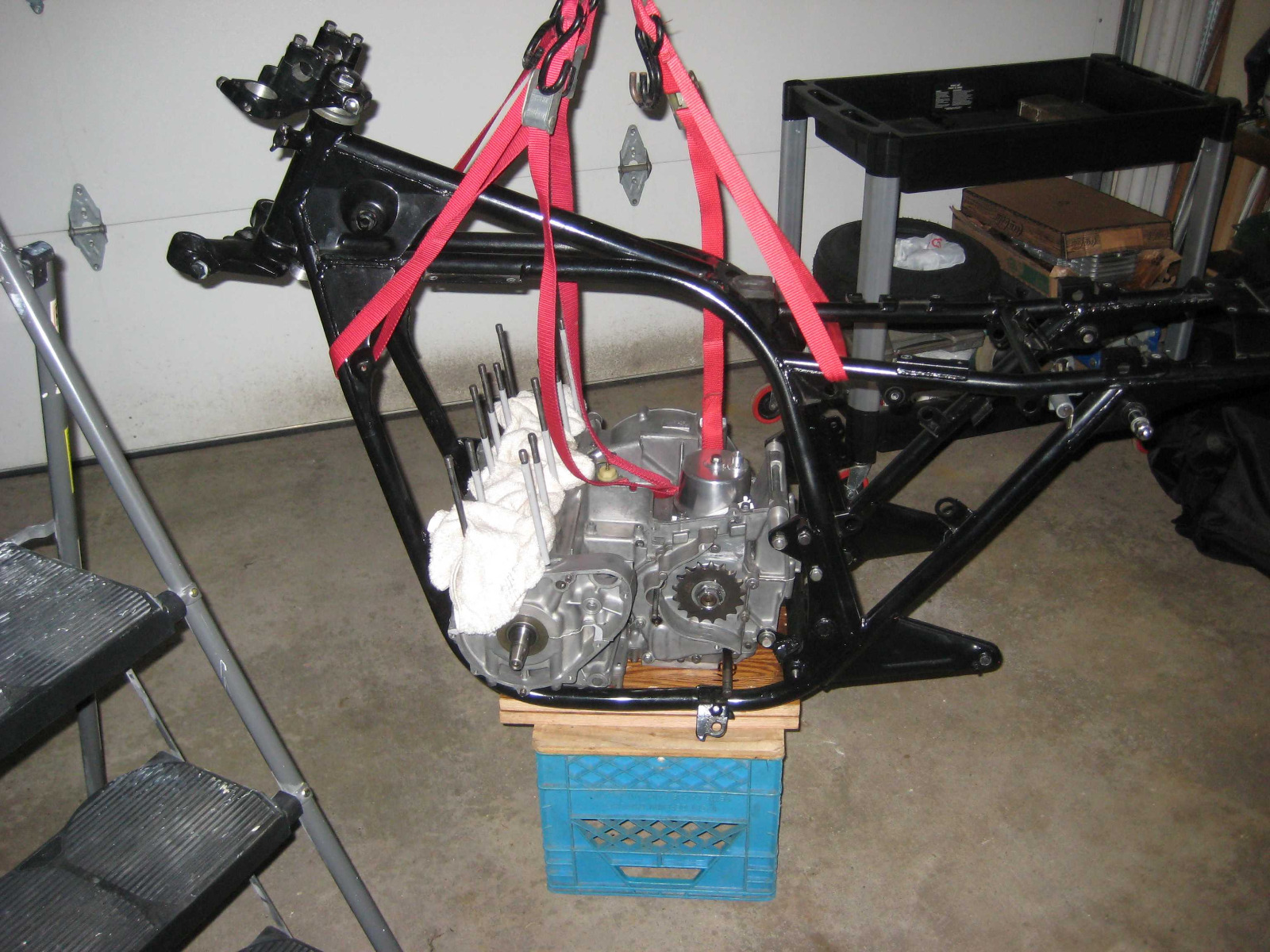

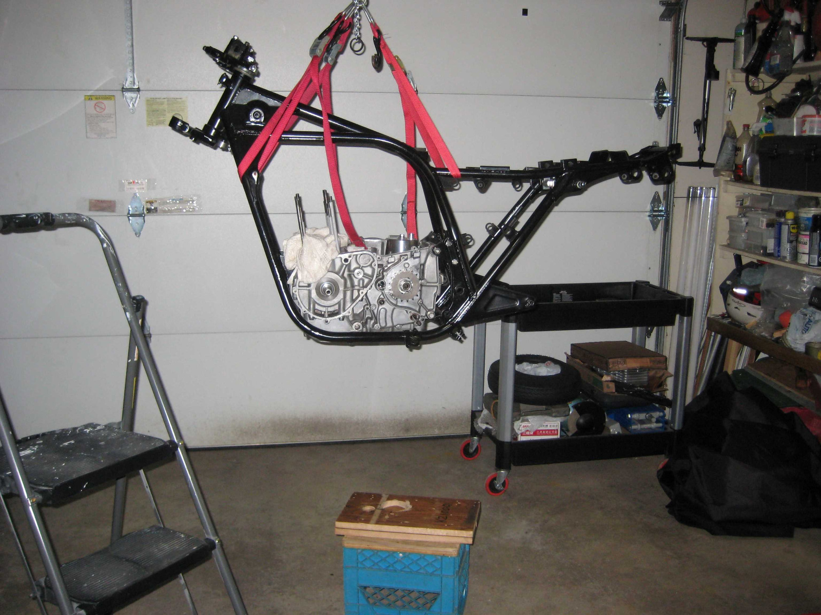

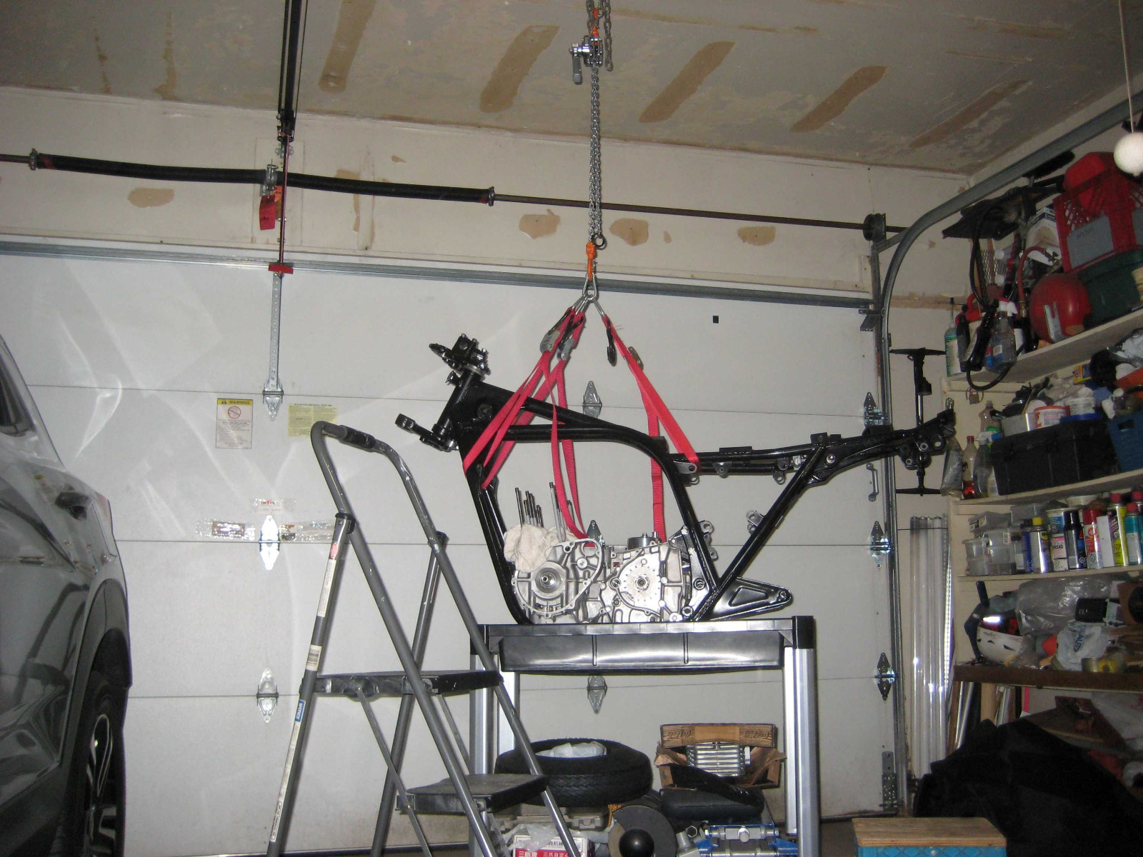

Its not that I could not get anybody to help me, its just that I like to be able to do things on my own and not have to rely on help. When you have to ask for help your on some ones free time which always bothers me.
When I lifted the drag bike frame/engine off the same cart I put my weight belt on and had a tie down strap draped behind my neck so the weight would not roll forward. Lifted it up and off the cart a few inches, stepped back and squatted down setting it on a milk carton. It was not easy but it did not hurt me either. Thinking back that was kind of risky in several different ways.

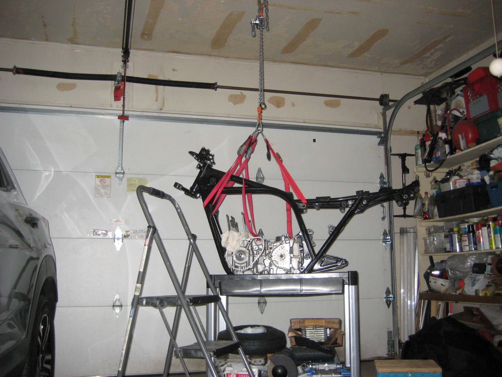

I figured out the frame/engine weighs closer to 230 LBS instead of 250 LBS the way it is assembled. I screwed two 3/8" screw eyes into a garage ceiling joist next to each other so that should be able to lift that kind of load.

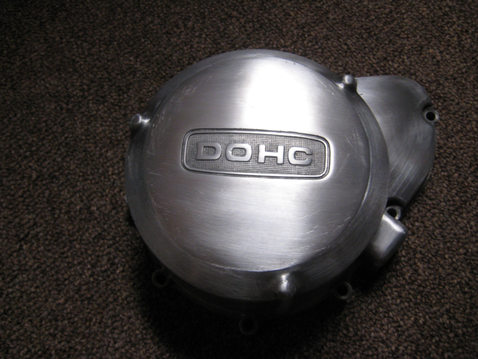

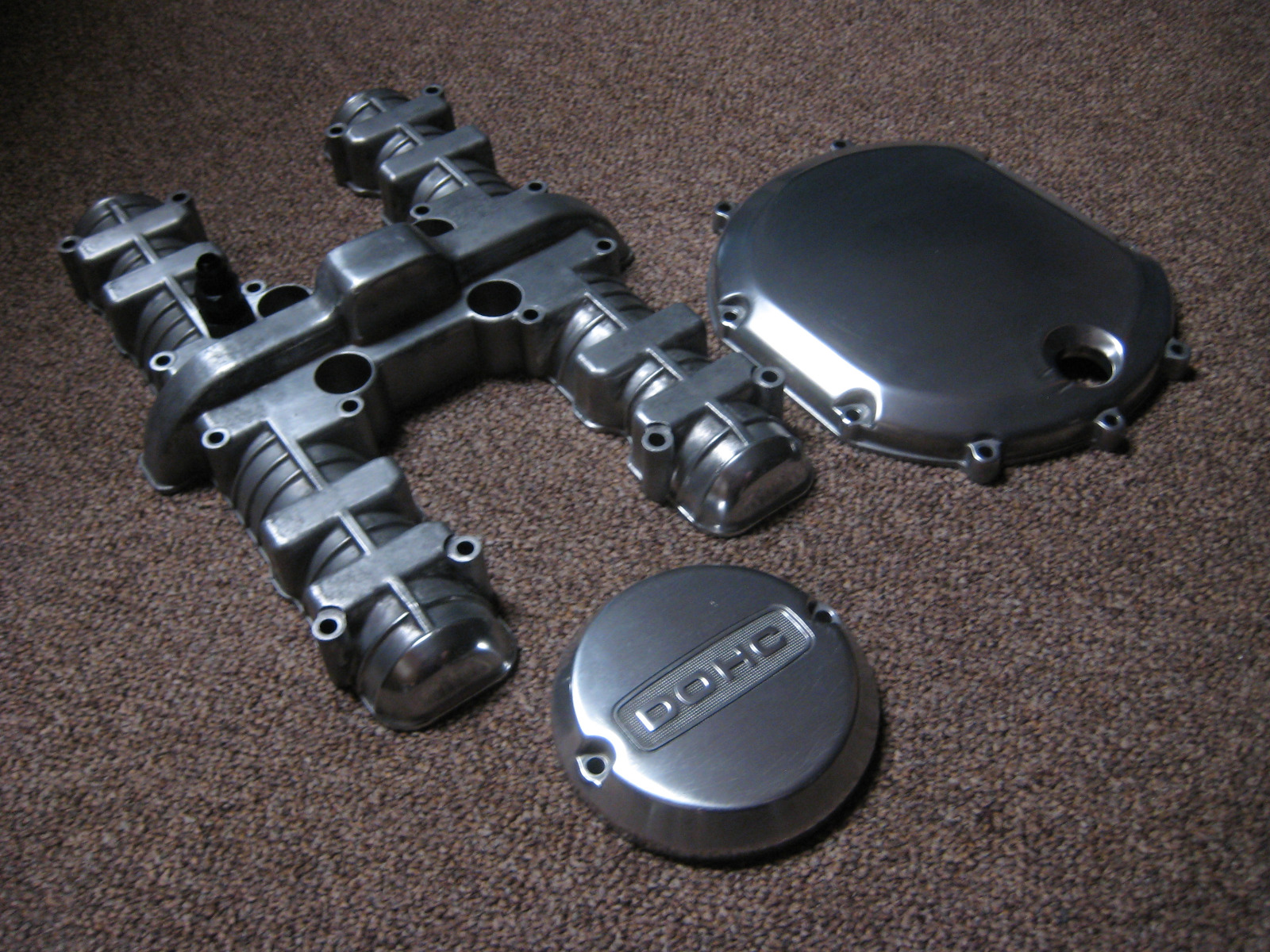

Had some time this morning so sanded and hand polished some engine covers. If you go to the first page you can see what I started off with.
I only sand up to 600 grit and don't use a buffing wheel, just some Mothers paste applied with a rag. I am not into the mirrored finish look, it does not make it any faster
The stator cover is coming along, this is at 180 grit but looking way better than what it was.
I need to remove the points housing from the engine, I did not realize that came stock as a polished piece.

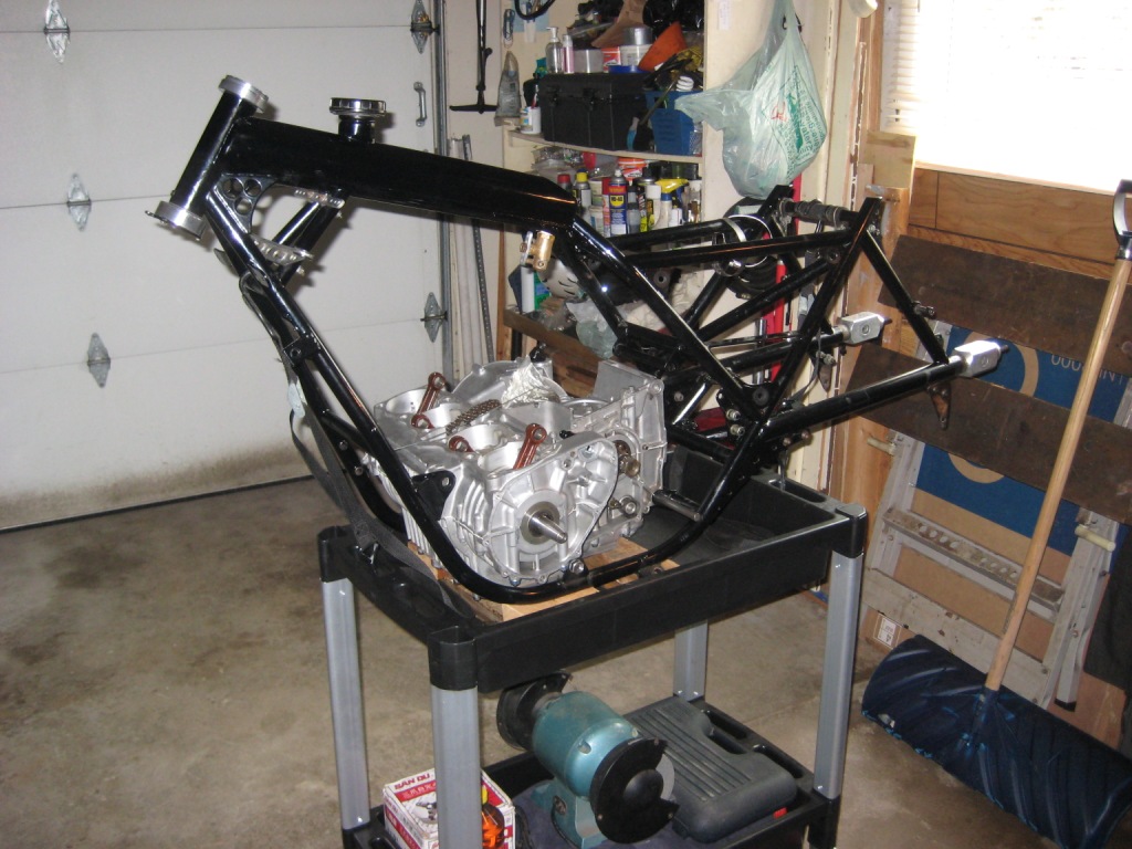

Dropped the engine/frame off the work cart today.
Once it was on the milk carton I used some ratchet straps to hold the frame firm to the carton. I slid the carton across the floor to where I can work on it and still park a car in front of it.
That little chain hoist was a life saver and worked flawlessly, don't know why I did not get one sooner.
Tomorrow I will see about swapping out the old tires for new, then I can install the fork and swing arm so the wheels can go on. Once I get the center stand installed I can get rid of the milk carton. The milk carton may look hokey but its the perfect height to install the wheels on the frame.
