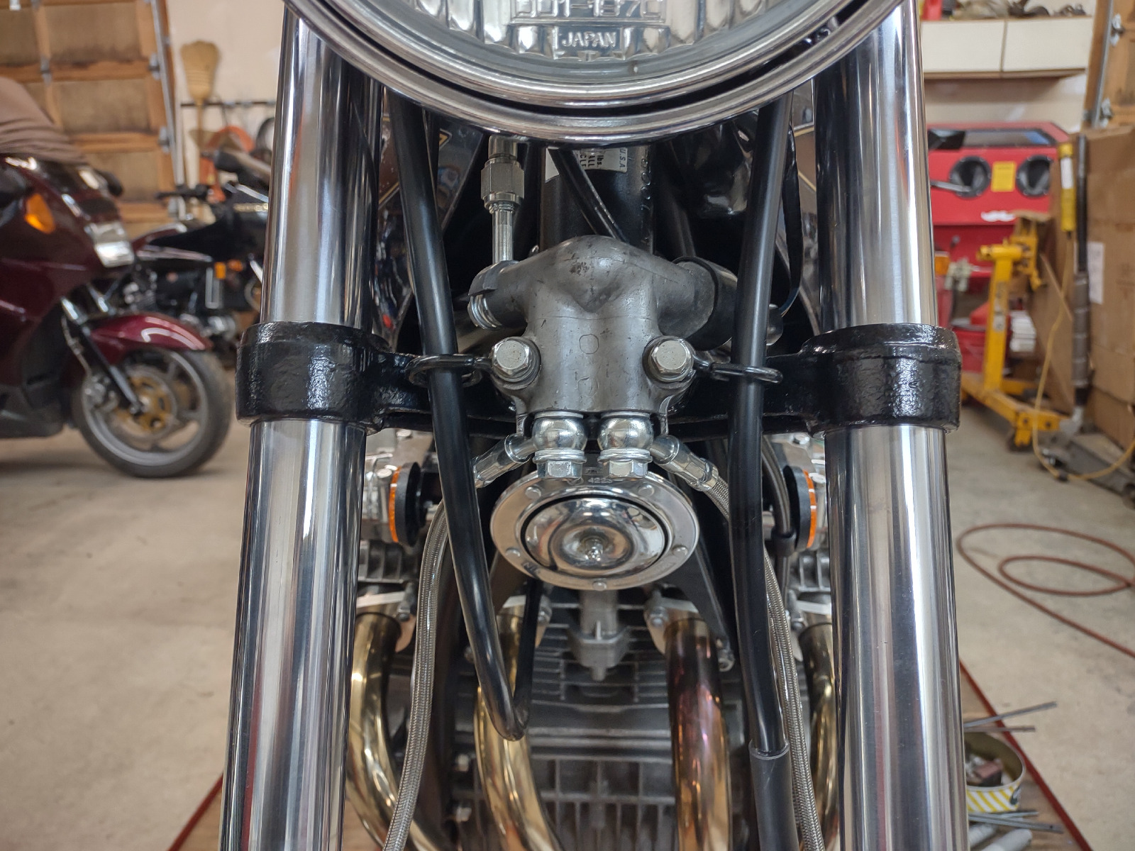

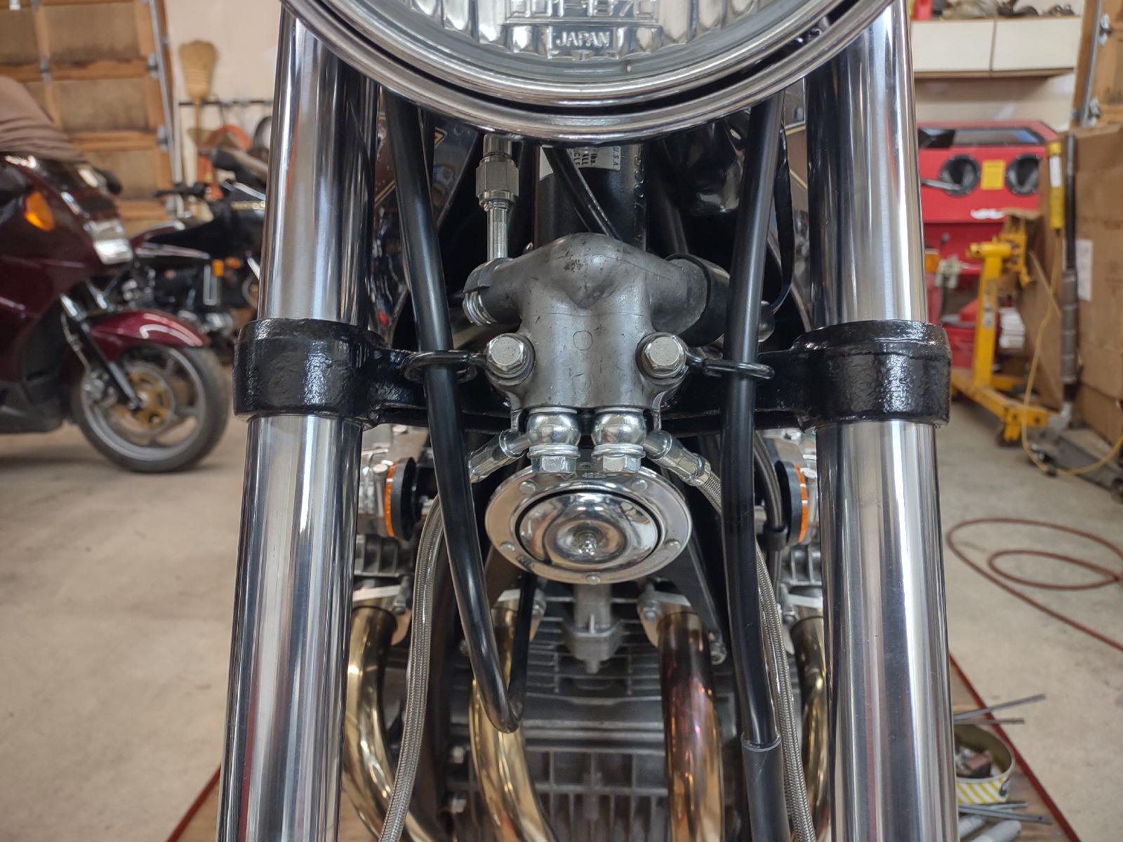

The Apex lines also come with all new banjo bolts and they are in Canada. You can also get swivels if you need them for tight spots. I got one for the short line from the master cylinder to the junction block. You can see it under the headlight.
