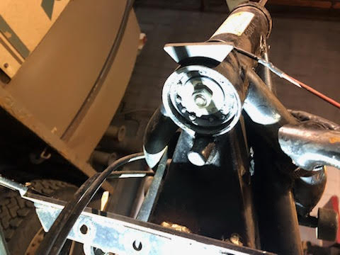

So I ordered steering stem bearings from Fortnine. $60 C$ and free shipping. Just in case there are Canucks price comparing.
I also learned a new word! When the bearing makes the little indents in the race, its called Brinell or has gone Brinell!
I first attempted to cut some slots in the race, to make removal easier. but there's not enough shoulder for a punch.
I think it was Mikaw mentioned on here to weld a washer to the race. Worked a charm!
Here are some pics of my playing around!
The first is a chunk of ready rod to hold the washer while I welded it in place.
Second is laughable welding job, but it got the job done!

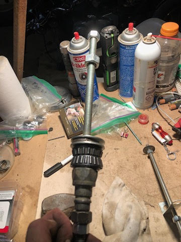

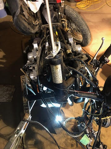

Third is my race install tool. Using the old bearings, I squeezed the new races into place. I know the thing looks like WTF! But it worked a peach. I've always had a problem with the races going cockeyed when I try to tap them in with a hammer.

Thanks Treetall and Mikaw for that bearing race removal tip. I can't tell you how many punches I've had to grind square after rounding the tips trying to remove bearing races from front rotors or drums over the last 40 years. As they said in the old Guinness commercial - BRILLIANT !
