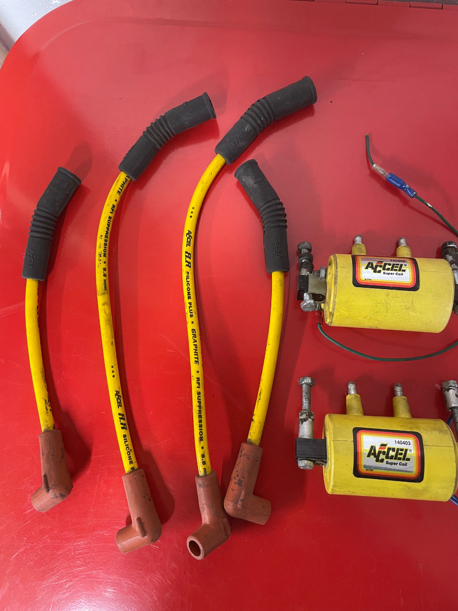

Nice work ! Im going to do this mod to .I want yellow plug wire too do you know where i can buy them?

I got 7 mm solid core yellow plug wire, from tonsperformance.com. I bought wire, terminals, and boots and made my own. I recommend using the proper crimp tool for the terminals. Terminals and boots are inexpensive enough, highly suggest buying extra wire, terminals and boots to practice first. I'm sure many others, Taylor wires for example, also can supply what you need.
