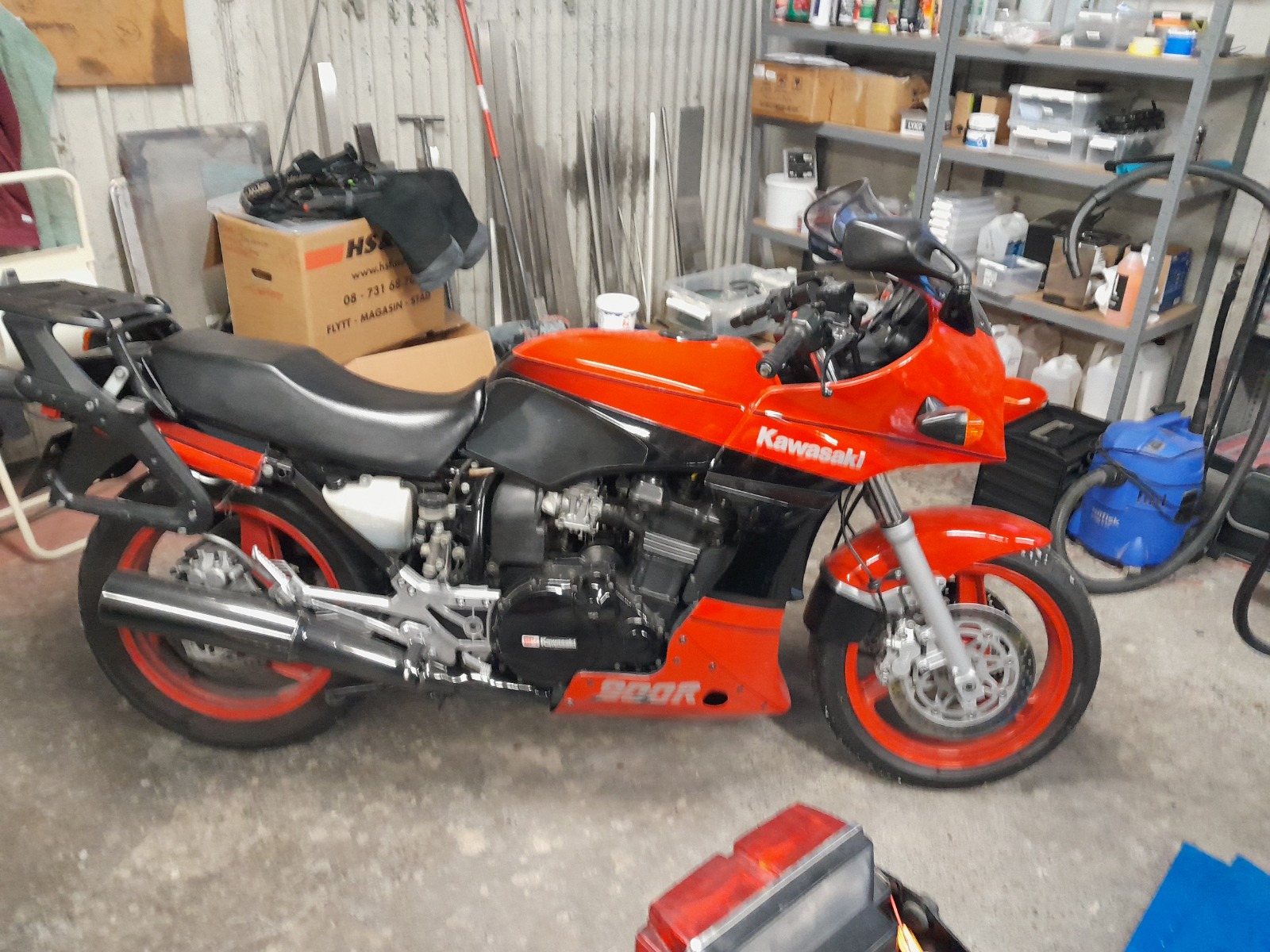

Friday morning I set of with another Gpz900 owning friend at 06:30 and by 15:00 the bike was offloaded in my workshop.
Looking pretty darn good, no witness marks of ever been down, no dents no scratches and a sexy luggage rack (the guy offered the bags for it, but I left them).

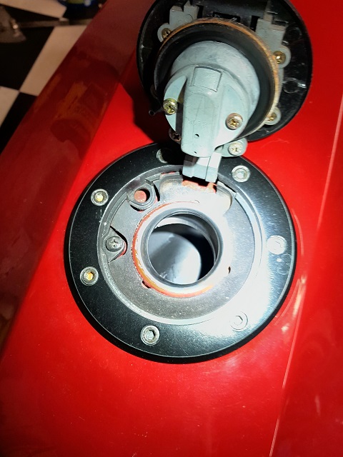

I checked the tank for any evidence of rust or other grit that could have caused the flooding, but its spanking clean,
Even when looking with my boroscope I could not find anything but clean steel.

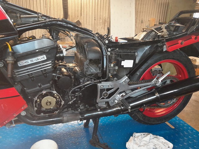

With all sorted and a list of needed stuff and no hacksaw blade I tried to make myself useful.
Belly pan fairing of and see there, the banjos for the oil lines are in desperate need of copious amount of blue permatex.
Draining the engine oil I found no foul smell of gas, nice so the engine didn’t flood after all. Oil filter looked ok, no metal shavings when I cut it up. Guess the big end bearings can be ok after all.
Then when I didn’t have any exhaust bandages either I spent a good day of the afternoon removing a m3 of chain lube from the left hand side of the bike behind the covers, on the chain, sprocket, rear wheel and chain guard.
Funny thing with these Gpz900, they are prone to leak oil, most commonly from the water pump or as it looks, from the crush washers on the banjos for the oil cooler and oil lines to the cylinder head.
So with that I just have to wait for my brown seat and have to find a trusty supplier of wire cutters so that I can start molesting the wiring harness.

Ok so the PO told me that he took the bike for a spin three years ago and I started to run unclean and after he had parked for a while he was convinced that he had completely flooded the bike and aqualocked it as it had given of a load exhaust explosion when he tried to ride it back home.
Given the exhaust explosions and the lack of obvious carb defects do you think it may be ignition related? (While you are waiting for the hacksaw blades why not give it a coat of Matt black )

Ahhh I forgot to write that nr 1&2 sparkplugs were on the lean side whereas 3&4 were fouled.
My 2 cents are on the float needles that had a bit of a crown. I even dismantled the petcock a it showed signs of use. Nothing more.
Wrinkle matt black?
Wrinkle matt black?

Check static cam timing and ignition timing just to be sure
