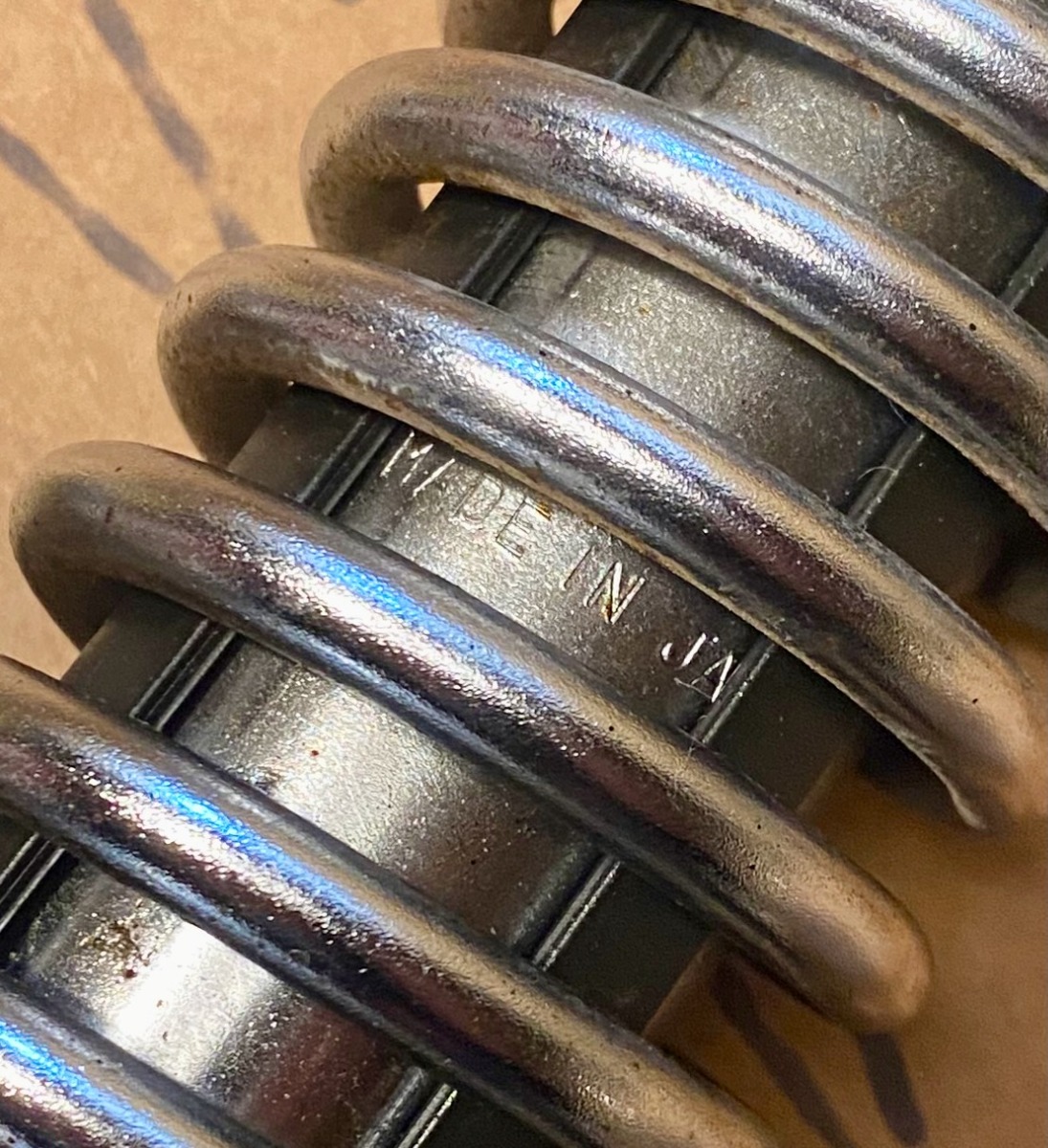

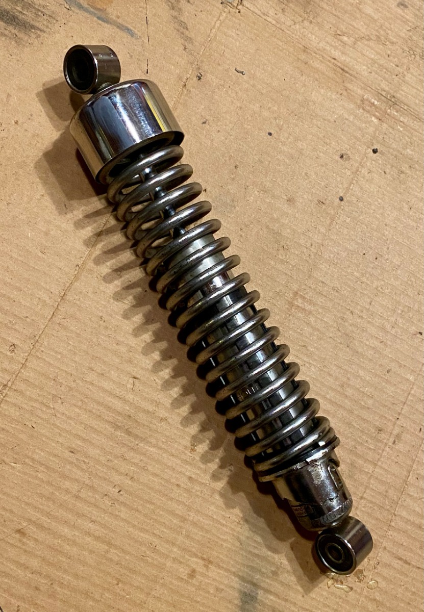

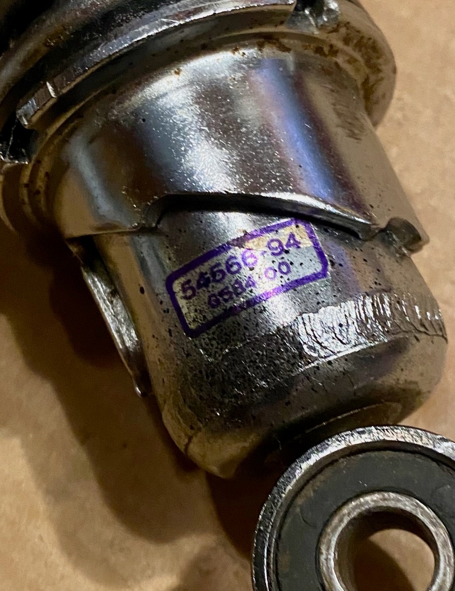

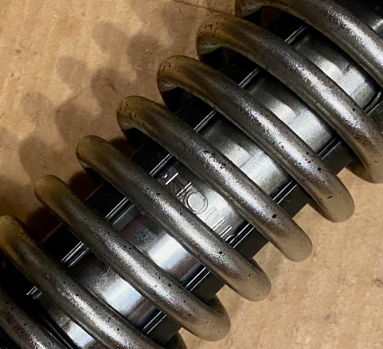

And what do you guys think of these rear shocks? It pleased me that they're Showa and Made in Japan. The numbers on the lower part of the shock, googled, tell us that they were OEM on 1994 Harley-Davidson 1200 Sportsers. Even in the lowest spring preload setting, these suckers are very stiff. My first impression is they're too stiff for the KZ1000's weight with me on it. And a lot of my local roads are third world rough! Is there something more supple that you guys recommend?

My SH775 seems to be adjusting itself to the load of my lights. I highly recommend installing one. Old 70's tech vs modern ones.

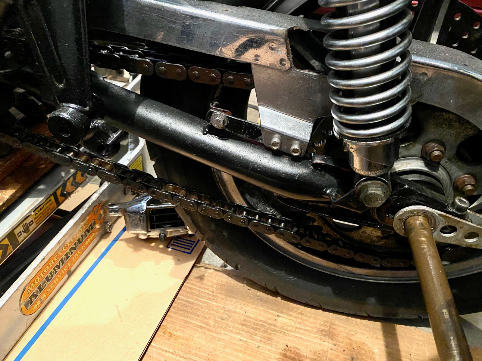

As for the shocks, isn't one too close to the chain?
The following user(s) said Thank You: wdhewson

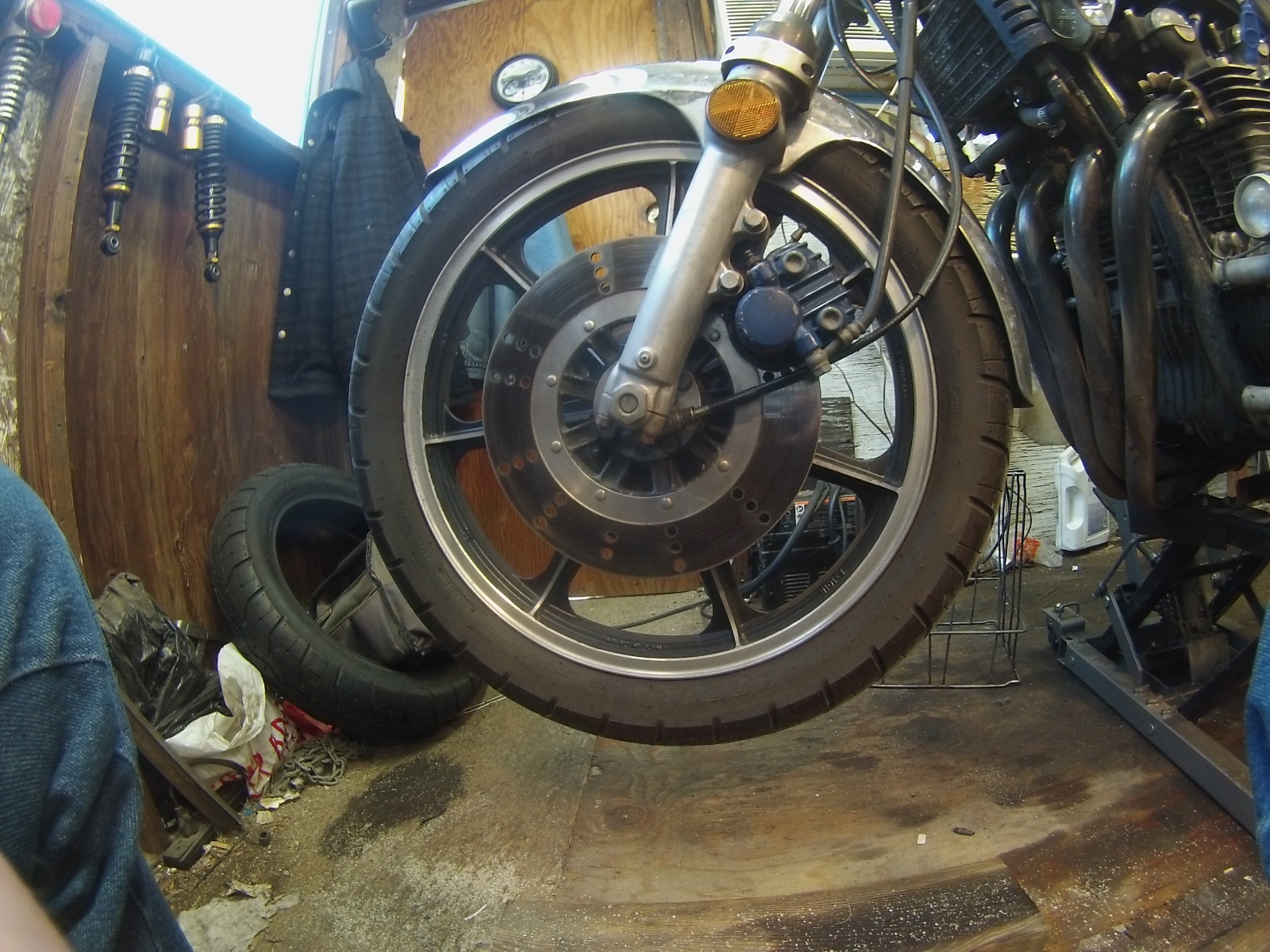

01 Feb 2023 16:35 - 01 Feb 2023 16:37My SH775 seems to be adjusting itself to the load of my lights. I highly recommend installing one. Old 70's tech vs modern ones.
Thanks SWest,
Good point about the rear shock and chain interference. The Showa shocks were both set to the highest preload which ramps those bottom adjustment collars upward. And perhaps this was done by the PO to clear the chain rather than tune the suspension.
So I went looking for a picture, and found this one. I think the preload collar clears the chain in any of its 3 position, and other shock parts also clear. But it's not the most instructive photo for this judgement.

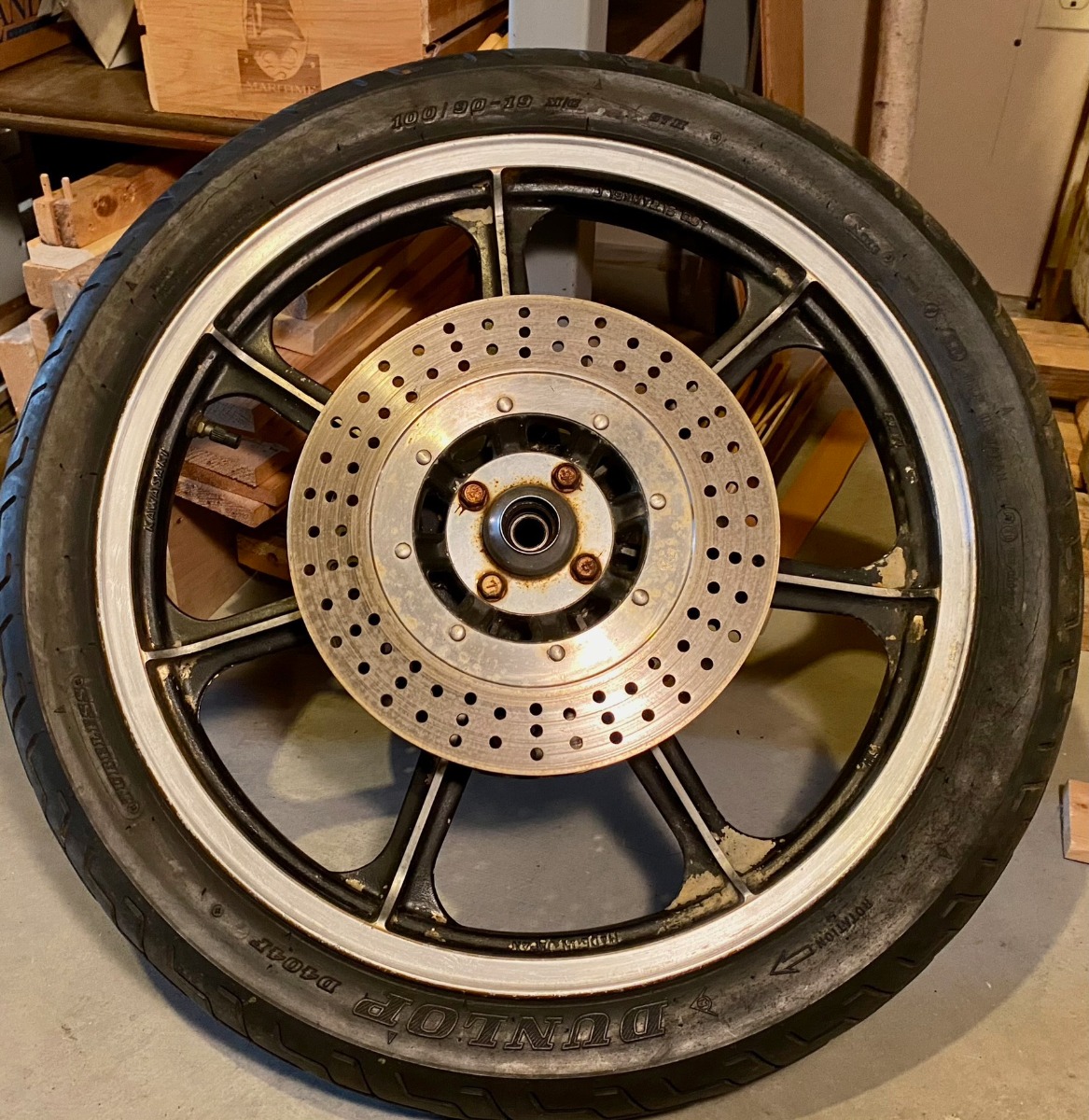

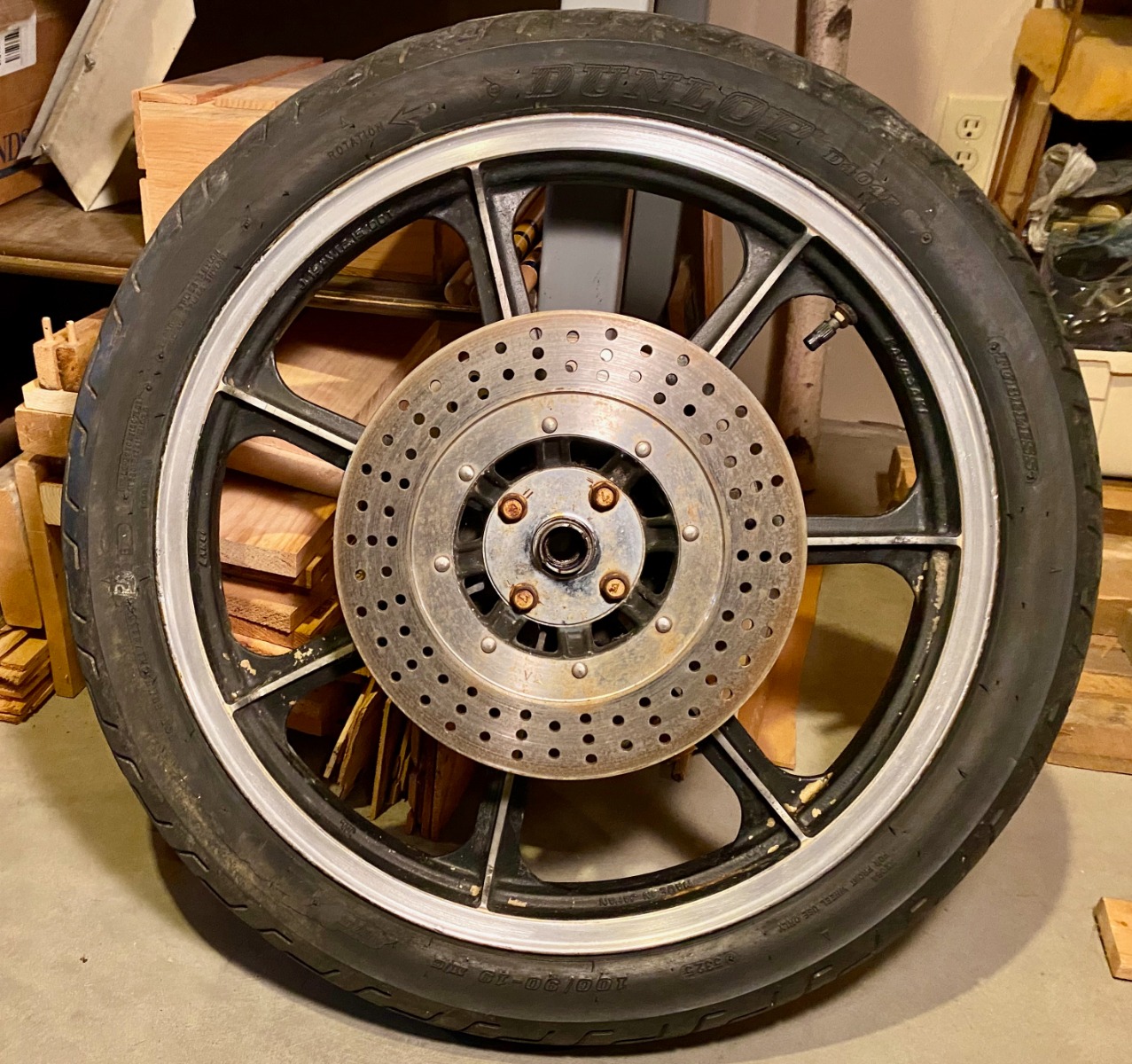

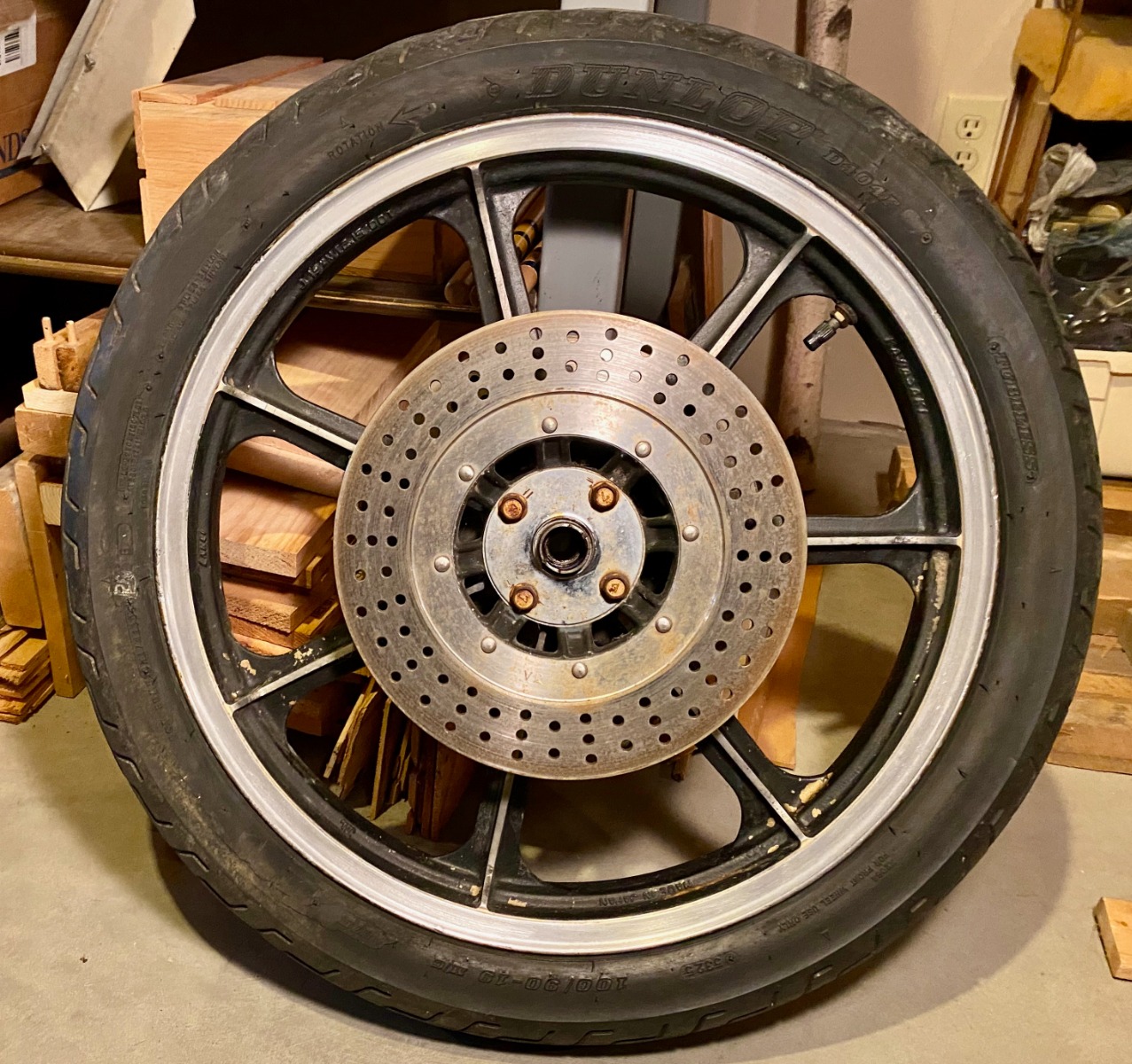

Working a bit with the front wheel and tire.
She's rolling a 100/90 19 tubeless, but there's some sidewall light cracking, the tread is legal but minimal, rubber seems hard, and it's not great at holding air.
Does that valve stem look like the installation is tubeless, or is that a tube stem?
I'm surprised that the discs are only 4-bolt and no locking tabs, but it looks like a sound assembly. the bolt heads aren't scarred up, so I don't think they've ever been removed.
To replace the rubber seals it looks like I would have to unbolt those discs. The seals seem OK to the extent I can examine them.

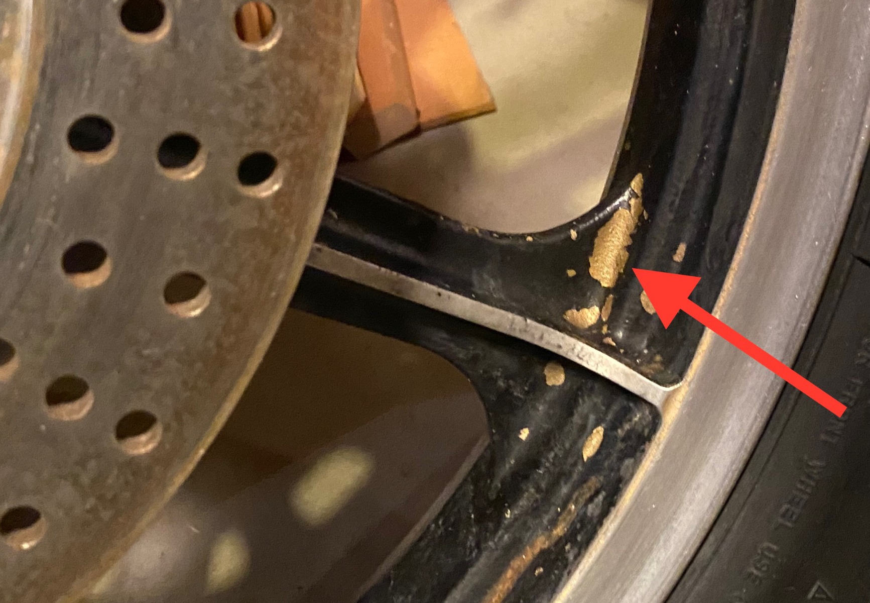

Also note that some of the flat black paint has flaked, and I might want to touch up the front and rear wheels. Is there a recommended paint for these cast wheels?
Thanks guys............

I run a tube like the one you have. The disks will need to come off. I used VHT roll bar paint on both of my alloy wheels I got from one of our members. (Thanks Vic) The disks look to have been drilled. I used some late model disks on my old wheels. They fit on the new ones too.

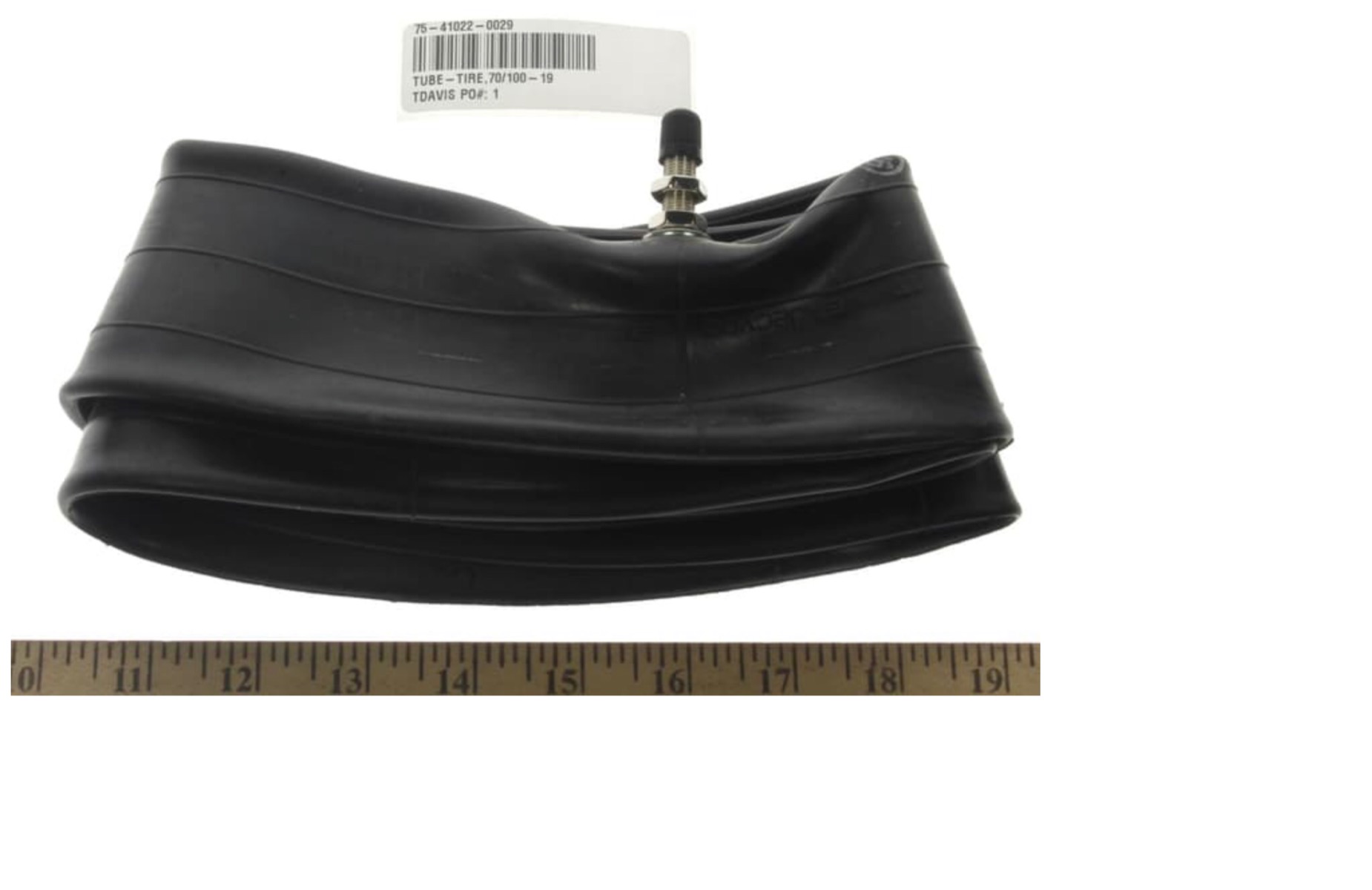

Yes the stem looks correct for tubeless, but there are tubes with metal stems so the only way to know for sure is break it down. I still run tubes in my mags. I tried to remove the tube once and the tire would be flat in four days. Tire needs replacing. Even without dry rot the shouldn’t be more than 8-10 years old. You may have 1979 mags swapped in, they were factory drilled. I’m a big believer in OEM setups, if the factory felt it was needed I believe them. Look at the parts fishe I posted and get 8 new bolts and 4 new locking tab washer.
www.partzilla.com/catalog/kawasaki/motor...hub-tire-79-80-b3-b4
Not your size but for example of a tube with metal stem
