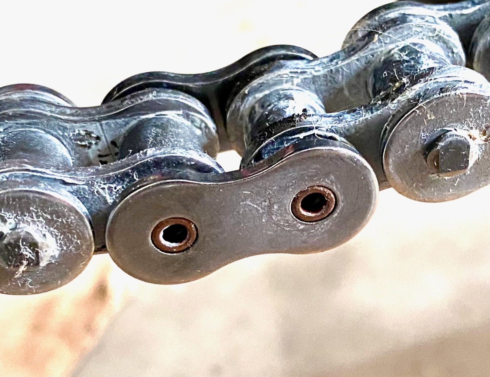

The D.I.D. instructions are not the best, as is so often the case with translated ones. I believe the point of that picture is to show that the rivet on the right is correctly done, while the rivet on the left has been over flared.

05 Oct 2023 22:03The D.I.D. instructions are not the best, as is so often the case with translated ones. I believe the point of that picture is to show that the rivet on the right is correctly done, while the rivet on the left has been over flared.
Good catch TexasKZ. I hadn't considered the translation issue. I think your interpretation is correct.
With about 40 thou per millimeter, going from 5.5 to 5.8 is a change of 0.3 mm or about 13 thou diameter increase, more akin to the right peen in the picture than the left peen.

06 Oct 2023 01:35 - 07 Oct 2023 16:45I remember when rivet style links included a couple of 'w' shaped wire gauges that went in between outer and inner link when riveting. The thickness of the wire gauge was set to provide the exact final squish of the O rings when riveting - making it difficult to over flare the rivet. Once riveted, the gauge wires were pulled out. Some new chains still show the gauge with the master link but I haven't seen a master link that includes them for years.The D.I.D. instructions are not the best, as is so often the case with translated ones. I believe the point of that picture is to show that the rivet on the right is correctly done, while the rivet on the left has been over flared.
Personally, I prefer the clip style master links - no guesswork - but not always available.

06 Oct 2023 05:33I remember when rivet style links included a couple of 'w' shaped wire gauges that went in between outer and inner link when reveting. The thickness of the wire gauge was set to provide the exact final squish of the O rings when riveting - making it difficult to over flare the rivet. Once riveted, the gauge wires were pulled out. Some new chains still show the gauge with the master link but I haven't seen a master link that includes them for years.The D.I.D. instructions are not the best, as is so often the case with translated ones. I believe the point of that picture is to show that the rivet on the right is correctly done, while the rivet on the left has been over flared.
Personally, I prefer the clip style master links - no guesswork.
Even bicycles have gotten rid of the master link, making me think it's an extra cost to be whittled out of the system.
On this RK Max-O chain, the O-ring squish seems to be controlled by a shoulder on the piece that the pin goes through. When you press on the outer plate, it butts onto this shoulder. Making it still possible to over due the peen.

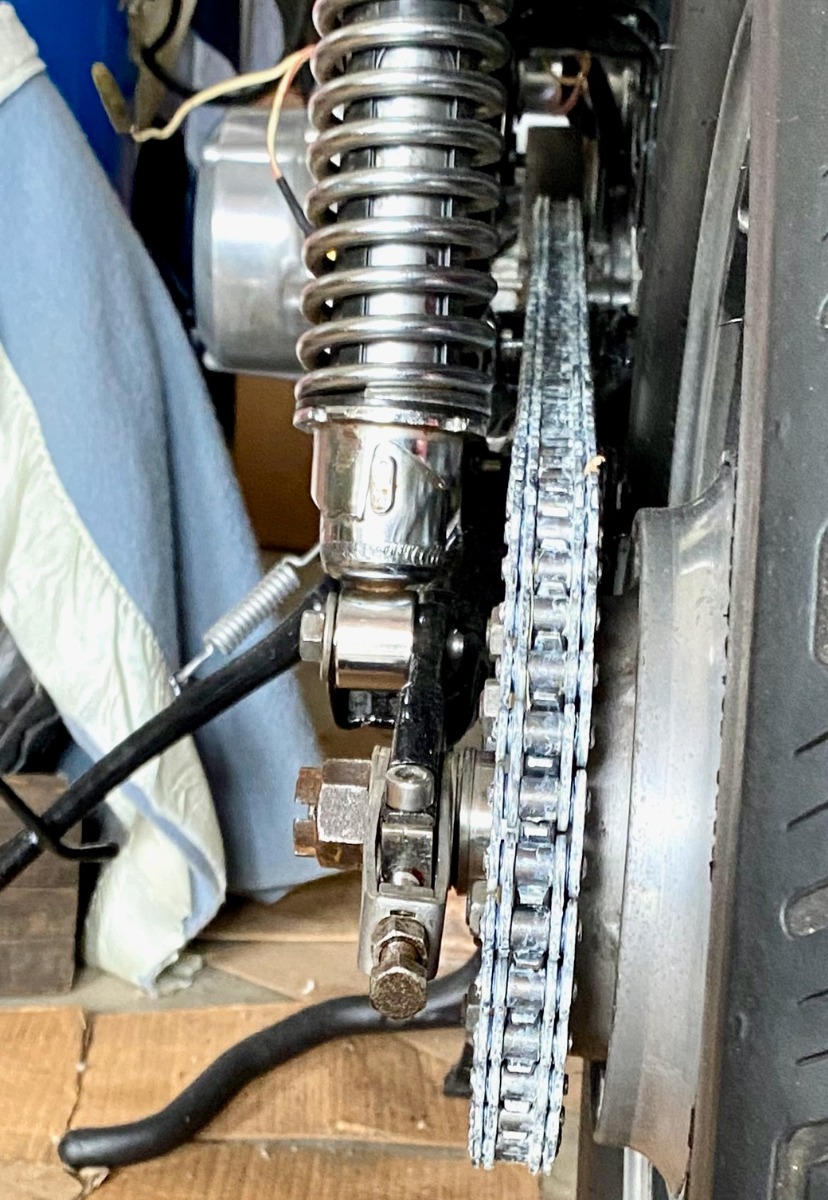

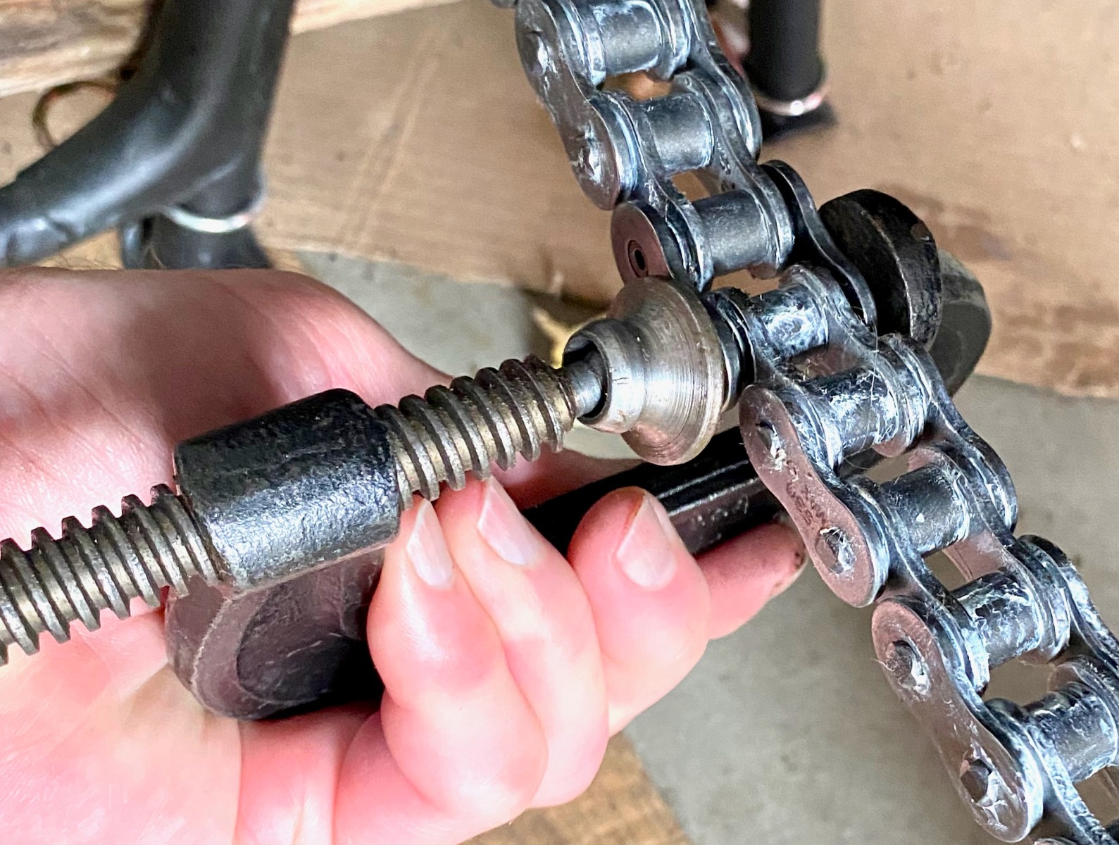

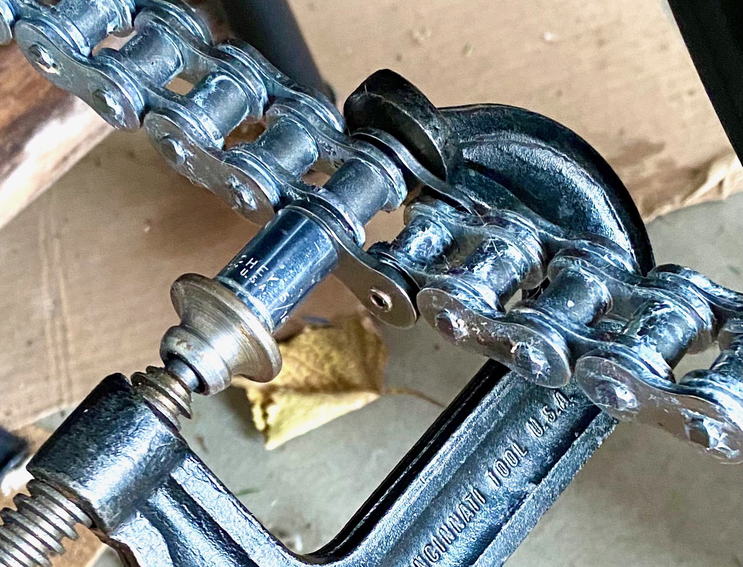

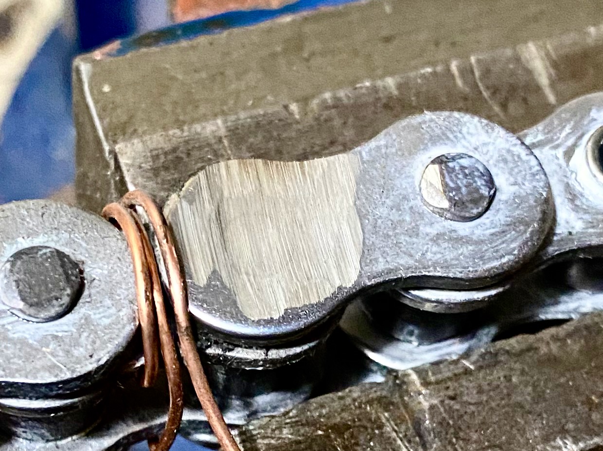

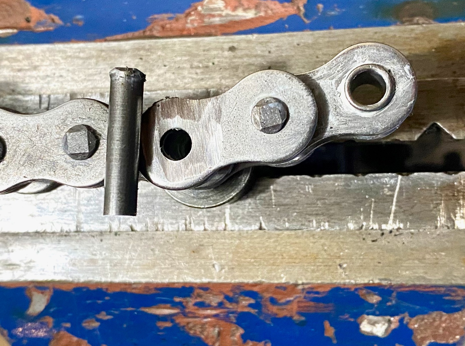

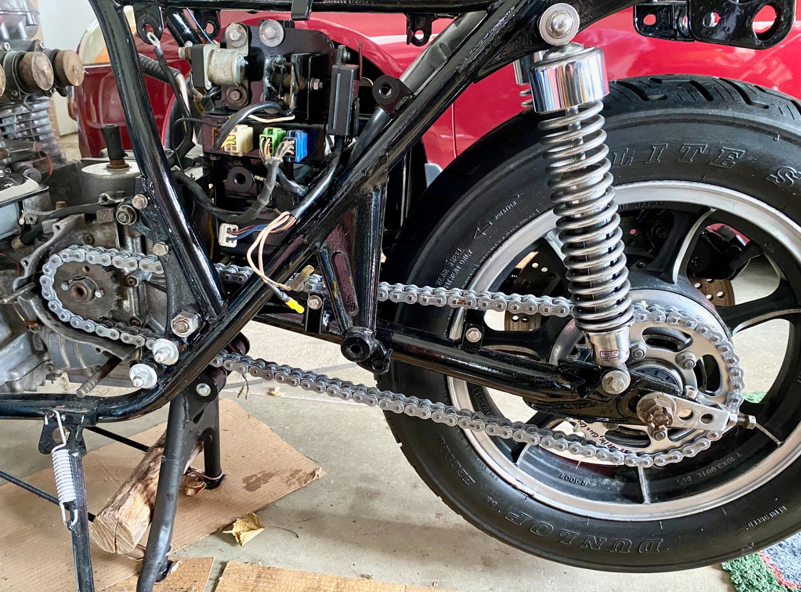

Partly installed that beefy RK Max-O chain this morning.
Those O-ring chains sure have a lot of pin friction due to the O-rings. Hard to handle.
Since my images seem to load in any order, I'll just comment, and the associated picture will be somewhere below.

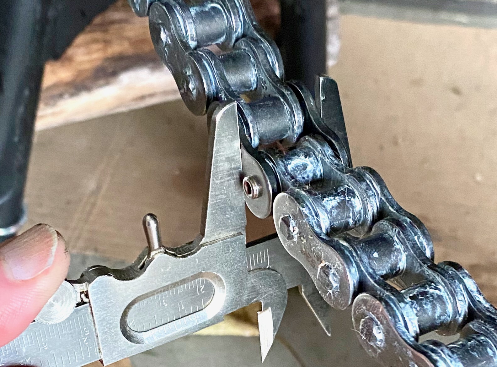

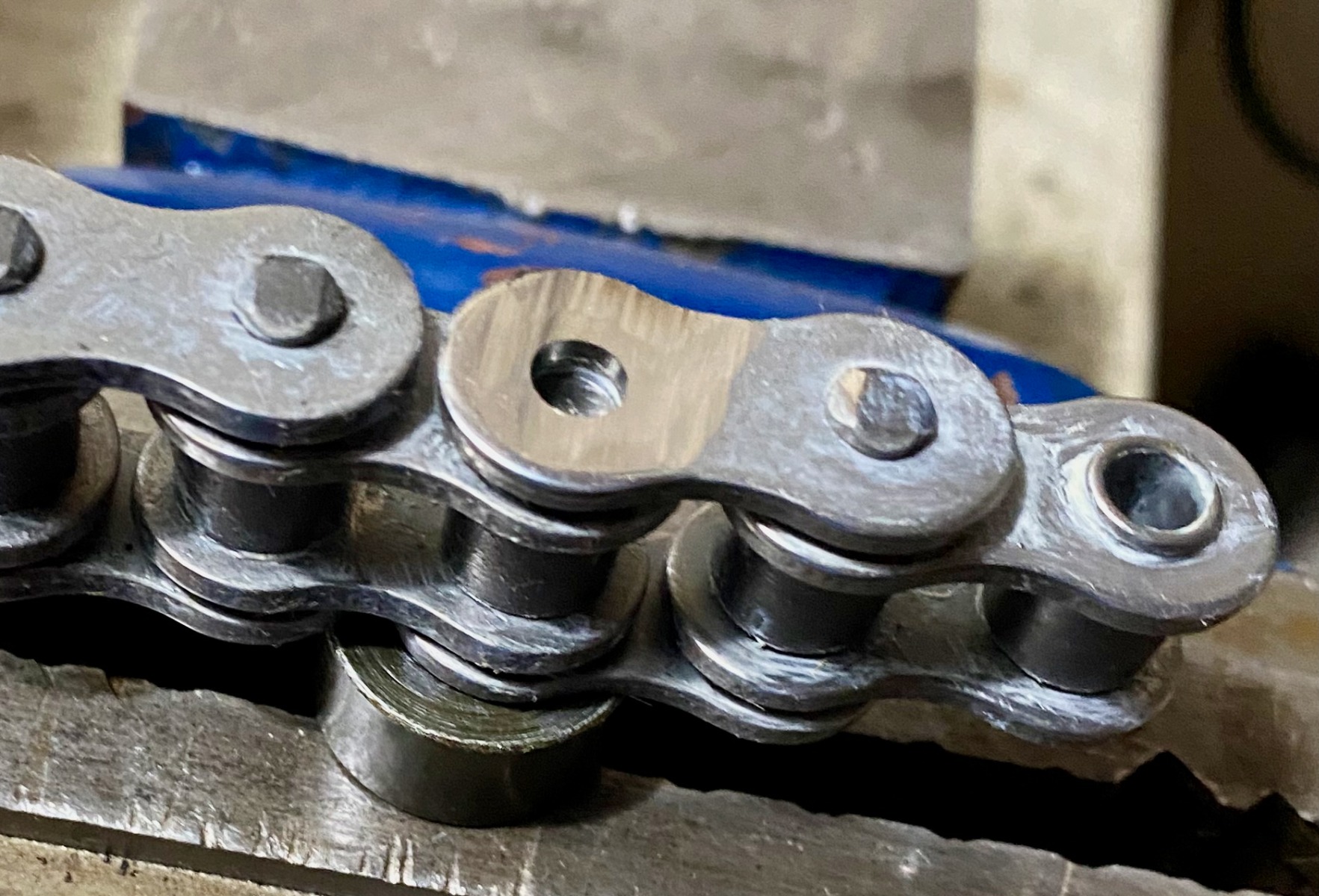

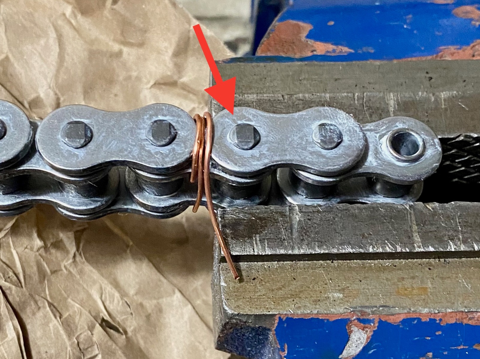

Tried the full 110 links, and there was way too much slack, so I marked the pin with some copper wire where I wanted to grind the staked pin off, drive out the pin, and loose two links.... going down to 108.
Punched out the ground pin into the "anvil hole" and through the vise jaws.

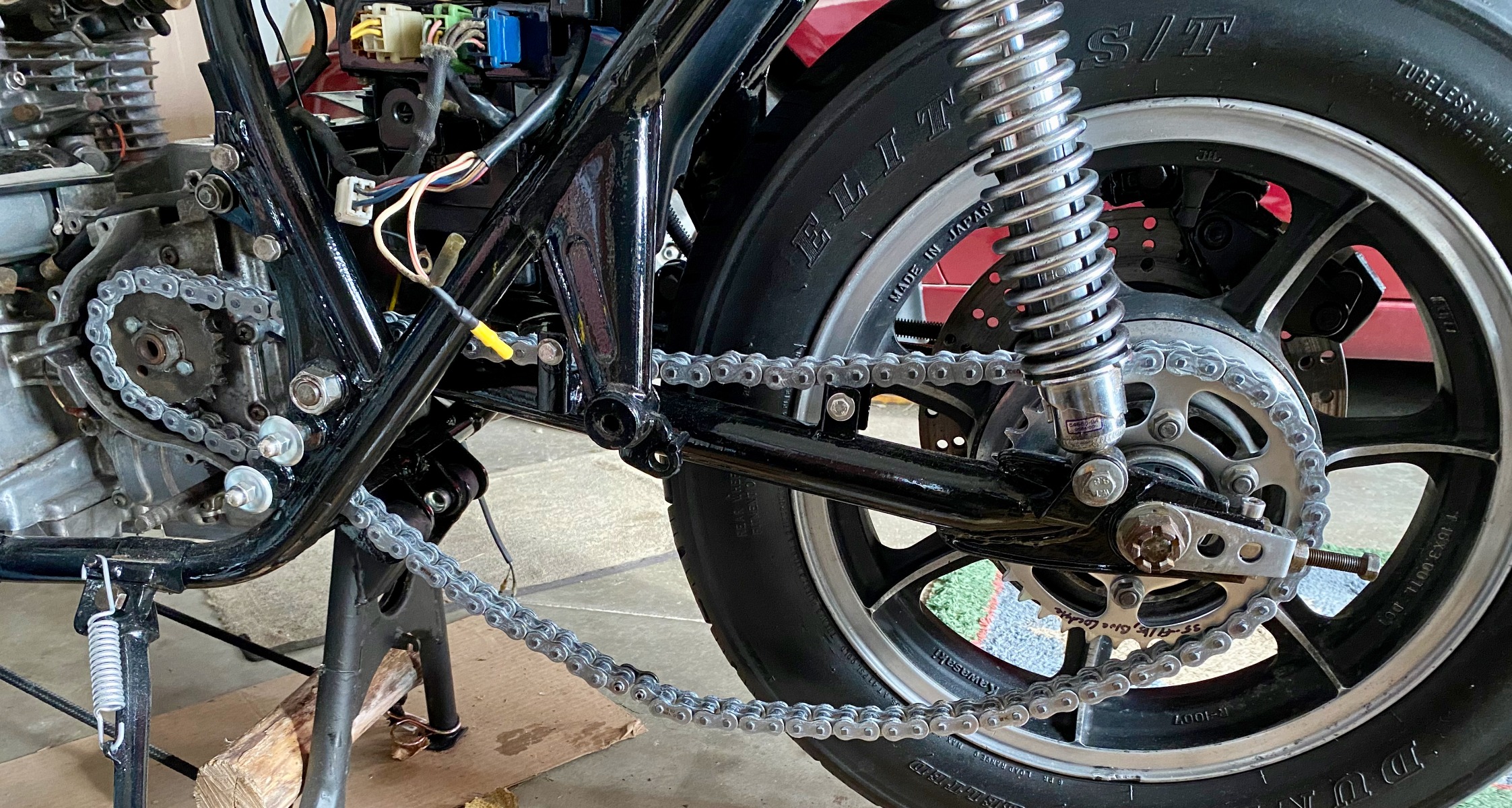

With the master link in, and no side plate yet pressed on, this seemed to give about the right chain slack, about mid axle adjustment. So I pressed on the side plate, eventually with a small socket to let the pin head through. Didn't forget the O-rings.
That pressed on side plate locates on pips so you don't over squish the O-ring which is nice, but I was using those Vernier calipers to watch it go down to the 22 mm width of the other chain's links.

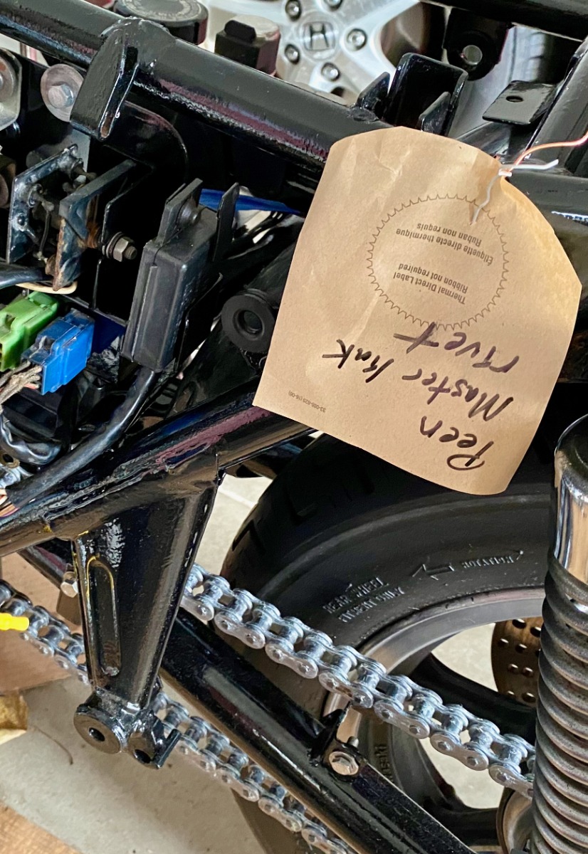

No rivet tool yet, so I posted a sign on the bike near the chain that she's not riveted. Hopefully a sufficient reminder!!!!!!!!

06 Oct 2023 17:40 - 06 Oct 2023 17:41I've peened them over with a hammer and RODE THE PISS OUT OF IT.
Thanks Steve. One of my friends worked in England building aircraft frames where there was a lot of rivet work, I might see what kind of tool and process he recommends. I'm likely too old to ride the piss out of it, unless the road is really wide and long!!

Those hollow tips are softer than the rest of the pins. If you don't feel good about doing it then I'd buy the tool. I've done it many times. I got it too tight once so I had to spread the link a bit and it worked well. This is on a 630 chain though and most tools won't do it.

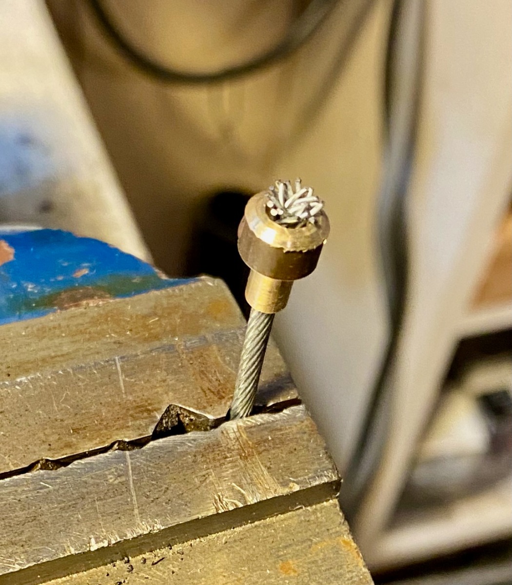

Meanwhile, with the chain in place, I can install the clutch cable. The cable that came with the bike looked correct but had way to much free end so the two adjusters (mid-cable and lever) were maxed out to get any clutch lift. With the lift mechanism screw and jam nut properly (I think) adjusted.
So shortened the cable, made up a brass ferrule at the release end and soldered the cable into it. Dimpled the end of the ferrule to receive the peened cable end, applied some old flux a machinist gave me 20 y ago, propane torch, and 50/50 plumbing solder.
Installed, it didn't pop off with 20 or 30 lever pulls, so far........
The KZ1000 is pretty good, the release lever is just at 90 deg to the cable with the hand lever halfway in.
A clutchless broken cable ride home on a heavy motorcycle might be an adventure!!
