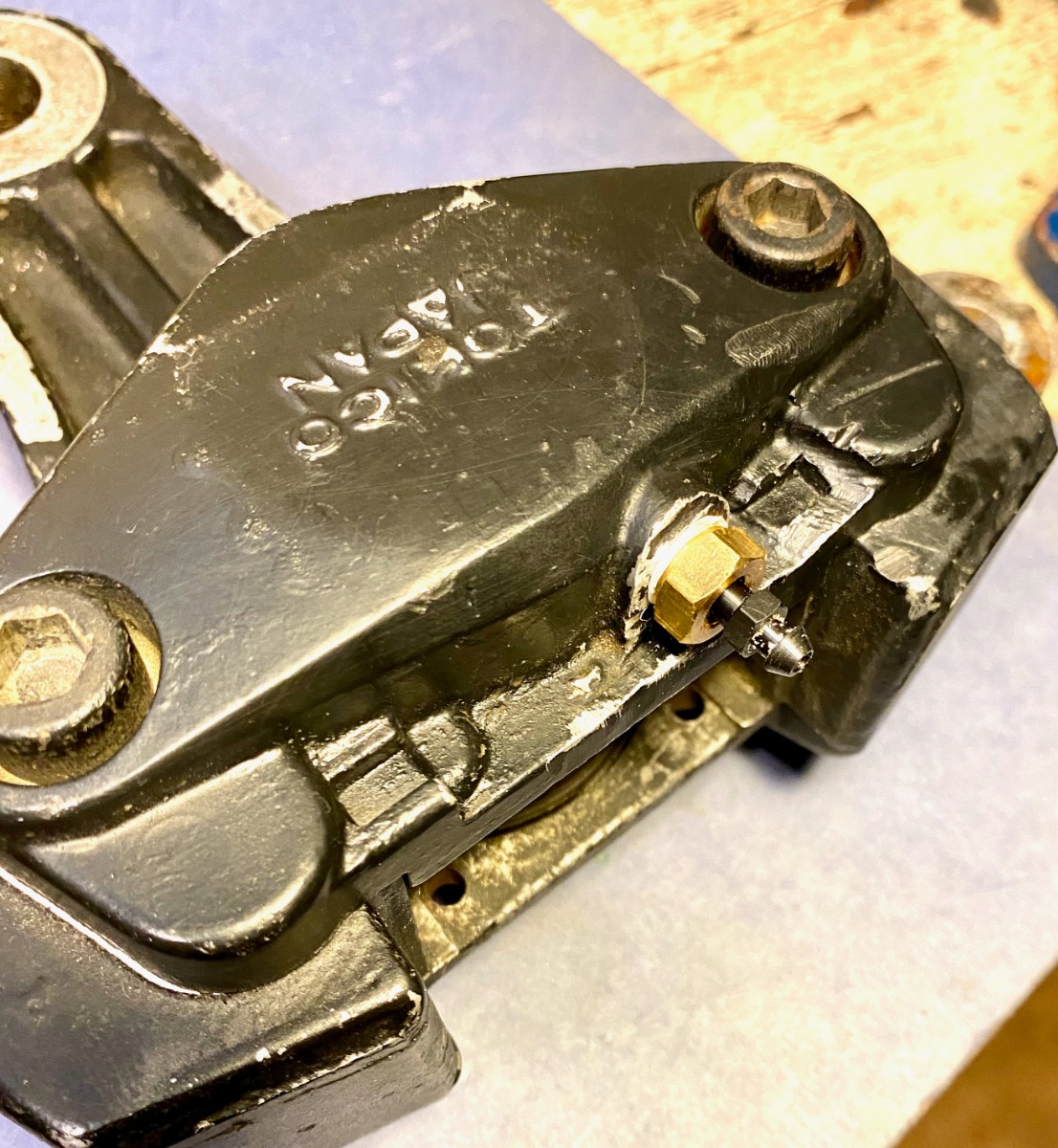

I cleaned up the head tube a bit and think the manufacturing date of 4 77 is visible on the side opposite the serial number, so you guys were quite right about 1977.
Here's the rear sprocket, which looks like an aftermarket JT one with a count of 41 teeth. Do you think this will be good gearing? I live in flatlands with lots of "nice" straightaways!!
And I rebuilt the rear caliper and everything looked pretty good, so lots of cleaning but no new parts. With the exception of a bleeder valve repair insert which uses a 1/8" pipe thread brass insert. Hard to buy these now due to liability.
