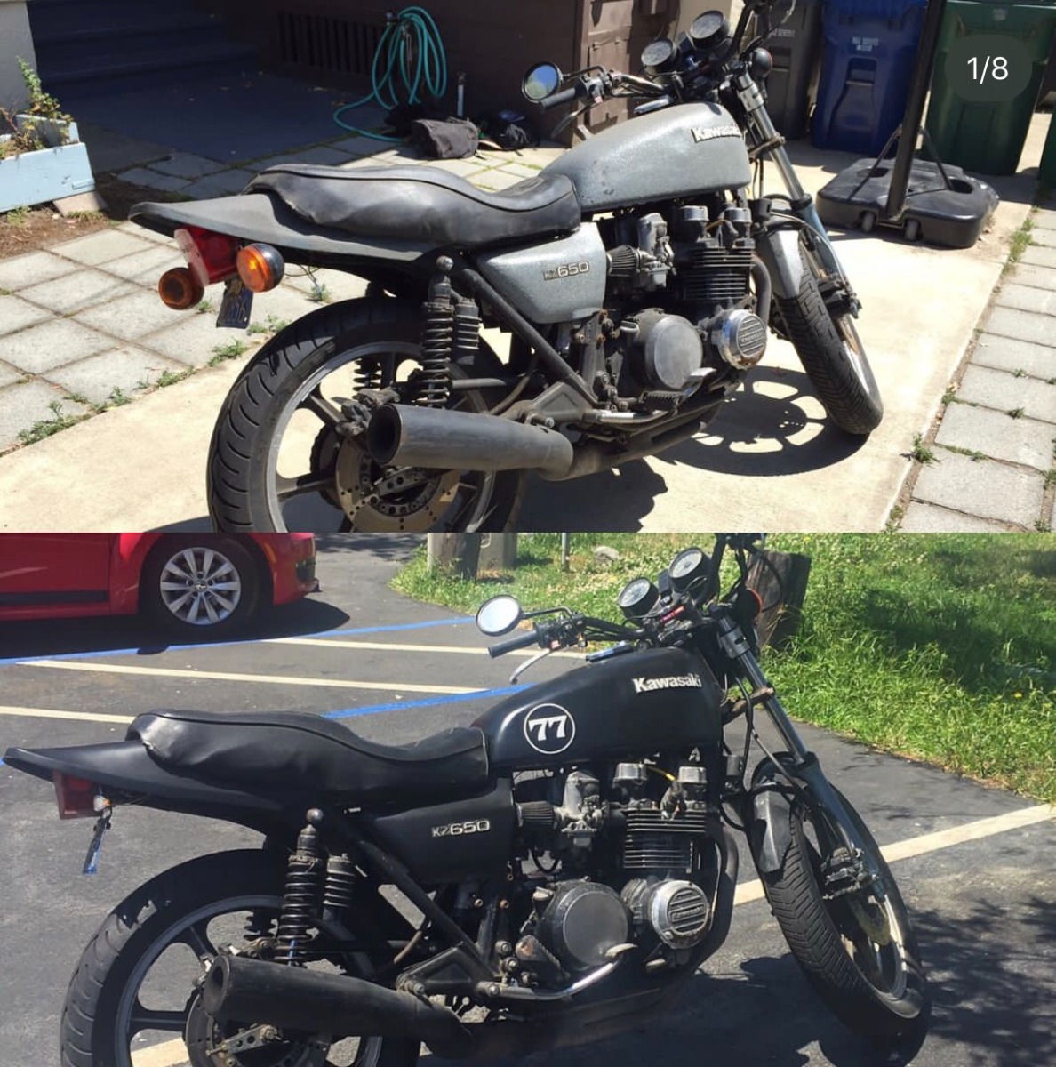

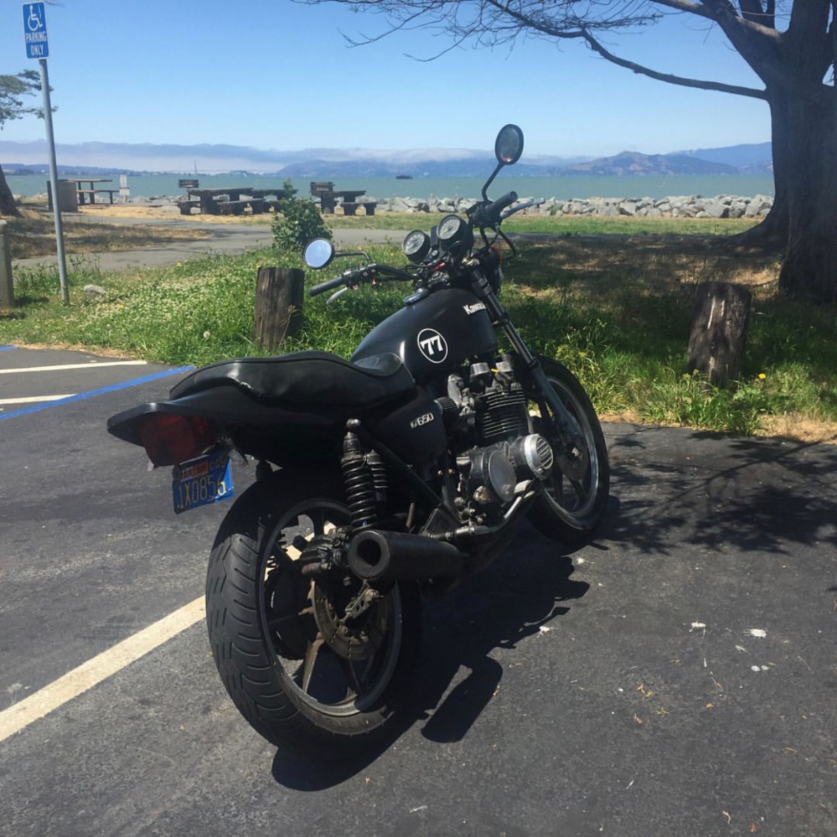

Top picture is a before and after, the previous owner had rattle canned an ugly paint job on it. I did my best to fix it with the matt black, I am planning on changing that soon as well. Give it a green Kawi flare at least.
These are old pictures, the bike is slightly torn apart right now due to a tire change. Will upload current pictures soon.
Thanks!
Thanks!
