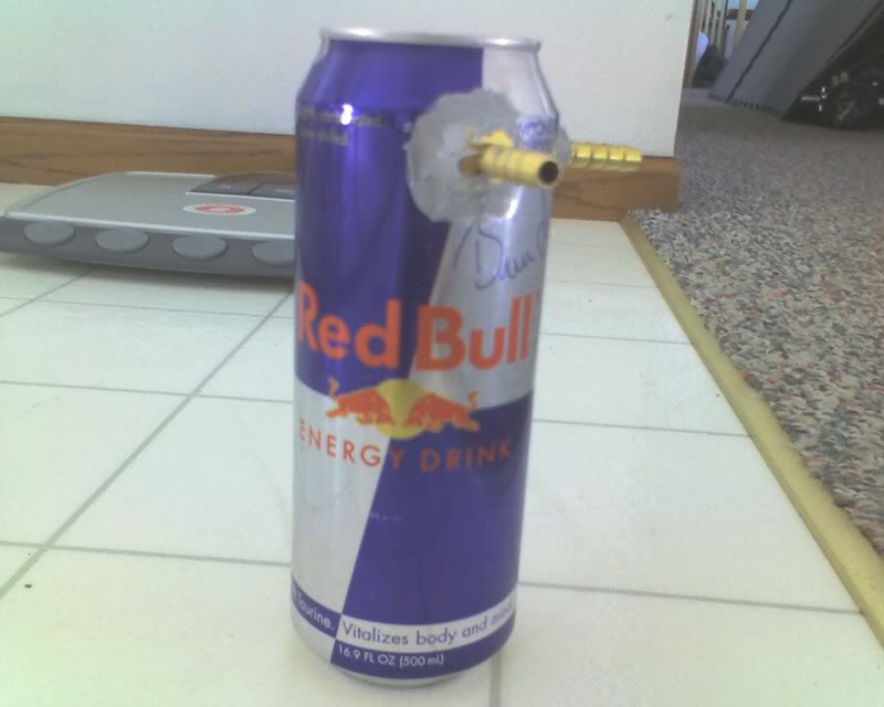

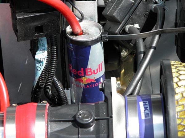

Racers are required to run the crankcase breather hose into a catch can of some sort. Otherwise, oil fog will spew out of the hose and go god knows where. I recommend a PBR can strapped to the frame. Doesn't get any cooler than that!
