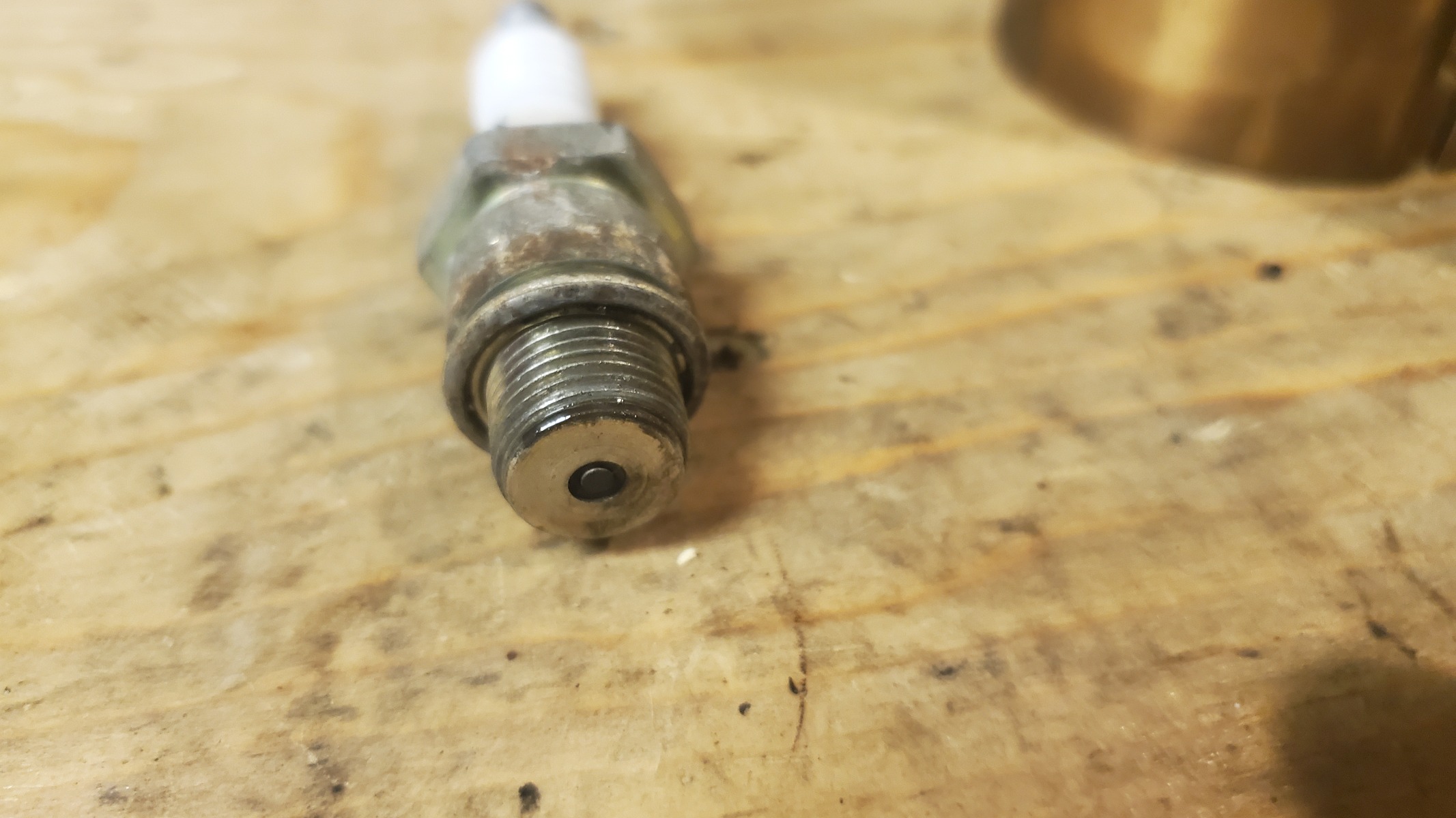

Can't say I have ever seen spark plugs like these before.

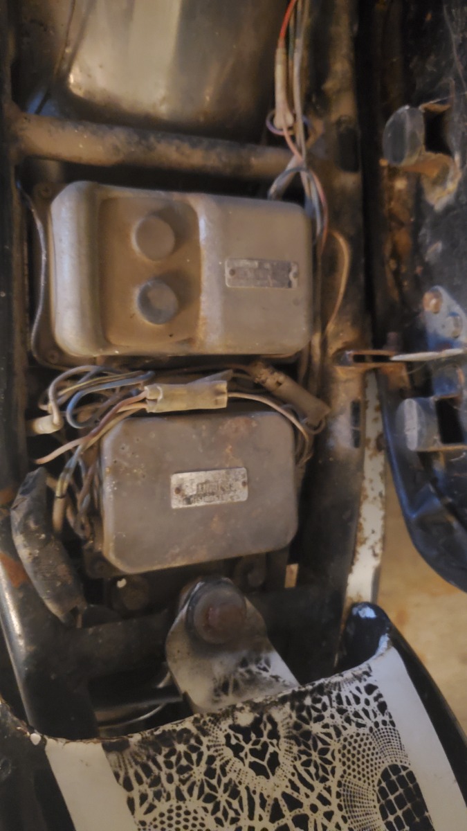

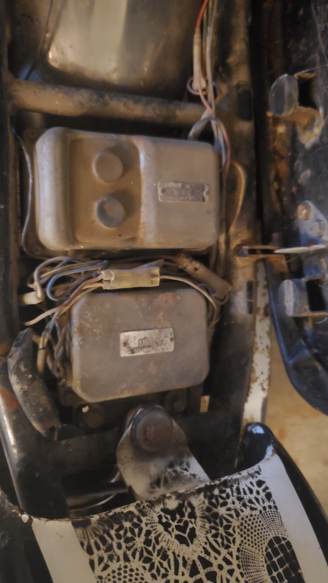

- The ignition is definitely an odd ball. I have some reading to do.

Those are what they call Surface Gap Plugs. The '69 to '71 H1 came with that type of plugs. They are SUPER COLD heat range wise!!!!
Its a little bit colder than a B9HS.

69 thru 71 had electronic ignition which proved problematic and KHI switched to points ignition in 72.

Kawasaki in '72 offered both the CDI H1A and the points H1B models that year. Kawasaki only made the mistake of putting points ignition on the H1 that one model year.
The H1/KH500 had electronic ignition for the rest of the years it was produced.
The H1B and the S series triples were a real pain in the ass to keep running at peak performance because of the weak points ignition those bikes came with!!!!
I owned Kawa triples with both styles of ignitions in the past. I would NEVER AGAIN own a triple with points ignition!!!!
