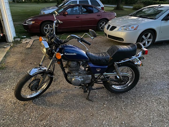

Thanks for the add! Just bought this 1980 KZ 250 LTD! It’s got about 20,000 miles and runs pretty decently (although it may be running a bit lean/has a hard time idling, I’ll post a video soon). Plan is to create a pretty sweet cafe style build with this.

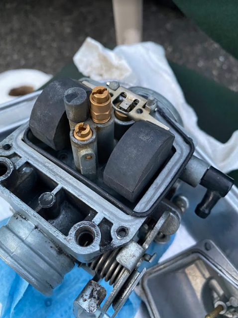

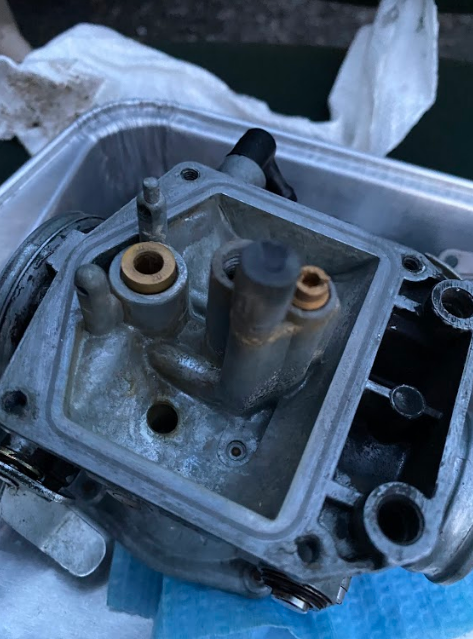

Currently working on getting the bike to idle and run a little bit better. I’ve noticed that it doesn’t really like to idle, and I’ve seen the exhaust pipe start to glow red so I think it might be running a bit lean. any thoughts on how to solve these issues?
I just took apart the carburetor, and it looks very clean on the inside. One of the jets had a plug on top, so I removed the plug (plug still on in pictures) in hopes to get the bike running a bit more rich. I think it’s lean because the original airbox has been replaced with some aftermarket parts. I also tinkered with the idle screw a bit before taking the carb off, which seemed to help a little bit

That rubber cap is necessary for the carburetor to function properly. The lean condition may be because the previous owner did not rejet after changing the intake system, or it could be from a dry, hard, cracked carburetor holder, or both. Could also be that the fuel level in the carburetor is too low.

I'll second that the rubber plug is necessary; the pilot jet beneath it draws fuel from the main jet, and if the plug isn't there it'll likely run very poorly (I've experienced this).
If you ensure everything is in spec and you have no air leak, then it's probably a rejetting situation. Looks like you can use jets that fit Keihin CV34s, so shouldn't be too hard to find larger sizes.

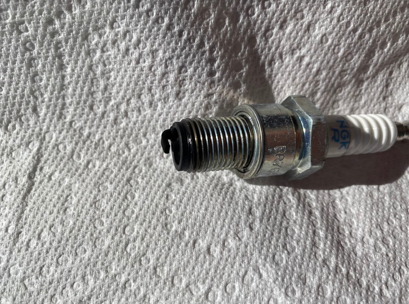

Since the last update, I removed a plug that I found in the carburetor covering a jet. When I put everything back together it definitely wasn’t running lean anymore, I think it is actually running so rich now that The spark doesn’t always happen due to too much fuel. I tried turning my idle screw clockwise until it wouldn’t go any more and it’s still running rich. Here is a picture of a brand new spark plug with two minutes of ride time.
I'm thinking maybe I should put the plug in the carb back in and get a pilot jet with a bigger size? Not sure exactly what to do. I also looked around the engine a bit and there doesn’t seem to be any gas leaks anywhere, which I suppose is a good thing
